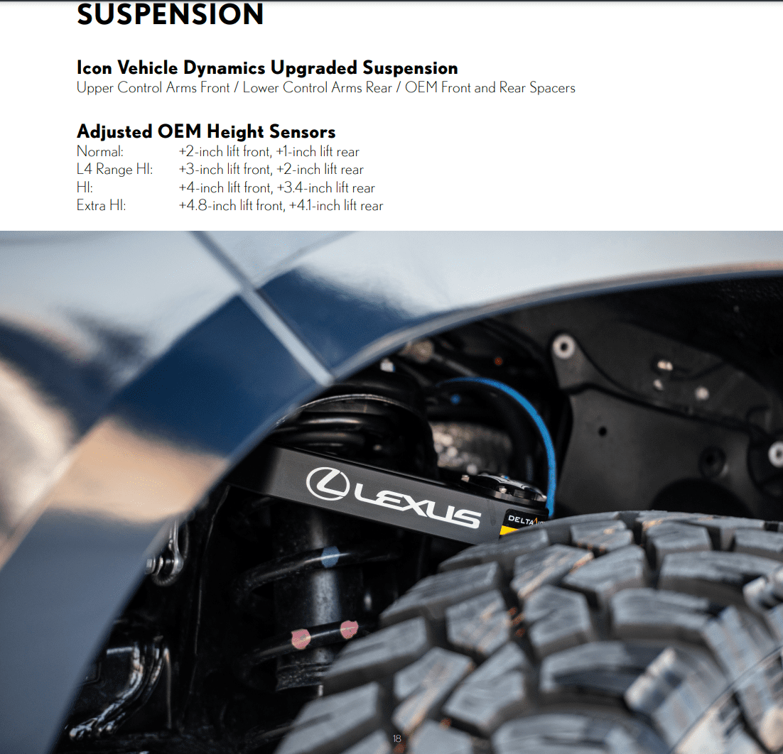

Interesting suspension setup they have on the J201. Glad to see they've largely kept AHC intact. Looks like they've paired Icon Front UCA and Rear Lower Trailing arms. Those parts don't really do much other than add some caster back to the front alignment. Added OEM suspension spacers to augment payload capacity. And given it a healthy +2" front and +1" rear sensor adjustment. Not unlike what I've done with mine.
The lift is prodigious on account of the sensor adjustment. Pairing that with 33s, makes for some serious lift. Imagine if they added 35s...they certainly have the gearing for it with 4.3s on the 8-speed. With 33s, that's almost 6" total lift. Add 35s, 7".
