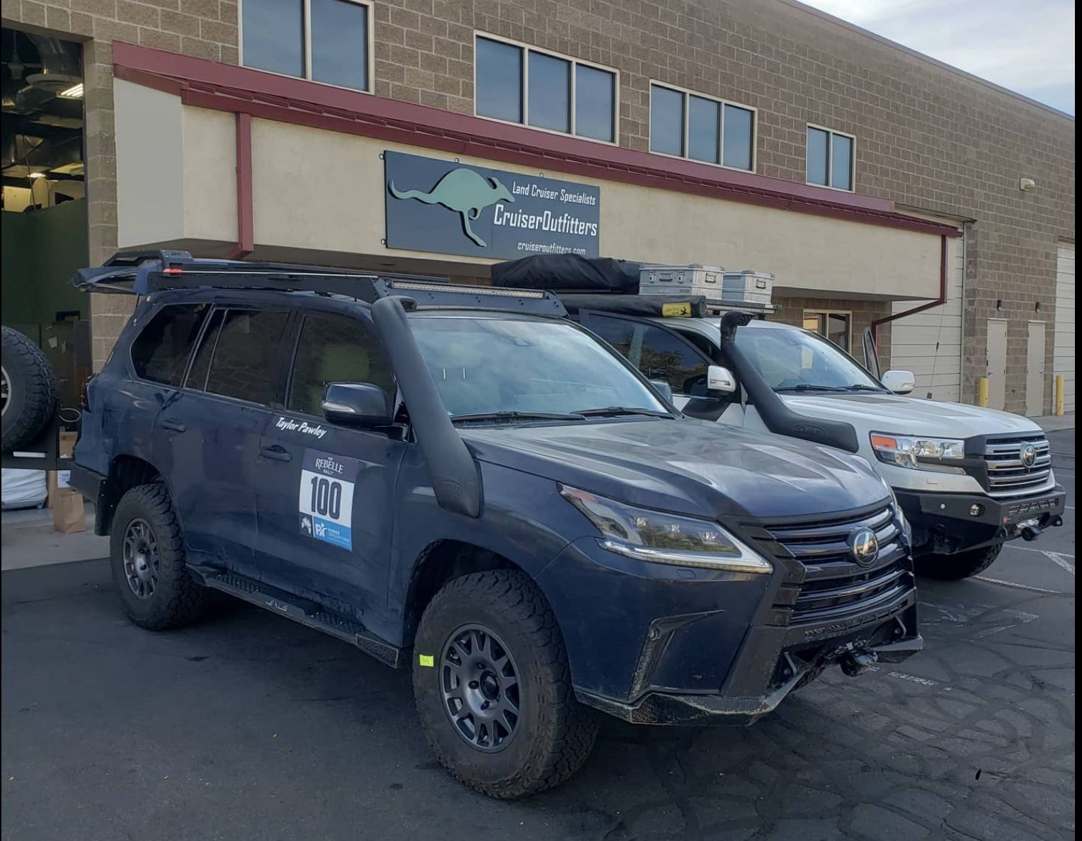

Not the greatest photo but a good comparison of the Airtec vs Safari and the two different CBI bumpers.
After scouring the threads I have seen instances of using a CBI 200 LC front bumper on an LX, but not anyone using one on a 2016+ LX. I appreciate the engineering that went into the LX specific bumper on the J201, but I would still like further improvements in approach angles (as well as a more traditional appearance). The LC specific bumper has clean lines and the level cut would, in theory, facilitate placement on an LX. Has anyone made this work? Do you have any pics? I have previously mounted an ARB on a 2010 LX, but without an LX template there is a good bit of cut and recut, and difficult to yield the outcome desired, especially with the uprights.
*BTW CBI currently has a Black Friday/ Cyber Monday sale on their 200 series products (including prinsu roof rack).
We used the Airtec (TJM) on this particular build. Mostly because it has a noticably stealthier upper body that attracted our Lexus team members. It also took a great deal of mods to the snorkel body, SAIS system, intake tube, etc to fit BUT not something I wouldn't do again. @bryson and I installed this one and were both quite tickled with the results overall. It fits as good as many Safari, Airtec, OEM snorkel applications. A close eye when at the vehicle will reveal the tweeking we had to do on the snorkel body but again, it turned out great imo.
