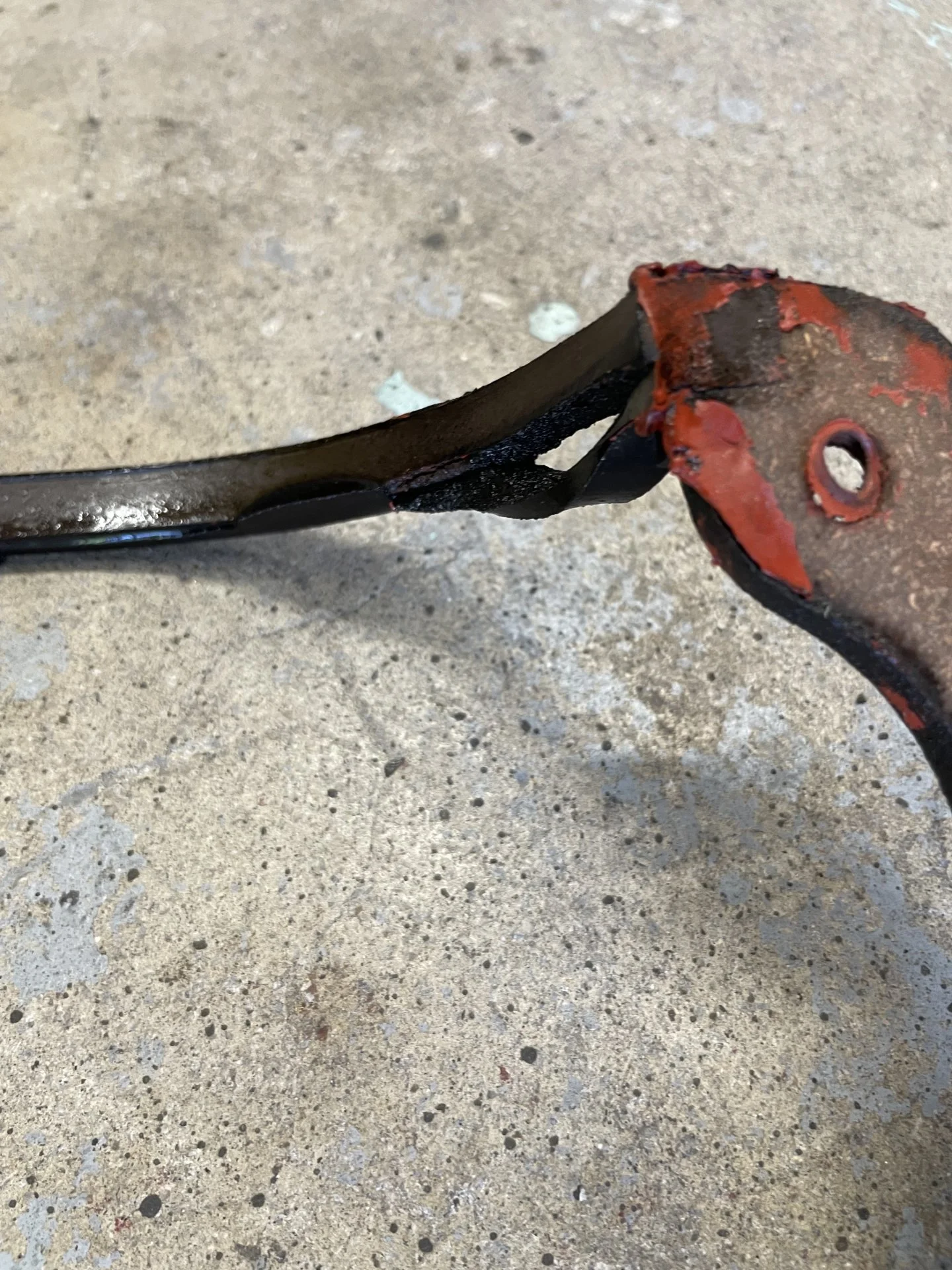

Check out that tear. This is on the front arch.

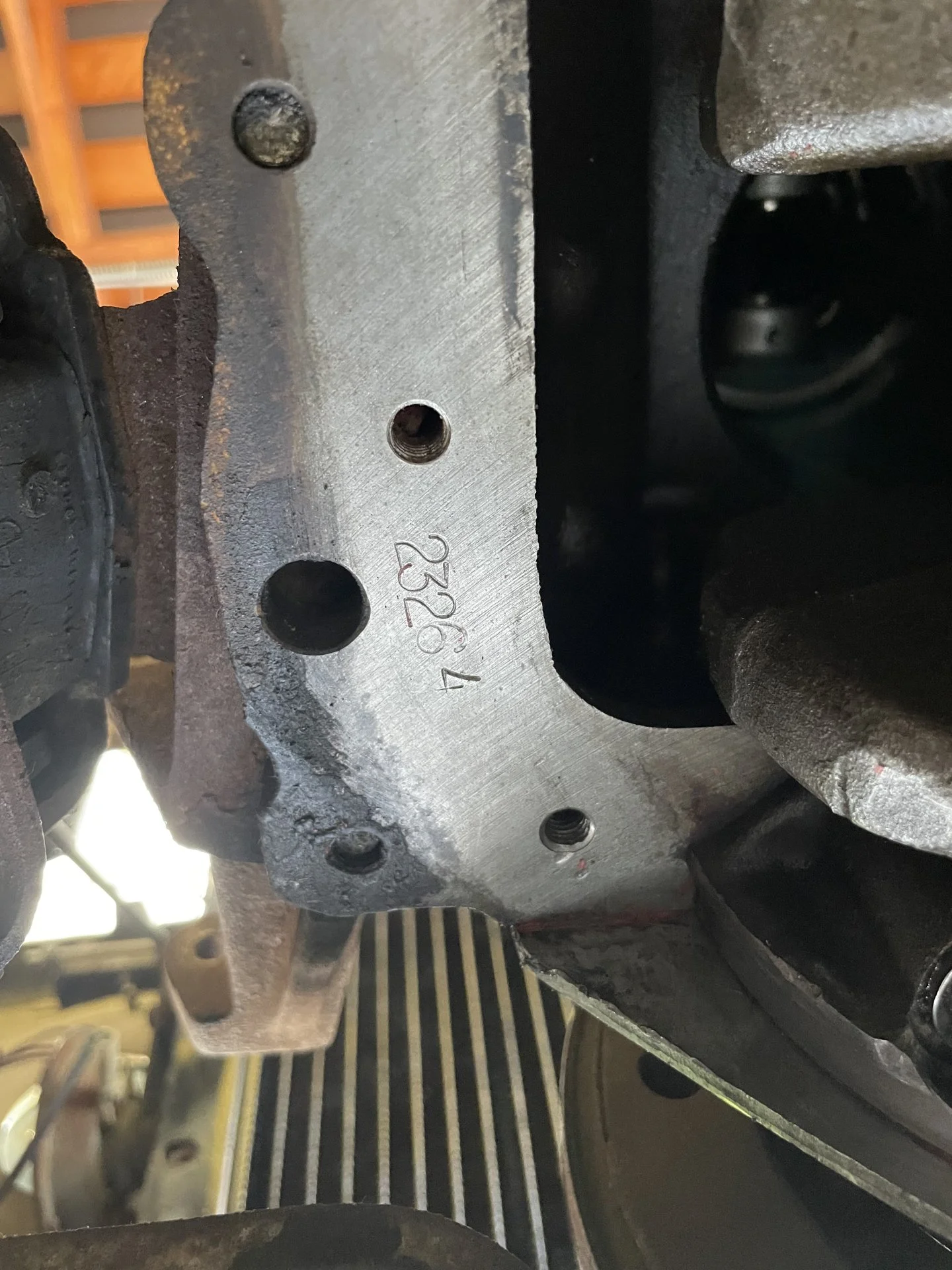

Found this on the bottom side of the block. This number doesn’t match the VIN, I didn’t expect it to, but I also don’t know why it’s here.
It also matches a tag that was welded onto the side of the block. Makes me doubt this block was born here. But who knows. Underside and oil pump all look fine.
