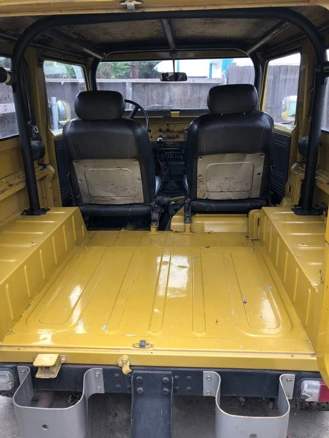

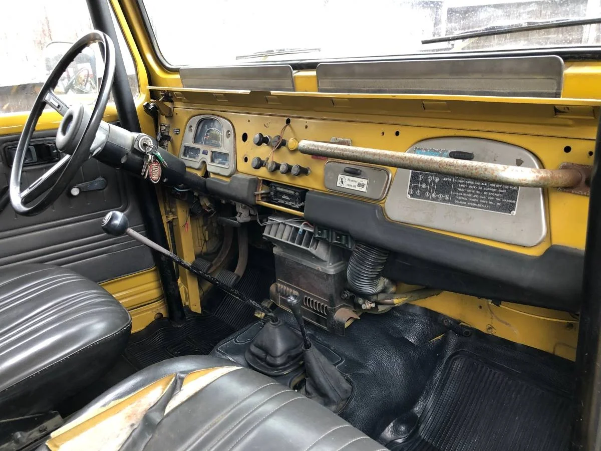

New project! First order of business is CA smog (she's a '77). Yikes. But so psyched! Quick and dirty compression showed 150 across the board except #6, which is 140. Surface rust underneath, moist t-case from the shaft seals, front crank seal, rear main or oil pan (hard to tell), steering box, all more or less expected. Starts and idles nicely but dies once it runs out of fuel in the bowl, so looking forward to sorting that out. CA carb on the engine (to rebuild) and spare CA carb in a box.
Lots of smog spares. Has not been de-smogged, still has the VSV, AIR, smog pump, EGR cooler, and that little computer thing under the dash all in place and wired up. Also has the hot air intake doodad bolted to the block. I understand that's tough to find now. No rot in the usual spots, as best I can tell. Respray seems ok as far as it goes, but no idea why they missed the shade on the upper rear panels and the seller doesn’t know either, was done before his ownership. Fenders were cut as well. Wheels as they sit look kinda silly I think, they are NOS from 20 years ago. Hah.
After fuel and smog, it's tires and seals and cosmetics and finding rare bits and etc. Unless it all goes to hell, which it probably will. Showing about 69K miles on the odometer, I’m sure that’s rolled at least once.
Will be here to start work next week, and tide me over until the '02 gets back from paint... someday. I'd send this one in next but I don't trust this paint guy to get it done any time soon.

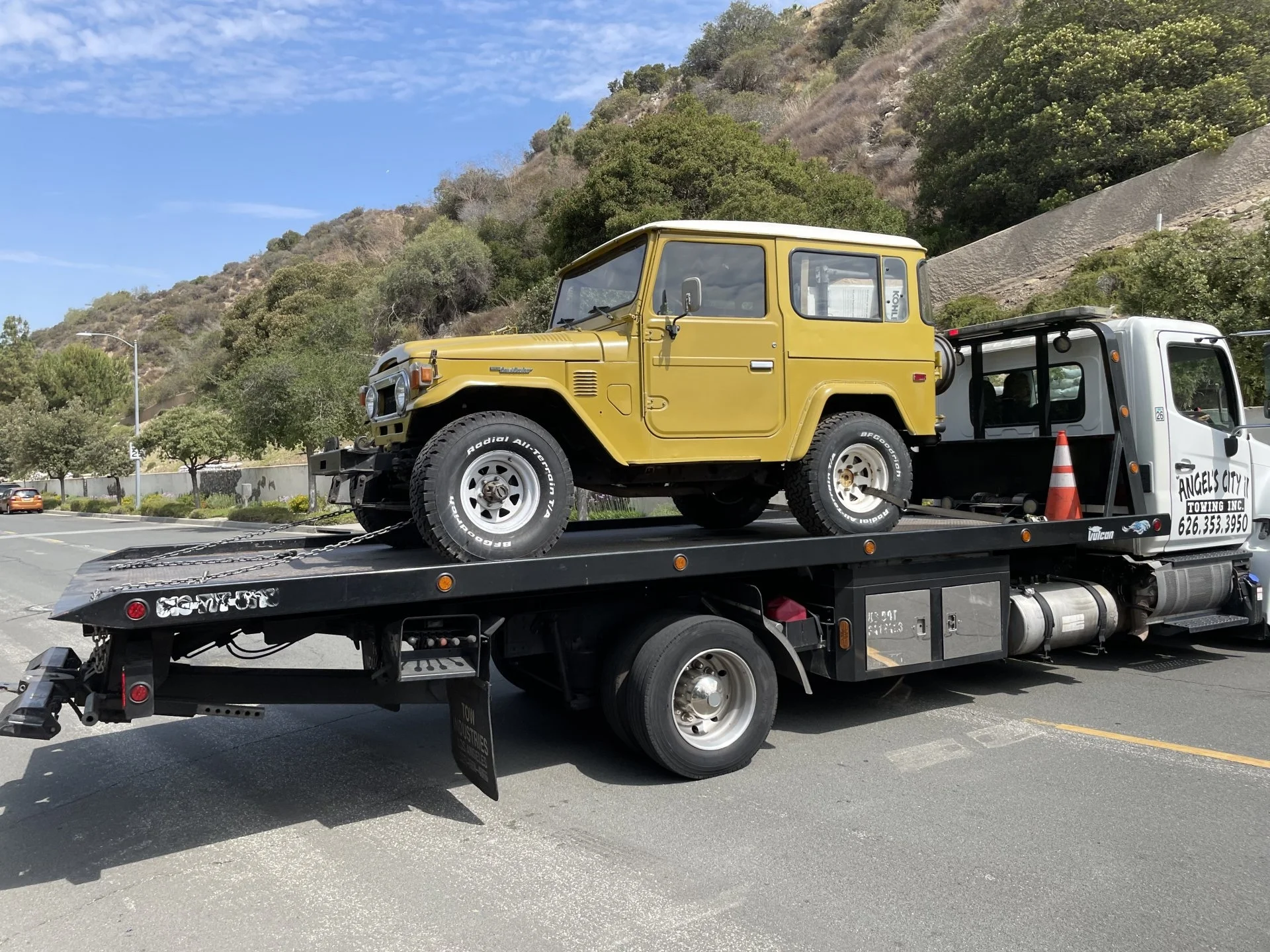

Today was the day! Got up bright and early, met the tow driver down at the seller’s place, and it was back home by about 11am.

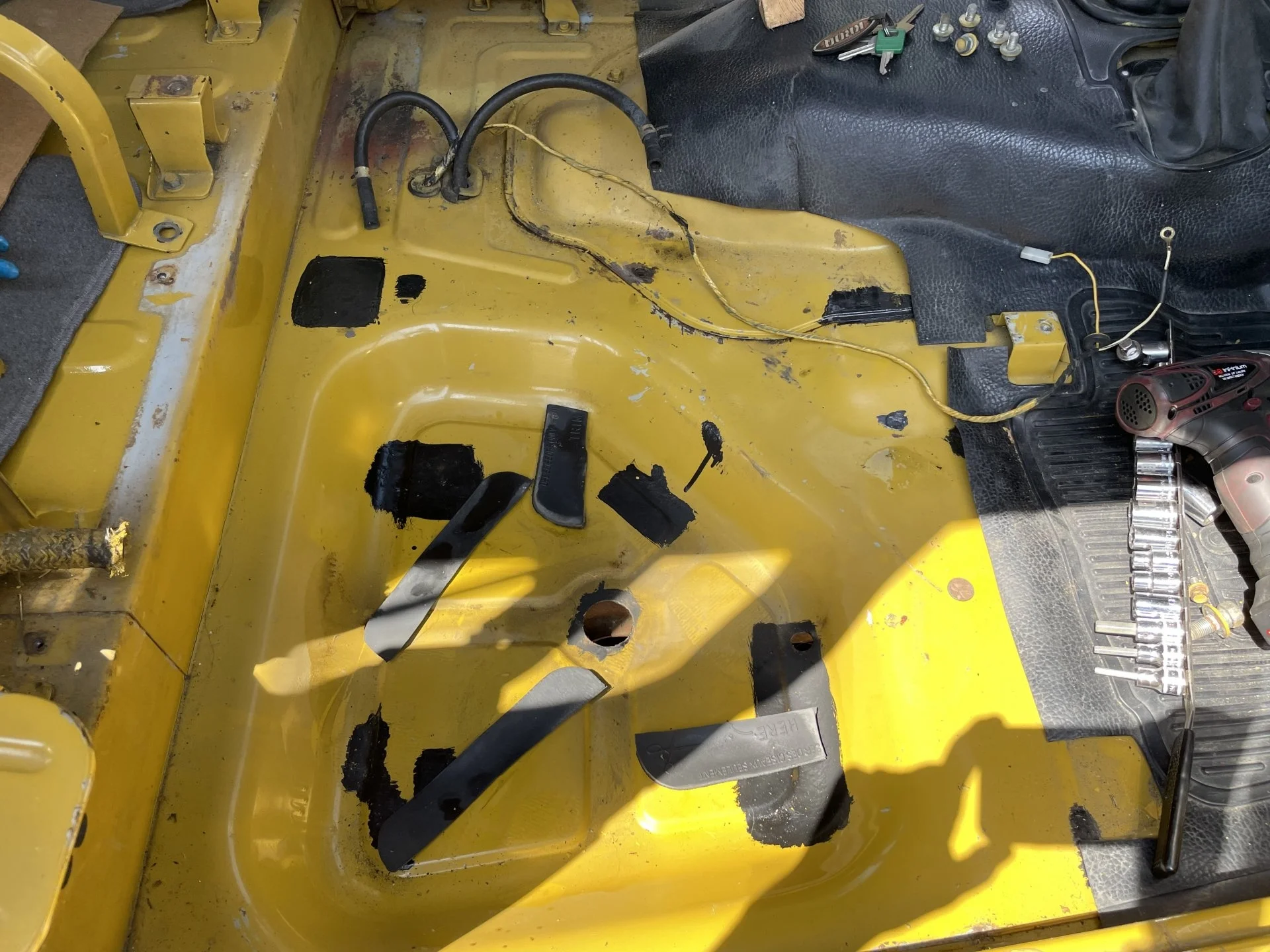

When I saw the truck last weekend, we could get it to get some gas in the bowl and idle for a minute, but no more than that. Same story when I got it here. I bought a carb rebuild kit with the intent of rebuilding the carb to correct it, and still have it. Will probably do it anyway - idles too high and the fuel cutoff solenoid seems shot or not connected due to some bad dieseling after shutoff. After more hunting discovered there was NO gas coming out of the inlet. That can either be a bad fuel pump, or junk in the lines. I verified suction from the pump at the fuel filter, so started yanking bolts and covers and so on to get the fuel tank out.
Someone’s been in here before. (Also note my sweet KROQ keychain. This STAYS with the truck.)
I had *just* dumped 2 gallons of fresh gas in it too, which ended up in a Harbor Freight bucket 5 minutes later. I blasted the crap out of the tank, drained as much of the varnish out of the tank as I could, blew out all the lines with compressed air, and let it bake in the sun for a few hours to evaporate off the water. Reinstalled, put more fresh gas in the tank, and it was idling perfect in the driveway with a rock steady fuel level in the bowl window.

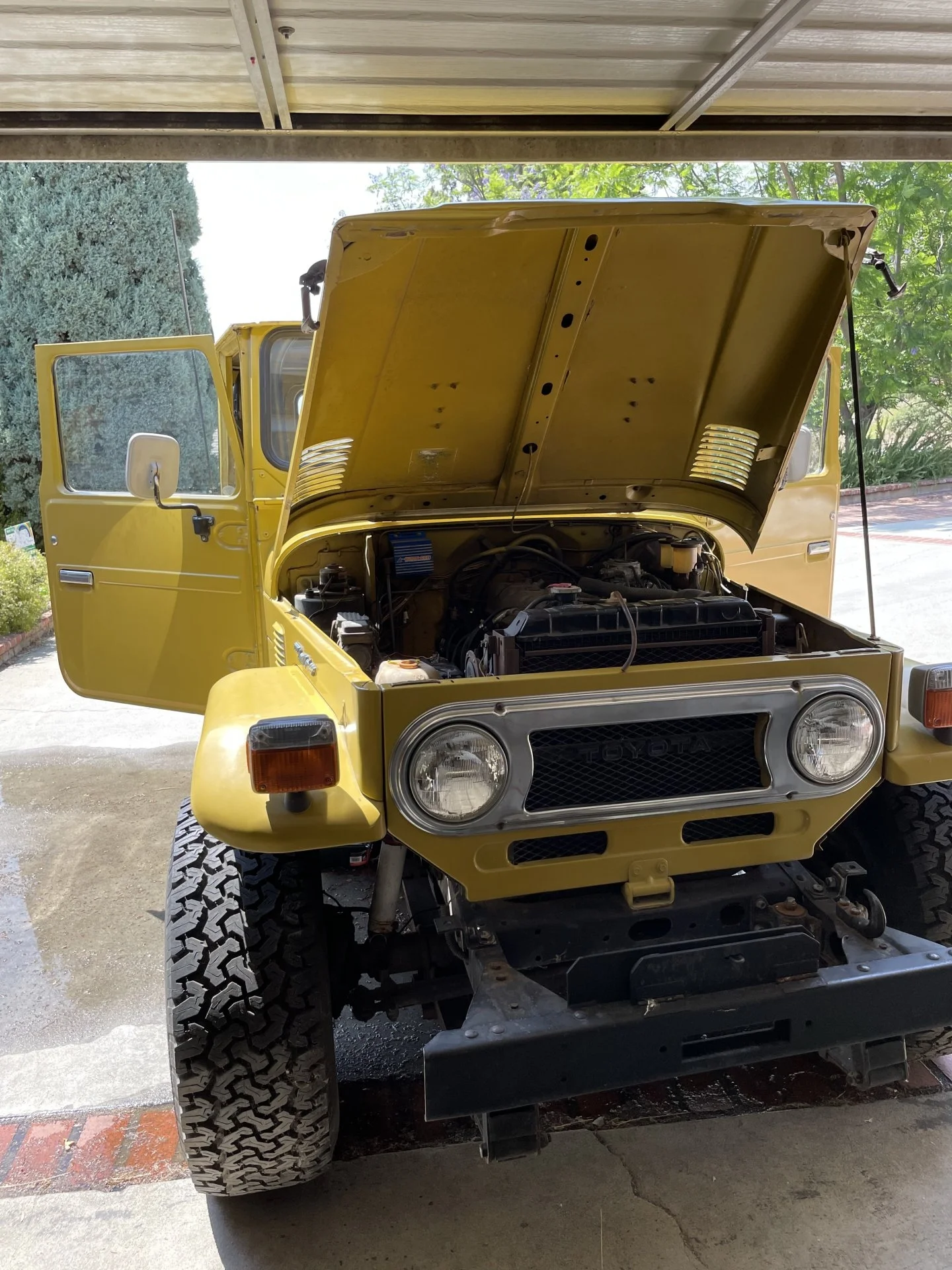

After that, I spent a little time installing the air filter, hooking up loose ends, and installing the cooling fan for the carb. That’s all in the car for now.

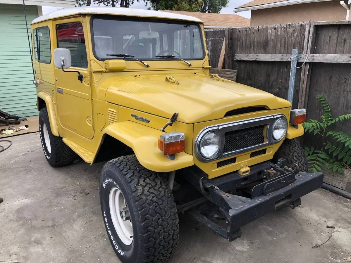

Paint? Why the heck would you paint that, looks like perfect original paint
The paint is an ok respray, at least on the hood, front fenders, rear fenders, and ambulance doors. Color on those areas though are spot on. The upper rear panels are a slightly different shade, also a respray. It's flaking / peeling off in some spots, particularly high-wear locations like the running boards (may not be the right term on a 40?).
If anything, I'd paint the upper rear panels to match the rest of the truck, but the two-tone look is sort of growing on me. I'm going to give it a wash and clay bar, then some mirror glaze and a polish. Then, realistically, probably leave it. :) I'll also want to replace those fender flares , these are cracking and ready to come off.
I do want to paint the bezel, am not excited about that chromed look.

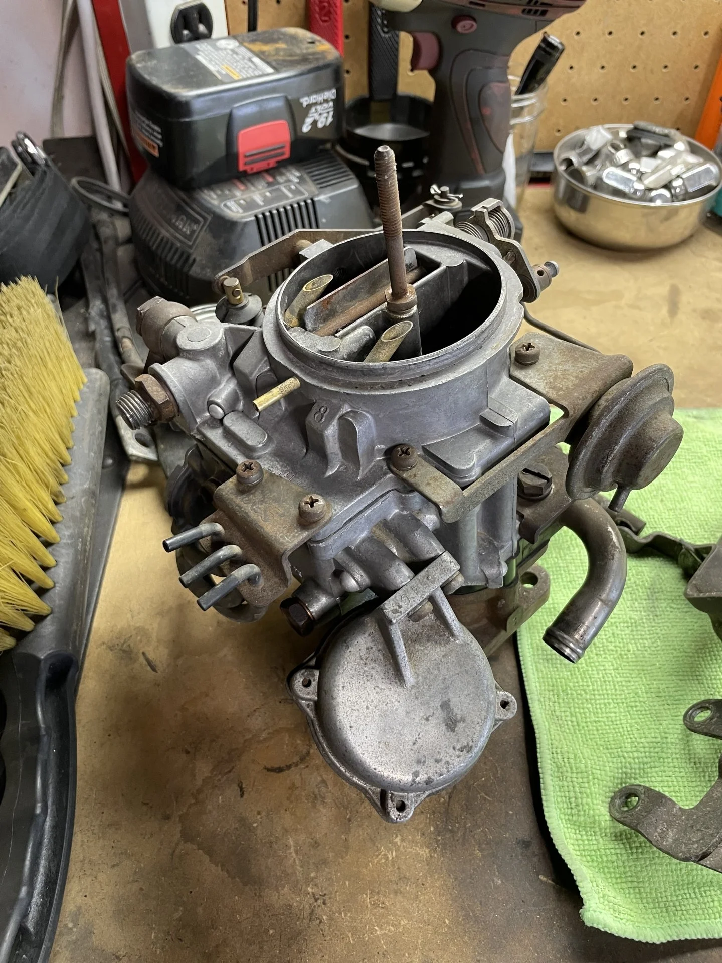

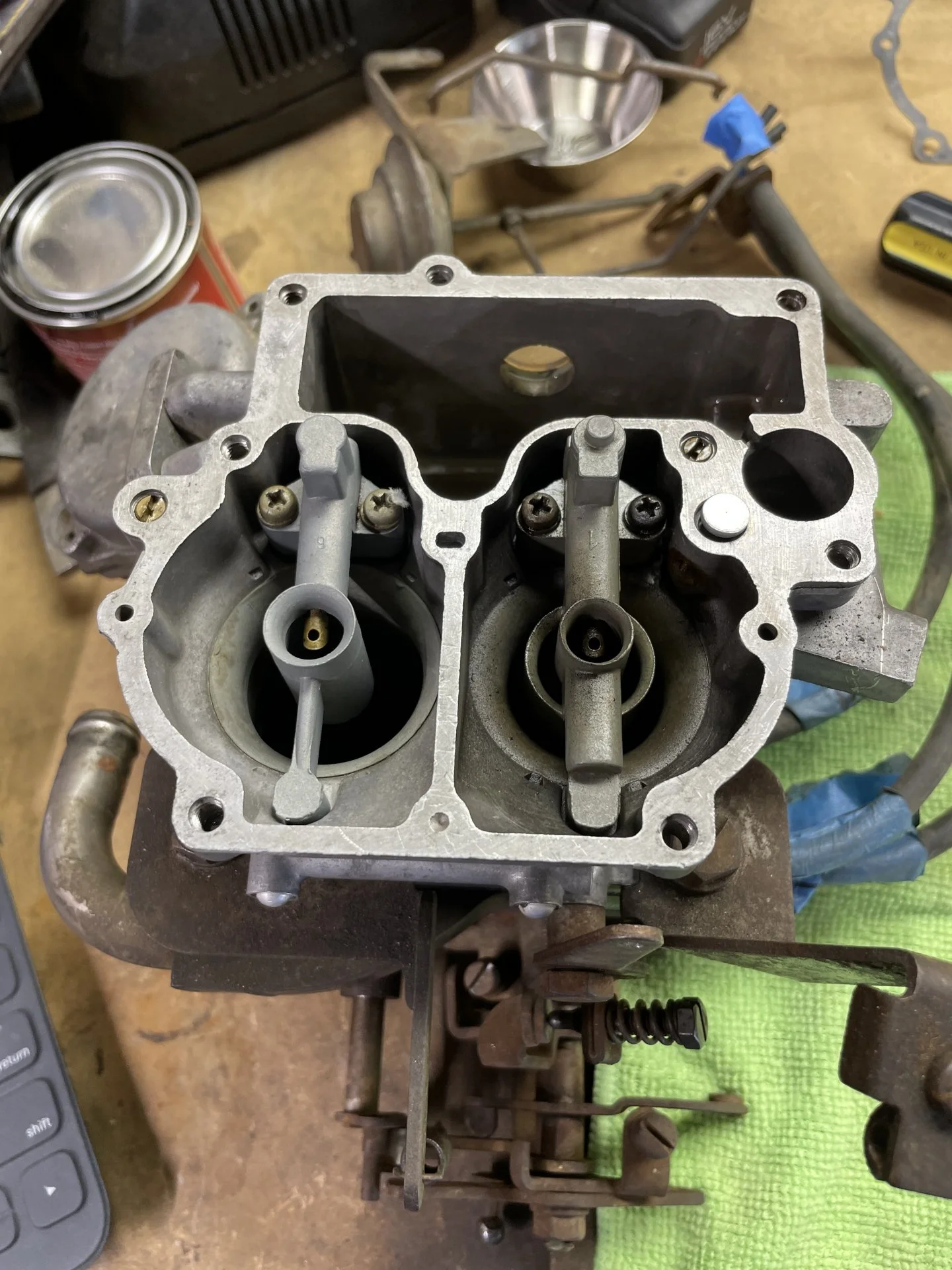

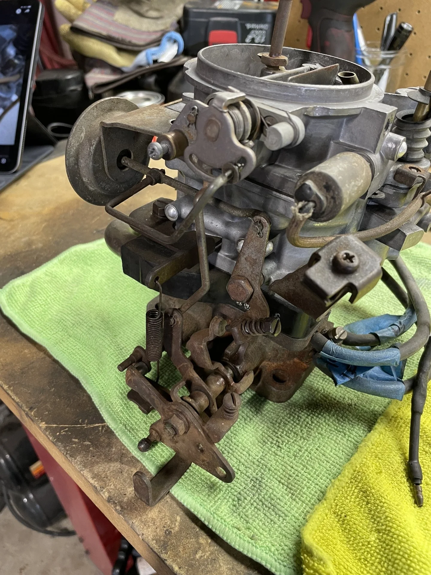

Getting after the carb rebuild today. Using Pinhead’s great video series as a guide. Vacuum hoses for reference.
Fresh off the engine.
Disassembly. Primary and secondary for reference.
Soaked everything in Berryman’s Chem-Dip, the bottom third is in there marinating, will pull it later tonight. If all goes well, may have it back together mid-week if I have time for a pre-check.
I also did the front and rear transfer case seals yesterday afternoon, and changed the t-case gear oil. No photos because I was trying to bust through in a short window of time, but got that done and no leaks this am. Input and selector seals will have to wait until I pull the trans for a clutch and RMS job, which I’m researching for later.
Carb rebuild and reinstall complete. Feels way peppier than it did before, now that the secondary isn't frozen shut. Tightened up the linkage with some washers, which seems to have fixed my fast idle issue, adjusted choke as well. Next step is to get a tach and vacuum gauge to set the carb idle mixture, replace spark plugs, rotor, cap, wires. May also pull the distributor and replace the o-ring, which is leaking. Check points, timing. Drove around the neighborhood again, no leaks from the t-case, which is good. Would also like to swap the gear oil in the trans, just for good measure.

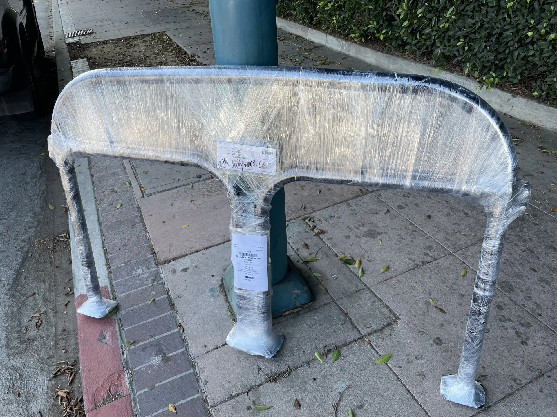

Also, big ups to @hyhpe for the roll bar!! Made it to LA in 4 days via Greyhound, awesome condition and a big THANK YOU to a great seller! This is currently riding around in the back of the 80 until I can find a home for it in the garage.

What's the plan for the roll bar? Seems like you had a good shape one in the rig already?
The one in there now is a full bar that covers the front as well. A PO welded the front section to the main crossbar. Good for hard(er) wheeling, but my plan so far is sympathetic restoration and refresh back to stock. I could probably cut off the front section and grind down the welds, but this one was super clean and year-specific.
Once I get to it, I'll post up the one in there now on mud if anyone wants it, either as is or happy to cut off the aftermarket section.

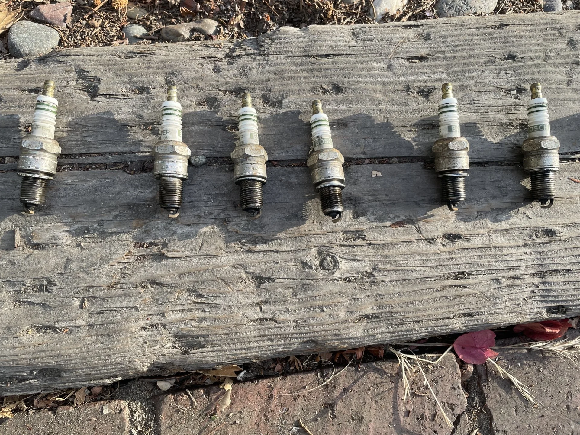

Now for timing... seems like the PO installed the distributor in a position that made it impossible to time to the ball. Had to pull each of the spark plugs so that I could turn the motor over to 7 degrees BTDC, painted the ball with some white acrylic for extra good measure.
Some relatively healthy looking plugs here, but will get replaced ahead of smog test. Arranged 1-6. 4 looks a little wet on the threads, will look at that more closely.

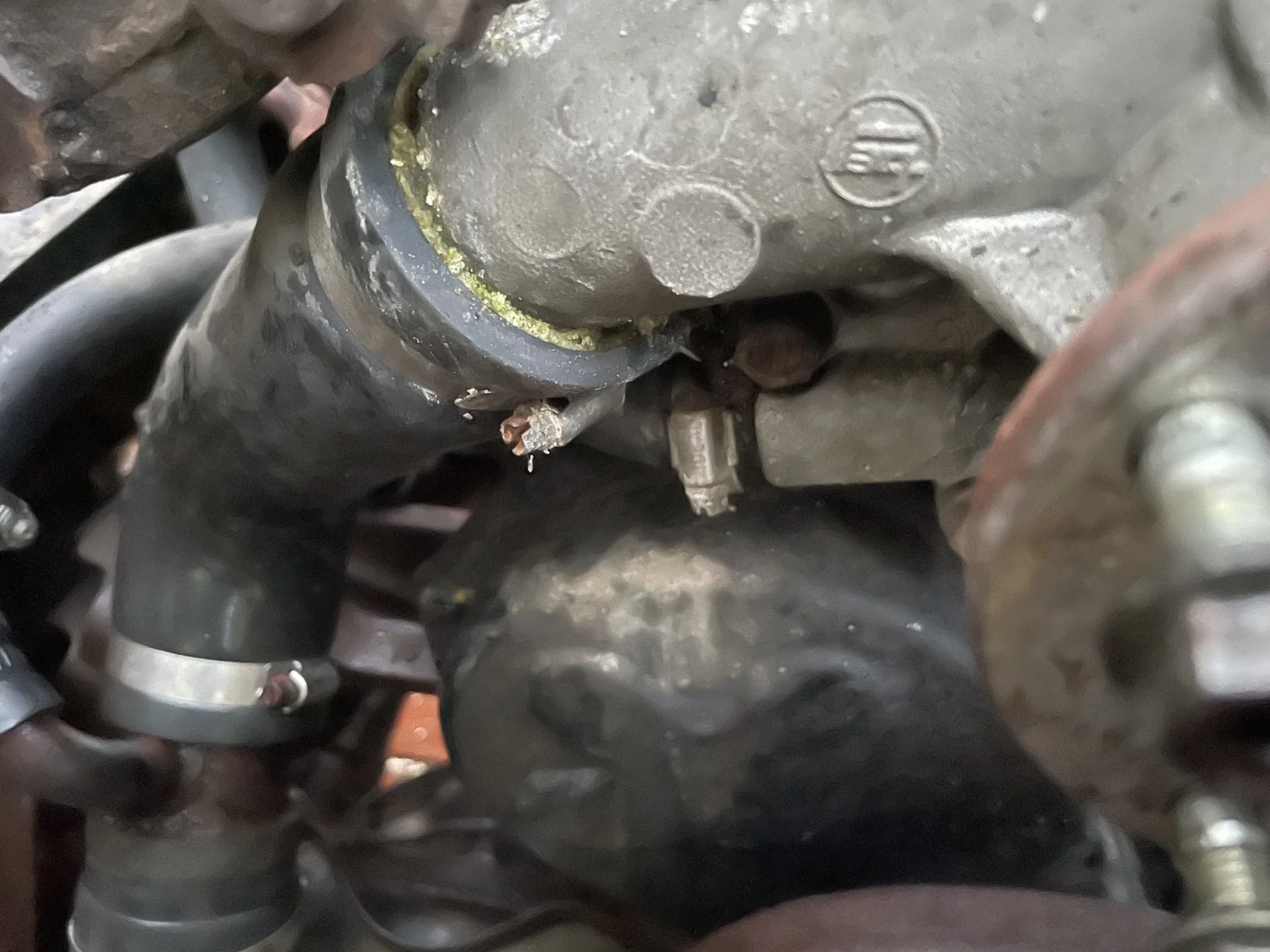

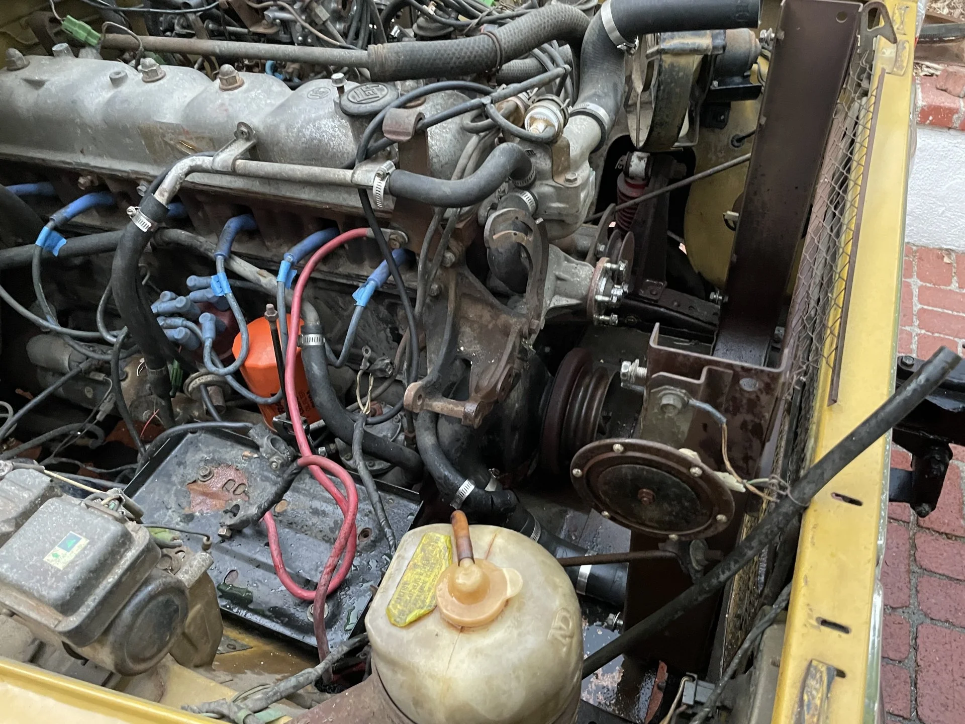

I sprayed the whole motor with some degreaser yesterday in preparation for today’s dismantling, which went fine. I failed to notice the petcock on the bottom of the radiator, which is GIANT, and just ended up pulling hoses off the radiator to get the coolant out. I was also able to drain the block, plug came out pretty easy. Coolant was nice and green, but not surprising as the PO just refilled it. Degreased the bejeezus out of my leaky steering box.
Glad I’m doing this, note the crystallization on the water pump. Pump flange is very loosey-goosey, might be the original pump? I also have a leak right around the timing cover, so I’ll be pulling this and replacing the cover gasket and crank seal. Evidently there is also a plate behind the timing gears that may leak, which I’m hoping isn’t my issue. If it is, well… it wasn’t leaking that bad. ;)
General view of where I left things this evening.

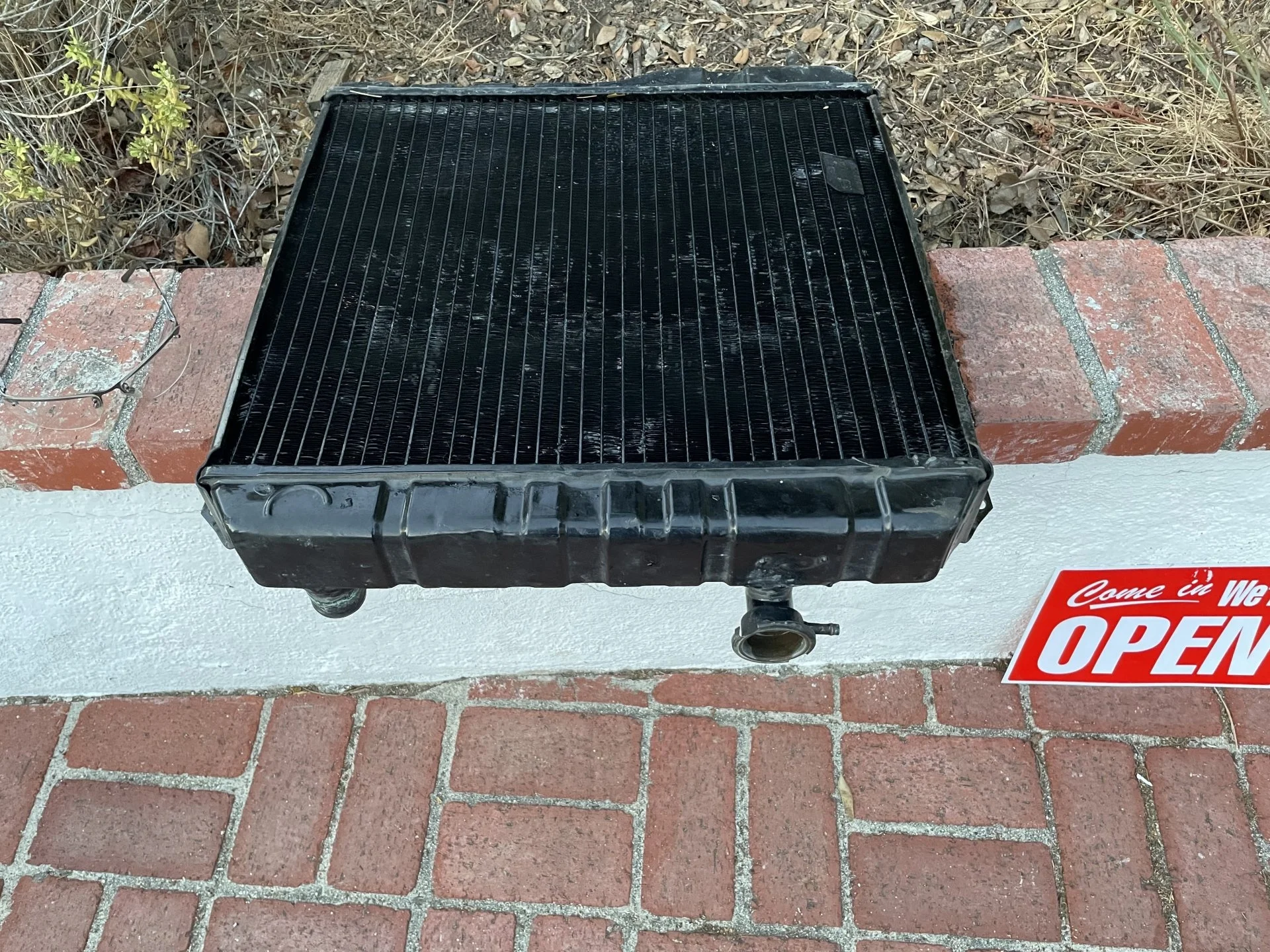

And the radiator. This looks new-ish, just flowed some hose water through it until it ran clear. My son likes to show that the Auto Shop is open when I’m working on the cars.
