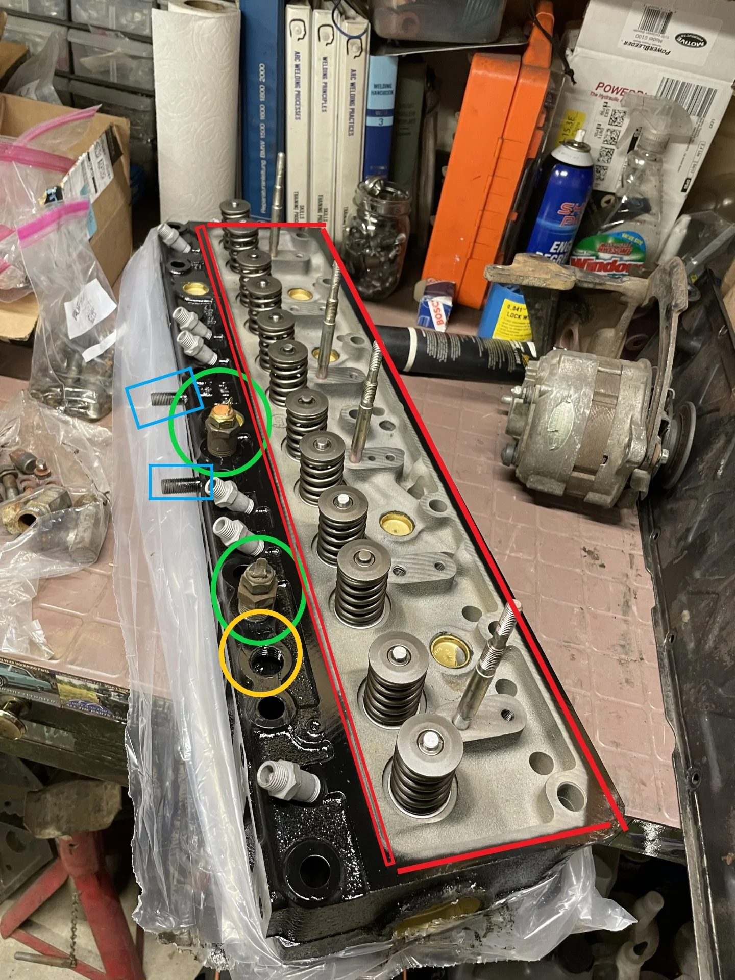

- are you chasing your FEMALE block ( HEAD BOLTS PORTS ) with a DIE before final assy 🤔
- this CALIFORNIA Spec. HEAD looks sharp , good job ! :D
- this may help you out a bit , i will ask @65swb45 / Mark to input here too on the SERSOR UNIONS TOPIC , because you have the secondary special THERMO one with the RED TIP ...... ?
- Remove ALL the Engine Enamel black paint in the RED highlighted areas , this if left in place WILL cause a valve cover rubber gasket leak real fast , if not you frst 100K test miles
- REPLACE these 2 studs for sure .........
- mark knows more on the sensor unions topics and the Thermo Sensors , BUT i do know that the SHORT varity shown with green pre-koted factory sealer installs
in the rear most union location , but in front of the water OUTLET

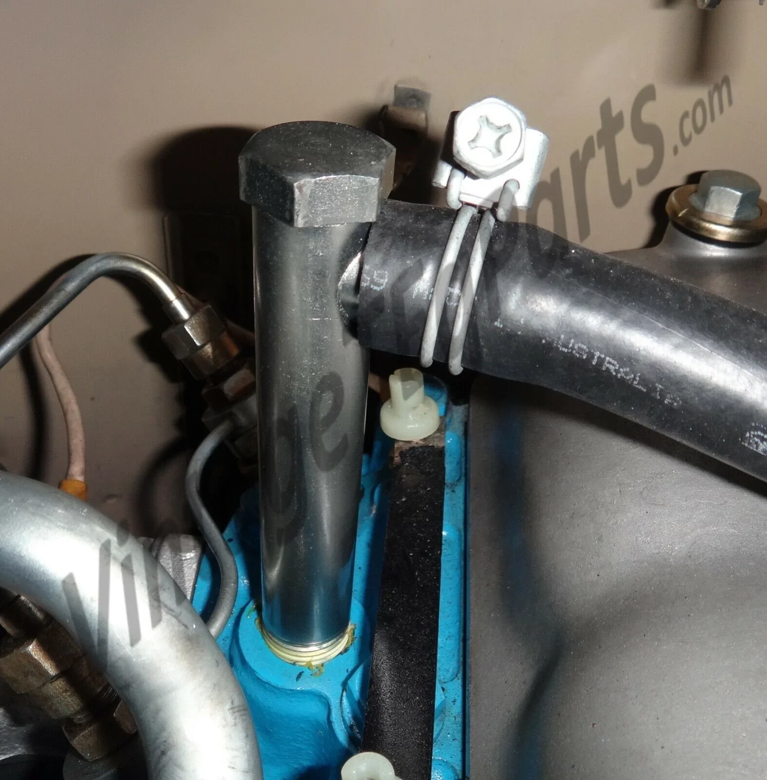

- Lastly , im looking for a TEST- Pilot of sorts for the LAST IMAGE , its a NON-USA NOS part oem toyota , and ill donate you one in exchange for photos ....:cool:
- it will TOWER right over a 2F valve cover / 5/8 hose bib and pipe JIS threads same exact as you have now / NO mods

not sure I would run a tap into head bolt holes--that will chew out the old threads and cause potential failure later--would think it better to use a good head bolt for this operation with some Kroil or such, followed by clean with an air blast and then a vacuum clean--couple of turns at a time
Ran a clean old bolt, with channels cut up the sides, in the bolt holes with brake cleaner a few times, fully drying with paper towels. I used a chase on the M10 in the 2002, which yielded a bunch of carbon and junk. That's been all good since January.
there are 3 main kind of TAPS i own personally :
- Common tap ( for making new fresh threads into a new smooth bore hole )
- BOTTOMING TAP ( has a flat bottom to go straight to the bottom of a fully TAPPED hole using the common tap above first )
- CHASER-TAP ( used for and ONLY to chase female threads )
matt
