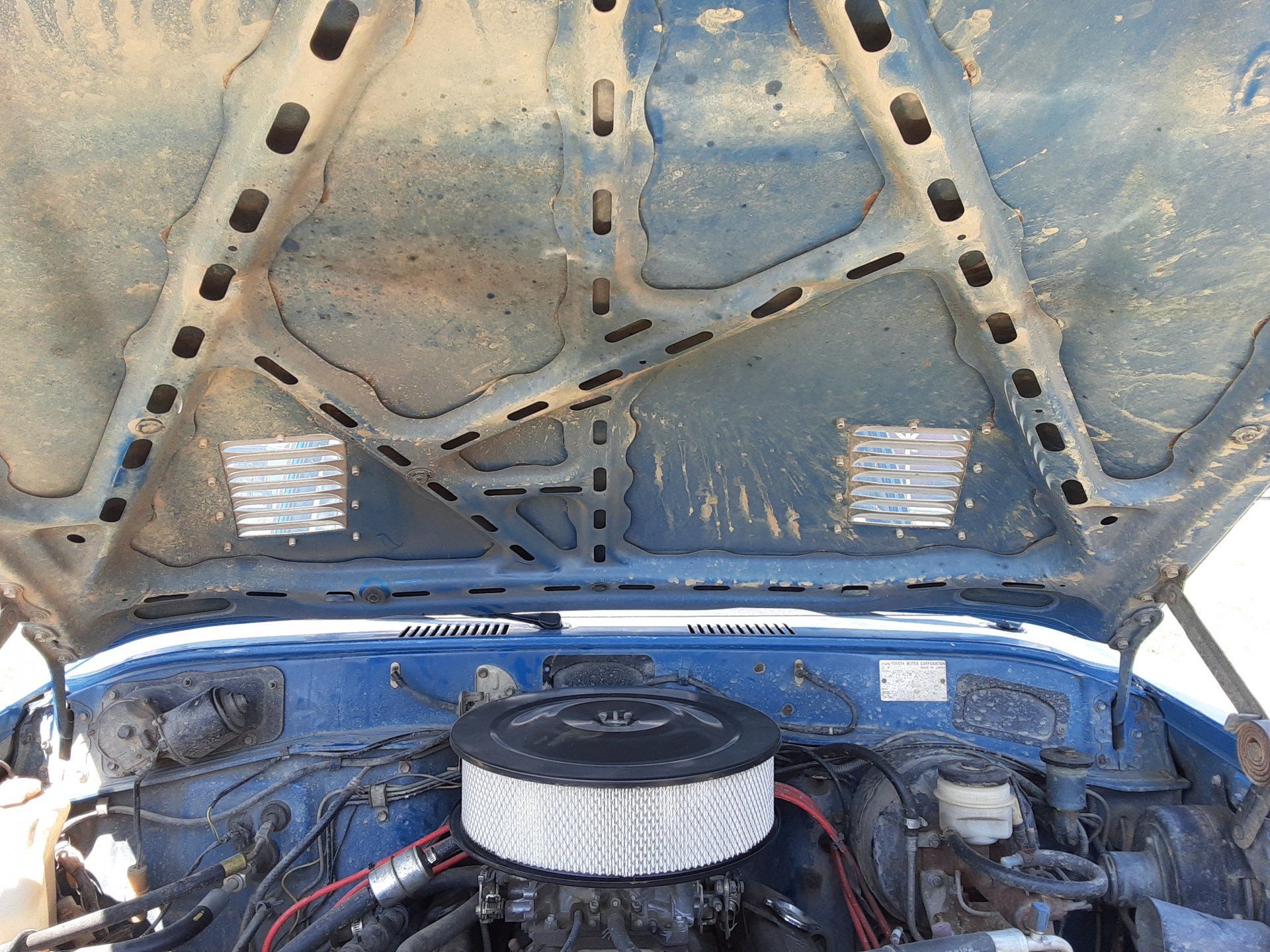

Interesting thought. I feel that hood vents would help a lot of the cooling issues with these trucks. That air needs to escape and bring the ambient engine bay temps down.
@POTATO LAUNCHER has some awesome vents on his 60 I was considering as well
Strictly based on on observation the “popsicle stick“ sized electric fan blades fail to compare to the canoe paddle sized Mechanical fan.
Even with duals it didn’t push a lot of air, now with the hood shut the mechanical fan pushes so much air I can feel it through the seams - a huge difference
Exactly what I discovered when I installed a the AC back into my SBC 60. Everything I tried from HD fan clutch(that just killed the gas milage and added a very loud fan to the equation), Aluminum radiator, water wetter all had the same results. As soon as the AC is engaged engine temps went into the red. Push the blue "turbo" button off and everything went back to normal. I could easily find the source of heat. I struggled to not cut holes in the hood but had no good solution. Thought about louvering the fenderwells but that would cause a whole new issue with water and road/ trail grime. I purchased a pair of louver panels off Flee-Bay and carefully located the panels to clear hood trusses and keep the lines as clean as possible with the 60 series hood bump.
Once installed the temps went back to normal and I have yet to see any issues.
Yes, I was not wanting to cut the hood but the end result is exactly what was required to remedy the heat exiting the engine bay.

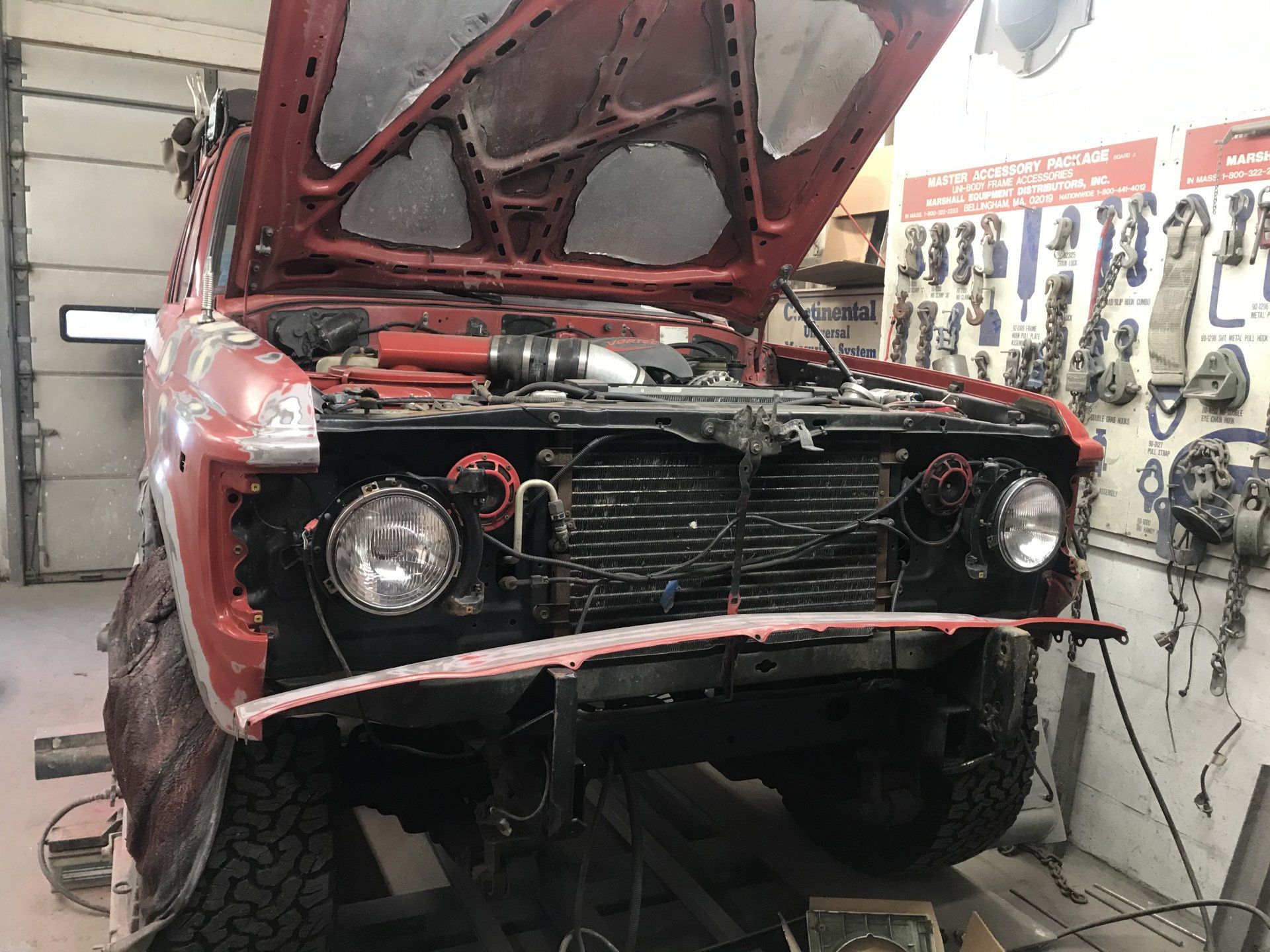

Slowwww progression at the body shop but these are all I have for now

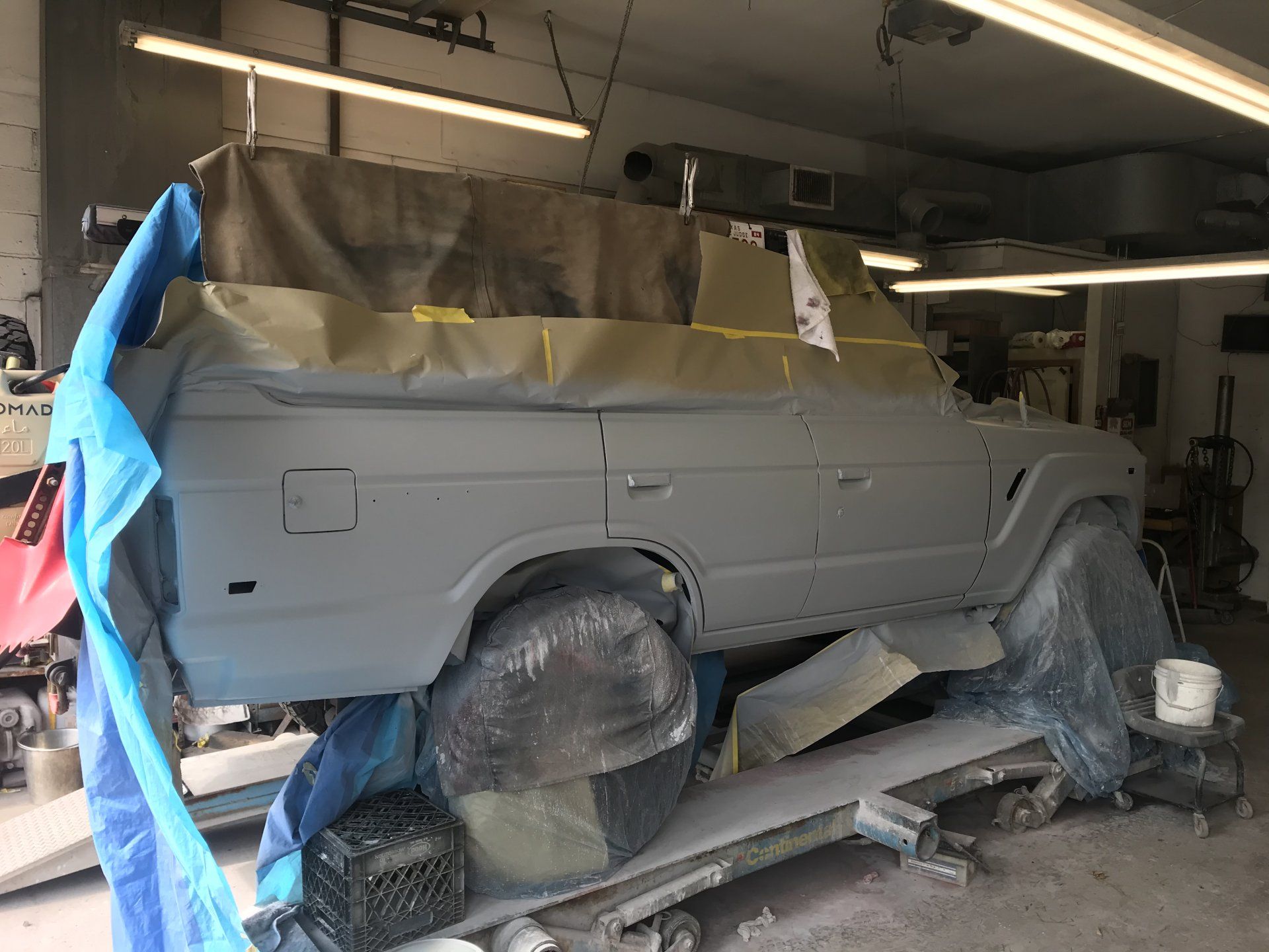

recent updates coming from them note that windows are out and the truck is in primer except for the roof.
Having them re-seal the gutters while they’re up there. Changed some little things to suit my needs and chose not to add new chrome trim on the windows and roof, it doesn’t last long up here anyways. Additionally, I had the headlight washer holes welded up and sanded smooth along with the mounting holes for the snake blinders on the running boards.
It’d be nice to retain that but the hardware is long gone and for the cost id rather have a super straight body with a few less holes for water to find itself in.
Fun Fact: There were 48 dents in my hood, almost mad I didn’t get a photo of that as it looks fantastic now and they fixed the bracing that was lifting off behind it. As a reward it’s getting two new struts to keep it steady

There was a period of time where the body shop choose to prioritize other projects over mine - a few weeks ago I saw to it that it wasn’t going to continue that way.
lesson learned: never let on to the body shop you have other vehicles to drive while you wait. Anyways - should have some pictures this week of some FRESH RED PAINT.
they’re painting my roof after the gutters are resealed and touched up, then pulling glass for the full shoot.
all that’s left to do is put on the Freeborn Red!!
