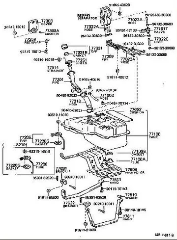

Tom do you perhaps have simmilar pic/diagram from the EPC to indicate the filler into tank and evaporater plumbing of the BJ vs the FJ ? I just bought a TOY "checkvalve" which Olive never had when I got her and I need to figure this out.Any help will be most appreciated. Sorry for the highjack Dan.

From what I can see, the tank, filler neck, and fuel-evaporative separator are all identical between petrol (FJ40) and diesel (BJ42) models (V for "van" models that is) of the BJ42 era. (Although the fuel cap may differ, but even then - I think only on some models and probably just to provide the word "diesel" and/or for "key-security".) The only real difference there appears to be the fuel pickup tube where the petrol model has the addition of a fuel-return tube that allows un-needed extra-fuel to splosh back freely into the top of the tank.
And this is what the EPC shows for that:

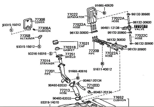

And here's zooming in to show the check valve that I think you're talking about on the evaporative separator:
I guess the line from that check valve is the one that opens out inside the LH chassis rail on a BJ-series?

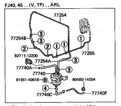

And just to really run roughshod over Dan's thread :D....
here's how the evaporative separator is piped in one part of Oz for an FJ40:

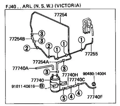

And here it is again modified to suit the beaurocrats (I never could spell that word .... is it right ... who gives a shhh...t) in another part of Oz:

That nsw and vic fiche is the same as US spec I think. This is because the bureaucrats (ha ha!) in the said Aussie states had imposed similar emissions requirements by this time to their Seppo counterparts.
Of course, Aussie bureaucrats have taken it to a whole new level today, where back then they merely idolised and envied the American bureaucracy. In true Aussie form, they punched above their weight until they outdid every other rational government.
