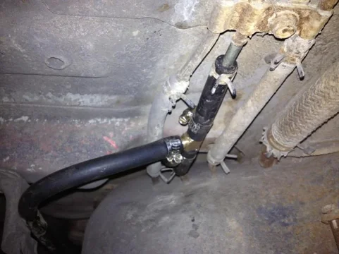

Finally got to run the return fuel line, I used 6.5mm hose as a temporary measure, while I wait for a BJ to turn up in the wreckers. I plan on using the same solid line and clamp the two together and then use the fuel hose for the shorter run across the tank.

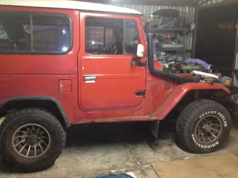

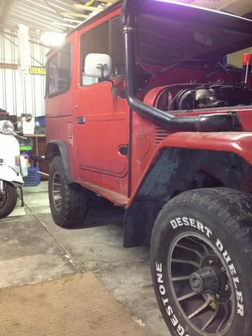

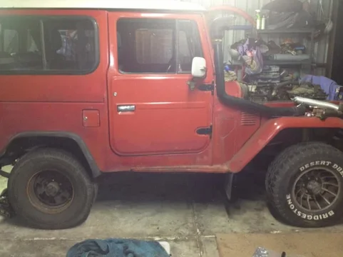

I know I'm getting ahead of myself, but I've put on the new rims while I'm waiting for a solution to the lower radiator hose.
Old vs new
Excuse the raised white
Profile
Forgot to mention
15x8 Delta Hurricanes
Australian Made
Similar to Cheviot Hurricanes

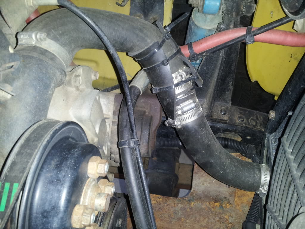

Hi Dan, sorry hope this isn't too late I was intending to get a picture posted before I left but didn't get to it.
I used the stock hose from the water pump but angled/rotated it up to clear the Powersteering pump, I then cut it to size and used a joiner to connect it to the hose that goes to the bottom of the radiator, the hose that goes to the bottom of the radiator is actually a top radiator hose cut to size.
Not sure if this will suit your rig as I don't have a radiator shroud to get in the way. I also noticed that your fan sits outside the shroud, there is an extension piece used on the 3B(or mine had one at least) that spaces the fan forward so it sits in the shroud.

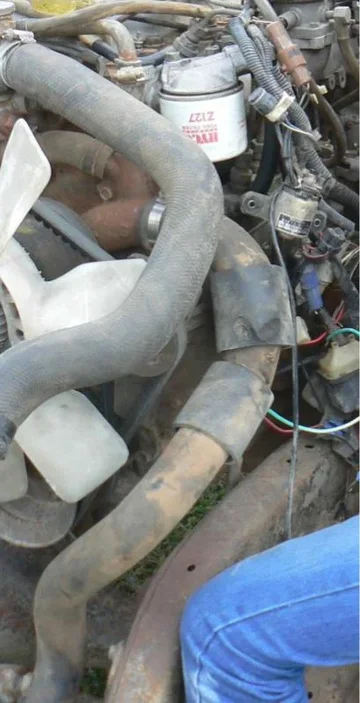

After having a look at a photo of a mates bj73 being pulled apart, I noticed the lower radiator hose.
So I went off to the shop today, and found it in the catalogue; should have it in my hands tomorrow and then try to mate it up to a second hose.

Ok - so the good news is that I have finally got the lower radiator hose sorted out. I needed to use the CH1925 hose above and chop it in half and then use the standard lower hose from the 3b and then join them together. While this is not optimal, it means that I can buy replacements off the shelf and have some for spares.
