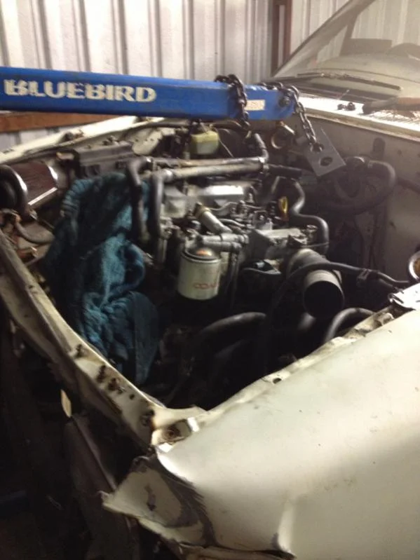

Was the snorkel on the Hilux just for show Dan?
Do you know what sort of condition the 14B is in? (I hope it hasn't been breathing gritty-air through that crappy engine-bay filter for very long.)

Tom,
The hilux snorkel was hooked up to the standard air box, unfortunately that air filter was in my 42 - perhaps a PO performance mod?

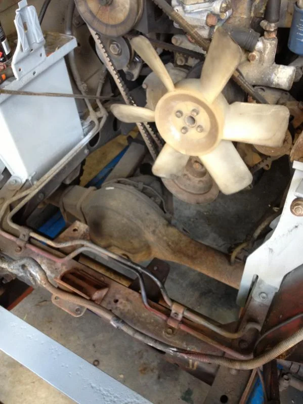

Can someone explain why the power steering line runs across the front and then returns?
For cooling
^^ x 2. Same on my BJ42.

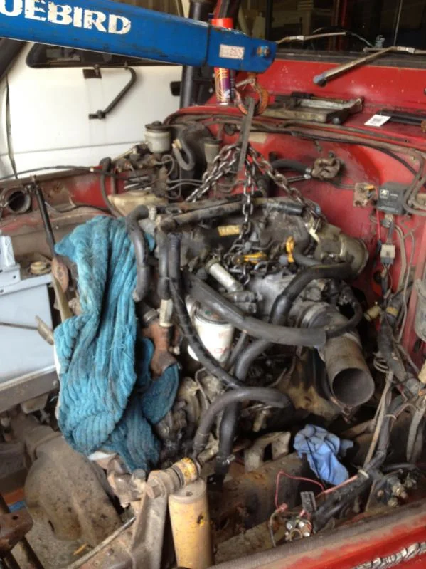

Quarter of the way - almost!

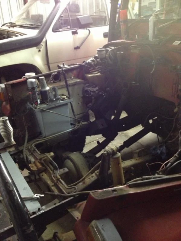

Have to pull out the second motor now. Had issues getting the 3b out. I should have removed the ARB bar so that I could have pulled it straight out.
Raises the question of how I'm going to get the 14b up and out - considering the 3" body lift...
It's too late now to cut out the front
Can see that I have missed the opportunity to swap in the H55f - but hopefully will still be able to get my hands on it on Monday.
14b is free from engine mounts and bell housing, ready to come out the front tomorrow morning.

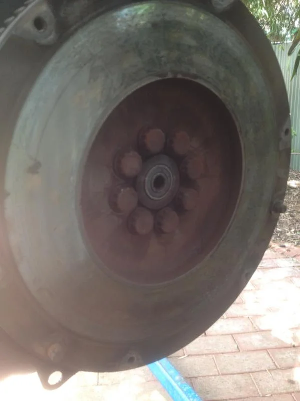

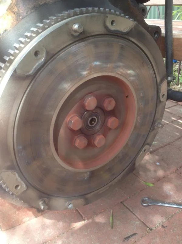

STUCK! The fly wheel is a different circumference. How do I get past this?
Used the grinder to smooth off a few of the high points in the bell housing. In hindsight, probably didn't need to as I found that the metal gasket (shoot me down for not knowing the correct name) was incorrect.
Now trying a test fit
Are you swapping in the 14B attached to the H41 only to replace it with a H55 later?
