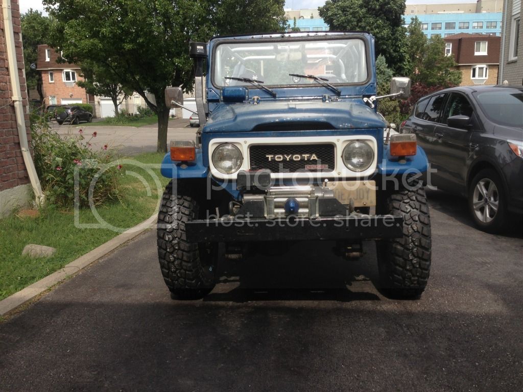

I just looked at a Ford Maverick with 33x10.5x15 KM2s - they look pretty good.
Now I'll have to see how much they are when I'm in the states next month and compare that to the price of fitted and balanced here in OZ.

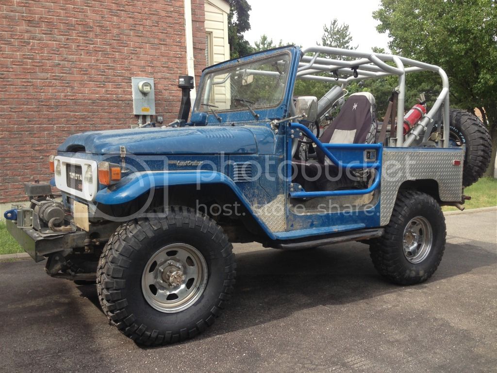

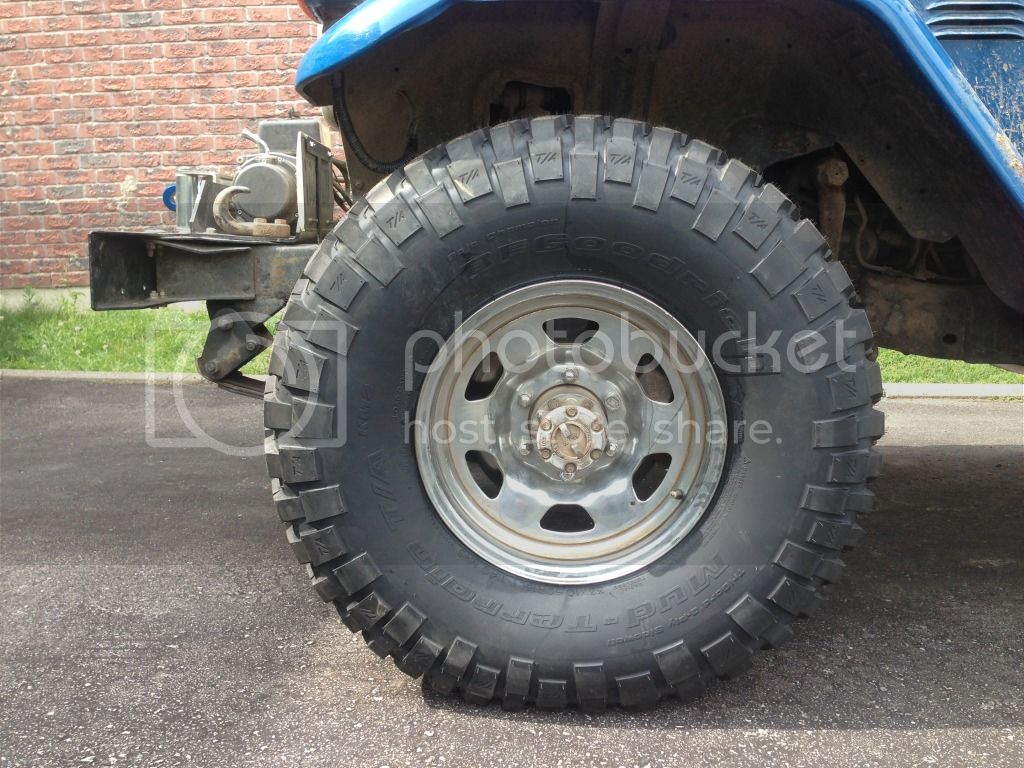

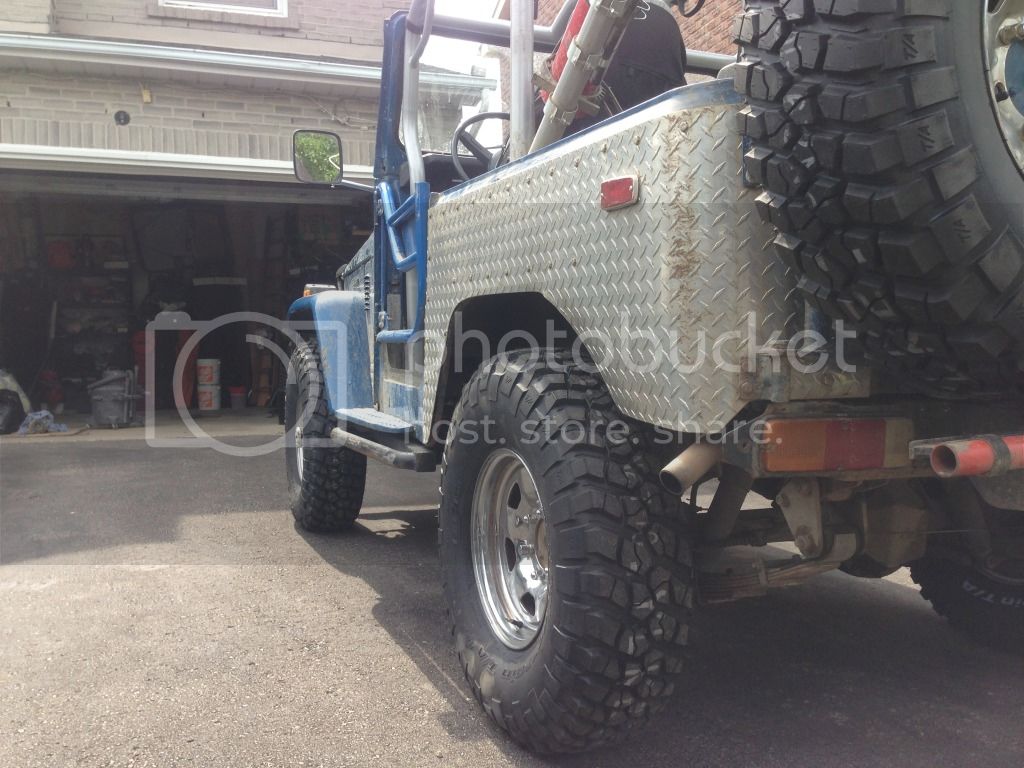

I just mounted a set of 33-10.50-15 KM2's on factory 15x6 chromies. They line up perfect with the body sides as opposed to my old BFG AT's that were 33-12.50's on 15x10's. I like the tall skinny look too and with the narrower wheel, it'll hold a better bead at a lower pressure when wheelin.
Thanks Noey, your photos make the decision easy. My rims are 15x8, so they'll look a little different.
Now I'm going to see the cost difference between buying in the US and shipping (plus fit & balance) and buying locally.

My rims are 15x8, so you can get an idea when you're here.
33x10.5x15 KM2s on 15x8 Delta Hurricane rims. Tray is currently off being pinted, that photo was a mockup.;)
