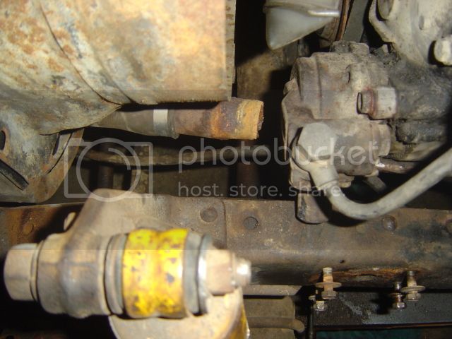

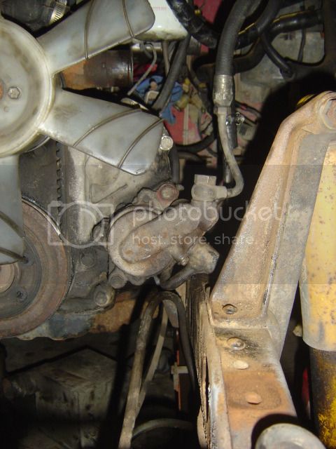

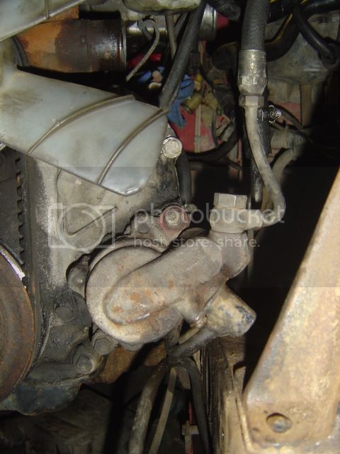

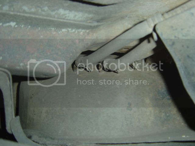

Power steering pump

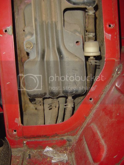

Can I get my return fuel line to here?

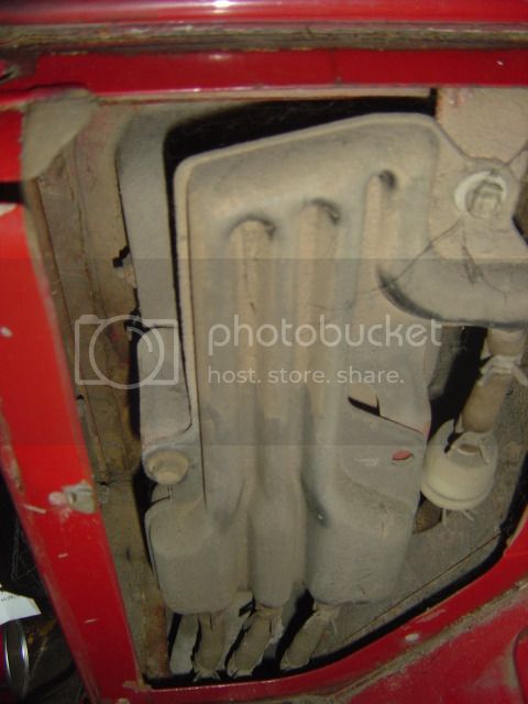

Is one of these a return to the fuel tank?

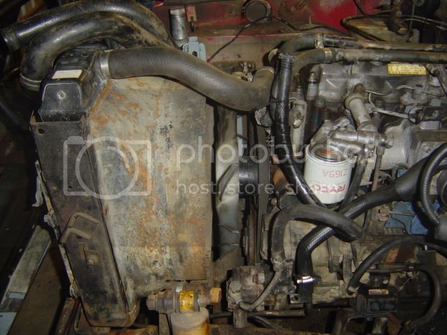

Will have to modify the fan shroud and work out some new radiator hoses.
Would like to see if I can put the P/S reservoir here
My first thought is what about using your old power steering pump and making a simple bracket to mount it where it was on the 3B? Otherwise, just make sure that there is enough clearance from the frame that you will not crush that line when the frame flexes off road.
That plastic bit on the driver's side is just an expansion tank but one of those lines is a return line to that tank so I don't see any reason why you could not tee into that. Chris K. would be a great bloke to ask about that or Locky. Email me if you need their numbers. Locky is intercooling his rig right now and is intimately familiar with the fuel system.

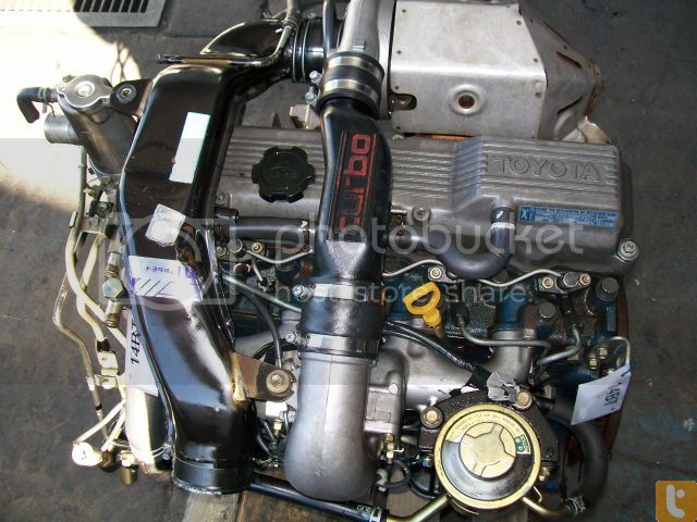

Whose 13bt is that in the photo? I want that engine!

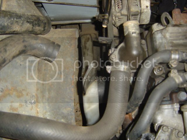

I have been able to swap the top of the thermostat housing with the old one from the 3b, (the top now faces the passenger side) so the top radiator hose is the standard one from the old engine - this is really beneficial, as I already have a spare.
The bottom hose is a little different, because of the location of the P/S pump. I have a couple of right angle hoses and connectors so that it comes up the side of the fan shroud.
I have temporarily setup the power steering high pressure line to run under the oil sump. This will only be there until I can get the local hydraulic shop to make up some proper lines/hoses.

Standard 3b radiator and hose (with 3b top thermostat housing)
Just realised that the other photo was pretty ordinary.
