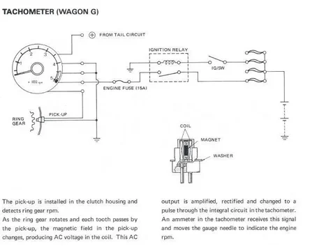

I think it works off the ring gear teeth Josh.
Well at least the tacho Toyota introduced in 1980 with the 60-series definitely does.
If so, it'll be out of callibration if the teeth numbers are different.

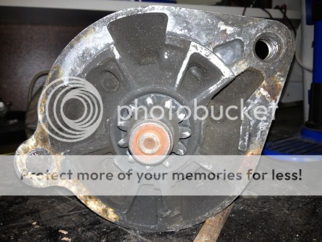

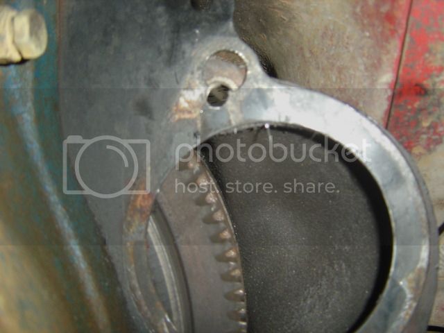

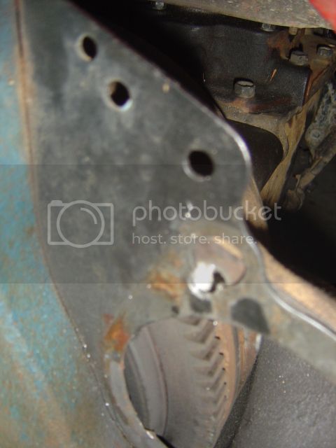

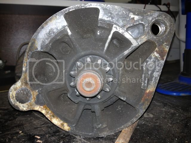

The backing plate on the 14B is different to the old one on the 3B, I could not swap the two over, so I left it as is, and have had to address a few issues as i found them.
I ended up drilling through the backing plate and then using the grinding wheel and cutting disk on the dremel, I elongated the hole to match up to the bell housing.
The 14B starter motor had one bolt snapped off. I don't have any reverse drill bits yet, so I opted to work out the issues with mounting the 3B starter.
The other thing I noticed was that the other hole on the 14B was threaded - this wouldnt work on the H41 transmission, as the hole that aligns with is also threaded. This lead me to think that it may have been done by the PO so that it would mate up to the Hilux bell housing.
I...........The 14B starter motor had one bolt snapped off. I don't have any reverse drill bits yet, so I opted to work out the issues with mounting the 3B starter.
Centre-punch it and then drill it out so the sidewalls are as thin as possible (without risk of taking away aluminium thread).
Then it should unscrew easily enough.
And here's some more info on the tacho courtesy of Toyota's publicity/training info when they introduced the 60-series in 1980:
:cheers:
