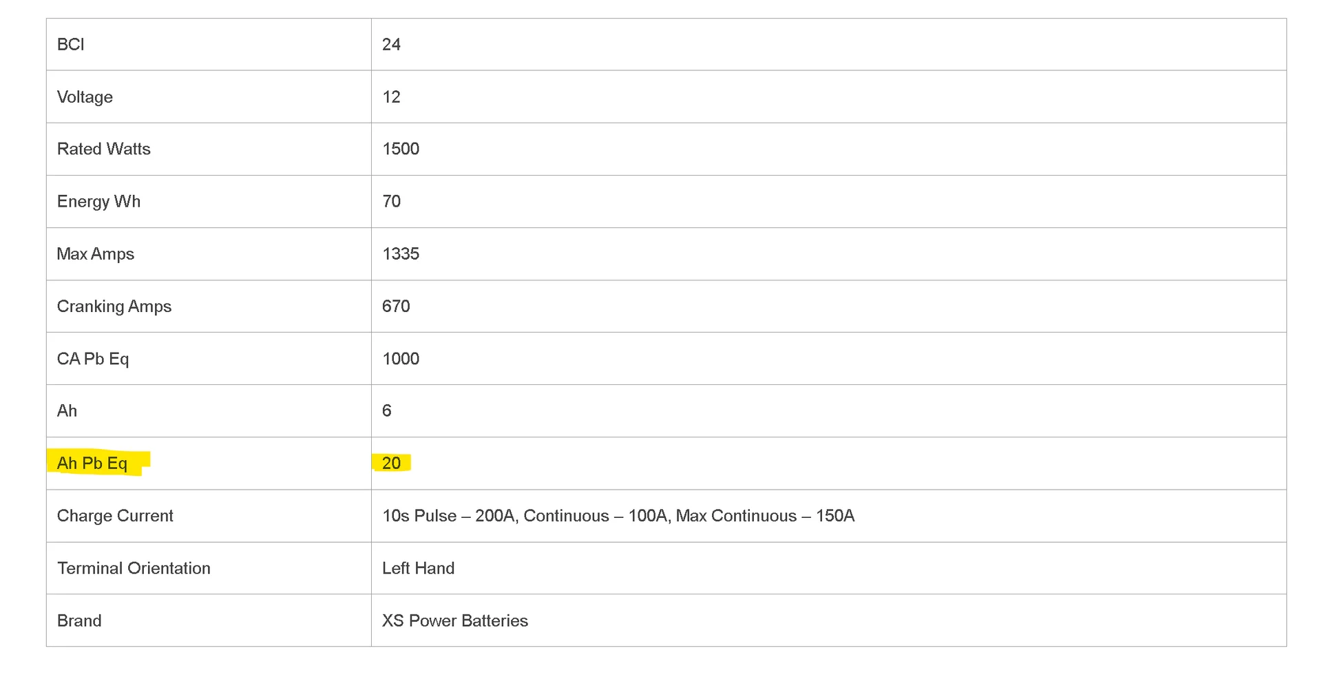

XS POWER LTO
BCI24
Voltage12
Rated Watts1500
Energy Wh70
Max Amps1335
Cranking Amps670
CA Pb Eq1000
Ah6
Ah Pb Eq20
Charge Current10s Pulse – 200A, Continuous – 100A, Max Continuous – 150A
Terminal OrientationLeft Hand
BrandXS Power Batteries
A 6 amp hour battery? That's basically nothing.
A 57# 6aH battery?
Gotta be a typo. 76aH stated separately.
edit:and yes, it seems like an option for deep-cycle purposes. I use AGM's for the same purpose. So far so good.

ok so to my understanding and yes they are rated differently.
AGM has only about 45-50% useable power
LTO has about 90-100% useable power
they do list the LTO as Ah to Lead Acid cell equivalents as
Ah Pb Eq 20
