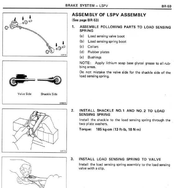

While mounting a new LSPV and spring (arm) to the old painted bracket, I discovered that I don't understand the FSM.
Can anyone help me understand? see pics.
On page BR-59, Step 3 says to install spring to valve using a clip.

Later, the manual says Confirm the valve piston moves down smoothly. How do I do that with the rubber boot in place?

i think you answered your Q about step 3, they are calling the "arm" a load sensing spring
Yes, the long arm is officially named the "spring".

I used a clip on the rubber boot but also ran the bolt through the spring and mounting bracket
Thats correct. That round clip is what the manual refers to. (Well, to be picky: It doesn't say that is the only way the assembly is attached to the LSPV.
Not at all. The sequence of the manual is odd here. I removed the clip and pulled down the boot yesterday in order to check on the pin as a regular maintenance. A real PITA to do with the LSPV in place and lying under the car with no lift...

Probably you should look into a career at Toyota to write manuals. (But you are 30 years too late to improve thisone) 🤣

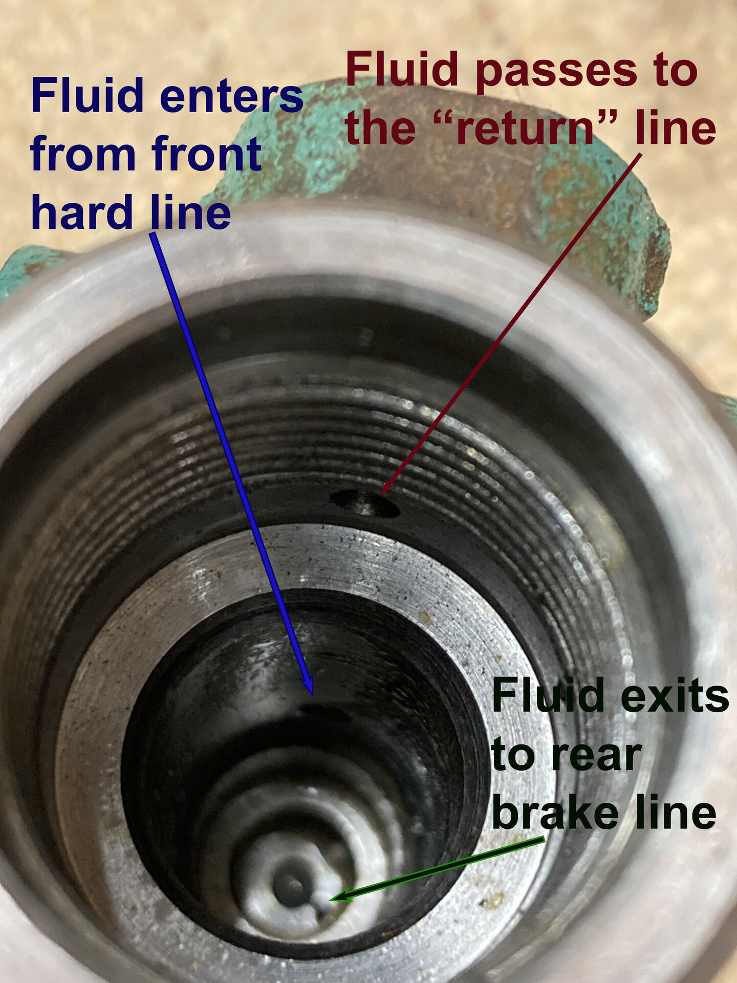

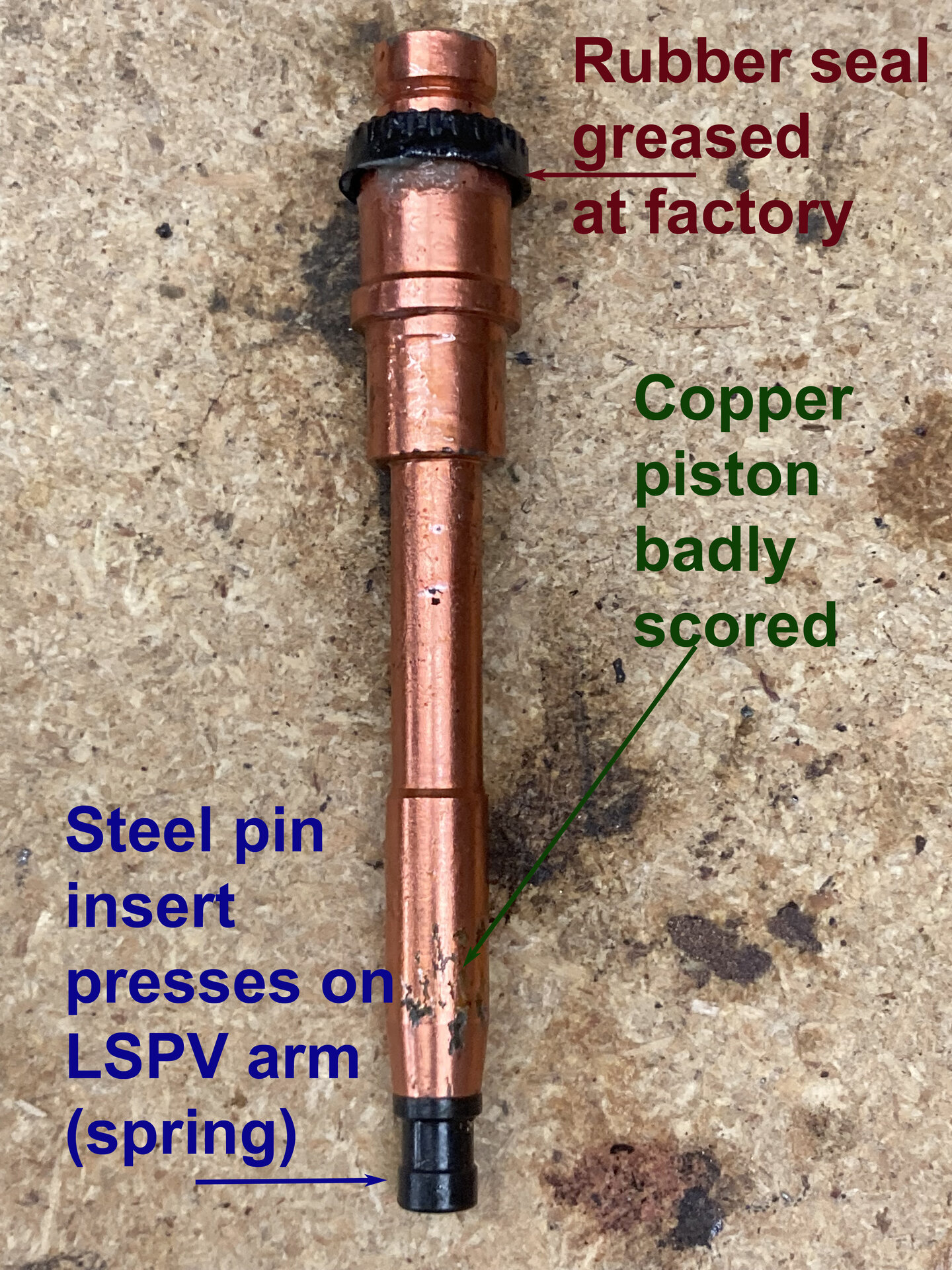

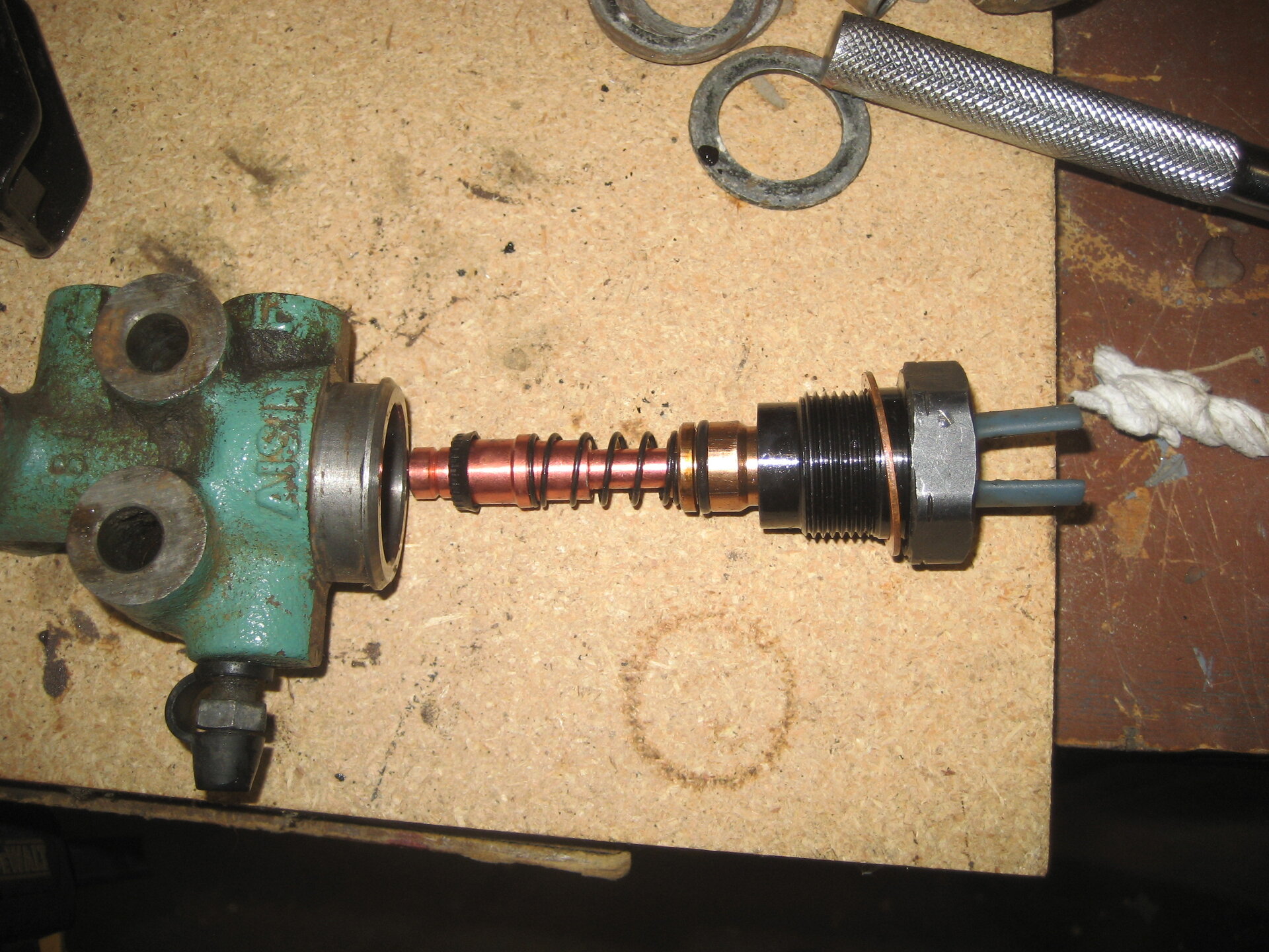

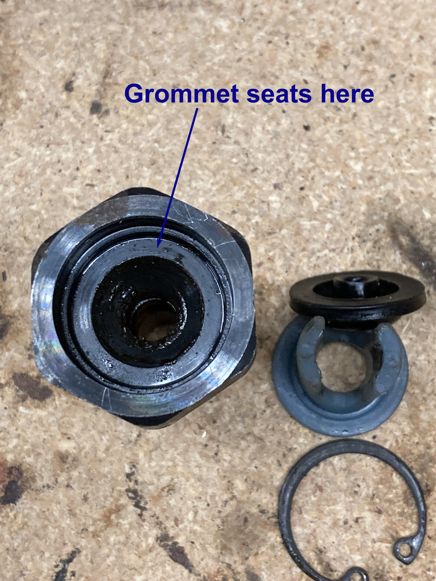

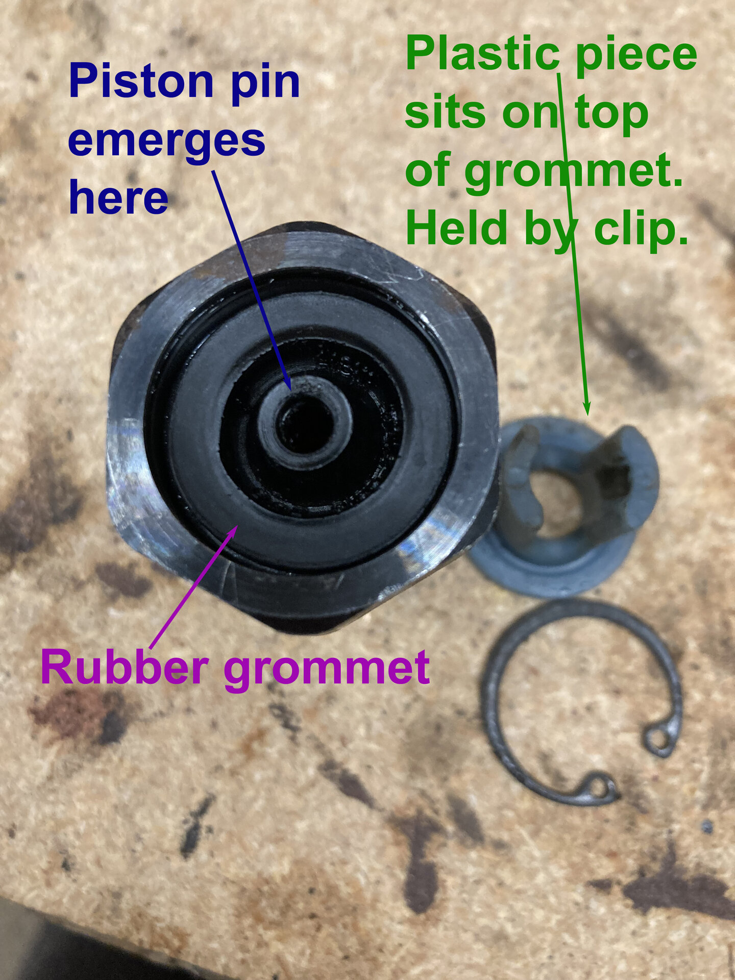

I took the old LSPV apart to see what's up. I am still not sure how fluid moves around in there as the piston slides up or down.
Thanks for the breakdown of some of the engineering wizardry they created here in this proportioning valve.
