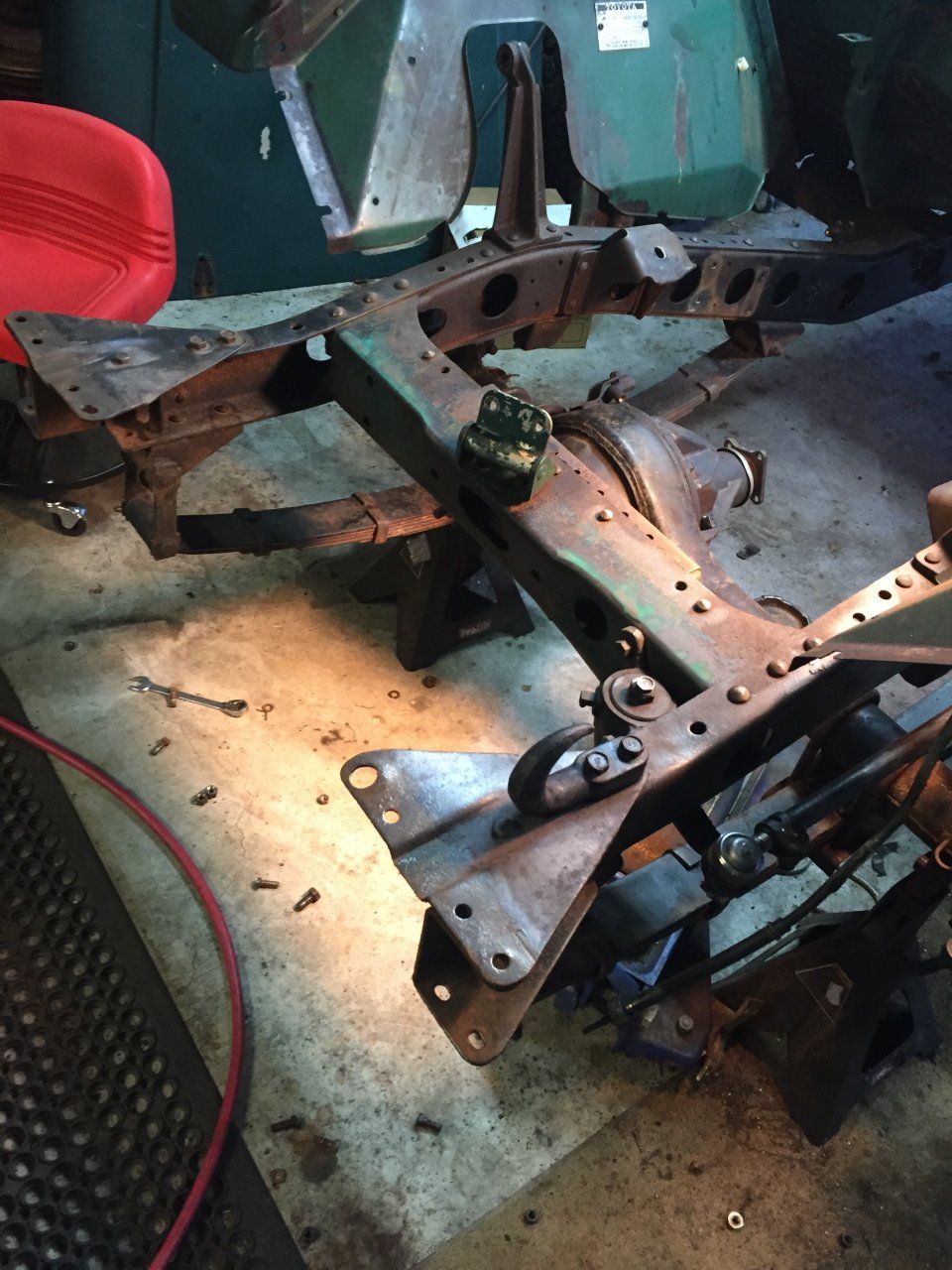

So. Lots of progress today. Removed all he steering links and cleaned and Pinter. New tie rod ends all the way around.
Also removed the heinous front bumper with that beat up trailer ball.
Finished cleaning up underside of body and rust treated the front area of the frame and under good stuff that had a little rust. Under coated the whole under body and painted the back 3/4 of frame.
Should be ready to start reinstalling brake lines and front end by Thursday.
Here's a couple pix.
The phone camera flash is making it look a little gray. But it is indeed black.
One more coat I'll be good.
Need to adjust rear drums to get cover on.
Lou what kind of undercoat and how many cans?
duplicolor pro. 10 cans. theyre all about the same i think.
i started with a can of rustoleum. because thats what i had. bought 5 cans this am at autozone. went back, they didnt have any more of the dupli pro. but had regular. i could tell it sprayed a little different, but its not noticable. and it's under the truck
