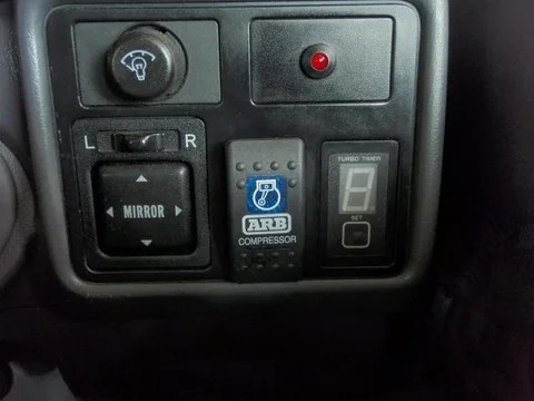

I use an HKS which has worked really well. It is installed into my ashtray for complete concealment. HTH. :cheers:

Mine will run on pre-set cool down times (seconds-minutes) or an auto mode based on temp. A quick trip to the store won't cause it to idle but an hour on the highway might have it idle for a minute or more. (though you can overide anytime) Nice features.
Only idendtifying name on the unit is ULTRA.
