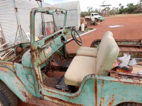

well punters its been a few months since ive had a chance to tinker. however declared yesterday sunday and in the mid arvo wandered out to the back bay with a few beers. didnt do much mind you; just cleaned up a bit. back bay ptojects tend to become a dumping ground for crap the moment i look away. sorted all this and pushed rusty outside to sweep up the shed. a mate has given me some 64 seats that have been covered in canvas and perfect for the job at hand. test fit these. arent they delightful!
