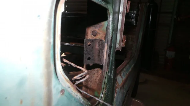

changed tact a little. my oxy set needed to be dragged 50 yards back out of the weather so found a small heating tip and tacked the windshield and softop bow mounts. these all got a heat, spray, few sharp whacks with a copper drift, reheat and respray. my only broken bolt remaining on rusty is a tub end bonnet hinge and it annoys me greatly! patience. (there still a few po ones but i have sorted most of them).

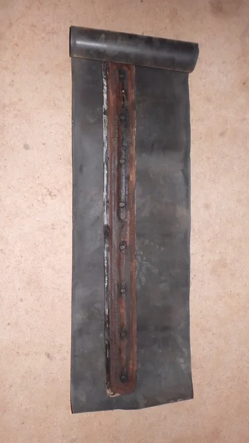

wandered through my local free car dump week or so ago looking for windshield rubber. reckon i had a win with an old daihatsu cab chassis destined for the crusher. very toyota oem looking. corners and height are perfect but a bit narrow. hoping to cut in a piece from the rear window rubber to gain the correct width. all very rough but might do for now; i have a budget to consider!

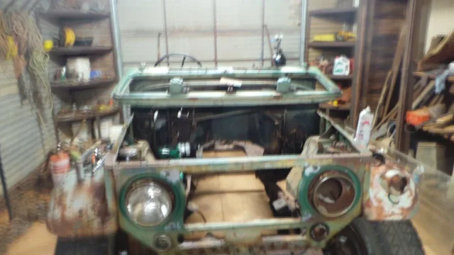

new look. got the bows off and screen folded down. lots of heat inc the screen hinges. broke a couple of bolts; still got one to get out.

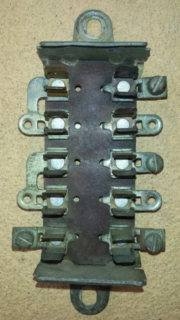

some assembly required.
had it plated since i figured the terminals were all loose anyways and it really wouldn't do any harm. now just need to find correct rivets and re-rivet terminals back on.

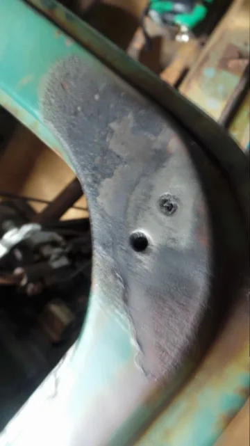

got a few little things done. mounted my under screen vent, not perfect; but looks mighty fine if i may say so myself!
have a little issue with the control knob for this; it has been po half unscrewed and very stuck there. all my usual tricks have failed to budge it so far and dont want to risk damaging the plastic. this means the vent wont open fully (and also looks wrong without the blind nut that is supposed to be there). anyways doing the job in a fashion for now. may tinker further with this down the track.

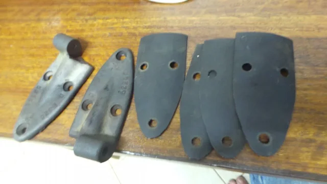

which brings me to BONNET HINGES. mine long ago snapped through the hinge pin who knows about these????
i had always kinda assumed that the pin must be a loose fit in one side of the hinge and threaded into the other? now im not so sure. both parts have the same BJ25 52251 part number cast into them so thinking the number should be different if one half has a cast thread? my 65 parts book lists nothing more detailed than the hinge assembly in its entirety. perhaps the pin is stepped to allow a tight press fit on one half and loose fit on the other? alternatively the pin is straight and one side of the hinge is drilled slighty larger. anyone know any of this for sure???
got one of the 4 pin section out after a lot of heat. (also made up some new rubber gaskets)
also noticed that the number stamping is different on fj25 (and rusty61) compared to later versions. (and then post 65? are a different hinge completely). i dont really have any serviceable pre 65 donors that arent already earmarked for something; and in any case running the non correct number just wont do!
so i really want to resurrect my original hinges. this shouldnt be too hard if there is no thread to deal with. anyone input on this one greatly appreciated.
