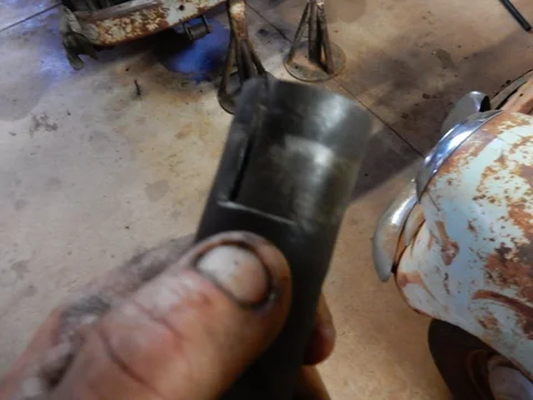

- finally, this groove near my fingertip... supposed to be an o ring? about to see if my parts book thinks so. thanks.

And yes there is a o ring on the top part of steering box shaft.

then noticed this wear and crack on my original steer sleeve (from the column shift assembly being loose) so pulled donor sleeve, the stick shift clamp and firewall boot.

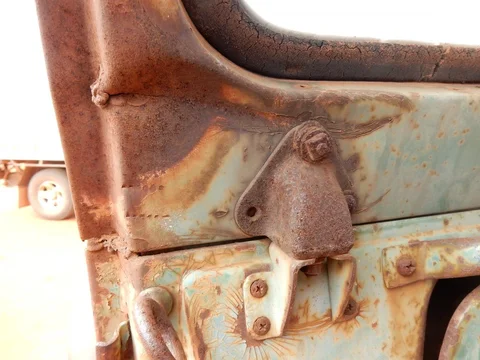

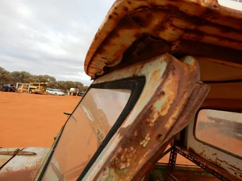

have been thinking for some time that this pretty much faultless windscreen surround belongs on little sister. surround on little sis has been bent, butchered at the top and generally stuffed with so is the perfect swap. started thinking sooner rather than later; may be better fix than putting some sorta glass into this one. little sis pictured:

have been heating everything repeatedly so this is an easy swap in the future. all the screen hinge studs etc. got these out,cleaned threads and replace with plenty antiseize so they good to go. interior mirror and wipers the same.
