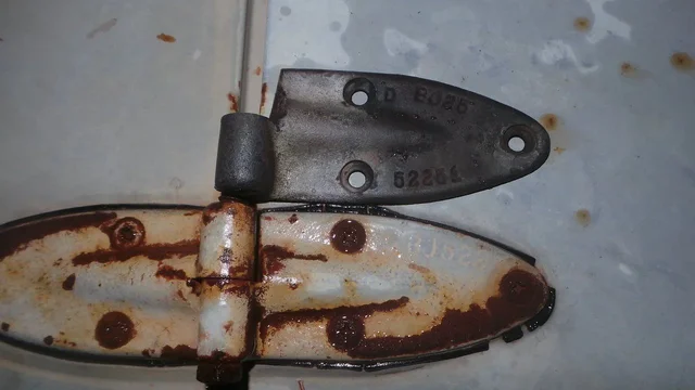

rusty61 hinge pictured loose next to a 64. no sure how visible the numbers are in this pic but it might give you the idea. dont mind the visible bolt head; a po mod i imagine. most my stuff has this mod in one form or other and is this that led me to assume one hinge half is threaded. i just hadnt ever really studyed this stuff before.
believe this to be the correct oem look regards hinge pin.
wondering if the pin is 'stepped' or the holes slightly larger on one side to allow for movement? reckon i can drill these out but havnt got to it yet. its been all about wiring. got fusebox seperated; tho complete PITA!

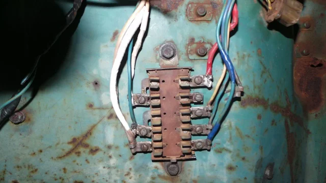

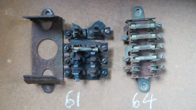

donor 64 fusebox fitted. had to join it where top light circuit had been cut to bypass the fusebox. also tape up a little sun damaged wiring and etc.
not very pretty but do the job. trying to save all the original harness and just tidy up where i can without doing any further damage. feel im making progress; and learning a lot as i go which is fun. small steps.

Mine were sheared off at the center so I redrilled and used a 5/16 stainless pin. I'm guessing one side was pressed or knurled.

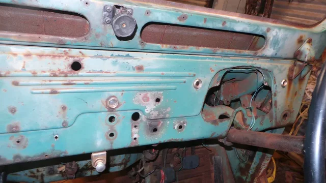

anyways tinker tinker under the dash. got the handbrake assembly out. was very seized at the top pivot (marked). complete PITA because the right mount bolt was hidden. couldnt really heat this pin under there with the wiring. heated the mount bolt from the firewall side. a win anyways

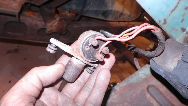

mr hdjtachtig - these are my mystery wires. thinking perhaps they used to go to the 4wd warning light? above the FD knob?

Mistery wires:
Blinker relay Connections: L, B, Ground. (Dont know if this is stock, seems a bit too shiny to be 53 years old)
L Green/Blue
B Green/Brown
Ground white Black, under one of the mounting screws of the blinker relay
4WD light
both wires green/Yellow
After 20+ attempts most pics are orientated as I want, but this last one keeps getting upside down aaarghh.
thanks heaps for that mr hdjtachtig. my mystery wires seem to be the 4wd light.

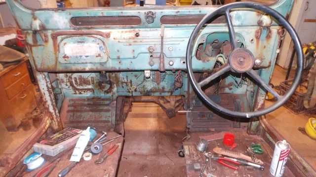

at present just going right through the firewall and undoing every stud and bolt, applying anti seize and reinstalling. things like the throttle linkages, vacuum line mounts, horn relay mounts etc etc. most things need heat to dismantle. cleaning all electrical joins and earths etc. want to have all this under dash sorted before i reinstall motor and box.
also sourced the correct thread tap set and sorted a few more broken studs; including tub bonnet hinge i broke couple months ago. i currently have no broken studs of my own making in rusty. im a bit proud of that.
got all the firewall bolts sorted. made a little start loosening up the original vacuum line wire hose clamps etc. handbrake cleaned lubed and ready for reinstall. got everything i can out of the dash. most bits needed heat which blistered the paint a bit but gave that a rub with some emery and it will blend in in time. cant budge the dash indicator light mounts but got the globes out so they will be fine. cant budge 4wd light without risking damage so soak more and ignore for now. still working on darth vader light (remnants) pull.
slowly finding my way through the wiring and coming up with a plan;
fusebox swapped out for a 64 donor.
lightswitch to be swapped courtesy cult45.
dimmer switch to be swapped.

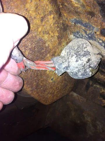

trouble light plug to be swapped.
wiper switch i think serviceable.
everything trafficator and indicators to be swapped.
everything horn to be swapped.
brake switch to be fitted.
wrong ignition switch to stay for now. i dont have a donor with key, this one works and is 'period correct'!
charge circuit will be alternator fit after motor reinstall.
much of this wiring is not necessary for what i am building. rusty really needs no more than a charging alternator and a headlight but i am enjoying the challenge while learning a lot about this old wiring. good practice.

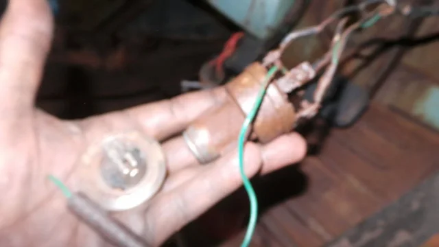

darth vader and trouble light plug - to work.

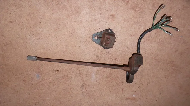

pics - donor indicator unit next to the po 'lucas' install. refurbed handbrake. i am also trying to pull the pedals for a clean and lube. they are not seized, but very stiff. got the bolts loose but having trouble getting them out.
(the bolts that is)
finally a question. how does this pin on the 4wd lever come out. havnt tried yet and dont really need to remove it; it just interests me. there doesnt seem to be anything obvious holding this in. press fit best left alone?
