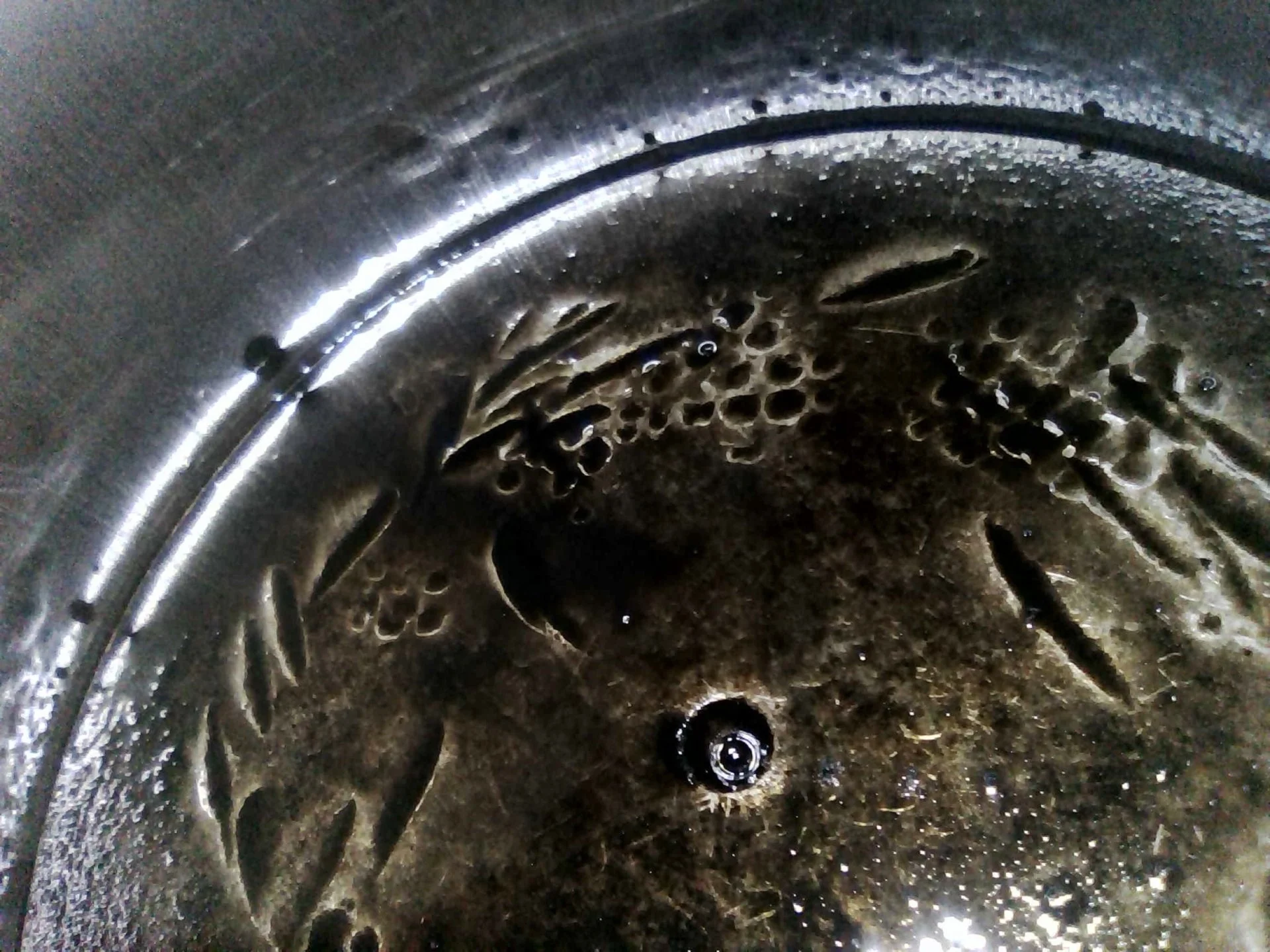

My top theory as to how my cylinders got like this (pre-me 😂)
