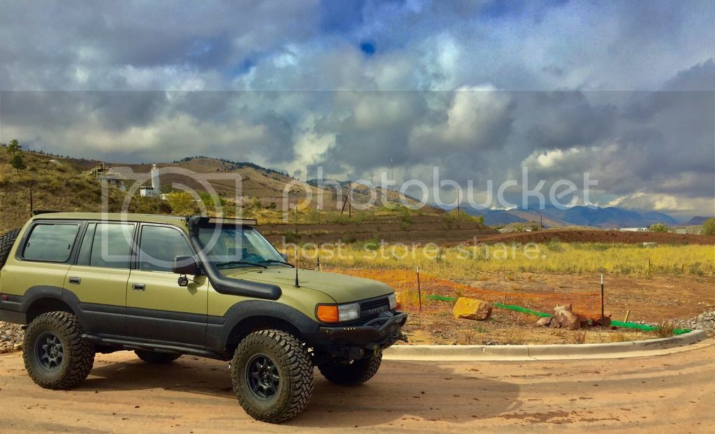

Here are some quick photoshops I did of how I want the truck to look eventually. I was going back and forth on painting it but I'm now leaning more toward bedlinen since I actually want to enjoy wheeling the rig. I'm leaning more toward the first image but I'm open to feedback!
Second pic looks more unique...Love the wheel choice
You are making good progress. Good luck with the build.
Nice 94!
I went with option 1. Looks way better. I'd do monstaliner though, bedliner UV fades really fast.
Nice 94!
Thank you. Looks good! Is the green on top monstaliner as well? I've got a friend with a body shop and I was planning on doing prep there. He suggested doing raptor liner so we can spray it on.
