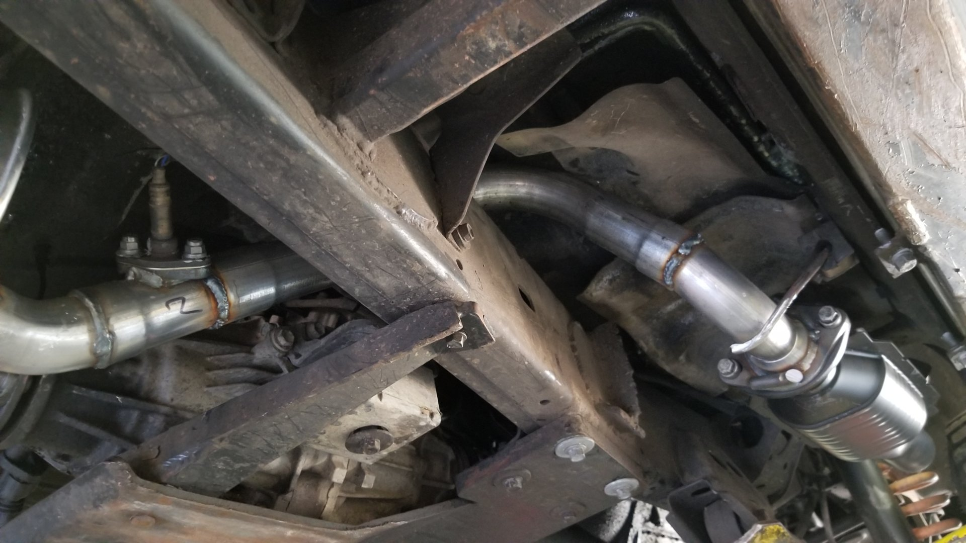

With a single cat you can go over the frame to the muffler. This clears out the entire passenger side with nothing under the frame.

I will be addressing this issue in coming months as I build my first OBD2 80 series. I’ve read about aftermarket cats and down pipes but this photo appears to show a single oem cat. Am I correct? Could I simply reduce to a single oem cat, assuming it’s still a good unit, and enjoy the same results?
That O2 sensor is quite a distance aft of the cat…..

That is the Magnaflow downpipe/cat. I went to a local hot rod shop with the Magnaflow and a box of parts from Bosal. They cut apart what was needed, welded up all the O2 bungs, etc. The Bosal muffler had a slightly smaller diameter than OEM so that too was tucked up higher.
No issues at all, other than it's starting to rust out. But it's been about 5 or 6 years.
