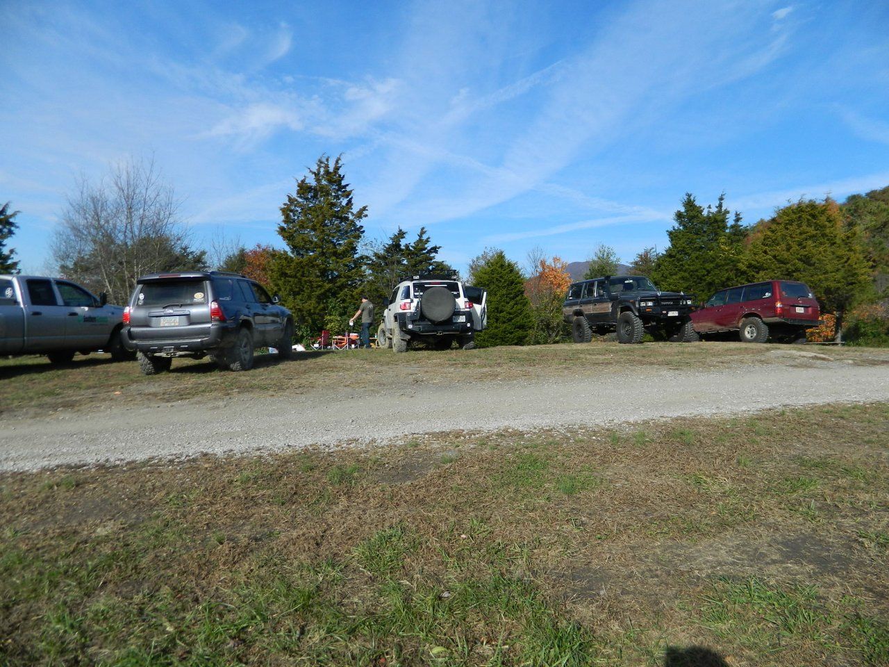

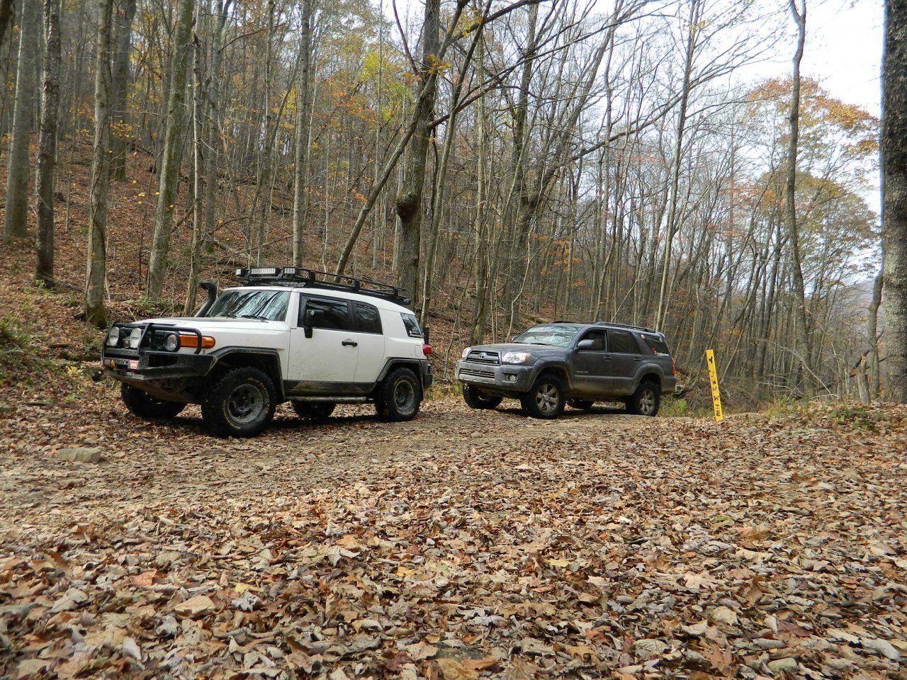

Epic photo update:
Went up to Windrock Park in Tennessee with some friends for the weekend.
Got my second oops on this trip. We went around this pretty long trail (took about an hour to get there) and the end was a pretty short black diamond. I was not even remotely entertaining the idea of driving all the way back, although some J**P guys that were following us all chickened out. The bottom section was actually pretty easy. The top there was a gnarly hill climb but with a convenient by-pass. Only problem with the by-pass was that it was very narrow and there was a large tree on the side. Well, found that tree with the quarter panel. Luckily the window was unscathed. Should be able to pop it out and throw a little touch up paint on there. Bad news is, I need 2 tail lights now. Also, looks like my factory skid plate is pretty bent. When going over bumps there is a pretty decent rattle. Need to get down there and check everything out.
