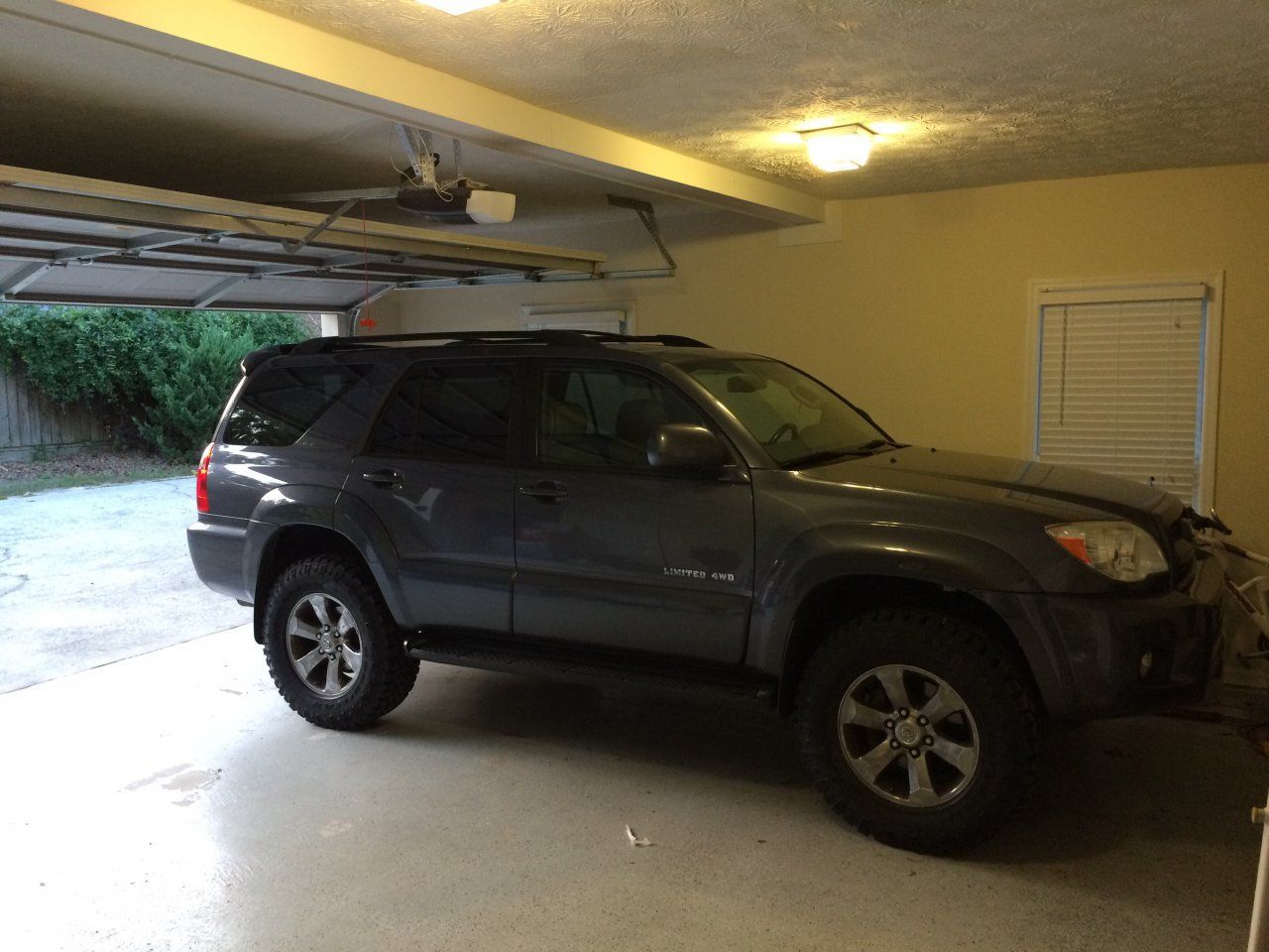

That came out great! I'm really considering going with a similar tire, be interested to hear how they work out for you.
It's amazing what couple of inches and some tires will do for a T4R. How close are the tires to your uca's? Any reason you added the dif drop?
Pretty cool. What does it sound like with those new tires? How does the handling compare to stock?
They are a little noisy but not too bad. Def louder than my Nittos were on my Tundra. Handling in general seems about the same. Tires are much stiffer which you can def feel. Most interesting thing is the steering feel. It actually feels much "lighter" now. Like easier to turn. There is a lot less castor now bc of the lift.
The tires are close enough where I can't get my finger in between them and the uca. That was one factor in deciding to got with the 275 over the 285.
Edit: Didn't answer the diff drop question. I felt like since this is a DD and full time 4WD it was kind of a "well it certainly couldn't hurt..." deal. I'm sure it would be ok without it. I'm just trying to decrease stress to hopefully eliminate any additional failure points.

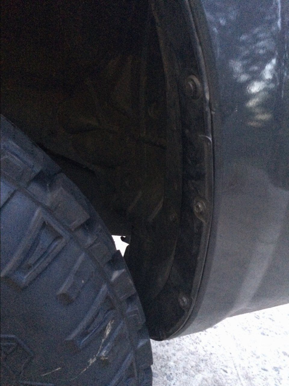

Started working on some clearance this evening. Took the front mud flaps off. The fronts just required the bolts to be put back in to hold the flares on. The rear ones are a little more tricky. The rear flaps also act as close outs for the rear bumper. The bolts also hold the rear bumper on. So, I just modified the rear ones basically removing the "flap" part of the... er... mud flap. Pics below:

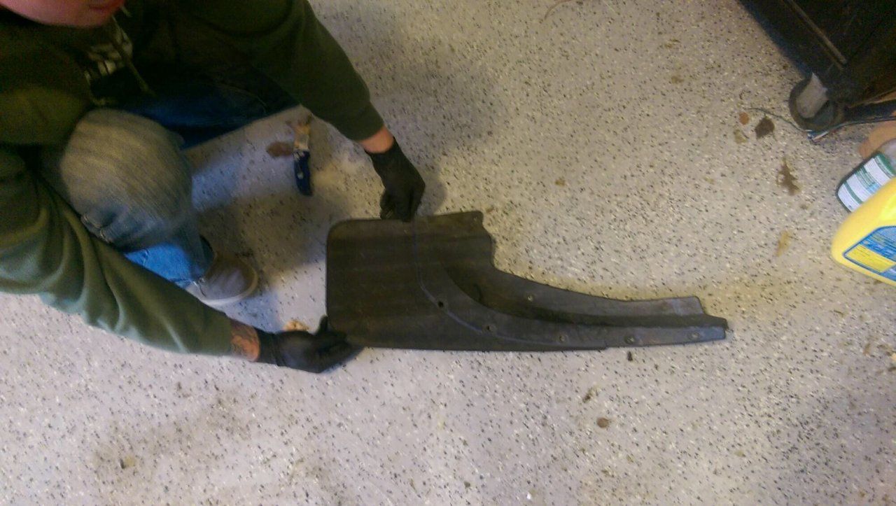

Trimmed the fender liners a bit:
Required tools...

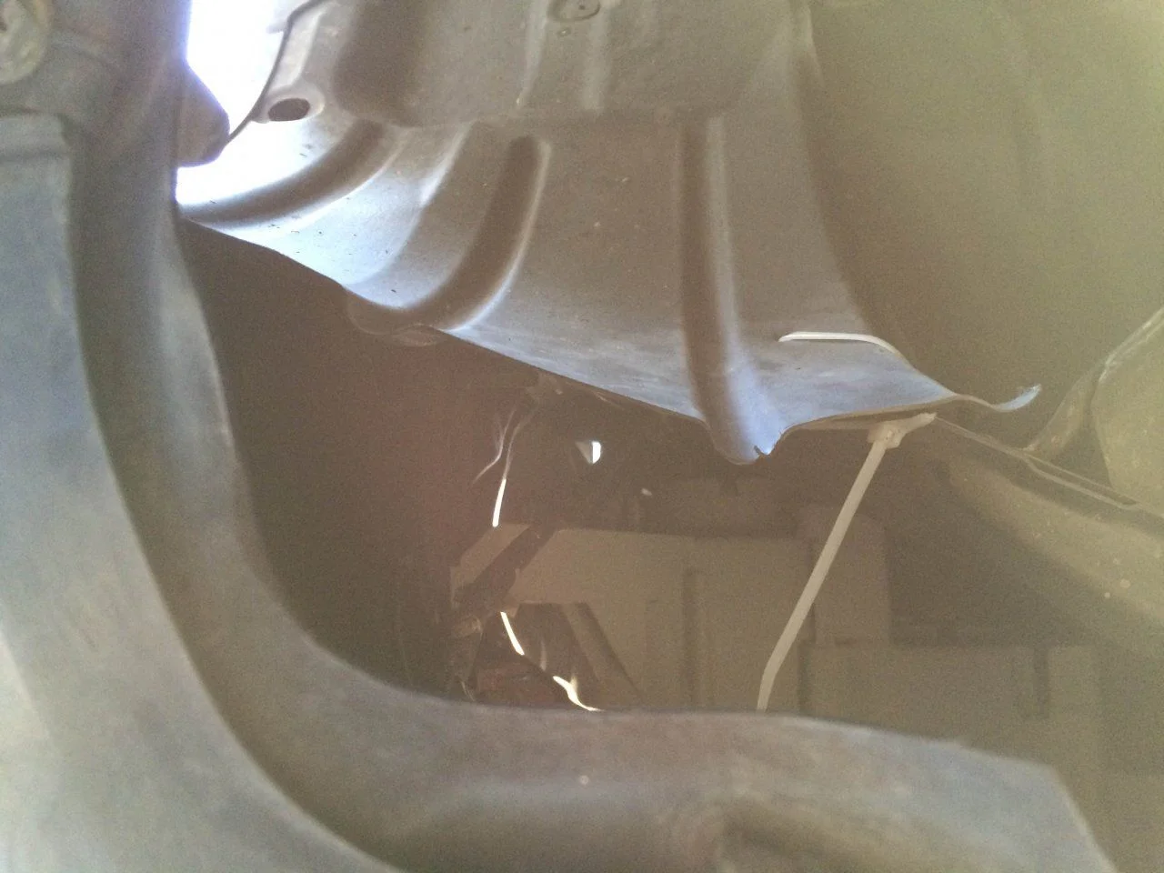

Marking roughly what I want to cut:
After a little trim:
No more scrubbing!!! (For now... Didn't flex it out or anything. Also only drove it across the driveway while parking.)
