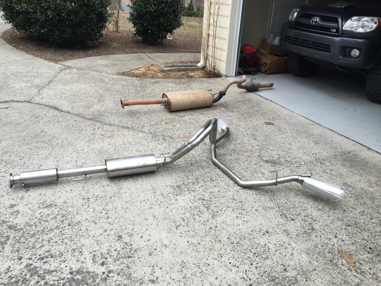

So, next couple of items on the list are sliders and probably my special made exhaust that I still haven't picked up. :doh:

Well, not really a functional mod but I ordered the last Borla 4Runner exhaust a while back. Finally got around to picking it up AND put it on today.
Sound quality is probably better if you watch these in HD.
