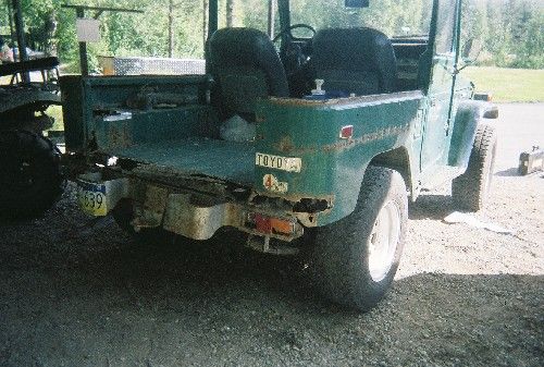

So I picked this '75 FJ40 up for $1k a few months ago just to beat around in and use as a hunting rig. I wasn't going to dump any $$ into it...just change the oil maybe and vacuum some of the dirt out of the seats. But we all know that plans do change :D So 3 months later I'm almost trail-ready and it looks a little different.
Future plans include Saginaw PS, lockrights, shackle reversal, dual batt. & some cozy PRP seats tucked into a little custom cage.
Here's what I started with:
Driving this thing 20 miles home was like riding a drunk elephant! I really did risk my life. After taking a good look at it when I got it home, I noticed that the front DS spring pack was missing 3 leaves and had a 1" gap between the housing and spring plates! The PS front drum was packed with this nasty silty grease and all the TRE's were falling apart. They guy told me that he'd been driving it back and forth down the highway all summer to work...either he's a lot braver than me or a good liar.
Over the next several months I'm going to transform this old heap into a mud-friendly Moose slayer! Attention will be paid to reliability, functionality and creature comfort (at least as much comfort as you can get out of an old 40) and it will remain street legal.

Used an AFW motorsports winch bumper for a Heep YJ...traded some stuff for an M8000 and threw some lights on the front. 37x13 Boggers fit perfect with 2" spacers all around. I flipped the rear springs (wasn't lazy for once and re-drilled em too) and will prob go with a BTF rear bumper soon and outboard some XJ leafs for more travel and a better ride. I'm leaving it spring-under for low COG.
I still need to weld in the rear wheelwells, but a large action packer will fit perfect between them with room for extra stuff in the back. Once I finish fitting and re-fiberglassing the cap (Thanks Mark) to match the narrowed hard top, I'd like to fab a custom hatch/sunroof that can pop open while hunting. The lip is gone on the cap, but I'm just building a rim for it out of some 3"x 3/16" strap. I'll rivet the cap down and seal it up real good and it should work great.
I mounted an axe and shovel on the insides of the hardtop, and am building a custom mount for the 6K pull-pal on the inside of the rear door. I used an old rack off of a snowmachine and welded it right to the single rear door to use as a gas can/cooler holder. Still need to run a couple pieces of tube down to support the bottom.

A couple more pics. Man this thing needs paint! and fenderwells....and exhaust...tune-up...
Used a couple headrests that we had laying around out of our 2001 Honda Oddysey van. Only the second-row seat ones fit perfect :)

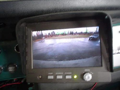

Some camera views & underbody rear-facing mount location. Have one in the front crossmember and rear rack as well
rear view cam, rock lights

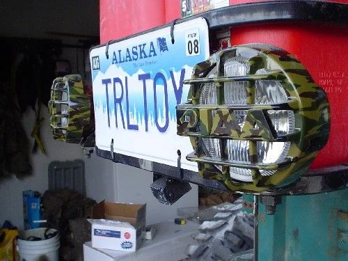

the frontend. Solenoid mounted in the grille, thinking about doing a grille hoop and tying it into the bumper. Going to pick up some UHMW for the fender flares. Should be nice and flexy when bouncing off trees & rocks
GraciasGracias. I'm working on the in-cab winch controls tonite. Shoulda waited to install the winch solenoids in the grille...haveta move the radiator again :doh: Hopefully I'll have time this weekend to grab some 3" strap and build the horseshoe/fiberglass cap frame and get the top all done. Then it's just fenderwells and go wheel some trails before all the mud freezes :crybaby:
