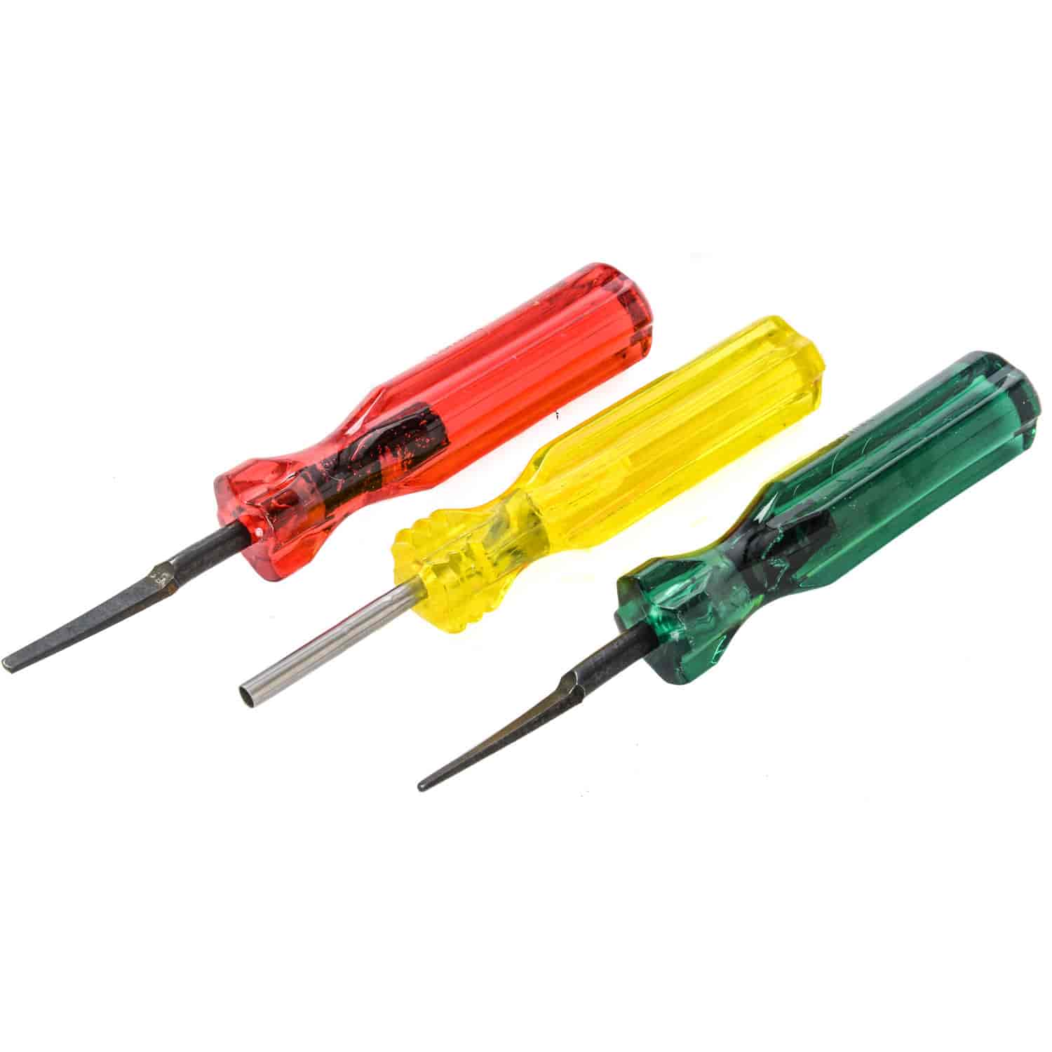

However, the OP made it sound like this was being attempted with basic, standard tools. Removing the pin block to get through the firewall requires the pin removal tool (special tool) schematics of which pin goes where, and if I remember correctly there was some pins that needed to be swapped. While that kind of stuff may be cake walk for you or others that do this on a fairly regular basis, those of us with limited ability, time, etc. may not be able to or may not wish to purchase a tool for a one time use.

Yup, $6.99 at most auto stores :) Pins go right back in the same place they came out of. All labeled already, all you need to do is write down what color to what slot and you are good. No schematic required and no changing wires. Mounting and wiring the pedal is a :banana: job.
