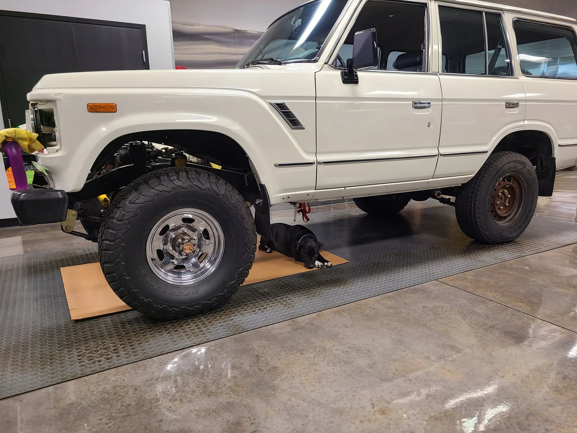

Let's swap a motor and do some other stuff to a 60....
And that was my week......and I thought I was going to be finished up with the interior and starting to pull a motor :)

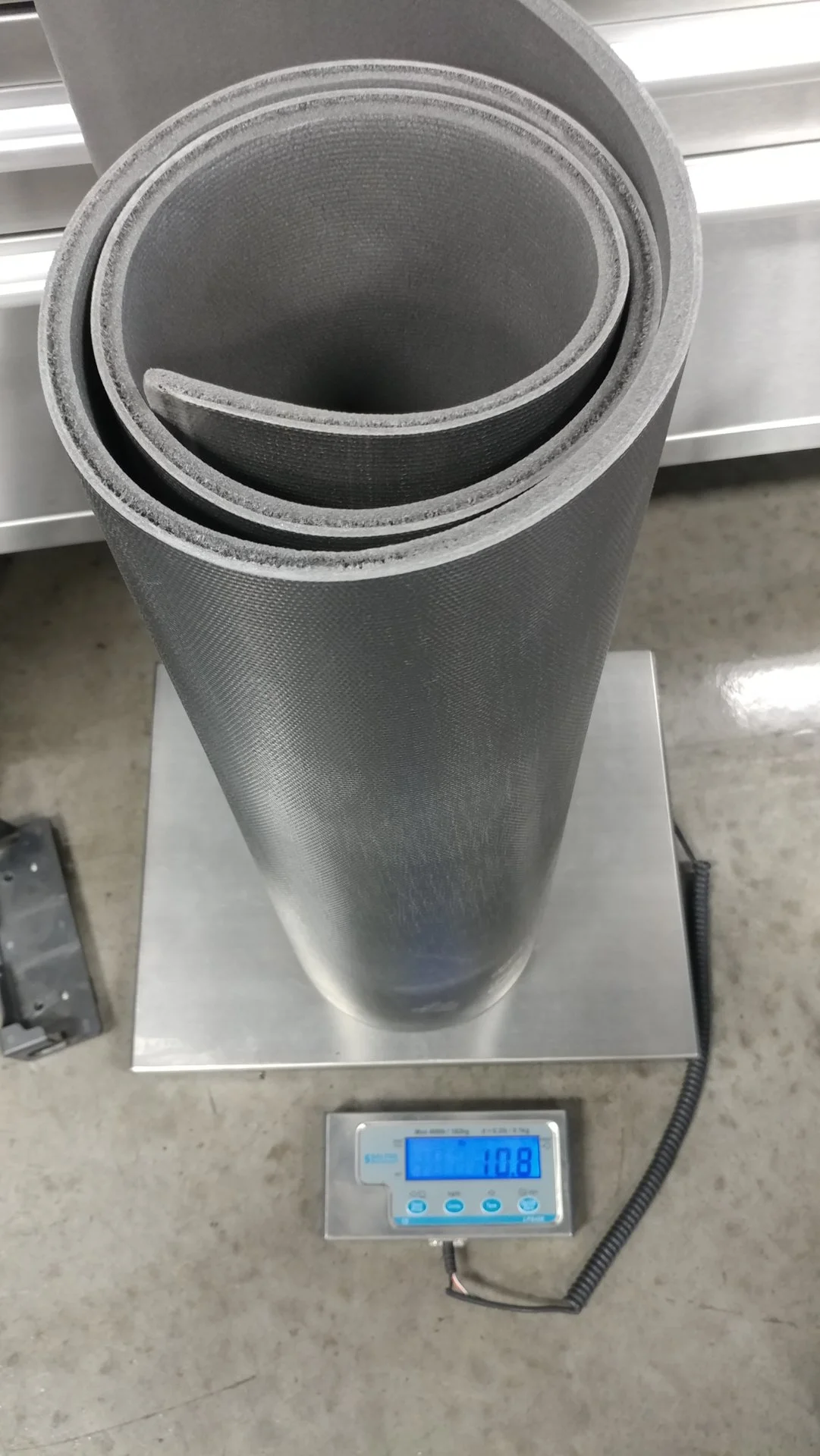

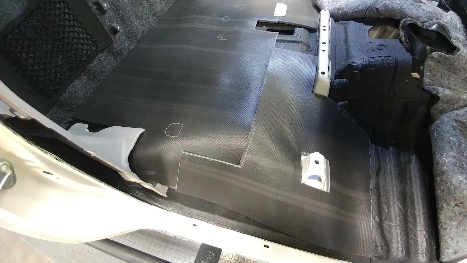

After everything had dried, I started down a road I hate going down. I like to use an MLV or mass loaded vinyl under the carpeting(or vinyl flooring in other trucks)....the MLV is a 3/8" thick rubber/foam mat that helps reduce sound waves traveling around the interior....like road noise. The Damplifier Pro stick on sound deadener and Spectrum help to reduce the sound in the metal....but the MLV gets it out of the air. In my other trucks that have it, they feel very dead inside....they're just solid.
Second Skin's product is Luxury Liner Pro. It weighs 1.25 pounds per sq. foot...it's ridiculous how heavy a roll is.
The downside to this stuff is that it changes the dimensions of the floor quite a bit.....it's an absolute bear to get the carpet or vinyl to fit tight over it. I usually remove the jute backing off the carpet to help control the thickness.....this helps but in areas like the shifter and places where things are mounted to sheetmetal.....it takes some patience(lots of patience) and some skill to make it look right. it also needs to be overlapped or butted up to itself....full coverage....no gaps. Not easy.
I used it in front and the middle. In the rear of the truck I used jute(supplied with carpet) and I went with a much thinner rubber MLV, no foam.

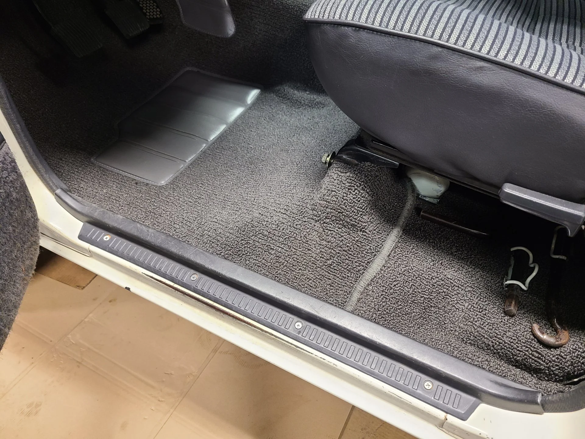

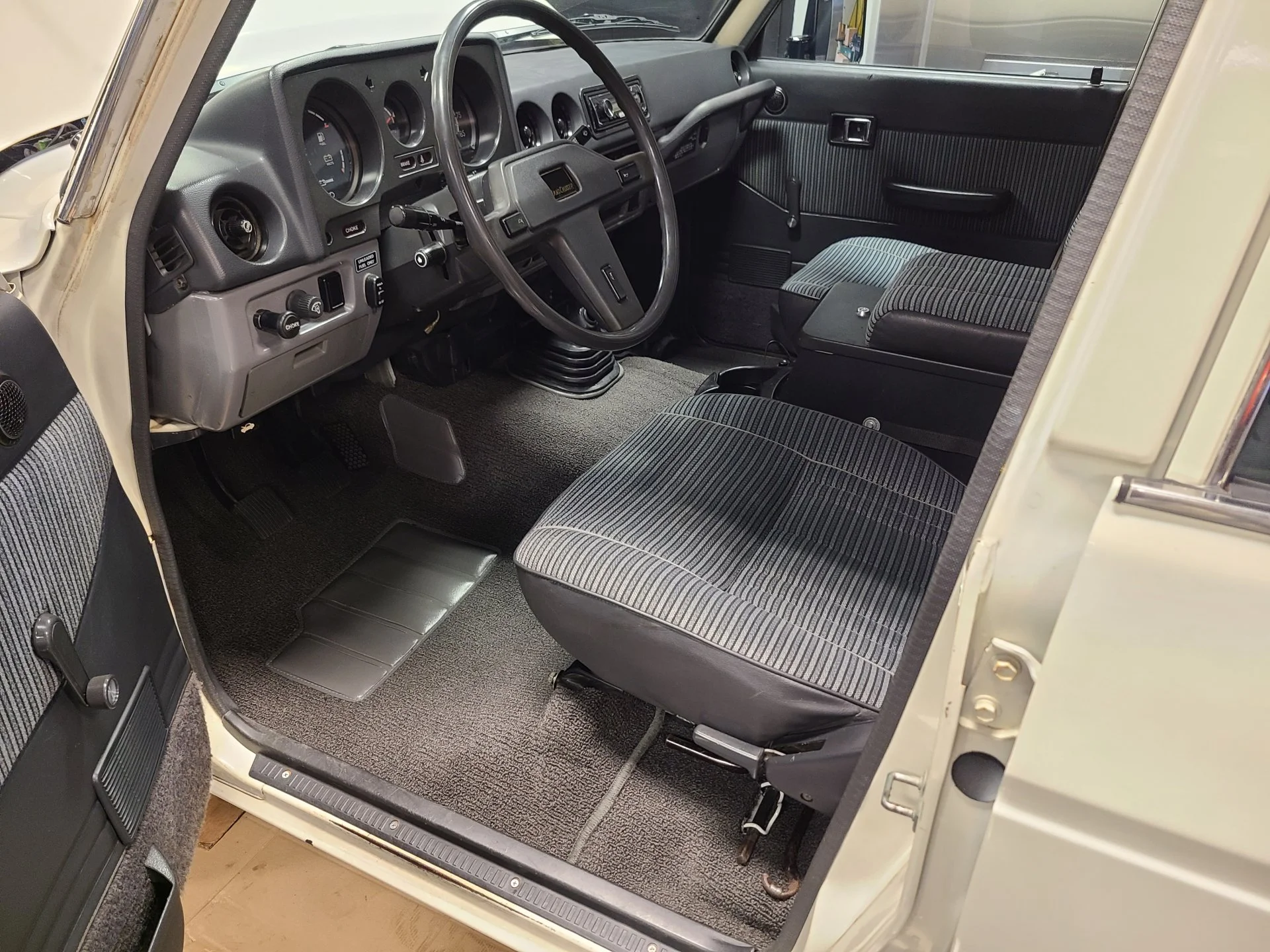

So once that puzzle of a job is done it was time for the ACC carpet to go in. Probably an easy fit over steel floors and if you have stock carpeting to use as a guide for cutouts....NOT easy to do if you have nothing to go off and your floors are 1/2" thicker than they should be :)
I spent almost a week messing around with the carpet.....I will never do that job again. And for the record, the ACC carpet kits are not all that good. OK for the money but disappointing. I should have had the interior guys build a custom carpet set for it. Turned out good in the end but a tough job.
As usual, the dog will park it on anything on the floor.....maybe she was helping get the wrinkles out.
Fairly happy with it.....there are some weird wrinkles on the top of the shifter area....haven't yet finished that area up since we're pulling the trans out soon.

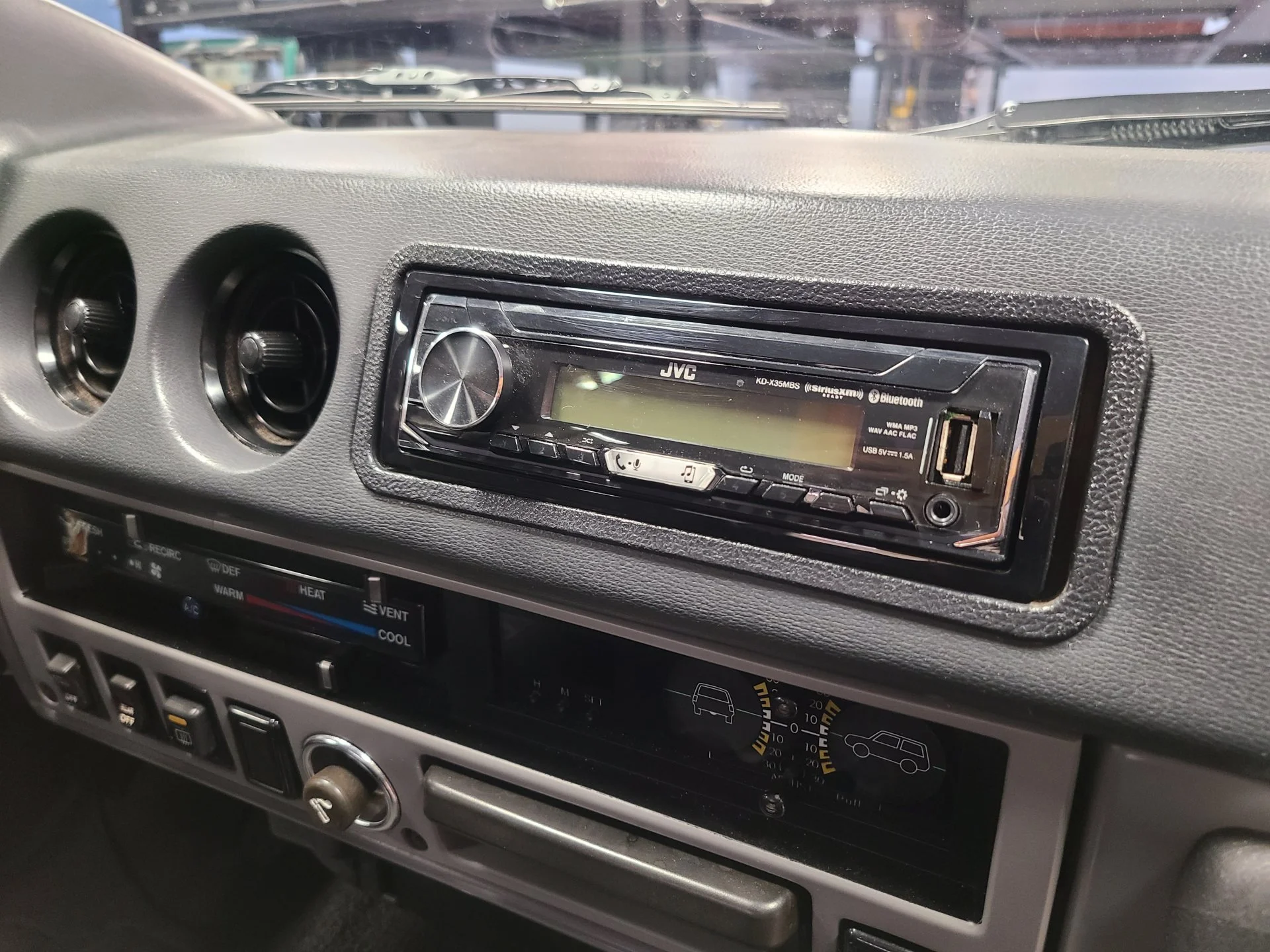

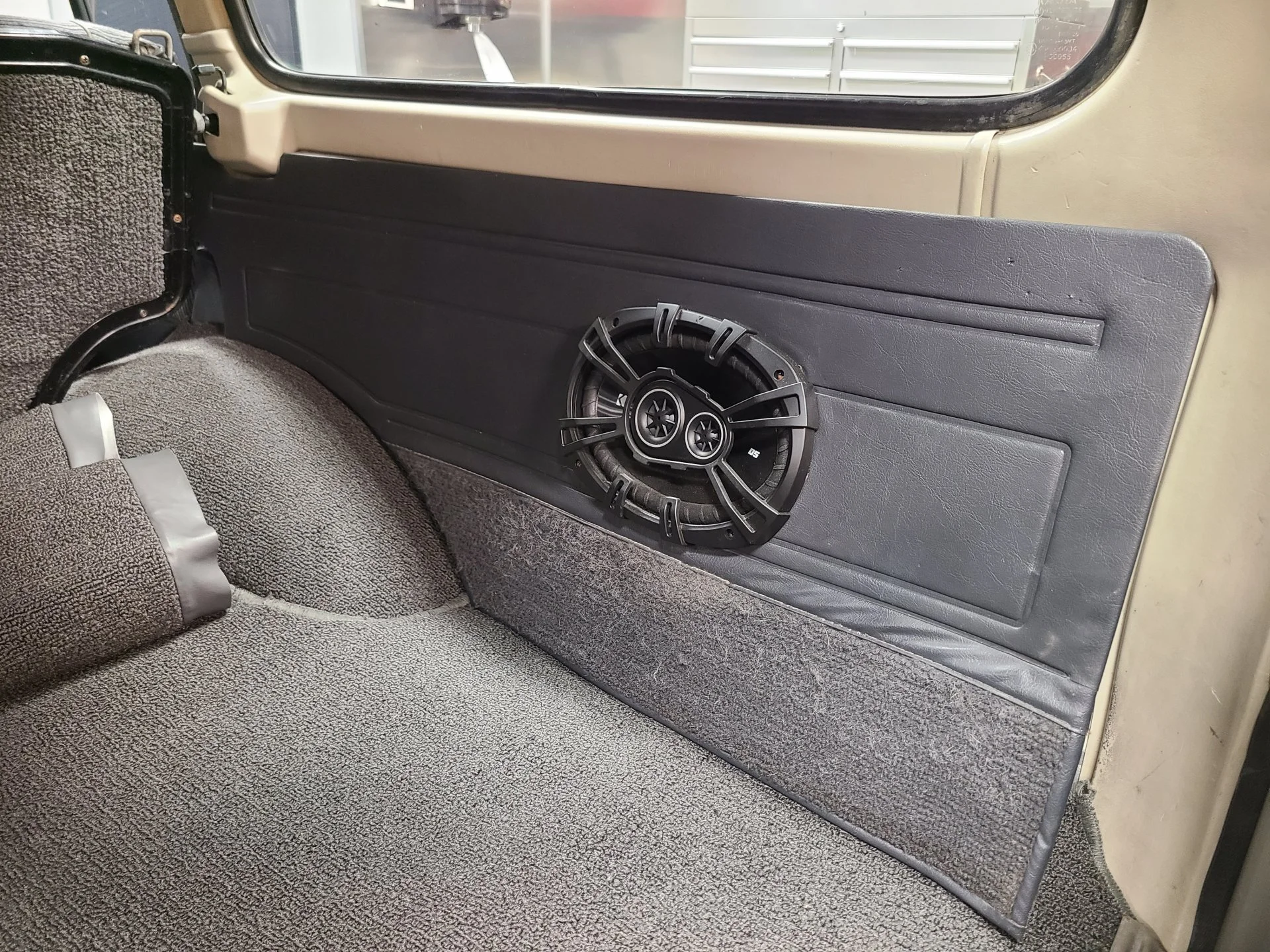

When I first got the truck, I had put a JVC head unit it.....a mechless one. I wanted it because I could change the color to green to match that beautiful dash gauge lighting. I'm not a huge stereo guy but I'm figuring it out more and more. I forget what speakers are in the front doors...some kind of component speaker. I think the window was hitting them....made some changes(put in some sound deadening in the front doors while I was there) and got them sorted out. They sound pretty good so no need to change them.
I went for a set of JBL GTO 6x9s for the rear....I use their 6.5" shallow mounts on the 79 series trucks and they are great. I wanted a little more punch but didn't want an amp and all that non-sense......so I got one of these. An 8" JBL sub for under the seat. Very cool and it sounds great to my amateur ears. This will be perfect for my needs in this truck. With all the sound deadening, stereos end up sounding very good.

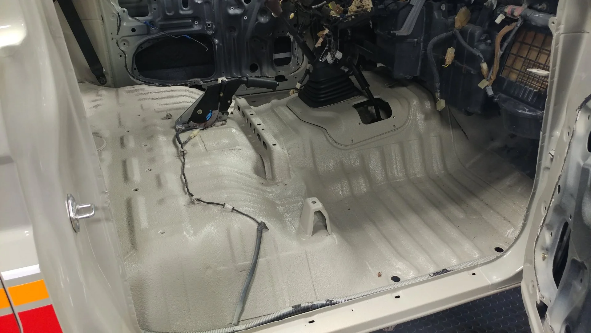

I would for sure strip those floors down all the way( I would feel most comfortable removing the OEM sound deadener in the front at a minimum) and get 3 solid coats of Master Series on it. Good solid heavy coats....especially in areas like where the floor meets the rocker/sill.....all those seams where the metal is stacked. It's thick enough that it will fill in that seam. I'd probably spray in some Spectrum....a good 1-2mm of it. Since Spectrum can be used as undercoating, it's going to be durable enough as your top coat but I'd probably be inclined to spray some Raptor on top of it. Easy to clean up and it's SUPER strong stuff. You can do it in any color.

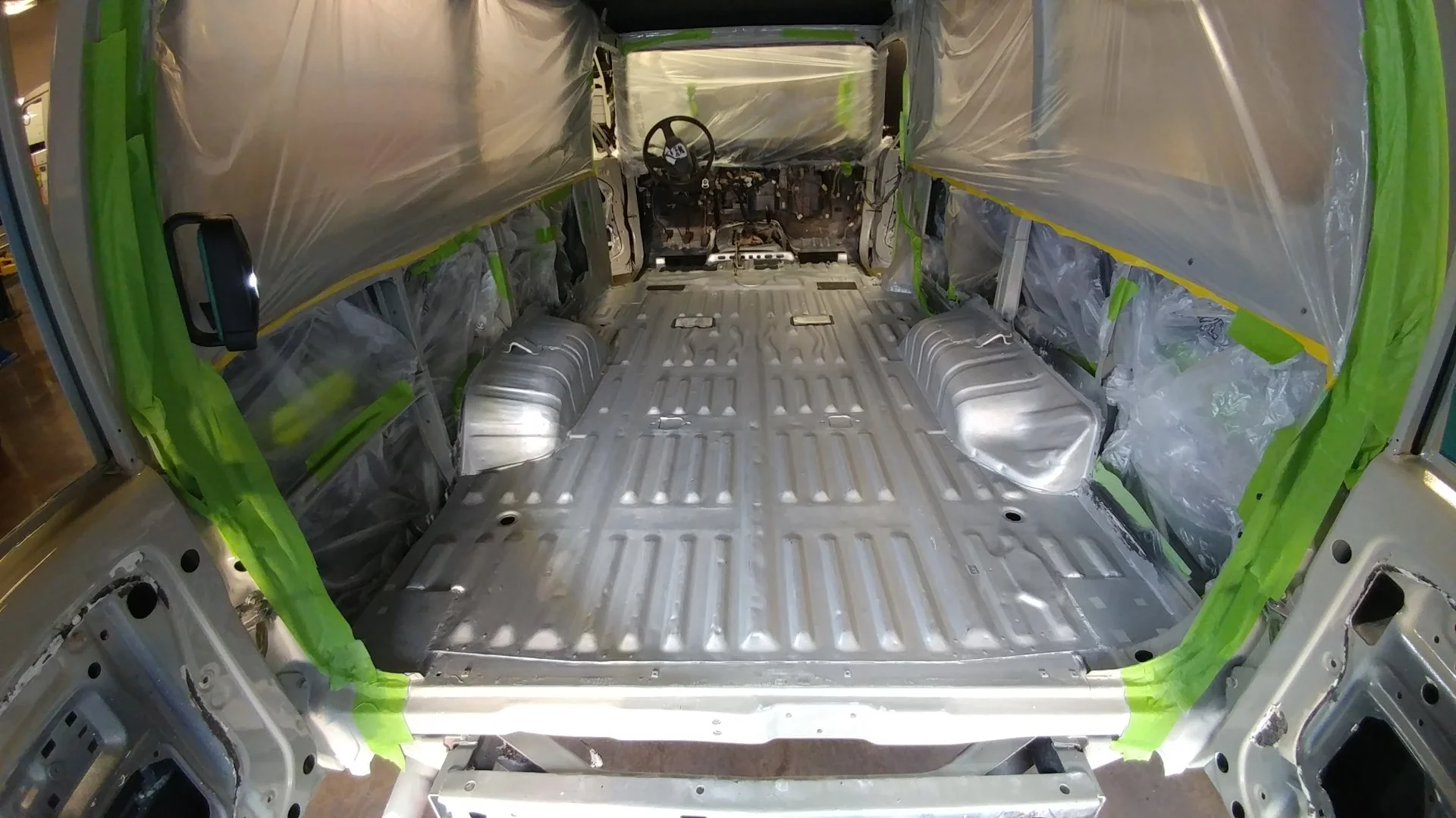

We did this in my Troopy build....these floors were structurally sound with some surface rust where there wasn't OEM sound deadening. We removed all the OEM deadener, ran a wire wheel over the rust, power washed it and had at it with the Master Series.
Originally I was only planning on running front vinyl floors with nothing in the rear....so in the front, we applied Dampifier Pro to the floors over the Master series....I taped down all edges with foil tape so there was a smooth transition between the edge of the Damplifier(it's thick....2mm) and the floor. We sprayed our Spectrum in on this build since we were top coating it with Raptor bed liner(I wanted it smooth and uniform). This was not a cover every square inch of metal with Damplifier install....I tried to get about 60% coverage in it. Basically enough Damplifier to keep the floors from sounding like a tin can.
We top coated with color matched Raptor.....it's a little heavier texture than I like due to the Spectrum's finish(I don't believe we sanded the Spectrum). VERY very durable. Just remember to let that Spectrum cure 7 days at a minimum.

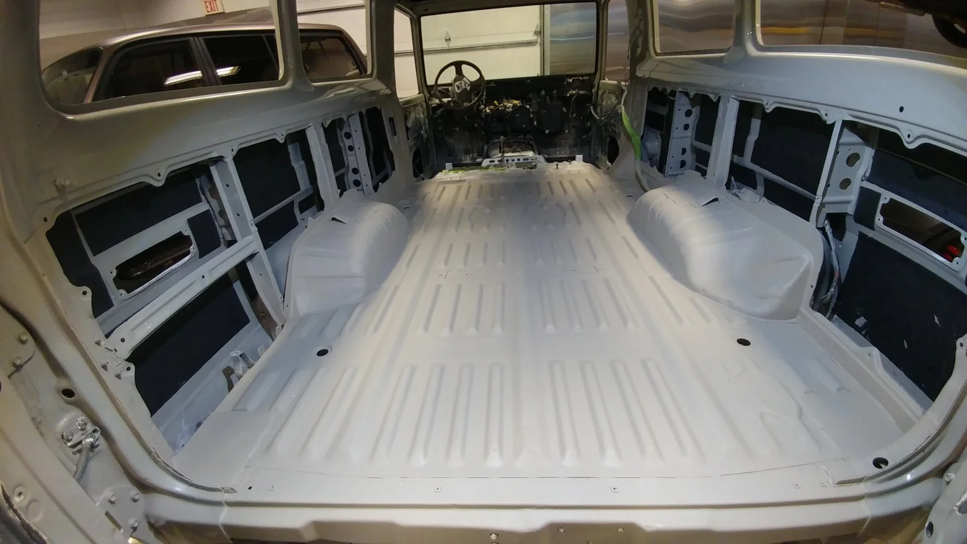

For the rear, I didn't need sound deadener....this truck is a 1FZ powered truck.....it's very quiet compared to a diesel truck so we didn't do much. Prepped the floors, Master Series, sprayed in Raptor. I used a finer texture(I use Raptor's Pro gun....has adjustable texture patterns)....we usually thin the Raptor out to the max suggested amount too.....really helps keep the texture to a minimum. In hindsight, I would have sprayed Spectrum back here but since this was going to be more of a utility truck, I wasn't going to run a vinyl floor....so I wouldn't have cared about texture. This truck is like a tomb inside.

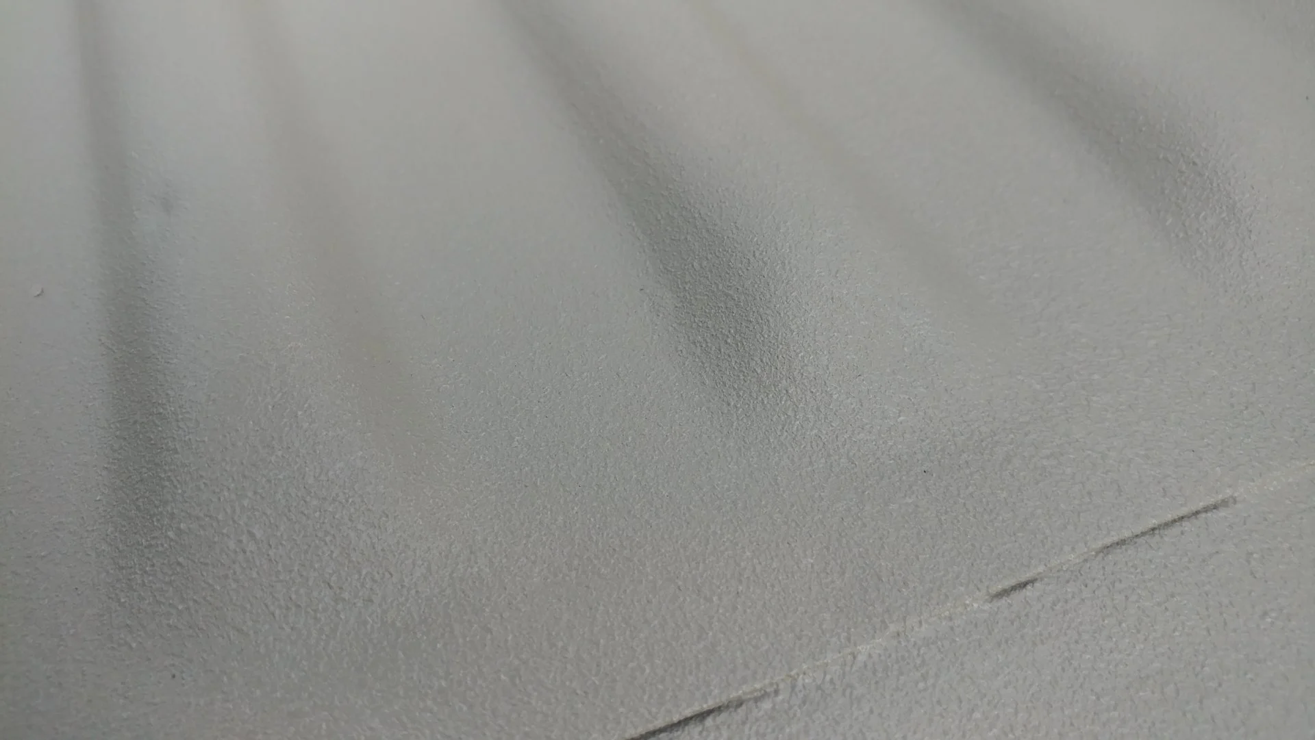

Raptor on the floors....very smooth with that low texture spray.
Close up of the Raptor
Here's how it ended up....

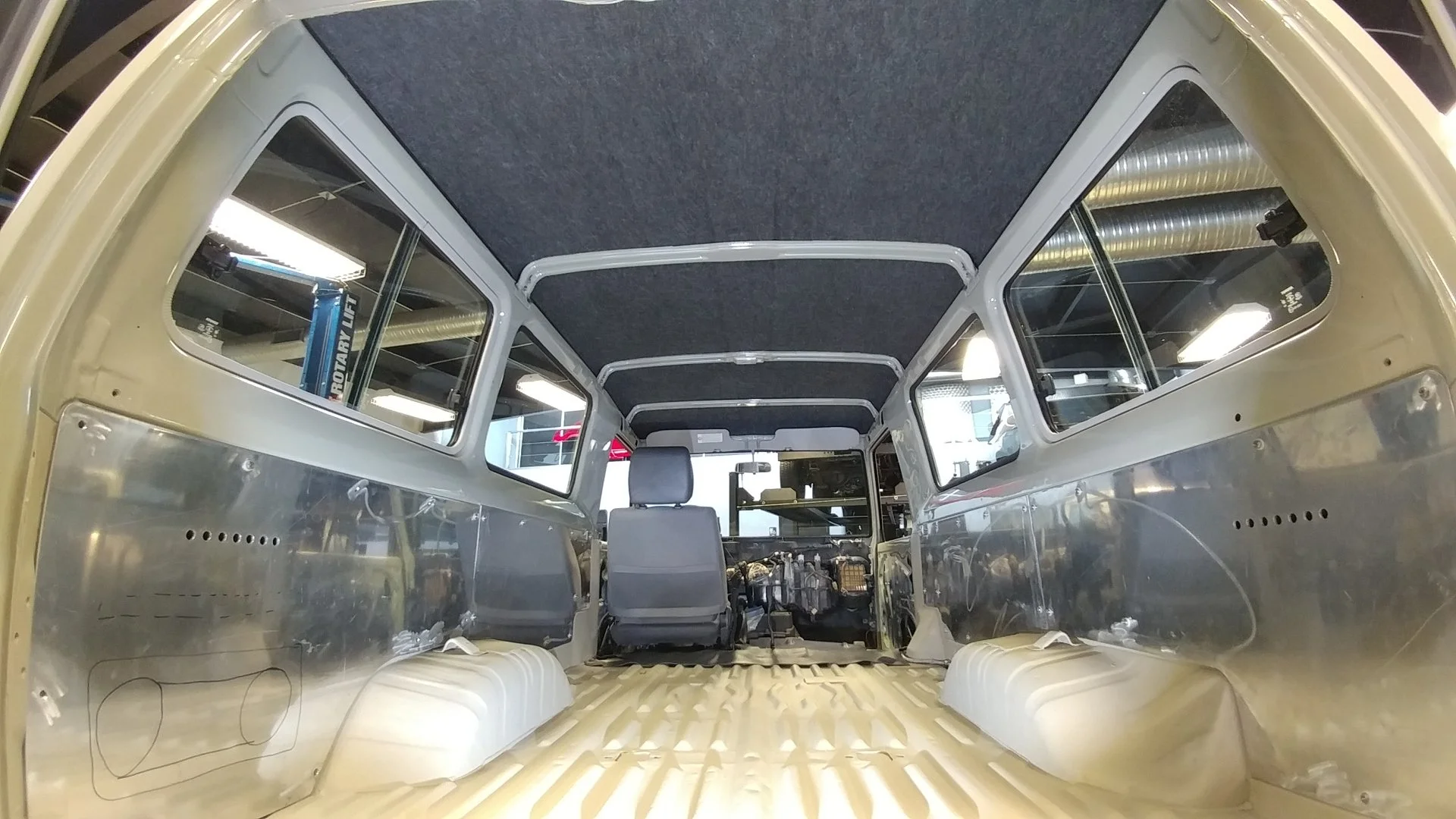

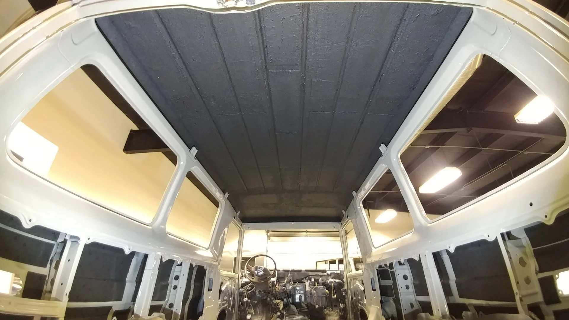

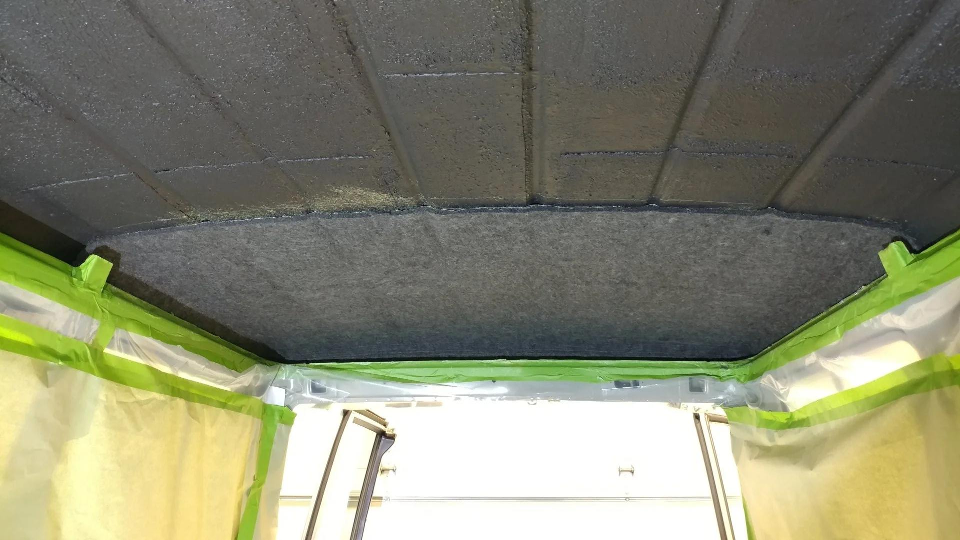

For the roof, I found this to be a killer setup.......we use it on a lot of our builds when the headliner is out. There are a couple of ways to do it depending on what you need out of the look. For headliners that go back in, we use Second Skin's Megazorb or Heat Wave Pro....cuts out heat big time and obviously decreases unwanted sound. For the Troopy, since I wasn't using a headliner, I used a product called Thermozite. It's a foil backed acoustic and thermal barrier.....amazing stuff. Looks great too.
Damplifier Pro in strategic areas....
Spectrum goes on next.
Thermozite.....foil side goes towards the heat source in this application so foil side up
Contact adhesive to apply it. It's a little tough to get right in the corners but very easy to splice in pieces if needed. I had to do that in a couple of spots...no big deal.
Finished product. Fantastic product....I'd have no problems using this as my headliner in a 60 if I had a really beat up factory one.

Pretty simple head unit....I gravitate towards head units that have volume knobs these days. Forgot I had added an inclinometer where the cubby was....going to probably lose the ashtray next so I can run an OLED display for my gauges....going to monitor a few different parameters on the motor that's going in :)

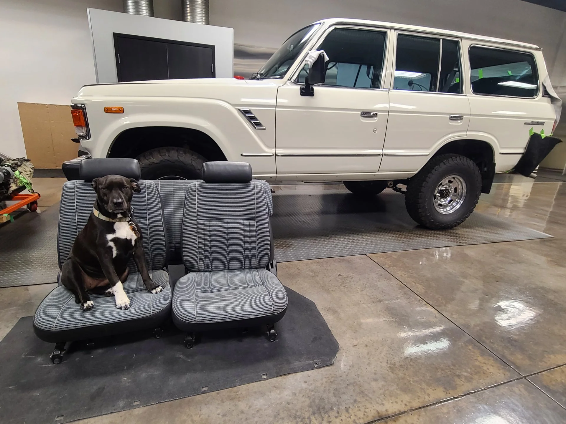

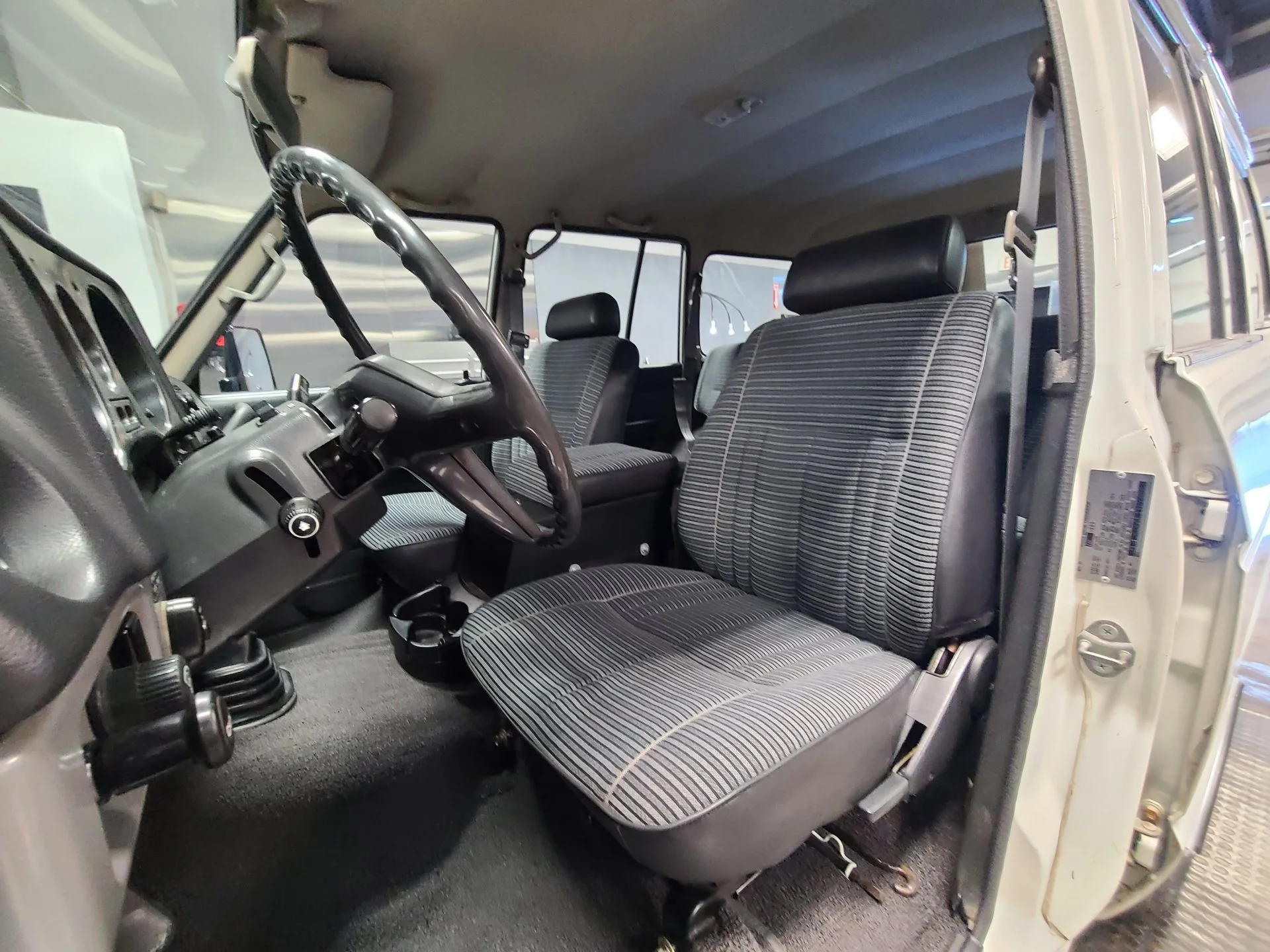

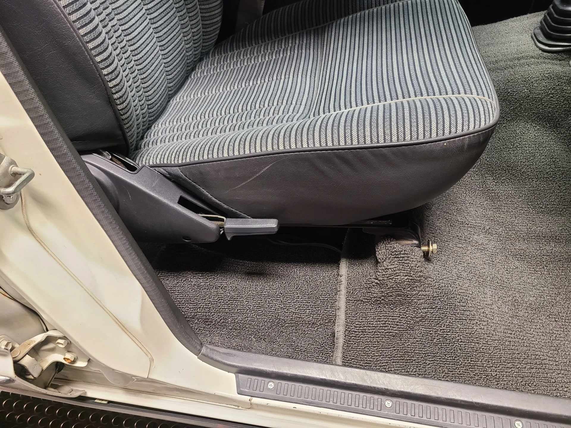

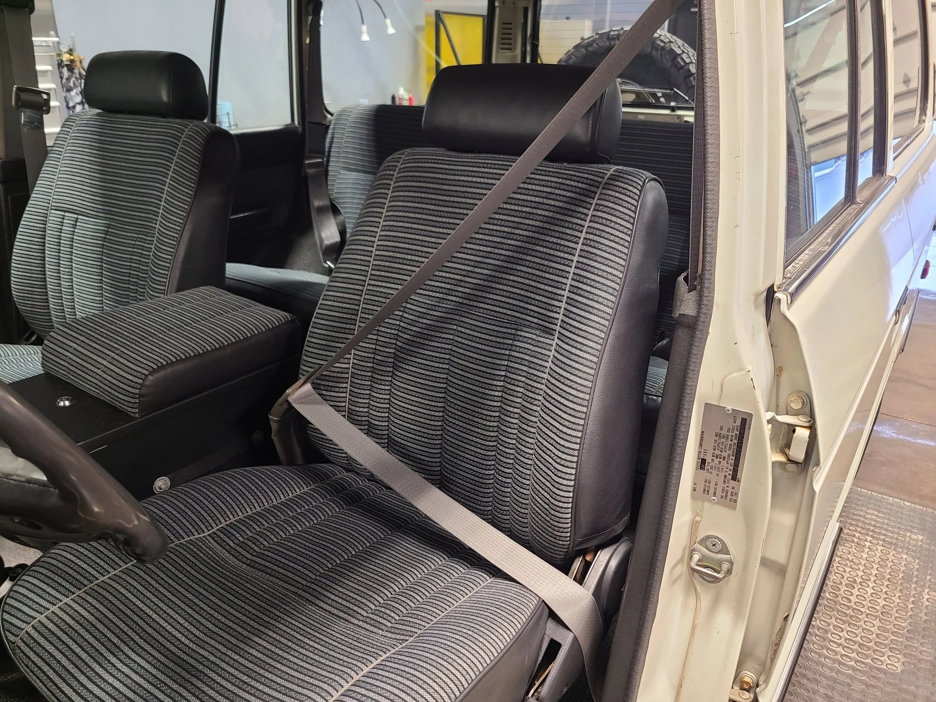

While I had the interior apart, I took some time and cleaned the seats. I had one cushion(typical drivers side outer lower bolster) repaired when I got the truck so no real repairs needed to be done.
I bought a brush to put in my drill like all those cool YouTube detail guys do.....wow what a great setup that was. I used a couple specific cleaners, some Dawn Ultra spray and settled on some good ol' 409. It did an incredible job. The seats are so clean...hard to believe.
Again....no real pics but what I found kind of funny is that when I bought the truck, I marveled at how clean the interior was. Turns out it wasn't that clean.
The right side was after one cleaning.....the amount of dirt coming out of the fabric after being agitated was gross. The foam looked like the color of a Wendy's Frosty. Yikes. I kept going until the foam was more like a vanilla Frosty and less like a chocolate one 😑
I had bought a used rear seat, took the fabric off of it and had my center console armrest covered. I love it. Looks super cool.
The dog was quite confused with the seats out of the truck I think.....and those paws are hardly clean. This was before cleaning.
Cleaned.....dog is lucky I like her and let her sit in on those clean seats.
With the exception of a little bit of fading, the interior has probably never looked better.
