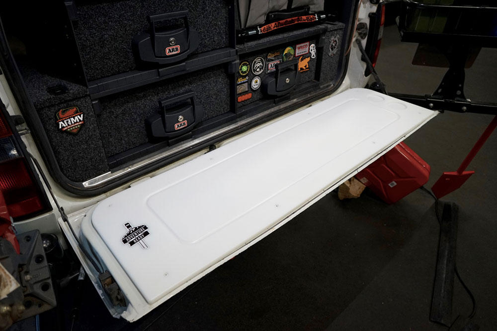

I have wanted to make mine into a giant cutting board for quite a while, haven't got around to it yet. I'd kind of rather have wood for that. At the moment I have mine covered with left over Rhino lining. It's a nice durable no-slip surface.
I just took the carpet off and use the metal surface for most things. I have a separate chuck box for cooking away from the truck at this point and it works well with an awning hanging off the back of the truck.
