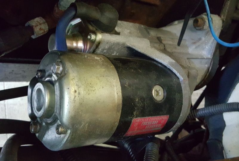

I used the guts of a Cummins starter for my 3B. Just reuse the Toyota nose cone. Great way to switch from 24v to 12v on the cheap.
In my case the decision was made for me because my Toyota starter had issues. Adding a new, heavy duty Cummins starter was an easy decision. It pains me a tad that it has the word "Chrysler" on the data plate but it's a big boy starter.
The 1HZ motor in #2 didn't come with a starter....so no swapping nose cones. But I think the HZJ73 came with another starter.....will look at the box of stuff I have for it. 73 is a 24V truck.
