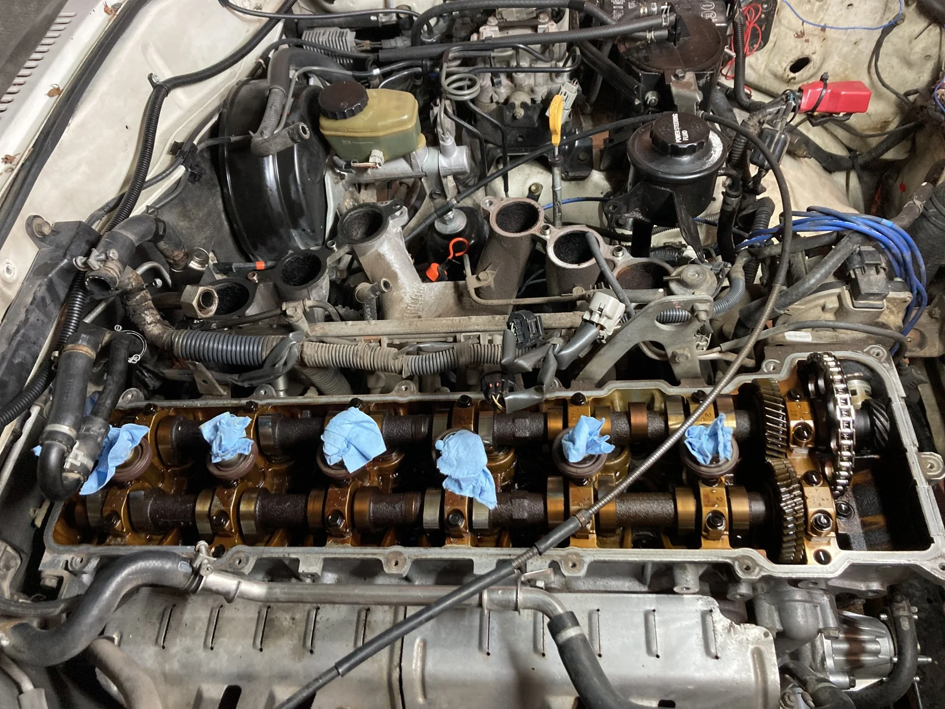

I’ve been wrestling with the block coolant drain plug on the cruiser, and I finally got it off. Apparently this is so I can bathe all those electrical connectors with coolant.
Fortunately it’s the last one ever I’ll drain the block in such a messy way. I bought a little drain bolt with a valve and a 1/4 tubing outlet. That should make future coolant drains much more manageable.
I also scrubbed the VC, lots of grime. I’ll plan on putting the new gasket on when I’m ready to bolt it back up. I’m nearly ready to get after the manifold removal job and the vacuum tube replacement. The partsouq order has a couple of new check valves and they won’t be here for 7-10 more days. The larger tubing will be here tomorrow. Waiting waiting.
Well, I’m now officially frustrated with the EGR system. Getting it loose from my upper intake is the latest holdup. I had to go find and E7 Torx to remove the EGR studs…fortunately I managed to find one at Napa, but the big ass nut is a problem. I couldn’t get an adjustable wrench on it because the the wiring harness above the fuel rail is in the way. I was able to get a pair of slip joint pliers on it, but I couldn’t get it to break loose. I don’t know if it’s ever been broken free since assembly.
So I’m soaking it in Kroil penetrating oil and I’ll try again tomorrow. Honestly I thought I’d won the fight when I got all of the bolts and nuts off of the upper intake broken loose, some of them are difficult to get to. Fortunately I spent lots of time in the driver side wheel well with my NSS saga so I’m it afraid to get elbow deep by that PHH. Actually the PHH is a breeze compared to this nonesense.
Blarg. I’m going to try remounting the studs and and bolting the egr back up to the manifold. I’m needing to mantra “Slow is fast” right now. I’m feeling impatient to get this project moving forward.

I bolted the egr back to the plenum and gave it another try, now the whole plenum is moving when I try and break loose the big nut…FSM says to do remove the EGR before unbolting the upper intake. :slap: I see my mistake now. Too bad those boys were a huge PITA to get loose. I’ll be pro at this by the time I’m done! Yes, I’m stopping for the night, having a dram and possibly shopping for a big wrench tomorrow.

I gave it another go briefly this afternoon, but I still need to bolt the upper intake back on so I can put more force on it without damaging the studs, or the egr pipe itself. I did buy some nice Knipex adjustable pliers today. They seem to grip well. I wasn’t able to work on the truck today, other things called my attention, but I’m hoping to have a solid couple of hours to keep going forward.
I’ll keep you posted and I’ll take some photos.
Ok update: I got that nut to move…so so very little. But I’ve moved it maybe 1/8th a turn pulling the wrench towards me….but it’s not really loosening. Then I thought: am it tightening this thing? Can you confirm counter clockwise with the wrench, which rotates the nut towards the passenger side.

@PNWTreeOctopus, as @FMC80 has stated correctly you need to rotate your wrench in the opposite direction. Because the nut is attached to the pipe, not the EGR valve, you have to have to do the counterclockwise lefty loosey from the perspective of the pipe/nut. When you have trouble breaking a fastener free once you get it to break free a small amount reverse the direction back and forth which will break any rust/corrosion free faster. This will also allow penetrating oil to get furthering in and then you can try again. This method also keeps a bolt or nut from snapping off.
Looking at your image, where your hand is, push not pull.
It’s all finally on the bench. I’m looking forward to replacing these vacuum lines. That was satisfying to remove. Thanks for the help. I’m beat gonna go get some sleep!
