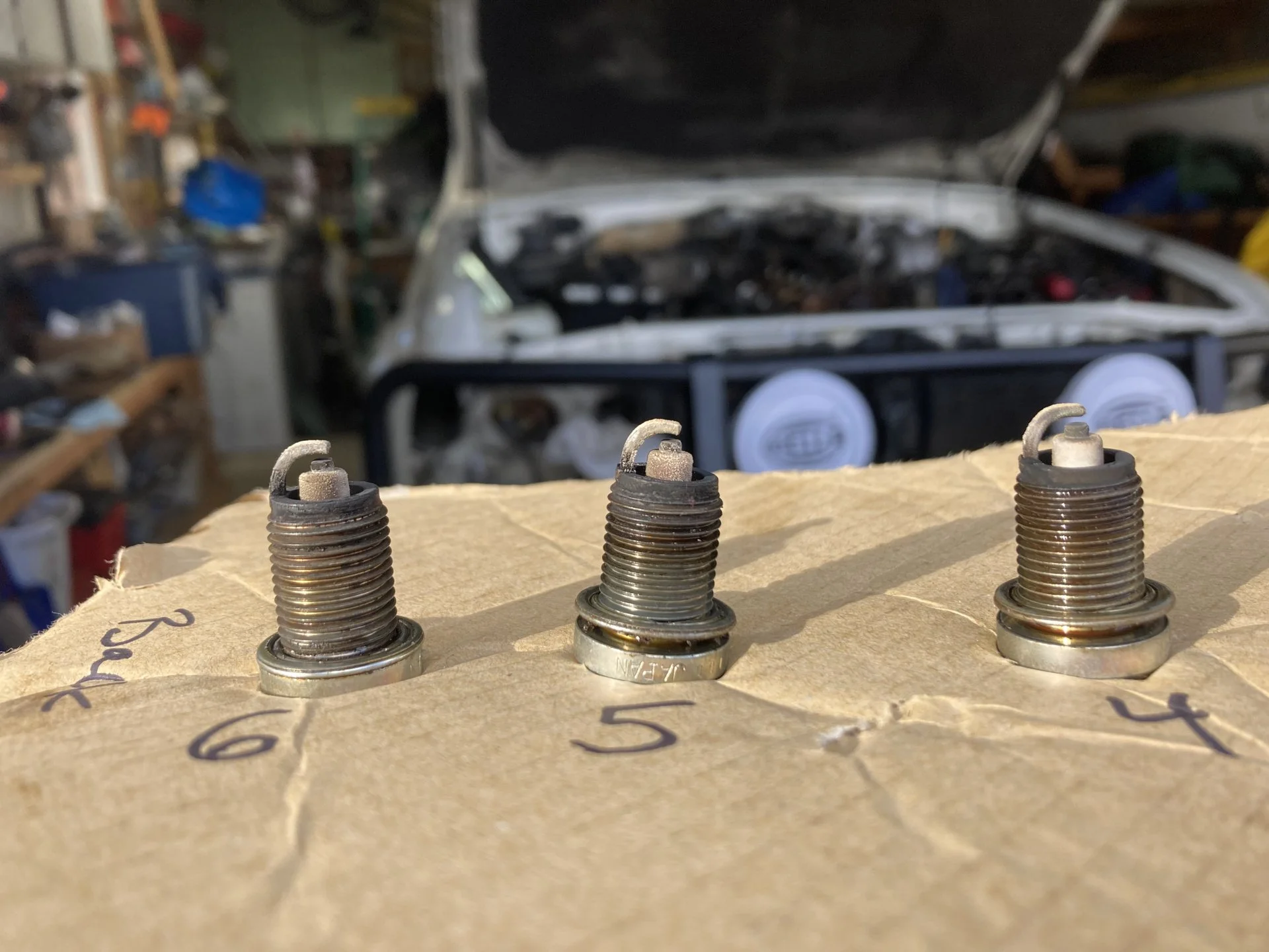

Remember how I was going to go to the beach? Well the pie is taking a ling time is our drafty oven. So instead I'll post pics of my spark plugs. I really don know much about inspecting them. They all look pretty similar to me, and nothing glaring. Honestly I'm posting this pic because Pell did the same thing in his thread and Ive decided to copy him...but Im not sure I'll buy a second 80, that seems like more than I can handle! Imagine me baselining two land cruisers...hmm.:hmm:
4-6

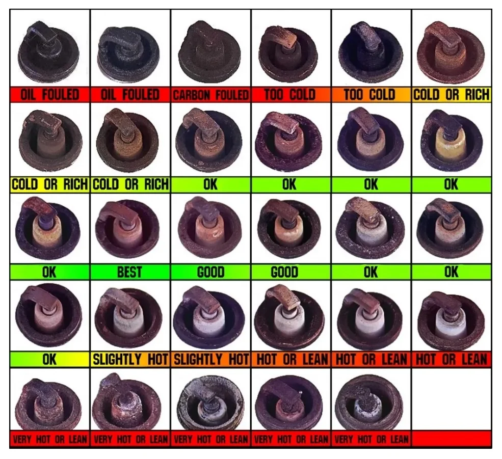

Happy turkey day to you and yours G. Plugs look good from where I sit with the exception of the minor deposits on the insulator. Could mean you have oil leaking or bad gas or you use your truck for short durations and it doesn't have the chance to burn off. I'm not a spark plug expert though. I could be drunk right now making people believe the nonsense I write for the sole purpose of misguiding people. But probably not. Here's an eye chart I loathe that I'll share with you so you can loathe it too.
I’m already there. I’m struggling to see all the differences….oh well! I’m having another stout! the pup agrees.
