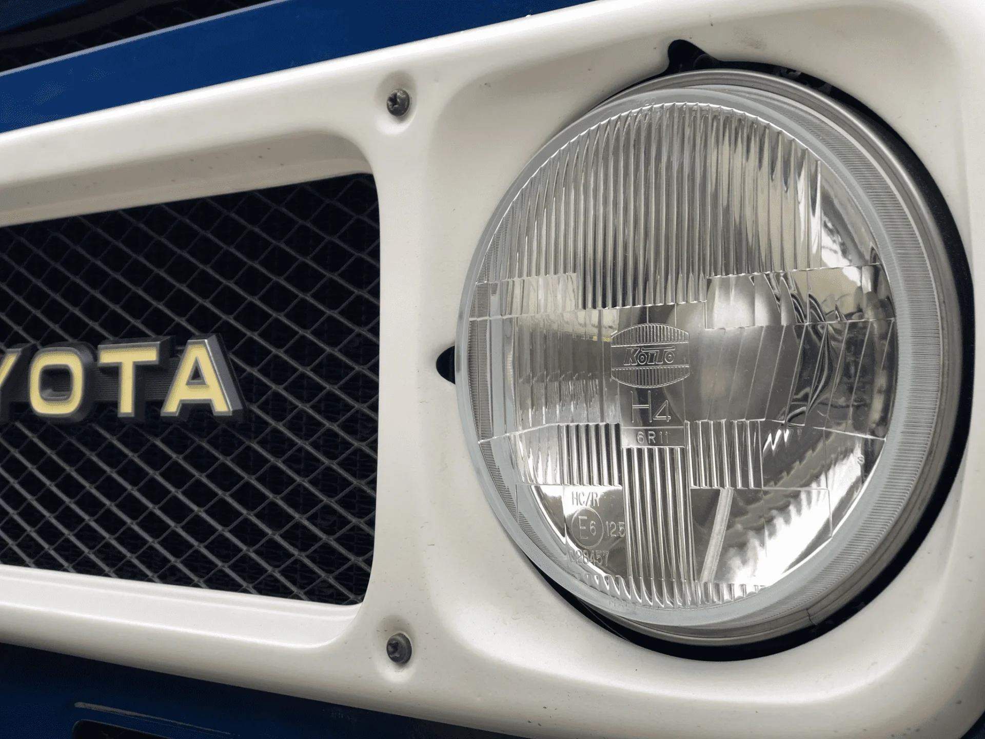

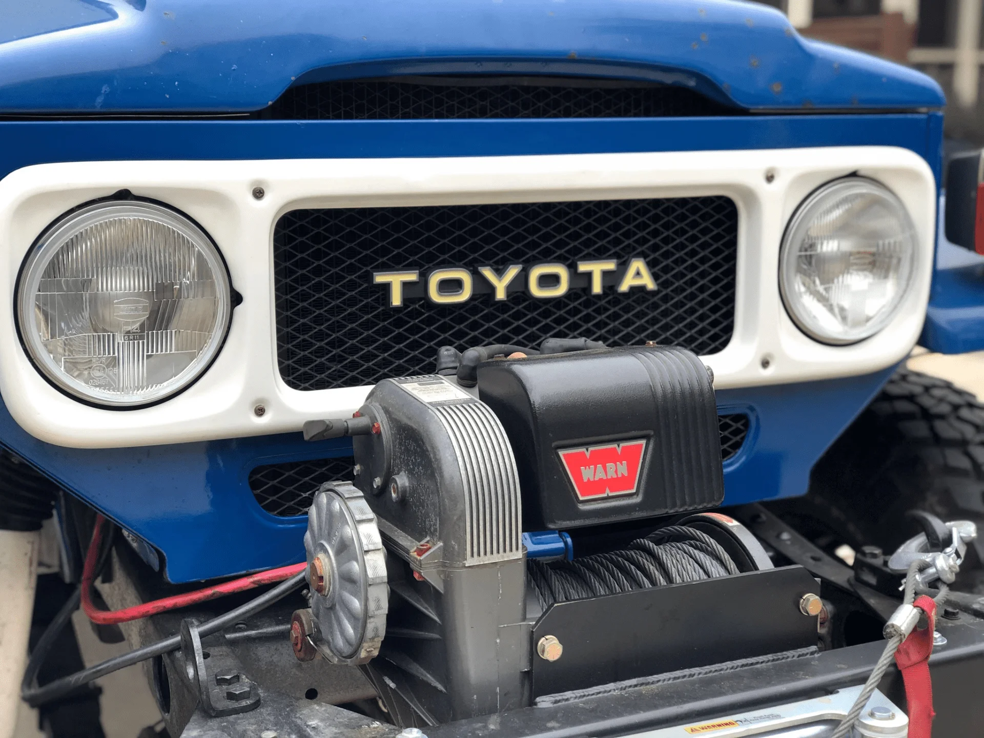

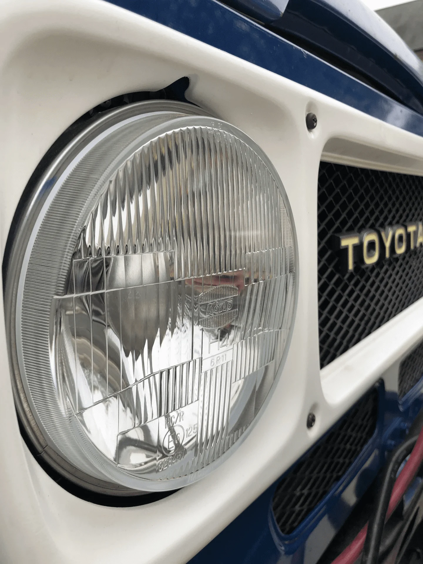

i would like to point out 1 unique fact , and feature . in all my R&D time prior to full kit production , i NEVER ran into another
JIS all glass lenses , all were plastic , now the facts :
- KIOTO H4 Lenses are FLAT like a table or wall , i never saw this feature either ?
- the flat jis glass if cast or crafted with many vertical flutes or lines in it designed to direct LUMENS down and to center of the
vehicle when properly adjusted to factory spec's fsm style
- some quick google , this is called a LIGHT HOUSE lens
- just like a natucal one on a shoal or point out at sea maritime
- well and behold , KOITO makes and has been making MARINE nautical lamps and lenses since wwII
see my example pics below , this is state of the art design modern features with a Timeless old vinatge look perfect for a FJ55
in my opinion

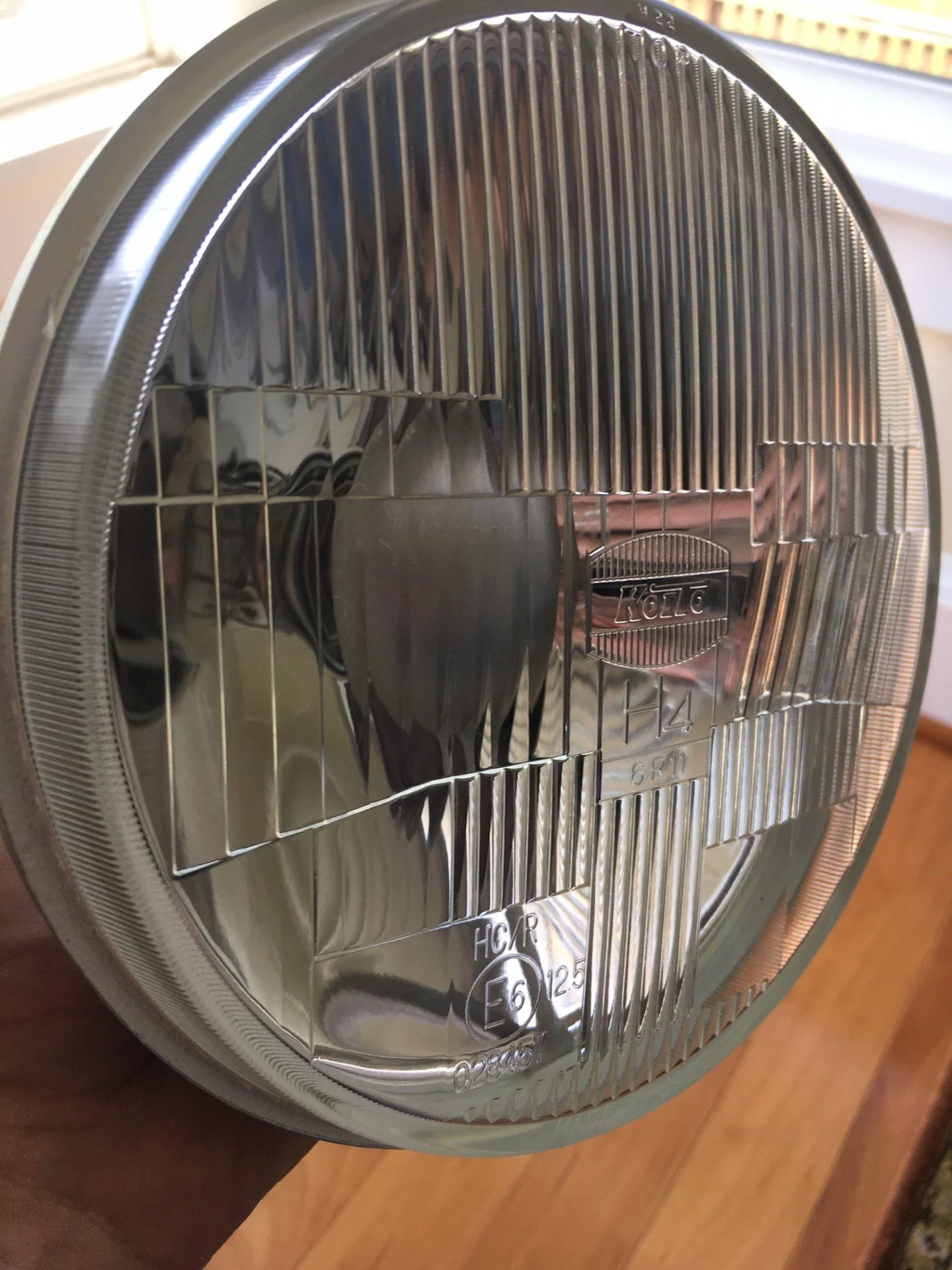

Just an thought here, but wouldn't the other manufactures who make LED headlights use the same fluted lens if it worked for the best for LED lights? I can't understand why they wouldn't after so much research and testing.
Matt, not sure why you are debating the Koito housing. I have them and they are very high quality. Quite frankly I don't like the flat lenses because original sealed beam Koito headlights had a rounded surface but I still think they are the best for the vintage look. You haven't addressed the issue your LED bulbs in the H4 housing projecting light too high and blinding oncoming traffic. Testing this feature would only require a professional headlight aiming meter like shown below. Again, all the components in your kit are super high quality, no debate there, but I suggest that the Koito housing with the Morimoto 2 stroke H4 bulbs would be "better" than your "best" because they offer a superior beam shaping and projection. We are on the same side here...just offering a potential suggestion on new bulb technology that may improve your already fantastic lighting system 👍. For everyone reading this thread, everything I have purchased from Matt has been absolutely fantastic stuff. He does spent a ton of time finding rare parts and developing great solutions. Matt has a true passion for vintage Toyota parts and great customer service. Don't hesitate to order from him!

not debating
educating
