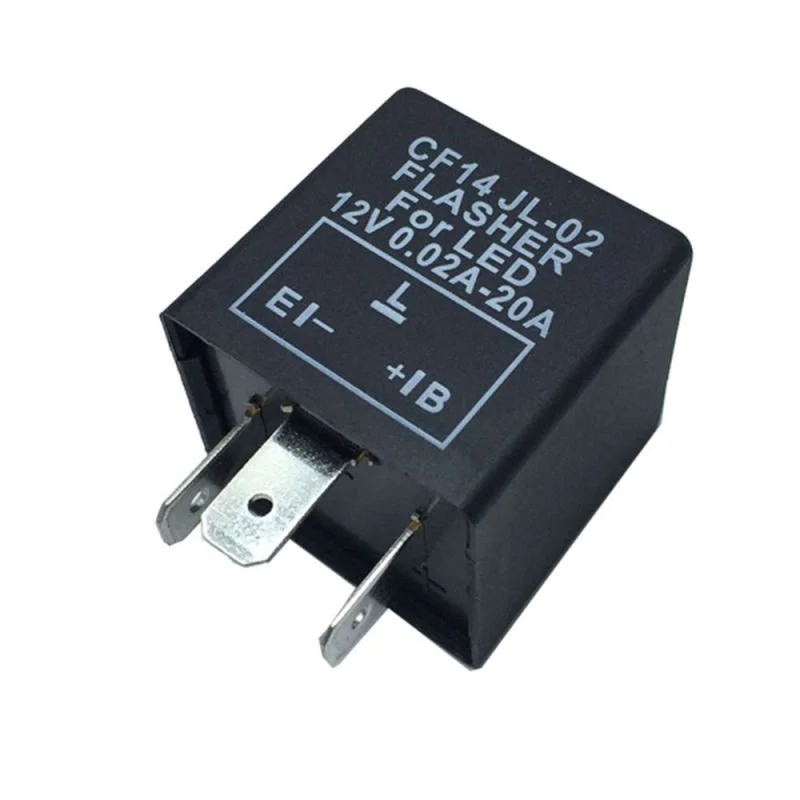

Should pull straight out. Below is what the pins on a typical flasher look like.
yeah, i have a replacement flasher i bought for LED bulbs. It looks like it should be straightforward and just pull out, but the original flasher is attached to some kind of adapter from what I've read in other similar posts. The adapter has retainer clips on it where the flasher snaps down onto it. But this whole assembly is in such a tight spot , i can't see if there is anything holding the adapter onto the assembly/board where it plugs in. Have you replaced yours? Did yours just easily pull out? Mine just doesn't seem to want to unplug at all and i don't want to keep pulling on it and end up breaking a connector or something and making another bigger problem to have to fix. That's why i was asking on here to see if anyone else had trouble getting it to come out when they replaced theirs.
