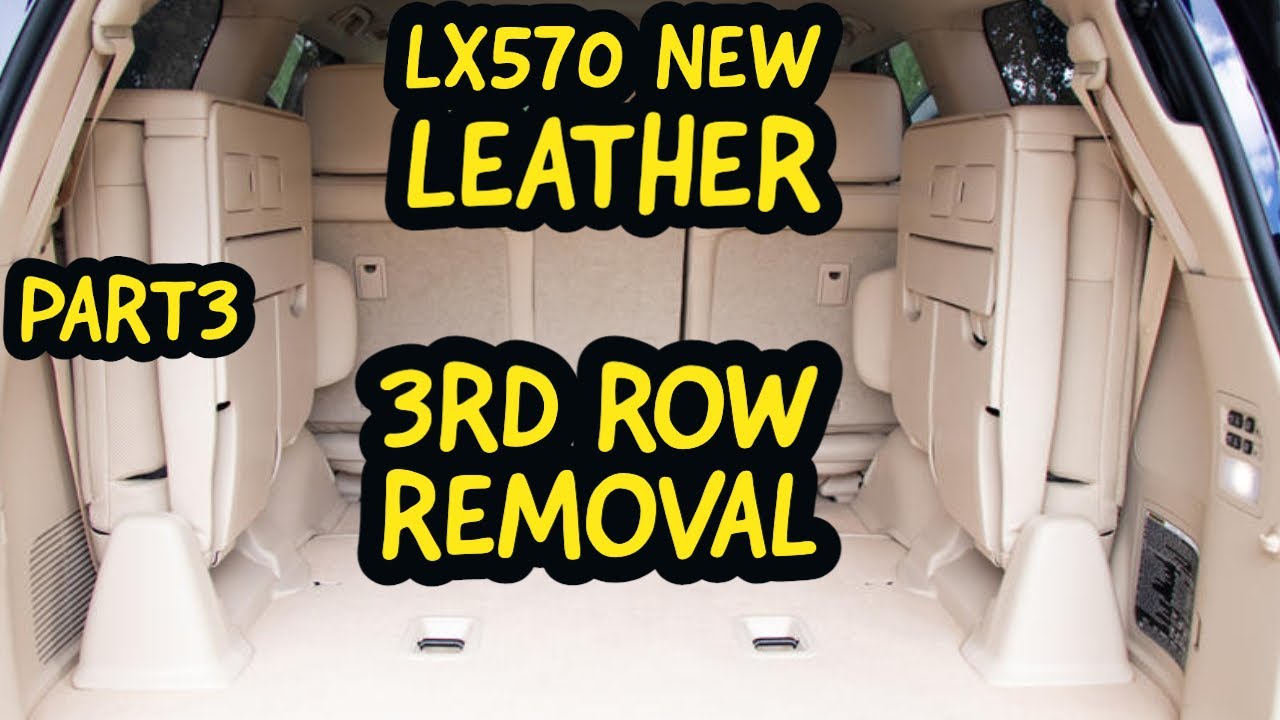

PART3:
Third row seat removal step by step video. I took my time to make sure I didn't snap any clips or pinch any wires and it took me maybe 30-40min. But after watching this video I think you can have them out in 10 minutes or less.

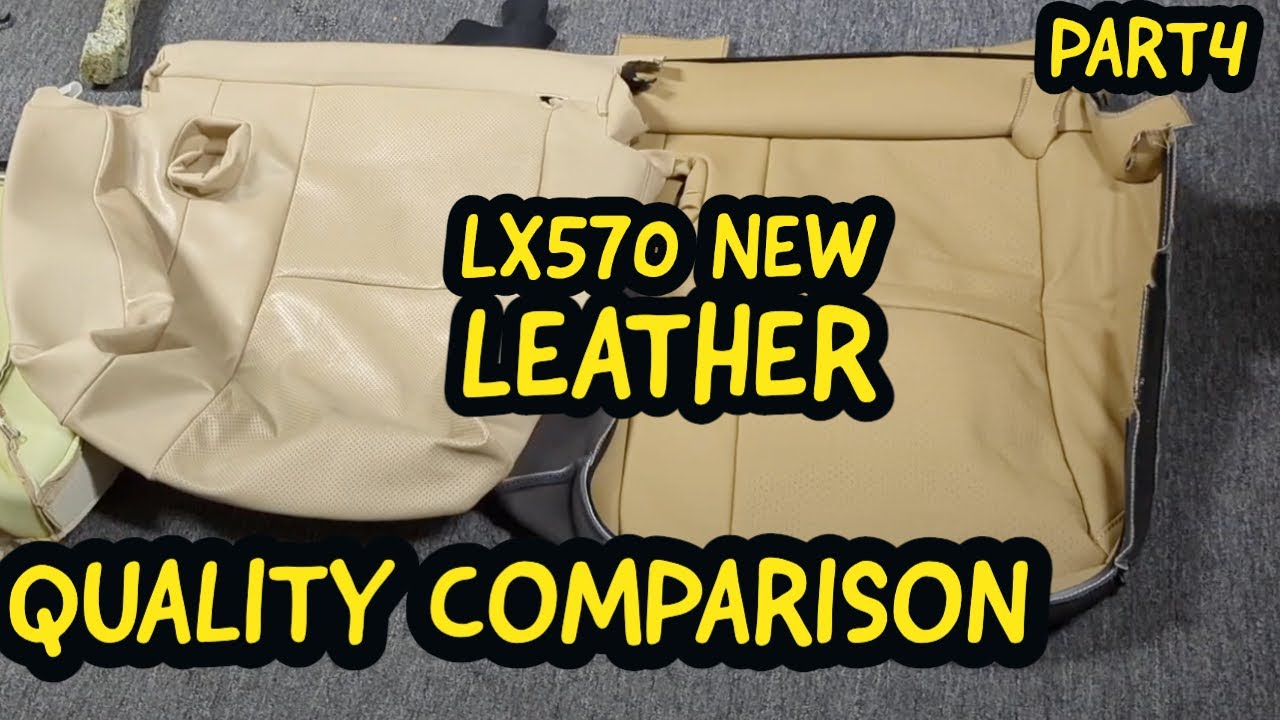

Part4 - Side by side detailed comparison of the LSEAT / LSEATS leather versus the factory OEM Toyota / Lexus leather

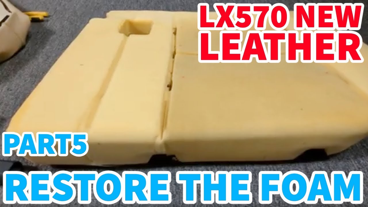

Part5 - How to restore the thickness, plumpness, and springiness back into your seat foam without having to buy new foam. I think this is a step that most people miss. And those that try to do it with small garment steamers may not be getting the full effects of having a high pressure steamer. Highly recommend you watch and don't miss this important step if you're redoing seats on any type of vehicle. Most foam I have come across is restorable, although some that are in very bad shape need to be replaced or added to. If you want to see the fast forward results in real time start watching around the 3:30 mark till the end.
Here is the high pressure steamer I am using: https://www.amazon.com/gp/product/B07PY2L1M6?tag=ihco-20

Not trying to sabotage @lx200inAR or anything but please reconsider recovering them all with LSeat. I used them for my 470 and was impressed for the price. That was a 320k mile beater that'd been rode hard and put away wet though. The quality of leather is abysmal compared to the semi aniline that's in your LX. I kept the 470 for ~3kish miles after recovering the seats and already saw wear on the bottom bolster.
Give your current leather a round or two of leatherique conditioner to get it nice and supple and ride it out.
