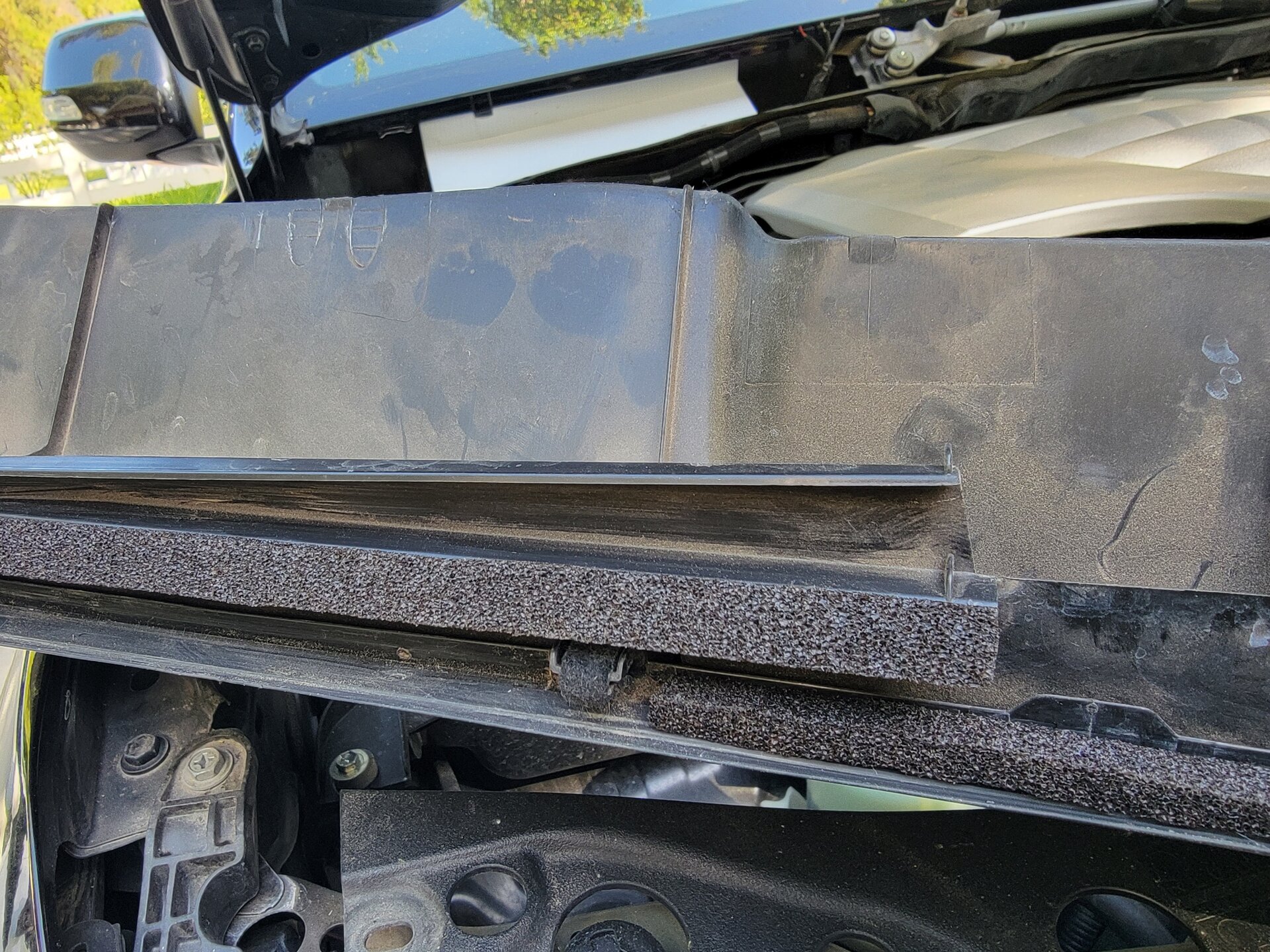

Just did this fix approx a year ago, followed what @CharlieS - @kwelhand - @lx200inAR - discovered and recommended. (THANK YOU GUYS!)
Our 22/23 winter rains were relentless in SoCal and a couple weeks ago we had a Tropical Storm from Mexico (dropped 7 inches of rain in 24 hours)

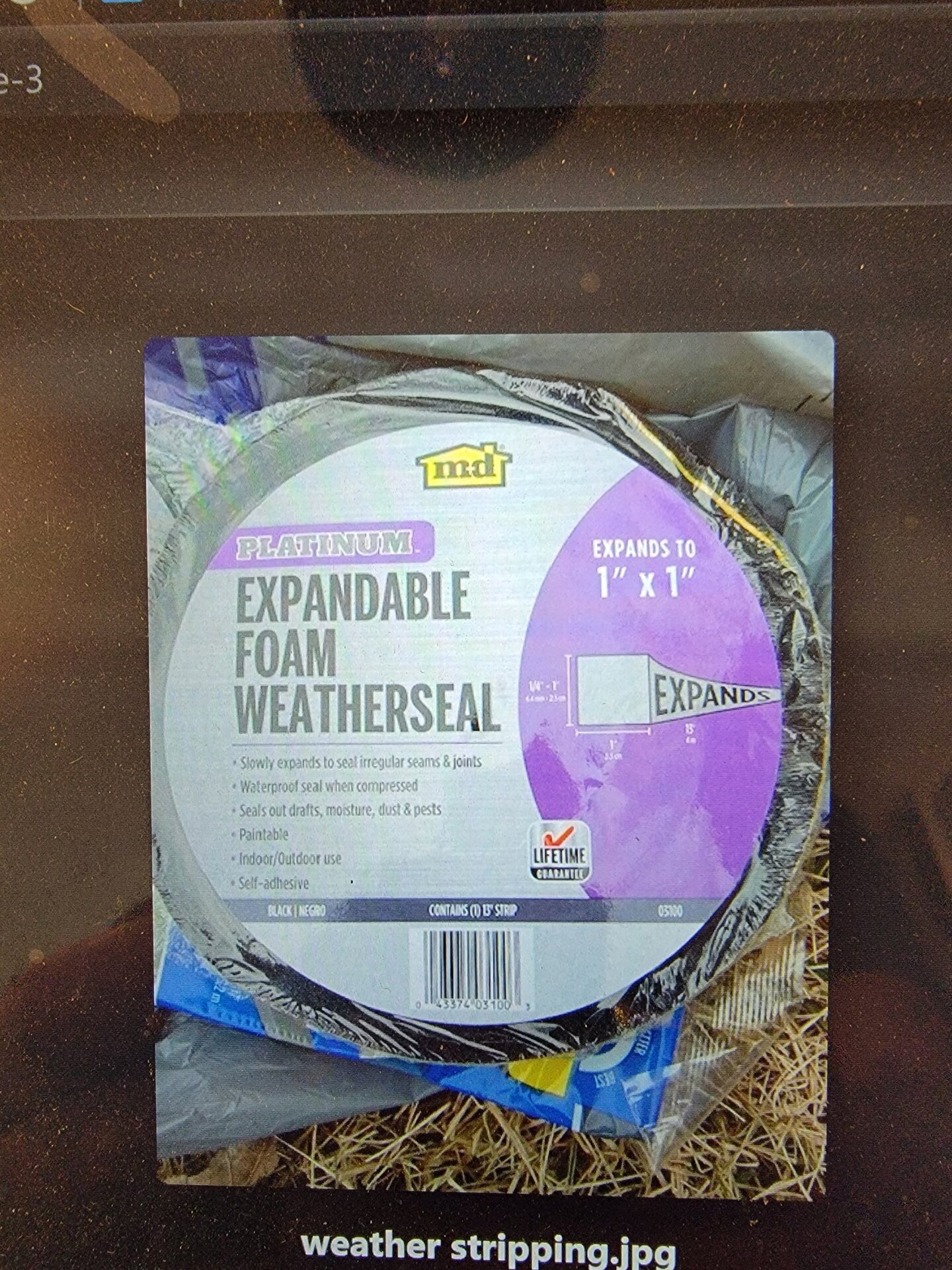

I did add a 2 inch thick length of expanding foam to the back of the white cover to help give it an extra air gap above the factory metal
Not a single drop in the passenger footwell
