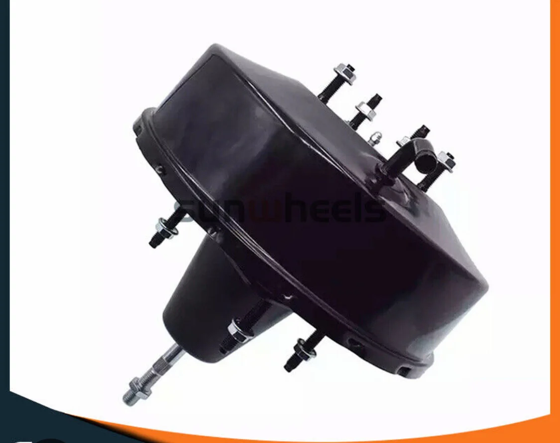

4. Brake booster replaced (A black round device)

You did not say, why your "black round device" replaced?
I assume this was booster "motor". But if you don't have ABS. You may have a vacuum assist master, which doesn't have a motor.
Pictures of your master will help?
The threaded rod is used to adjust pedal free play. I've never adjusting with excessive pedal free play, so not sure of outcome. But not likely your issue! Just check free play. Which is how far pedal travels, before resistance (move rod/plunger) felt: 1mm to 6mm is standard.

Thanks for the inputs, i replaced the brake booster thinking that might be causing this issue. There is a rod adjustment in this
So you've a vacuum assist system. I work with electric booster assist only. Sorry I can't be of help.

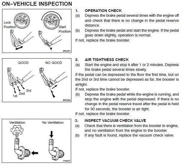

I would check for vacuum coming into the booster. And then do a booster test. The LSPV is also prone to internal rust on older vehicles that haven't been maintained.

I know you said you installed a new booster but…. Once again, check the brake booster and especially the one way valve going into the booster. If aftermarket, many are bad. With a gauge, check how much vacuum the hose is pulling, should be 20hg at least.
If you or your mechanic have a handheld vacuum pump, hook it into the booster.
