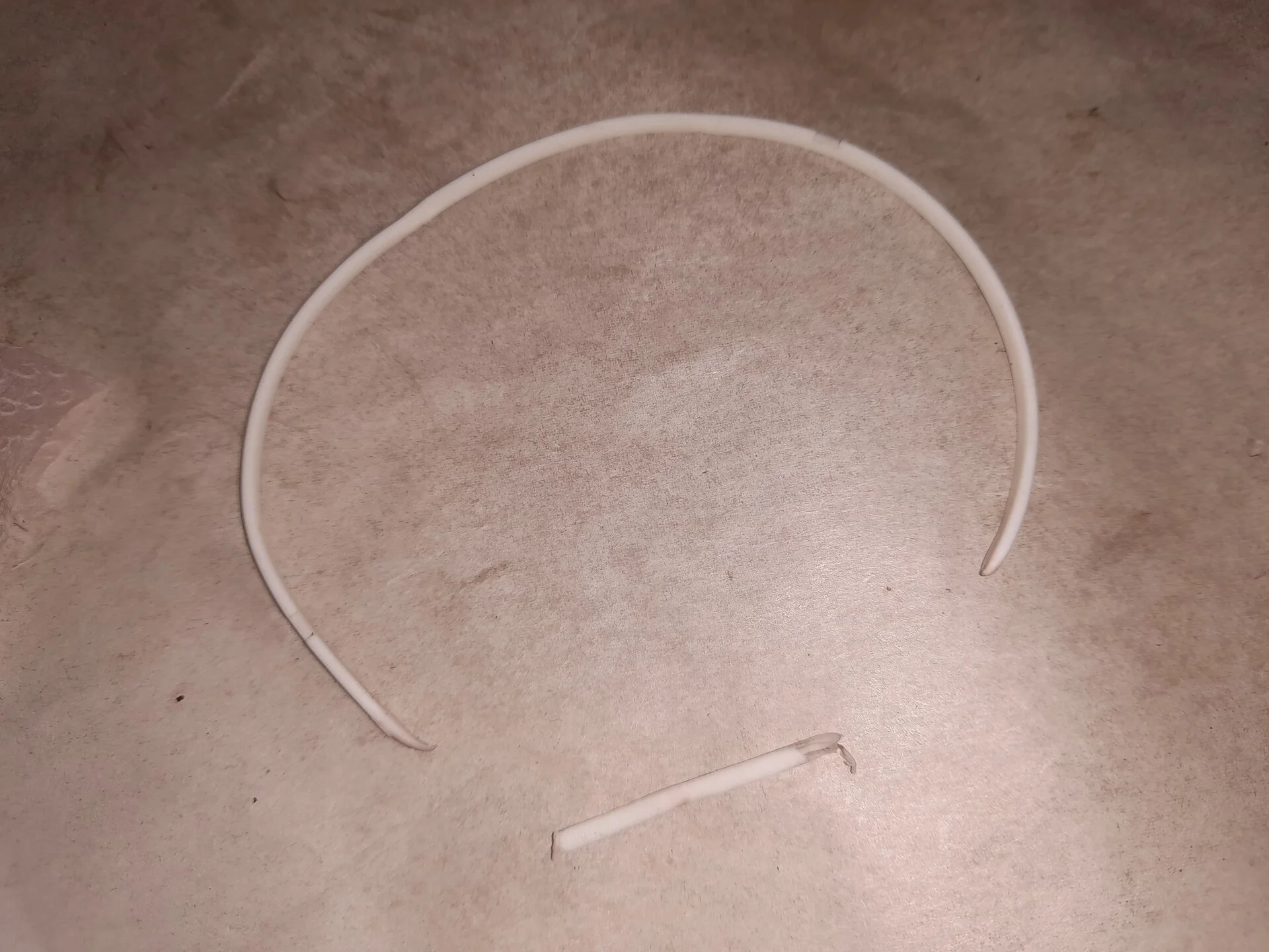

The tricky part on assembling these pieces is getting the teflon ring snug against the O-ring in the bore at the front of the power piston during insertion. The entry to the gear housing is chamfered, making that bit easy. It's the knife-sharp edge of the forward bore which is hard. There is a lot of resistance to pushing the piston in by hand, so careful control is needed.
Of course, I went in too fast and guillotined the teflon ring cleanly into two pieces.
Second attempt - after waiting for a new teflon ring to arrive - was successful. The trick was to drive the piston into the gear housing using one of the valve housing bolts, tightening in tiny increments and making sure the teflon ring is seated under the sharp edge of the bore. The picture shows the power piston past the hang-up point in the gear housing.

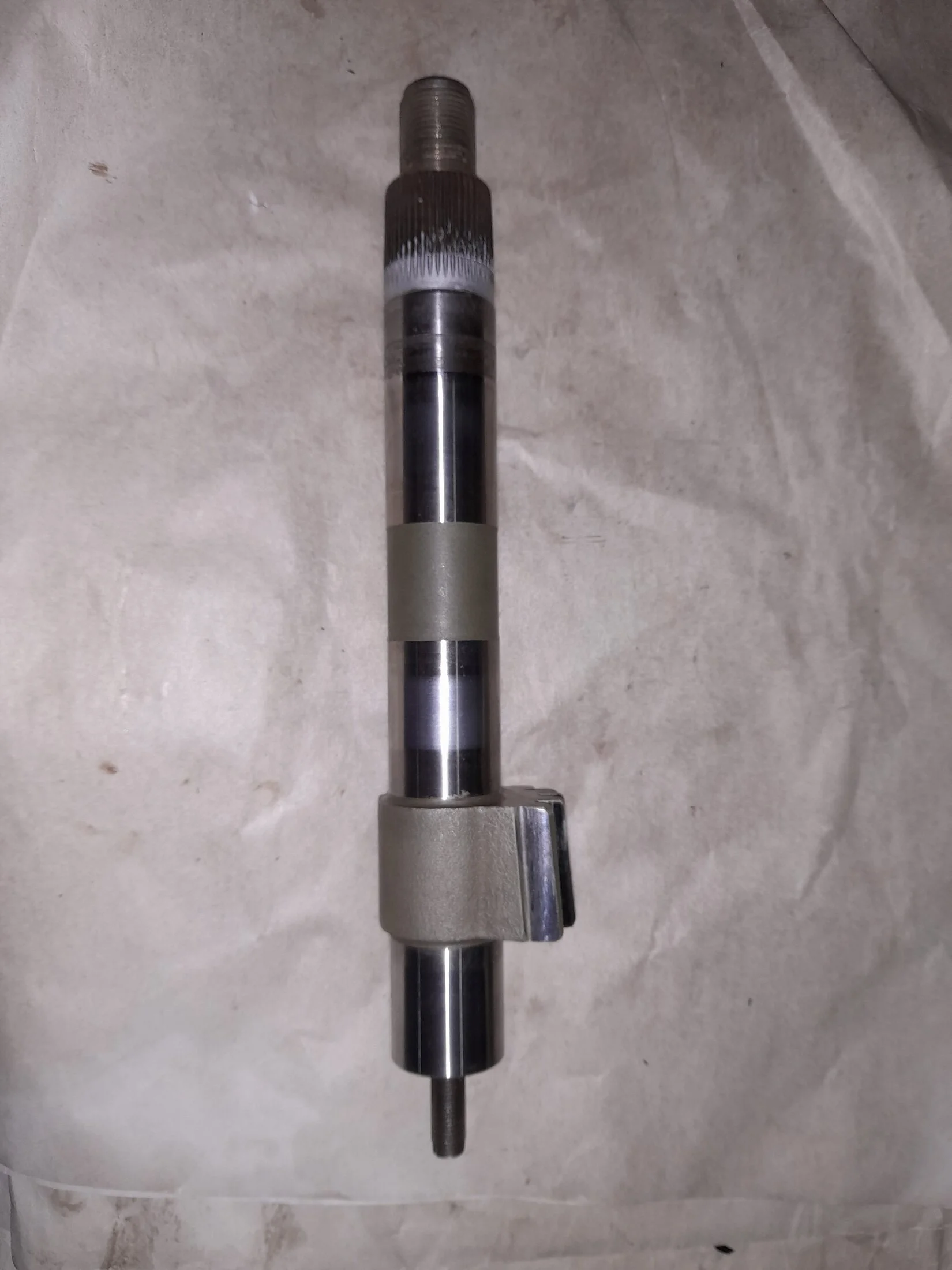

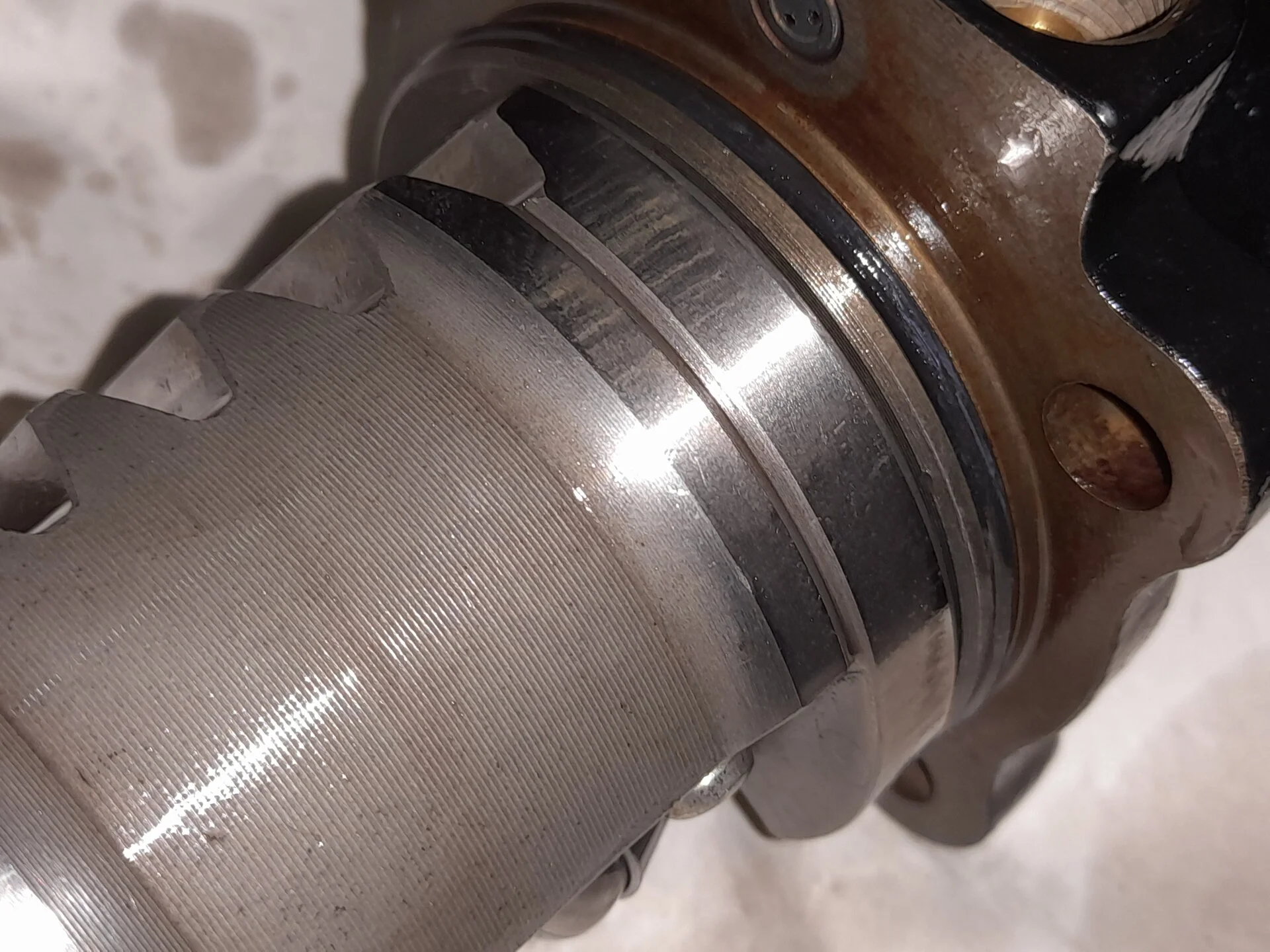

My big question is assuming you change the sector shaft for new, where is most of the wear? Is it on the rack? I've just splashed out on a new (expensive)105 box for my petrol 80 here after trying to get several 80 boxes to perform better.
Hi John
The sector shaft is fine in mine - I only replaced the adjuster bolt and lock nut to minimise free-play. This is an original 60 box which seems to be in great condition (it is not the original from this vehicle). Also, the 60 shafts do not have the design flaw of the 80 shafts where the splined section of the shaft inexplicably narrower than the main sector shaft.
I believe free play comes from wear in the teeth, which obviously is not repairable, and the adjuster bolt being too loose. It should have no detectable (by hand) end float, but move freely. They are cheap and relatively easy to replace.

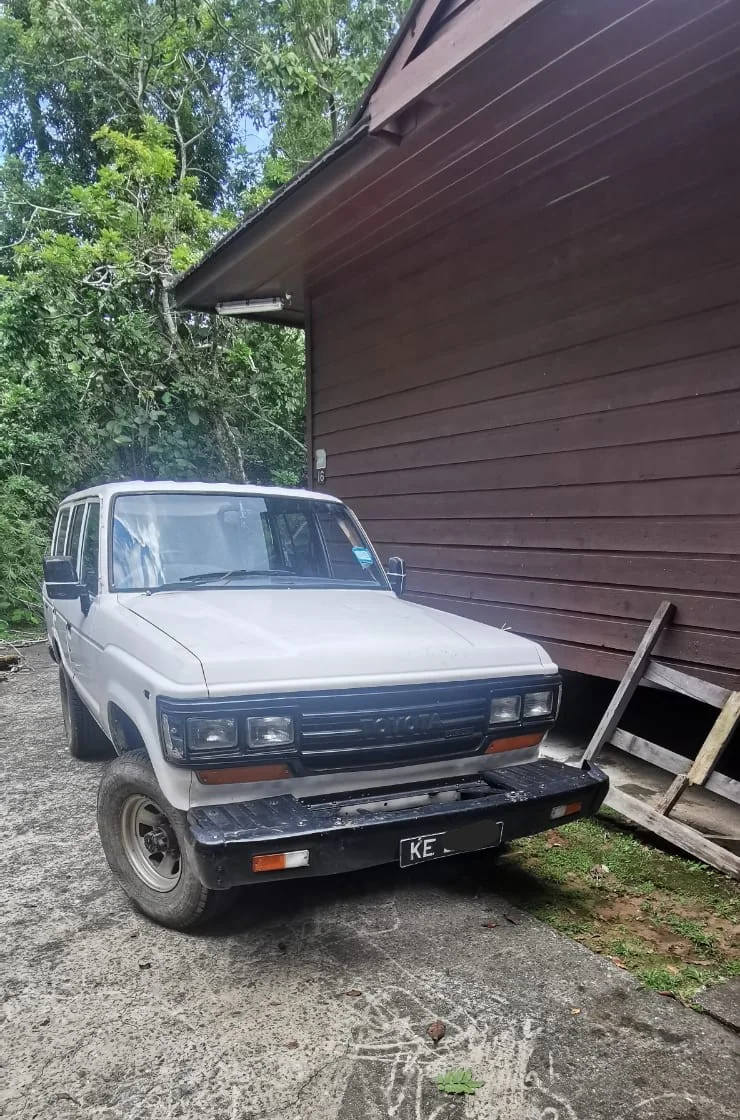

I don't think I had ever seen a power take-off (PTO) winch on a Landcruiser before I came to Borneo, but I loved the idea. With the ultimate aim of taking this vehicle all over Africa, I feel a winch would be a good addition, and my dislike of all things electrical on a vehicle, and my aversion to modifications meant a factory PTO setup was something I dreamed of puting on this BJ60 build. The difficulty was in finding all the parts required - from the chassis extensions and brackets to make the 'porch' type front bumper arrangement (which I love the look of) to the winch itself, the correct set of drive shafts and chassis brackets, the PTO box, the engagement lever and knob, the rubber gaiters and the mounting piece which is welded into the floor pan.
PTO winches are usually found on high-spec JDM 60s with fully chromed porch bumper setups. They were also an option on (only left-handed) European 60s, and in General market models. I believe they were not an option on Australian 60s and definitely not in the US, though I am not sure about Canada. Here in SE Asia, they were an option on the ultra low-spec BJ60. According to my friend, there are just two BJ60s in Brunei with factory PTO winches and bumpers - one of which belongs to his brother. These were actually ordered back in the 1980s by the company I work for here.
This vehicle is in pretty worn out condition, and my friend has retained the winch. It is exactly the same model as mine, made about 3 months earlier (04/1989). His brother is selling the vehicle, so my friend asked me if I could save the winch bumper. Note that the indicator/marker lights in the front bumper are not original.

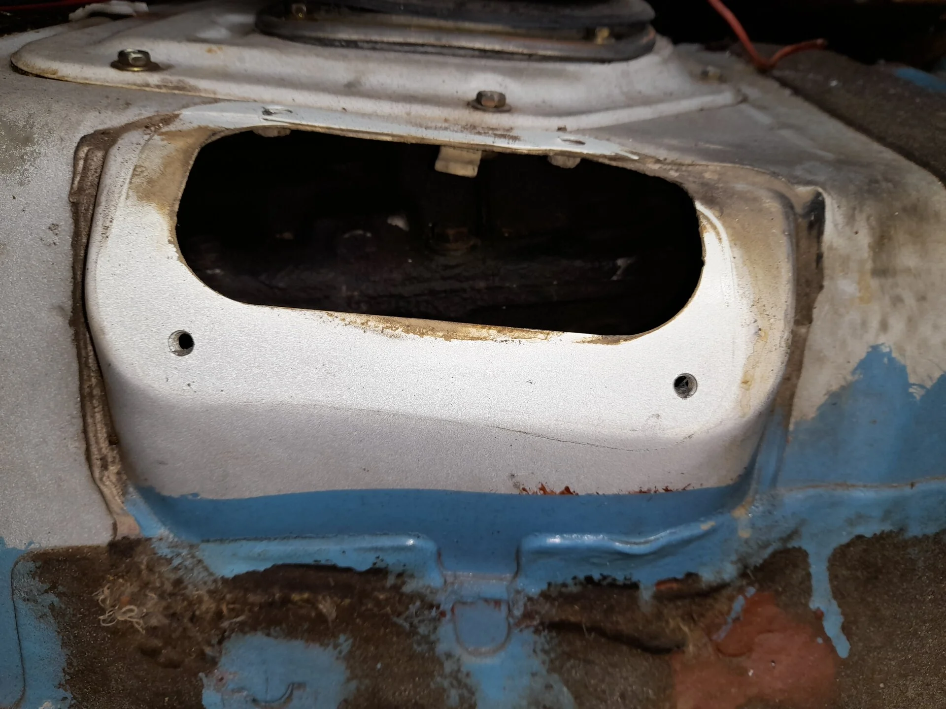

He also let me remove the PTO shifter base and gaiter from the floor pan, so I drilled the spot welds, made a blanking plate and welded that in, followed by seam sealer. This is the later style (08/1987 on) base which has a different bolt pattern from the earlier one. You can see a clip on the outside surface of the base to keep the speedometer cable away from the PTO lever assembly.
I took all the brackets and plates off, made standard sized bumper brackets, then put the bumper back on as a standard bumper. Note that although it has been repainted in black, the top plates on the porch bumper are not chromed, but were originally silver. The bumper would similarly have been gun metal coloured, like my standard bumper. When my friend came to collect the brackets a couple of weekends back, hearing that I was after such a bumper setup, he gave them to me on the spot! I was delighted!

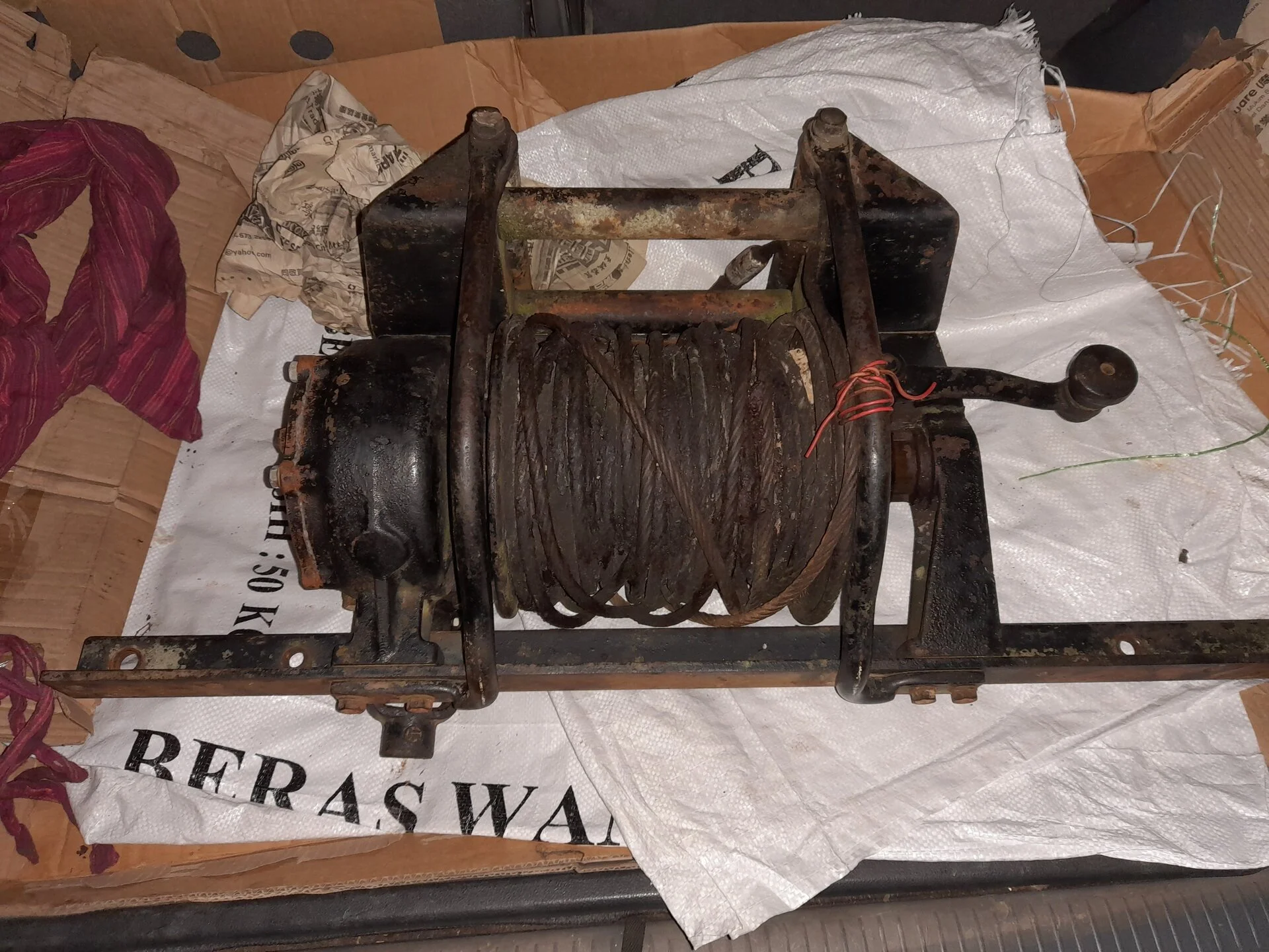

A week later, the same friend forwarded me a fuzzy picture of a PTO setup for sale here in Brunei. After a short drive into the interior after work last Tuesday, I found a full PTO setup in great condition and bought it immedialety.
The winch, with original hook and cable. Dated 08/1986. All moves quietly and smoothly, and is well greased. Too heavy to lift out of the boot of my RAV4! The winch end cover has clearly been removed and refitted (upside down) with silicone and only 5 out of 6 bolts. Hopefully no horrors when that gets stripped down.

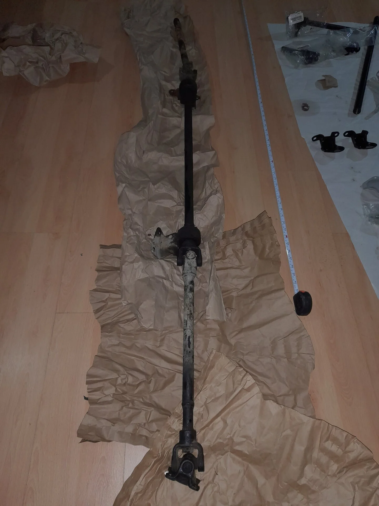

The three-piece shafts used on 07/1986 onward 60s, with the two pillow block mounting brackets. Splines are good. Pillow block bearings are shot, some of the UJs are worn, all have hardened rubber seals. Only issue I see is that the shear pin holes have been drilled out to about 7 mm. (standard was a very weak 4 mm on the 60s, increased to 5.2 mm on the 70 Series). I'll need to think of something to remedy that.

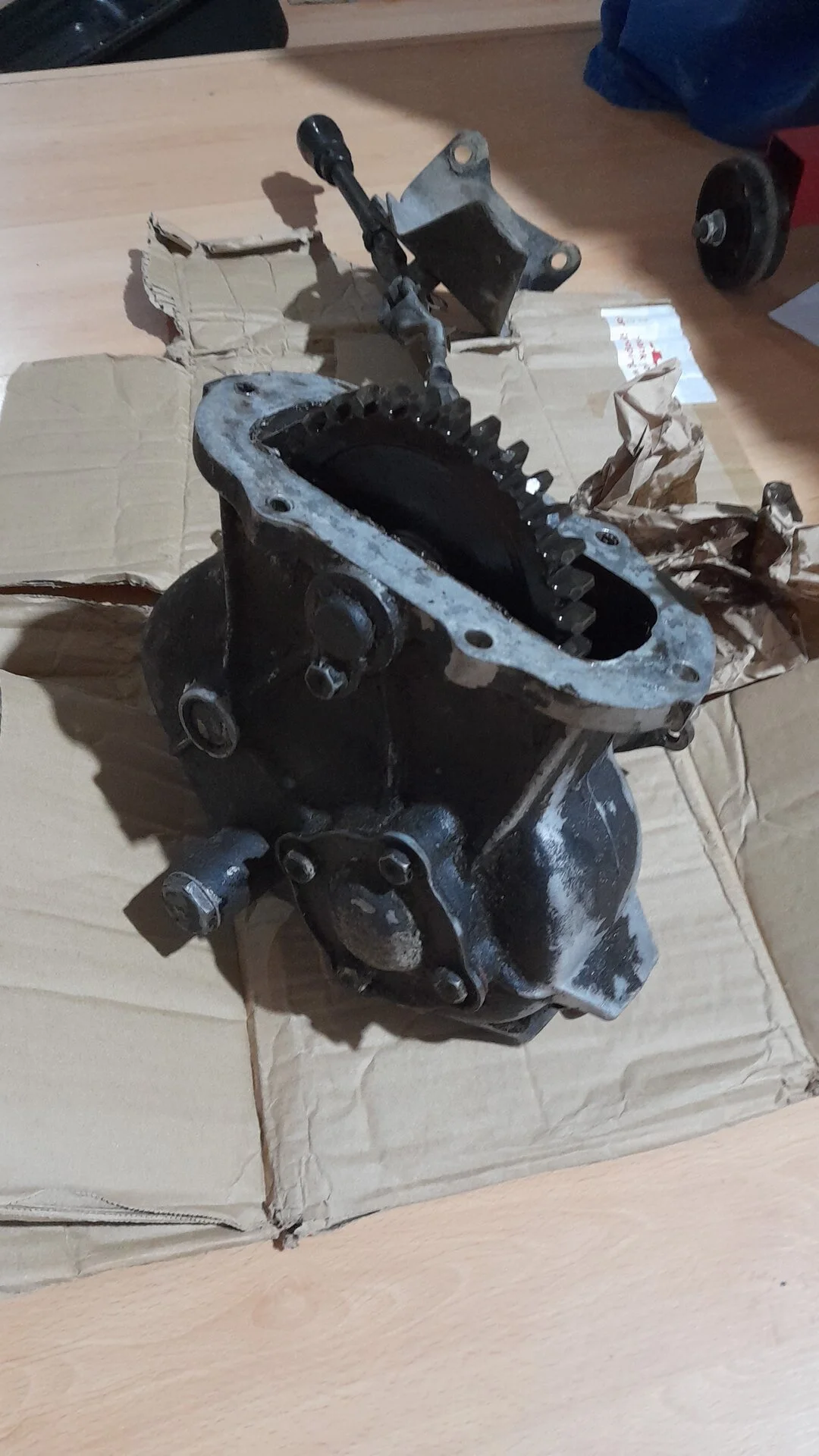

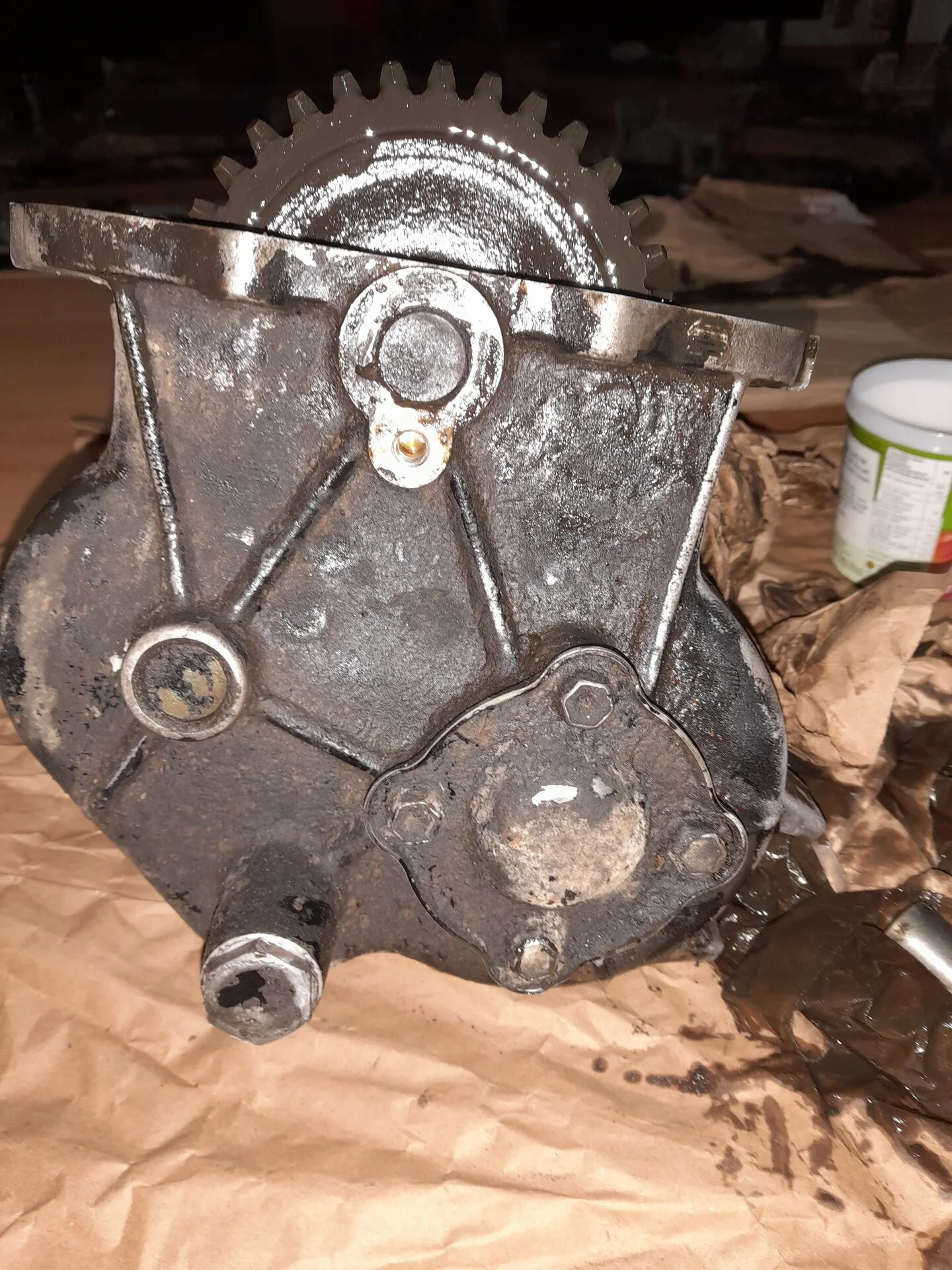

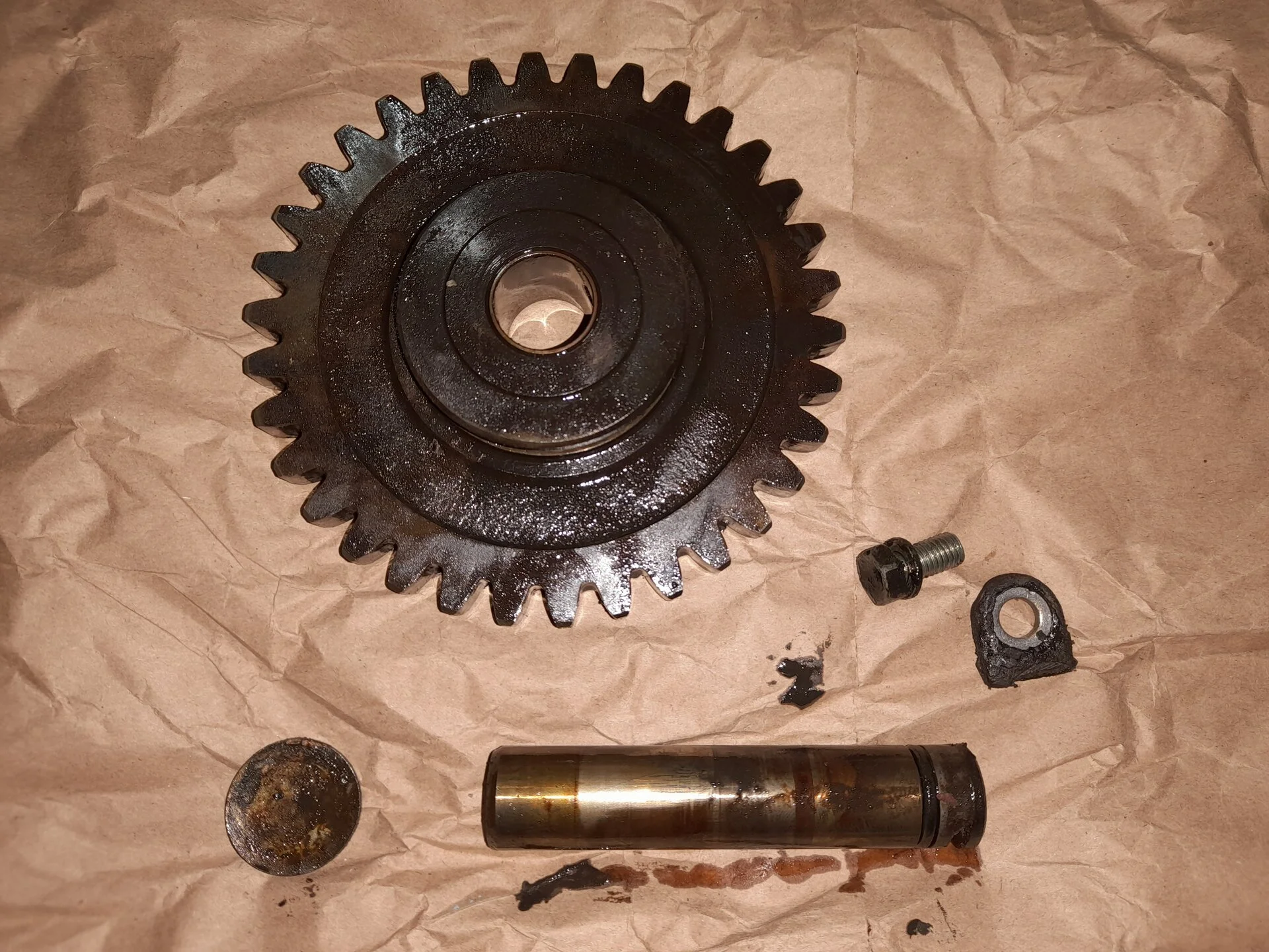

PTO box disassembly 1
I started to dismantle the PTO box shortly after I got home with it. I'm not sure if I have a section in any of my FSMs for the PTO box, but it's so simple that it shouldn't be necessary.

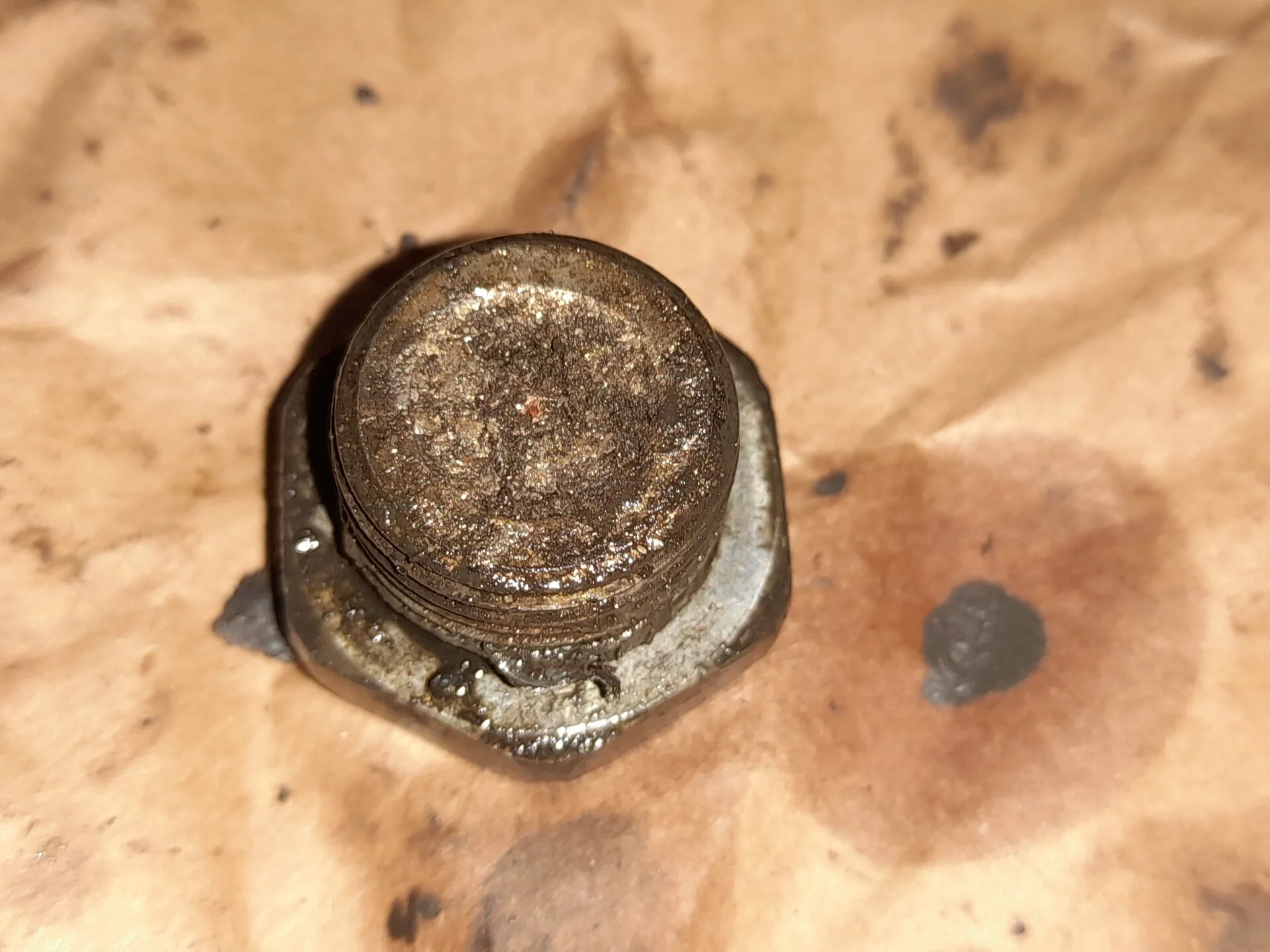

Removing the drain plug (note this is not magnetic, but the same as the filler plug, with a ca. 10 mm deep bore on the inside of the plug) showed it to be absolutely packed with yellow metal flakes. I'm glad I did not buy the transfer case that this came from!
After draining some filthy oil out of the case (I think it could barely still be called oil - it looks like the crap that comes out during a swivel housing service of a solid front axle with blown oil seals), I removed the PTO link lever, connecting pin, spring washer and cotter pin. All these items are still available from Toyota, except the link itself.
Remove the locking tab and M8 bolt from the rear of the input gear shaft bore...
...then with a hammer and brass drift on the back of the input gear shaft, drive out the front blanking plug. Don't push the (most likely corroded) exposed end of the shaft through the brass bushing of the input gear. Instead, push the shaft out towards the back once the plug is out. Out of this lot, only the blanking plug and bolt are still available.
Next, remove the locking tab and pull out the link lever shaft. Only the bolt is still available from this lot.

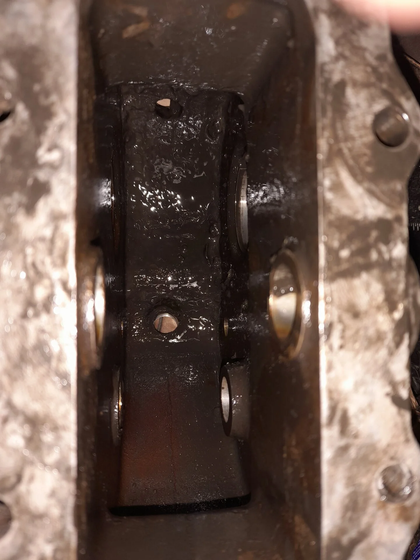

PTO output gear and shift for assemblies exposed, and the filthy insides of the case.

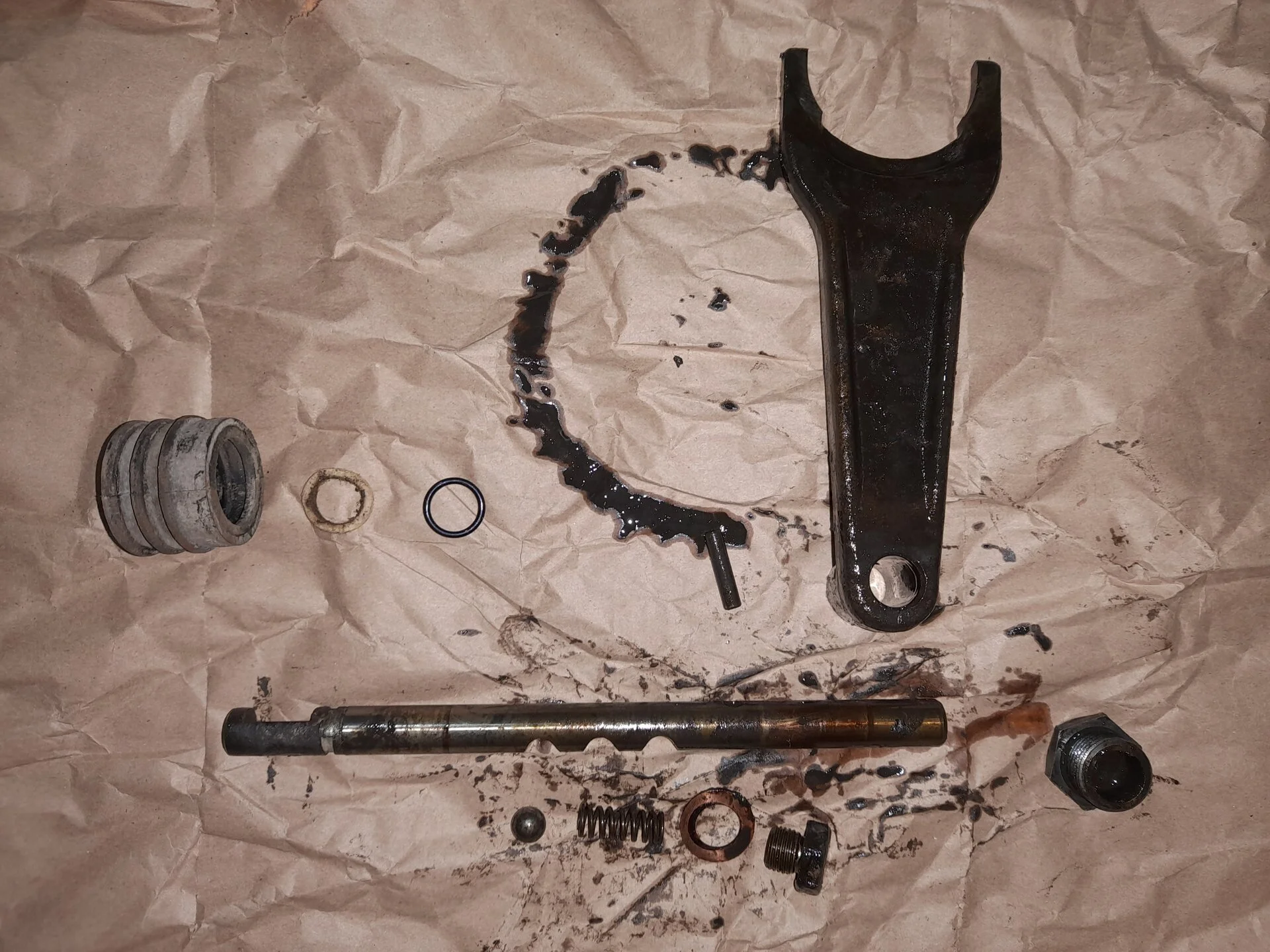

Remove the shift fork shaft detent ball plug, then remove the copper gasket, spring and ball. Then remove the nearby (mangled in my case by some bodger trying to remove it by hammer and chisel) filler plug.
Turning the shift fork shaft slightly aligns the end of the slotted pin in the shift fork.
Drive the slotted pin out, pull out the shift fork shaft. Inside the bore is a felt dust seal and a rubber O ring. Remove these carefully. Remove also the 20 mm plug from the rear of the shift fork bore.
The entire parts pile for the shift fork shaft. Only the rubber boot, felt dust seal, detent ball, slotted pin and copper washer are still available.

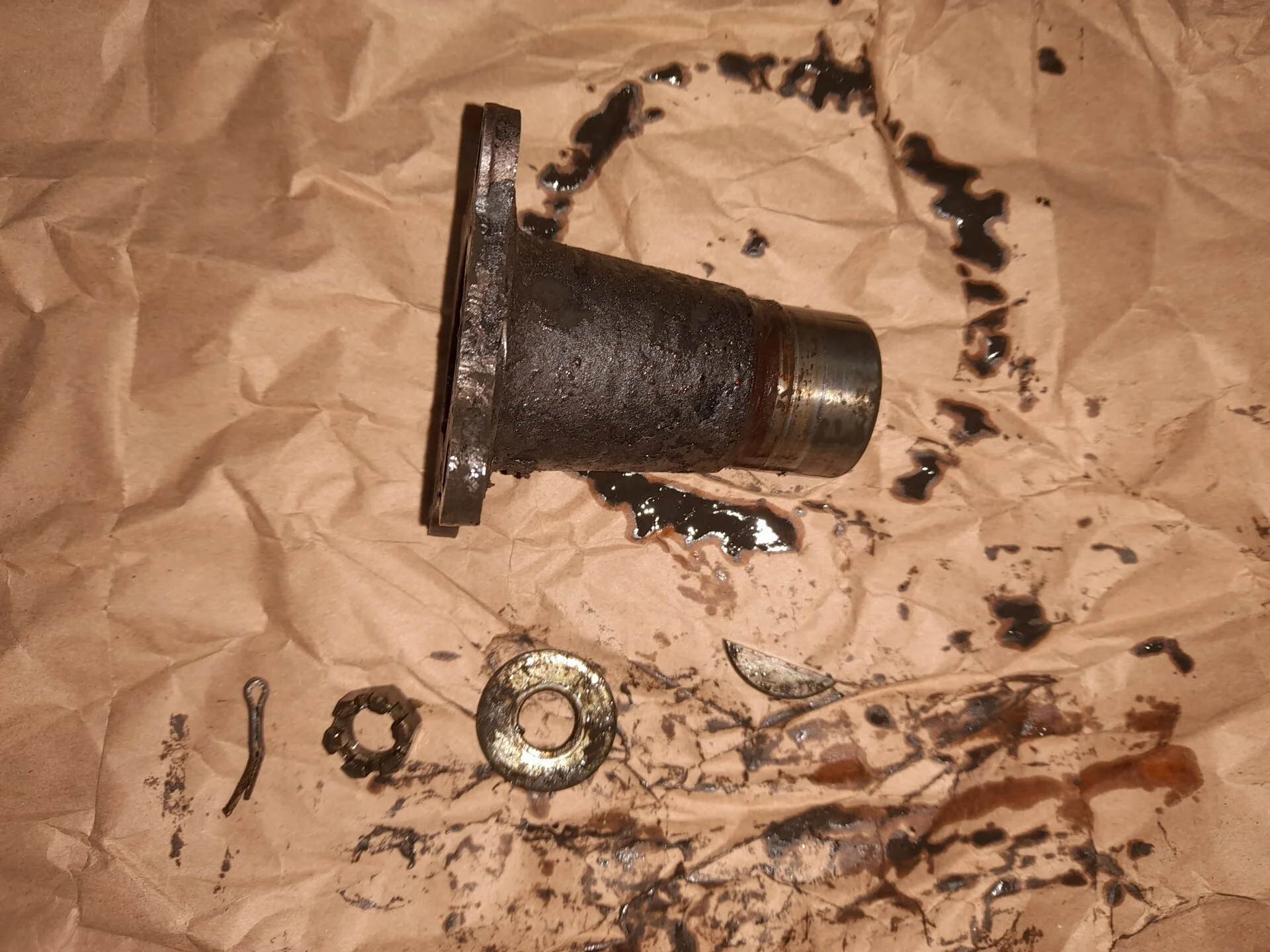

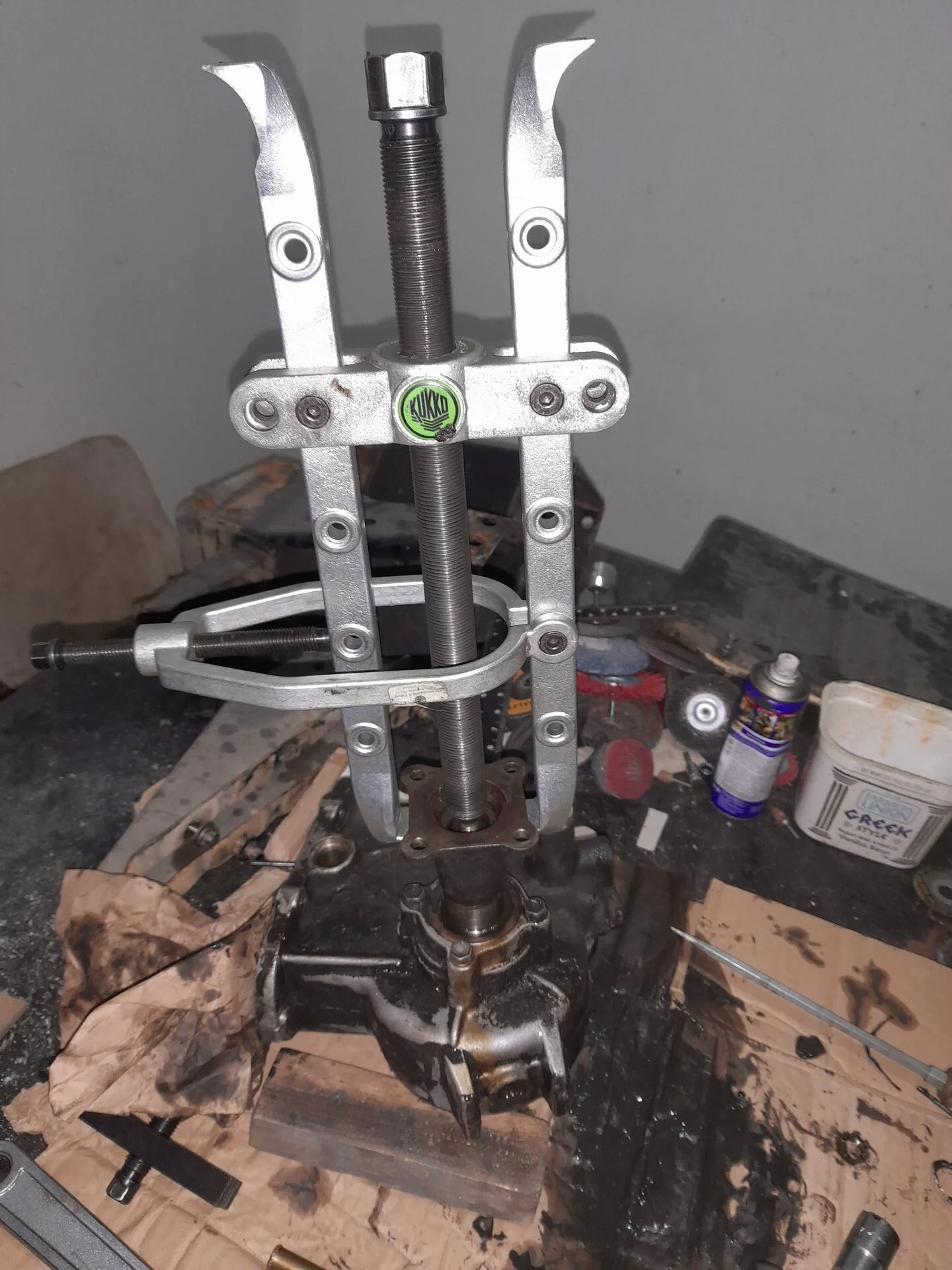

Now it's time for some fun with my favourite tool! With the washer, castellated nut and cotter pin removed, I pulled the flange off the shaft. It's a long interference-fit section on the shaft, so needs a good long puller.
Flange, woodruff key, washer, nut and cotter pin. Flange and washer NLA.

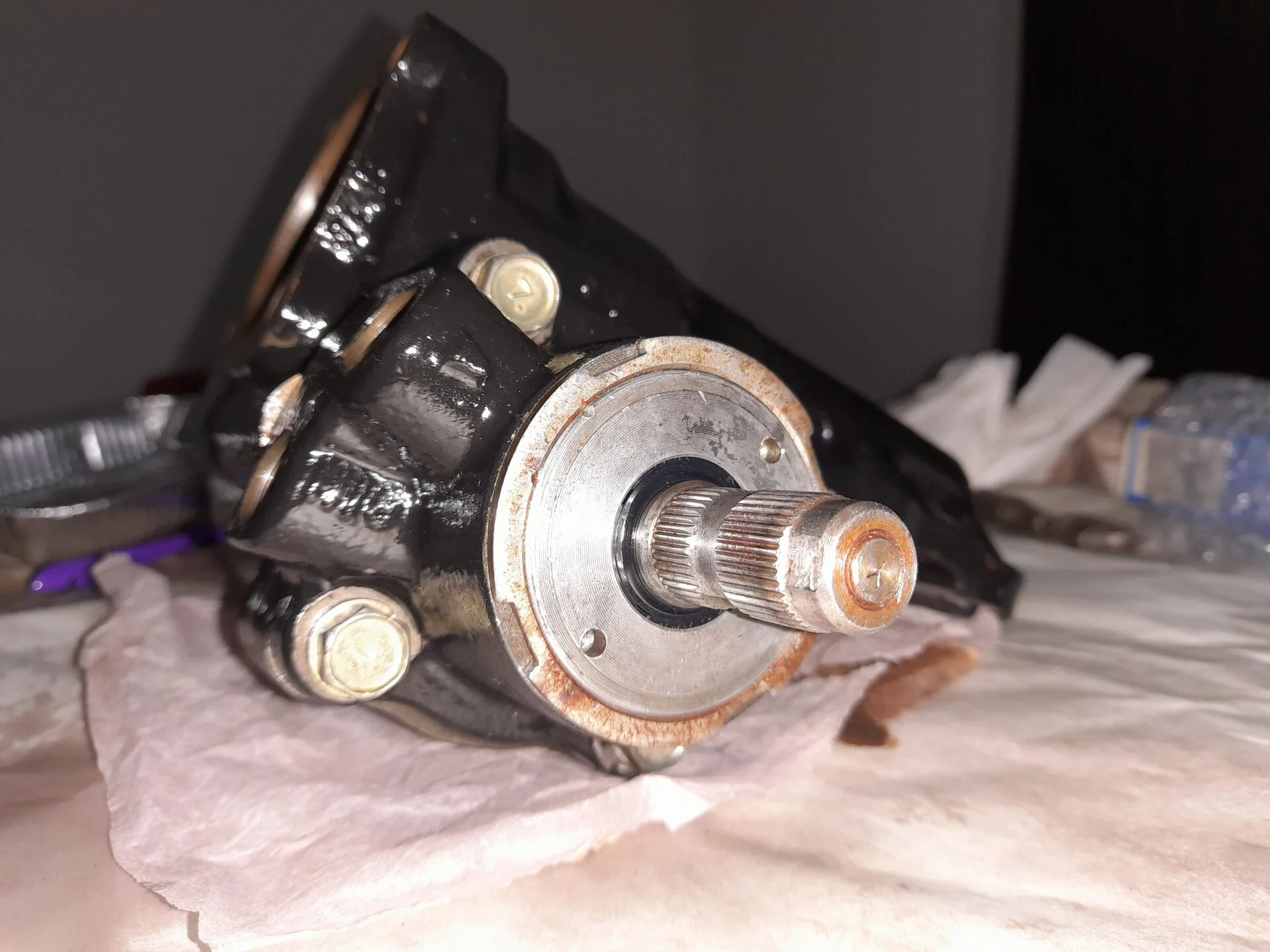

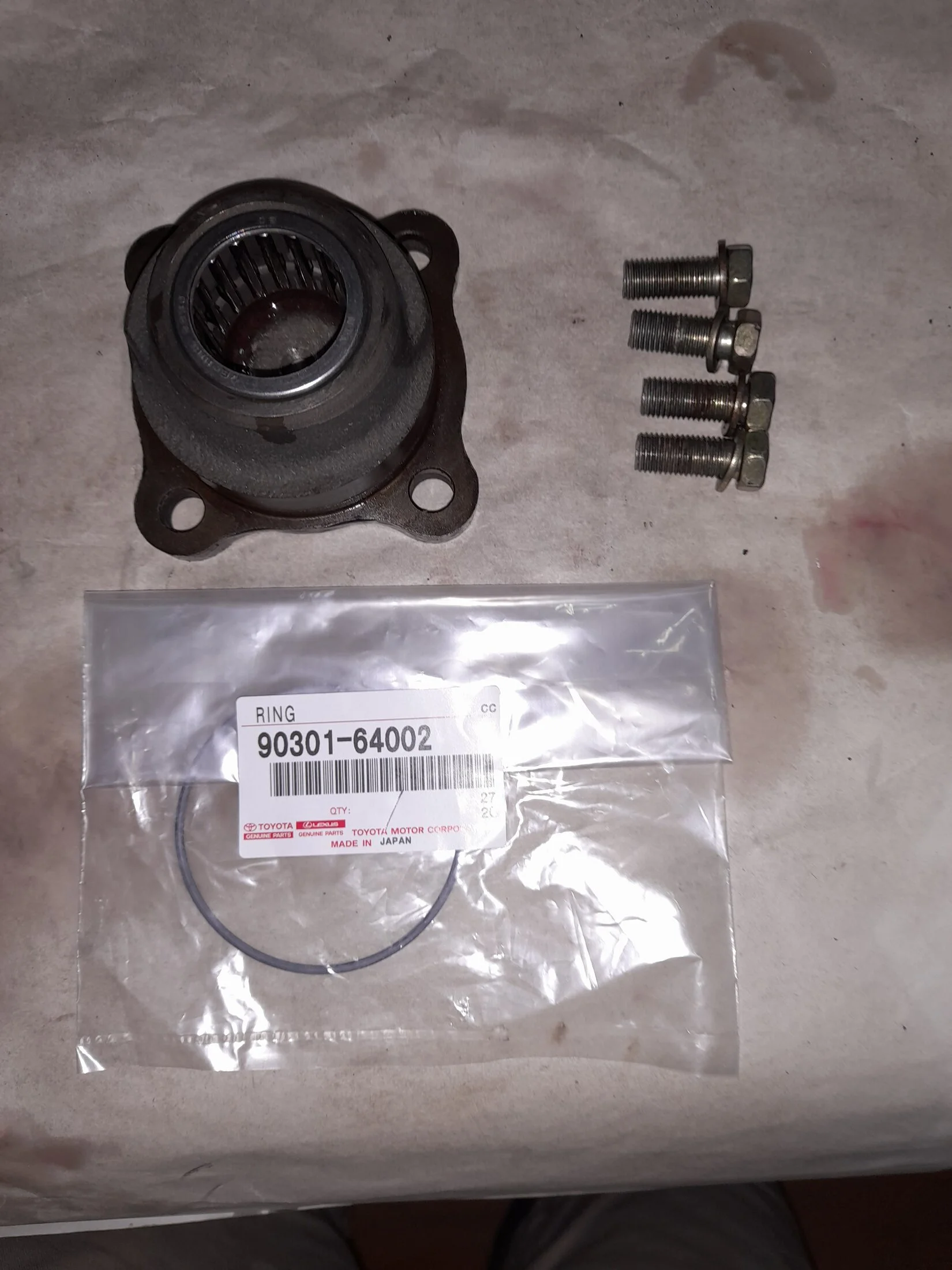

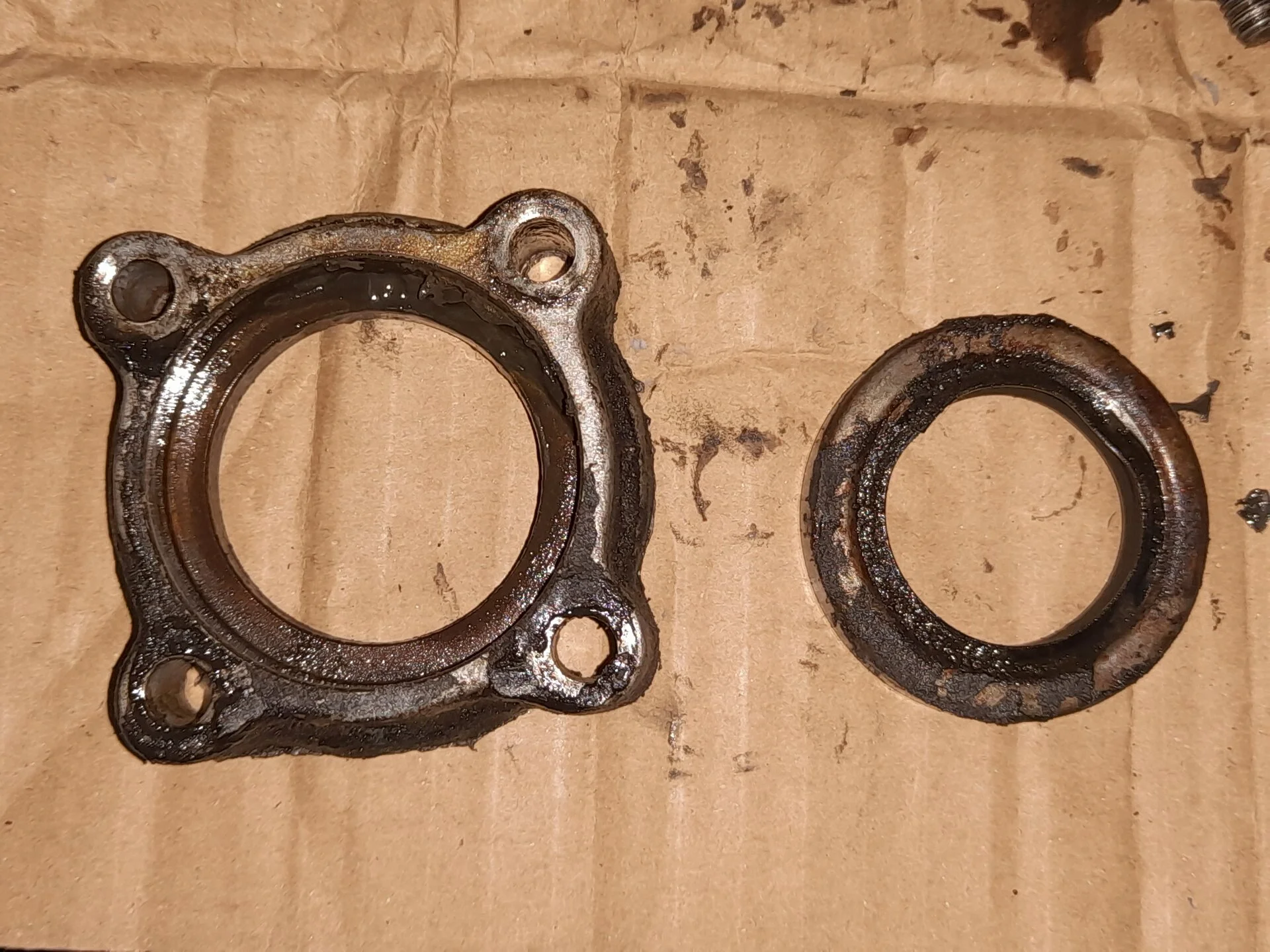

Remove the four 35 mm M8 bolts and tap the front bearing retainer off with a soft hammer to expose the front output shaft bearing...
...then knock out the old oil seal. Oil seal thankfully still available, as is the paper gasket.

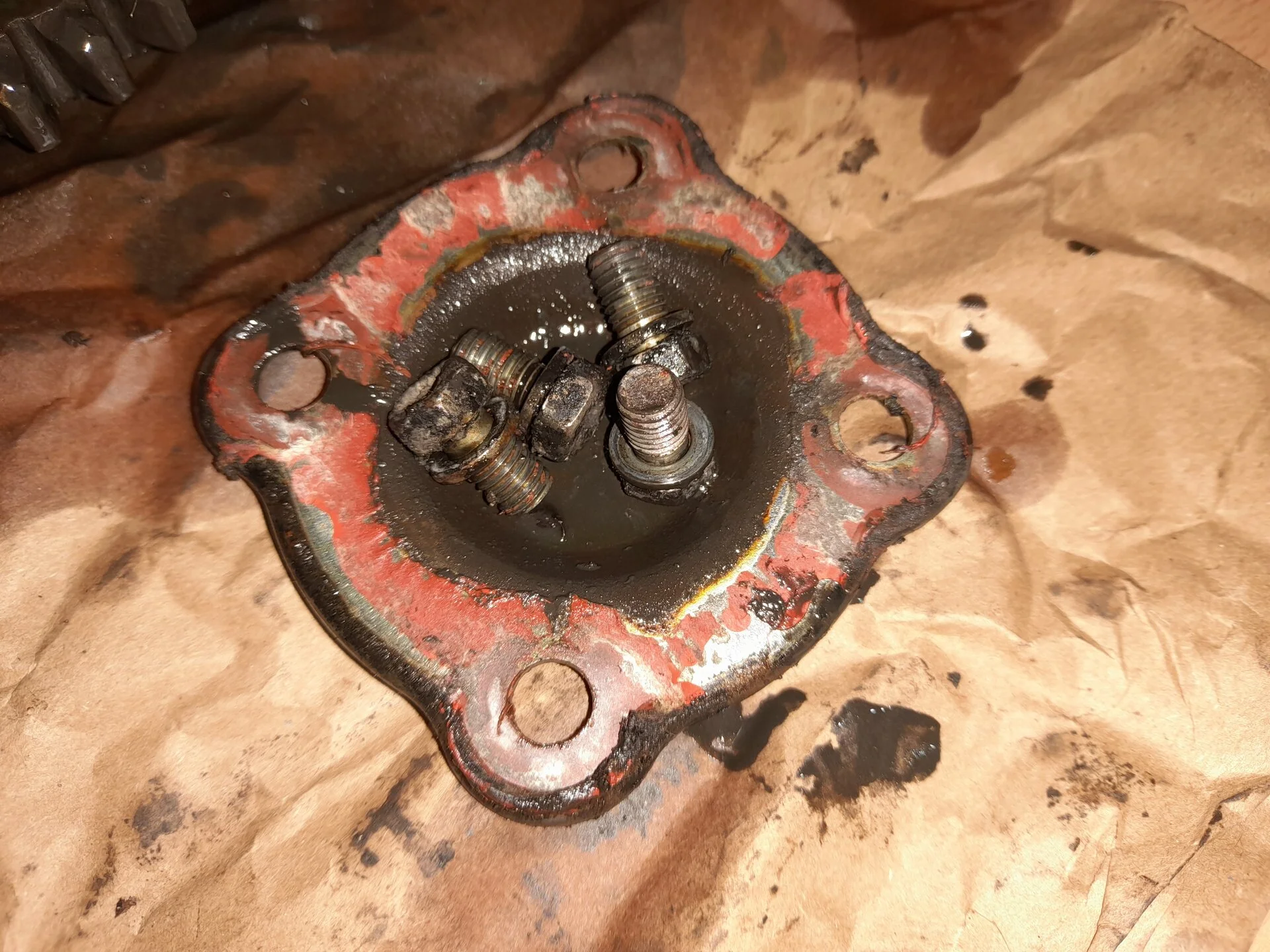

Remove the output shaft rear bearing cover. This should be sealed on, similarly to the rear input shaft bearing cover on the transfer case, by a cork gasket. Toyota have generously dicontinued this gasket, so I have ordered some 1.6 mm rubberised cork gasket sheet and will cut my own.

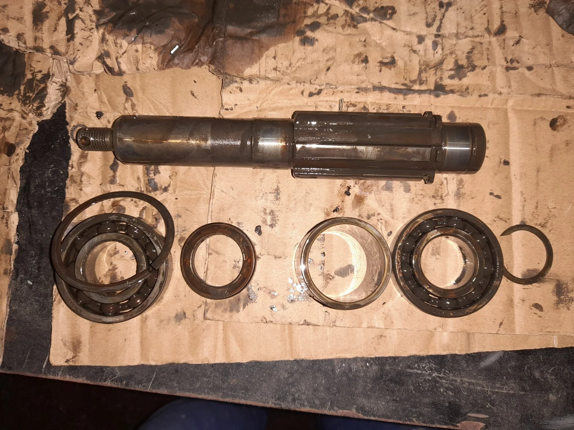

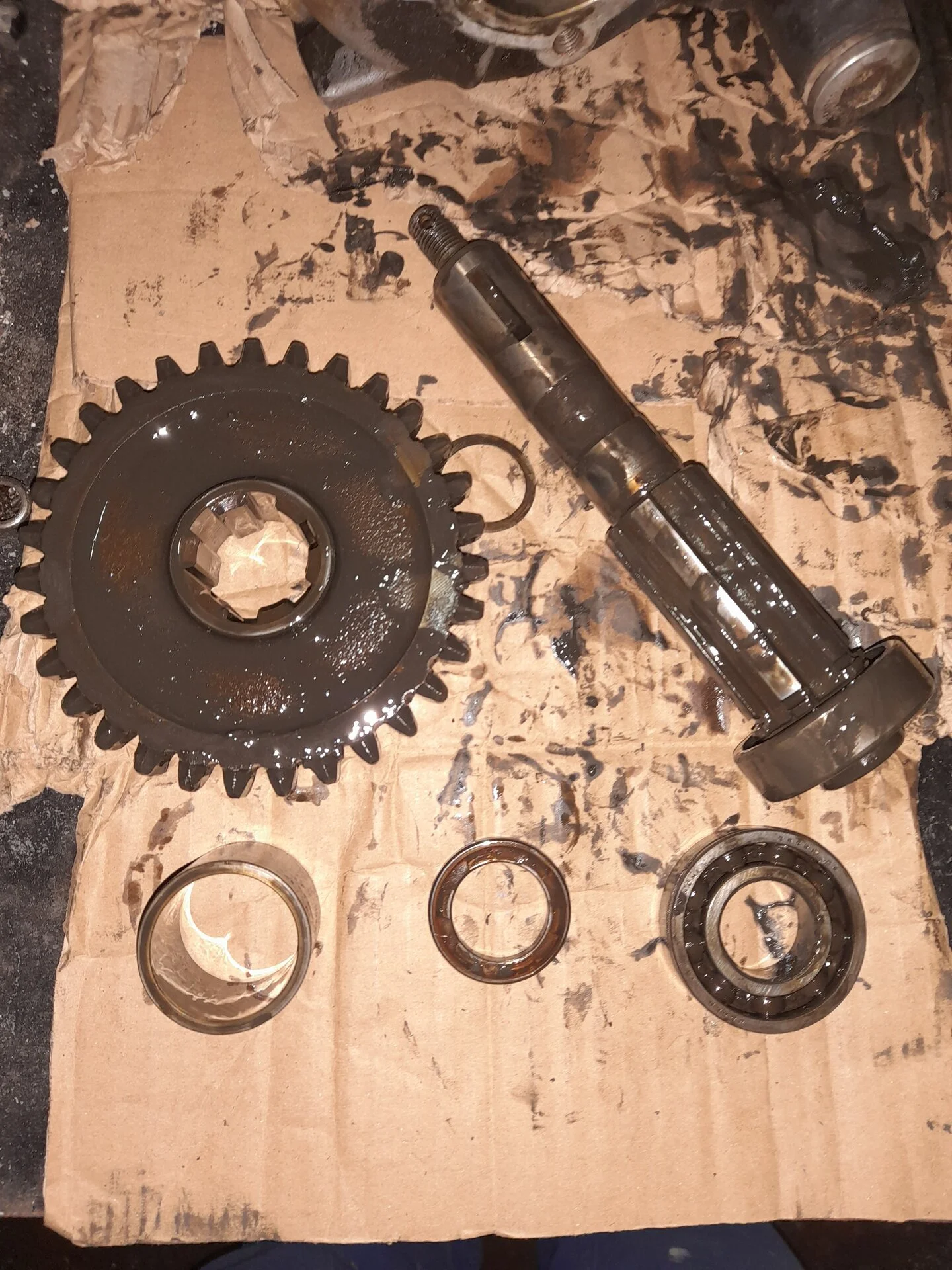

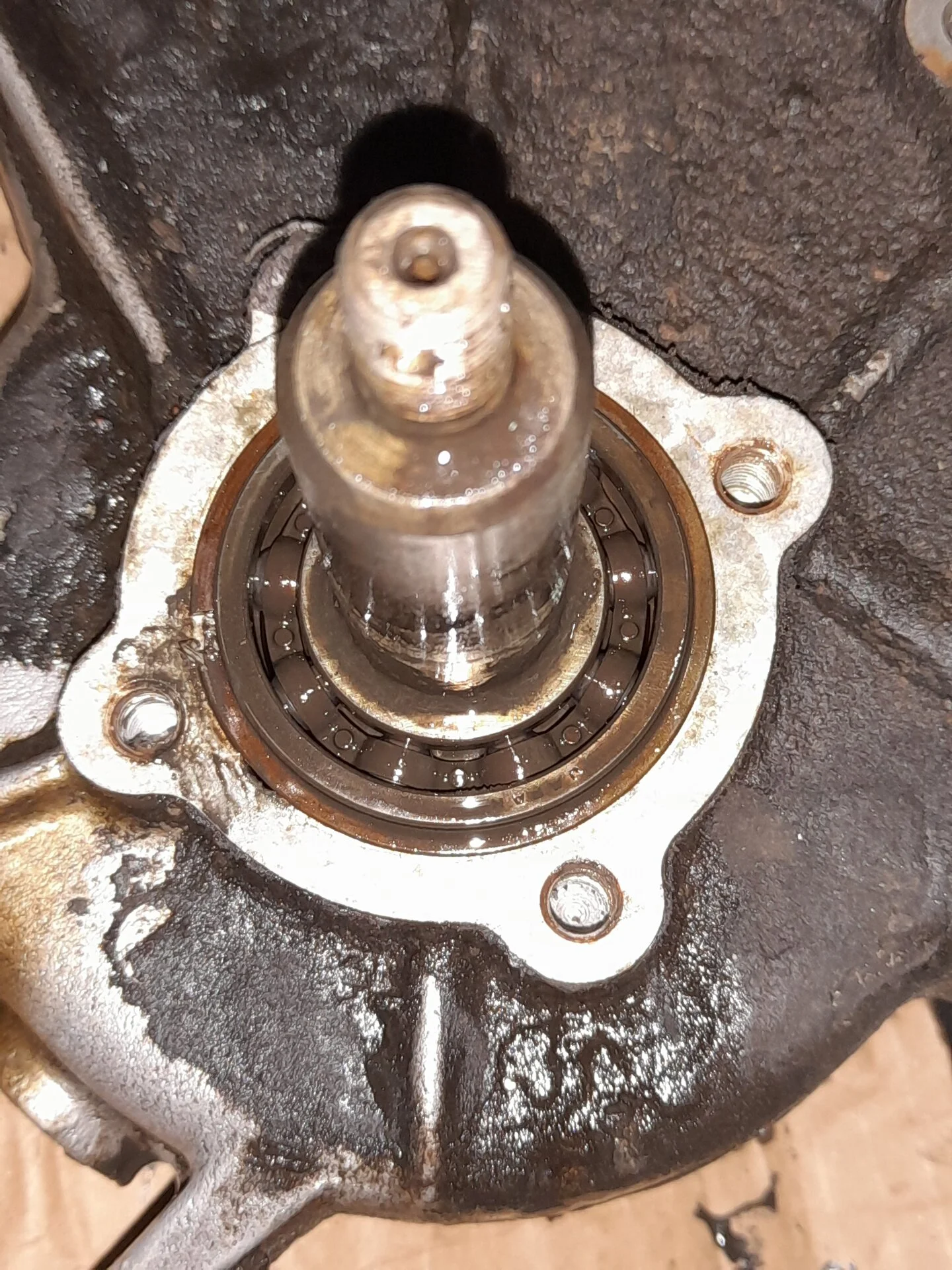

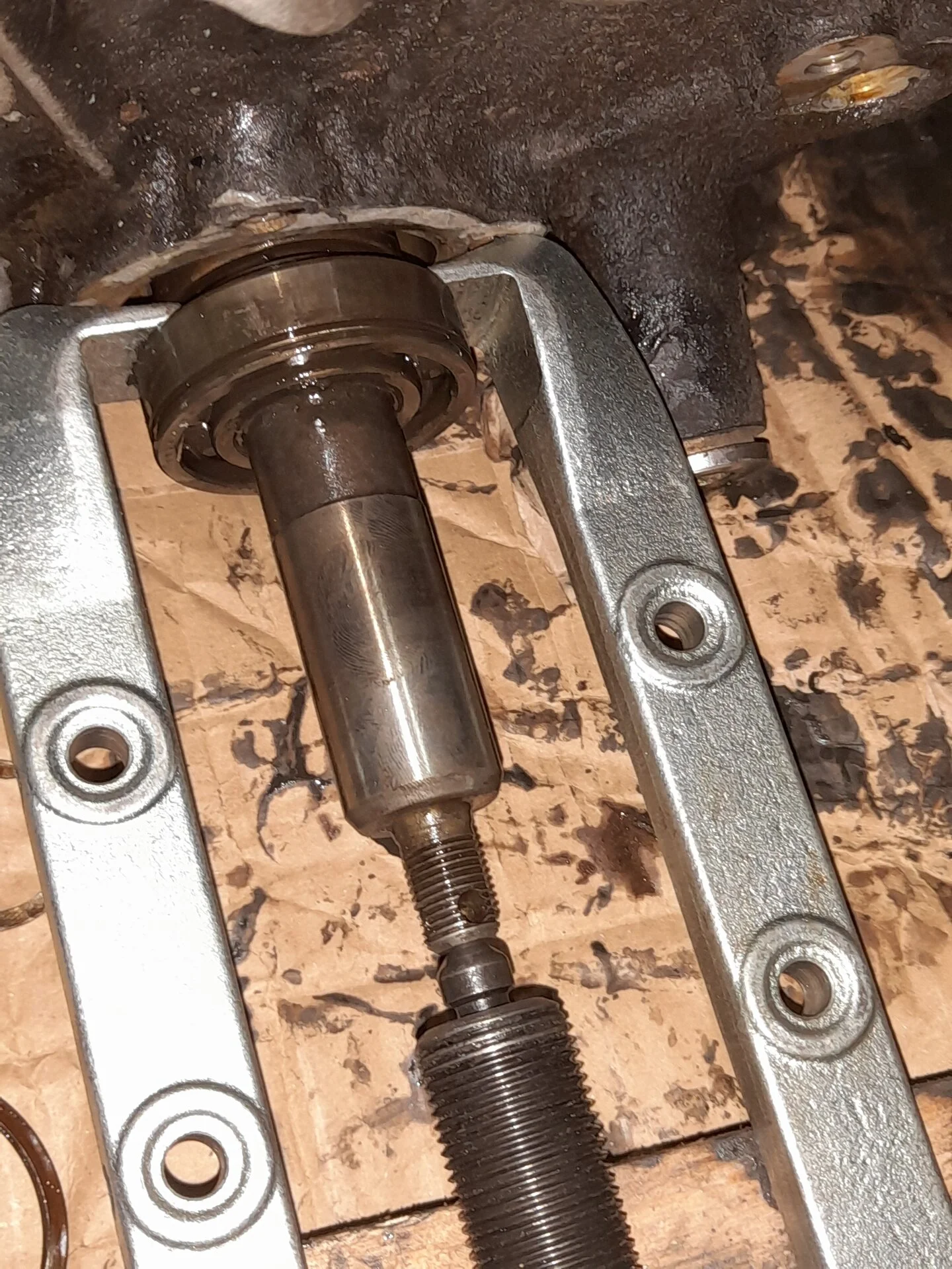

With the retainer off, the output shaft assembly can be moved out of the case enough to get the puller on the front bearing. The shaft only comes out from the back of the gear, so taking the rear bearing off at this stage will not allow the shaft to come out. Both my bearings are rough and noisy and need replacing.
Remove the output shaft from the rear side of the case, then remove the gear and two output shaft spacers.
Remove the snap ring (NLA, so be careful with it) from the rear of the shaft and pull off the rear bearing. This rear bearing is the only part in the above picture which is still available.

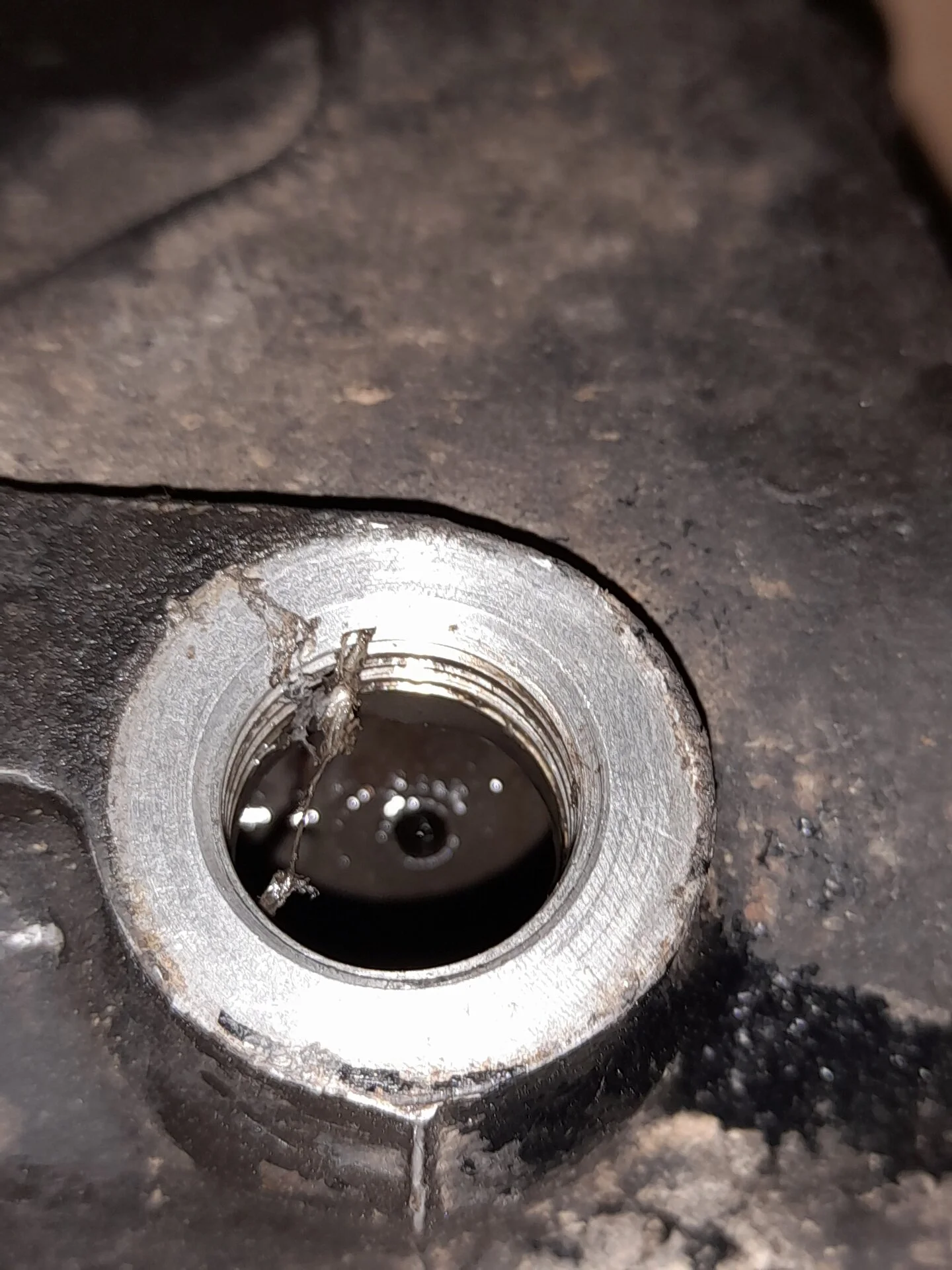

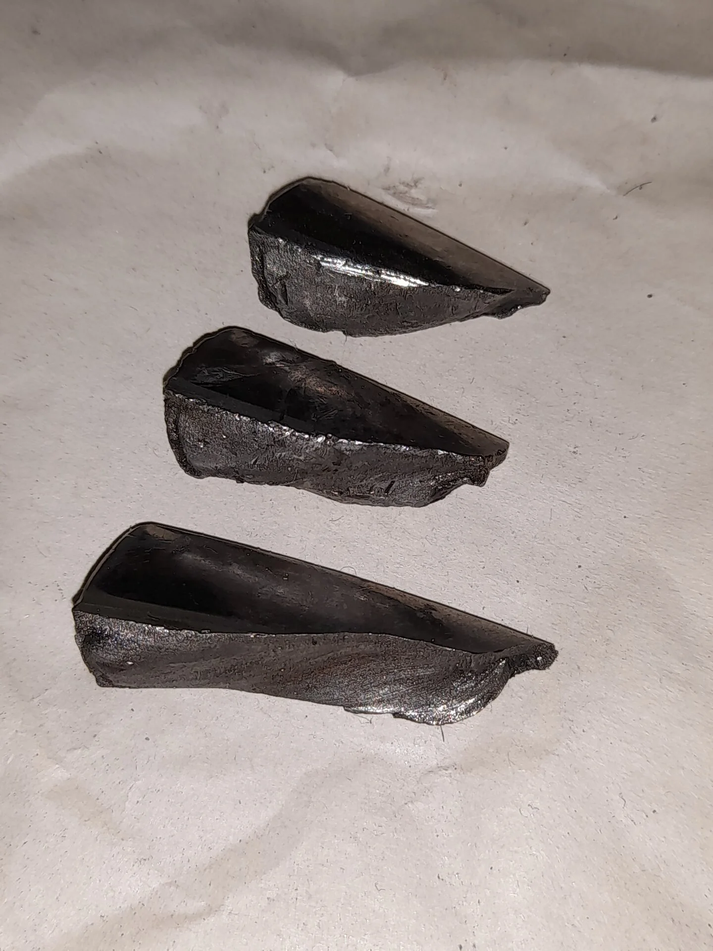

Horror
Fishing around in the muck at the bottom of the case revealed the source of the occasional metallic sound I heard when spinning the box. Something tells me the parent transfer box to this PTO did not have a happy life. Thankfully, no damage to the gears in the PTO box.
I had already bought all the available replacement parts for the PTO box, I got lucky and found a NOS front output shaft bearing, but it is the O-rings that f***ing Toyota have discontinued that I need to figure out before I can fully rebuild the box. I think I will try both imperial (as per brake cylinders) and metric options.

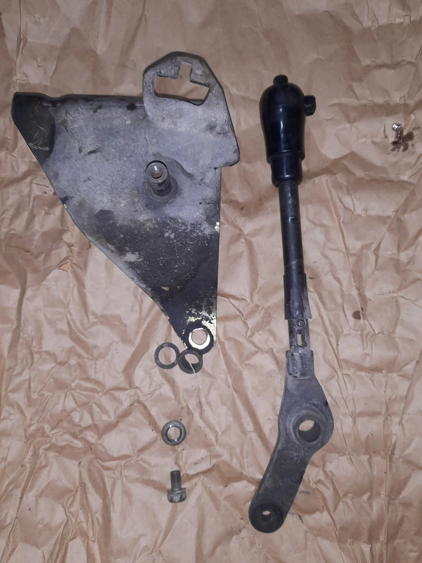

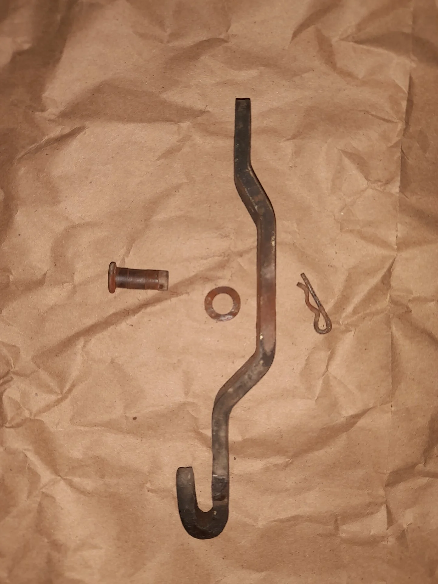

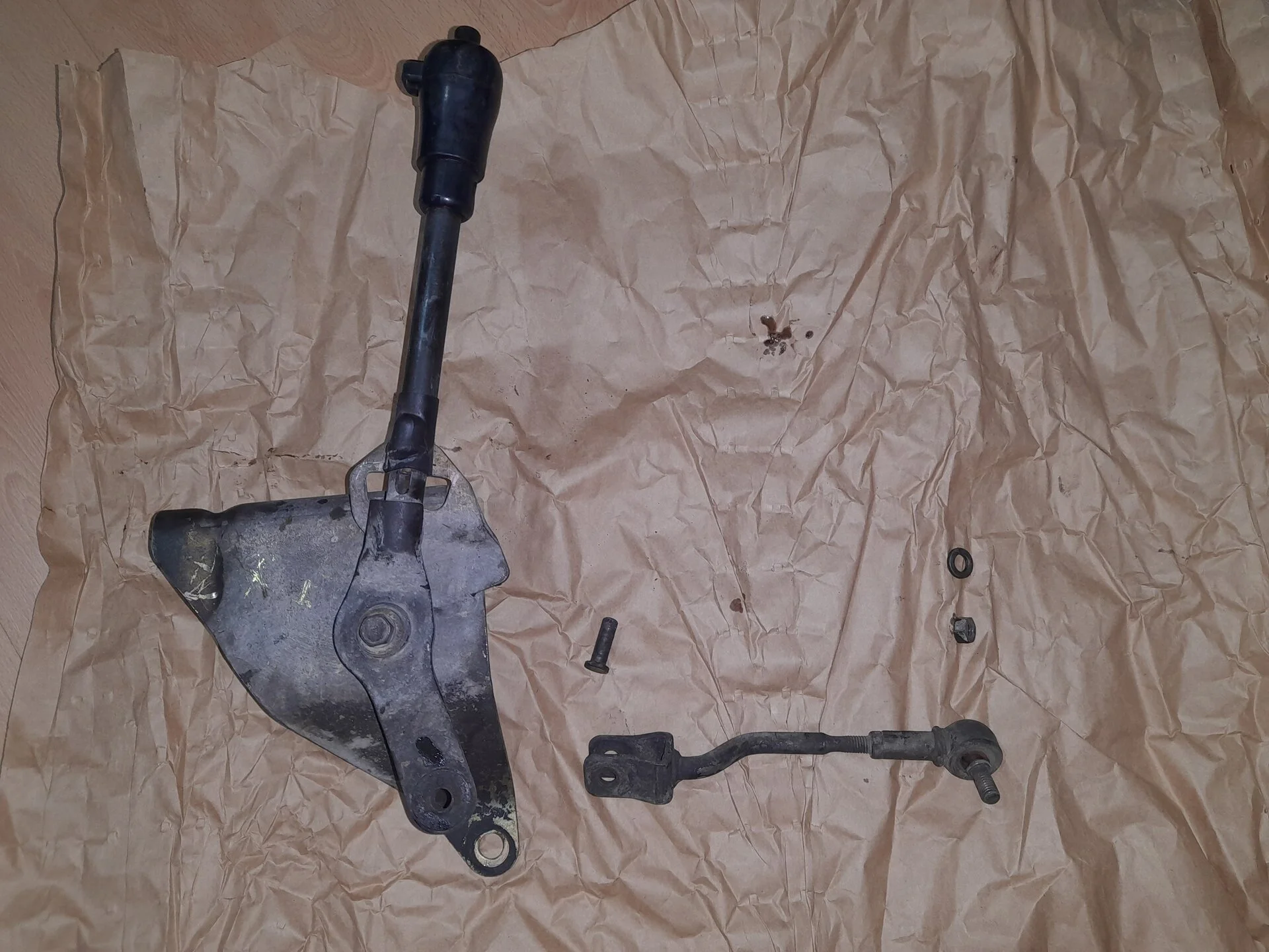

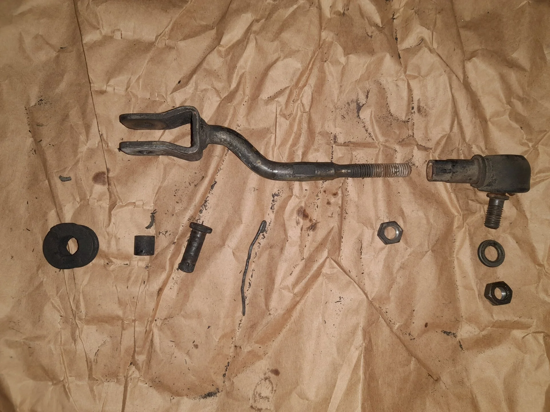

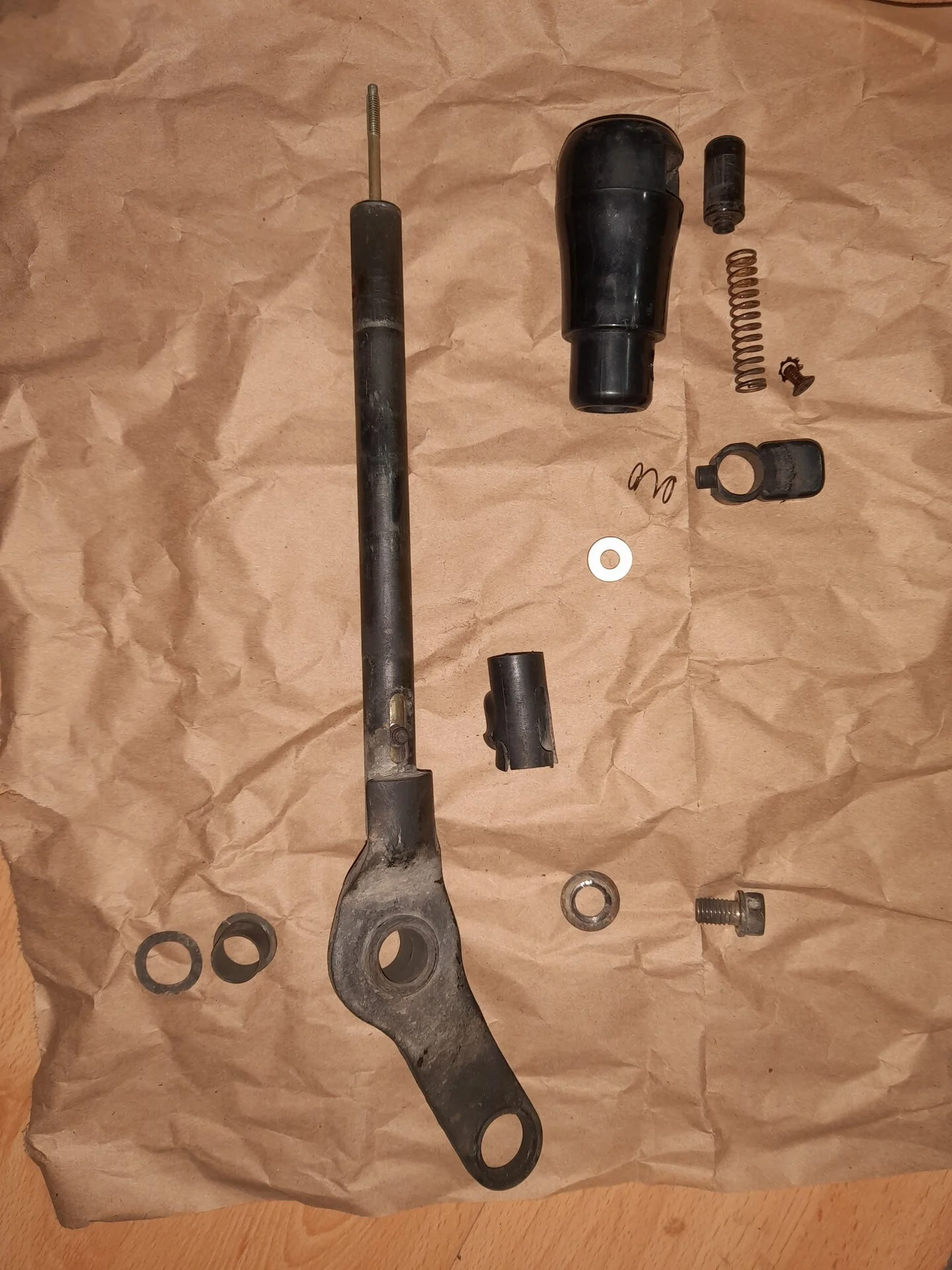

PTO shift lever 1
The shfit lever mechanism consists of a lever with a plastic knob (annoyingly missing the OFF/ON graphic), a bracket for the transmission and a linkage to the lever on the PTO box.
The PTO lever link with joint. The rubber grommet is pushed into the end of the PTO lever and has a small brass bushing. The rose joint with the perished rubber boot is the same as is used on the high/low range linkage on the split case transfer. Everything in the picture is still available new, except for the link itself.
The PTO lever is attached to the transmission bracket with a spring washer, two plastic split bushes (the same as are used on the clutch and brake pedals) a large washer and an 14 mm M8 bolt. On mine one of the bushes was missing and some bodger had replaced the large washer with and undersized washer, meaning the lever was very sloppy and could be moved around the lockoutplate on the transmission bracket. Lever and bracket NLA.
The knob is held onto the lever with a tiny (2.5 mm hex drive) grub screw and claw washer. Unscrewing the top button allows the knob to be removed. There are two lock buttons - the forward button is supposed to unlock the top button which can then be pushed to move the pin at the base of the shaft down the gate in the lockout plate, so the lever can be pulled back to engage the PTO box. For some reason, the forward locking button was not working, but I can't see anything broken or missing. Perhaps thetop button was screwed down too far. To be investigaed. Annoyingly, the rubber cover at the base of the lever is split a bit and is of course NLA. Of the knob assembly, only the scew, washer and possibly top button (tbc) are still available.

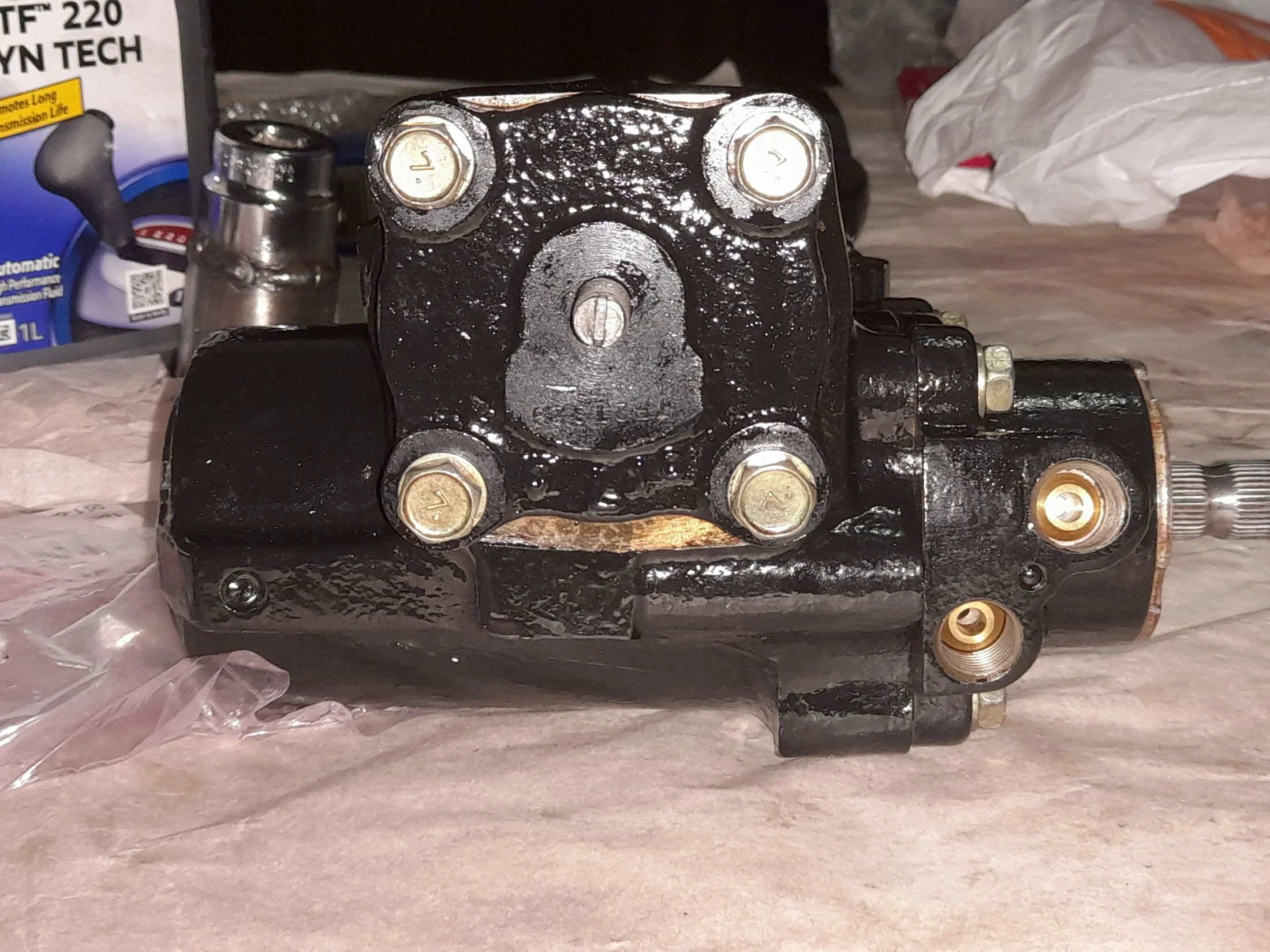

Time to update this thread again. Lots of work done recently - Transfer rebuild is very nearly finished, as is the PTO, plus a few bits on engine ancillaries and brakes....
...but first to complete the steering box rebuild.

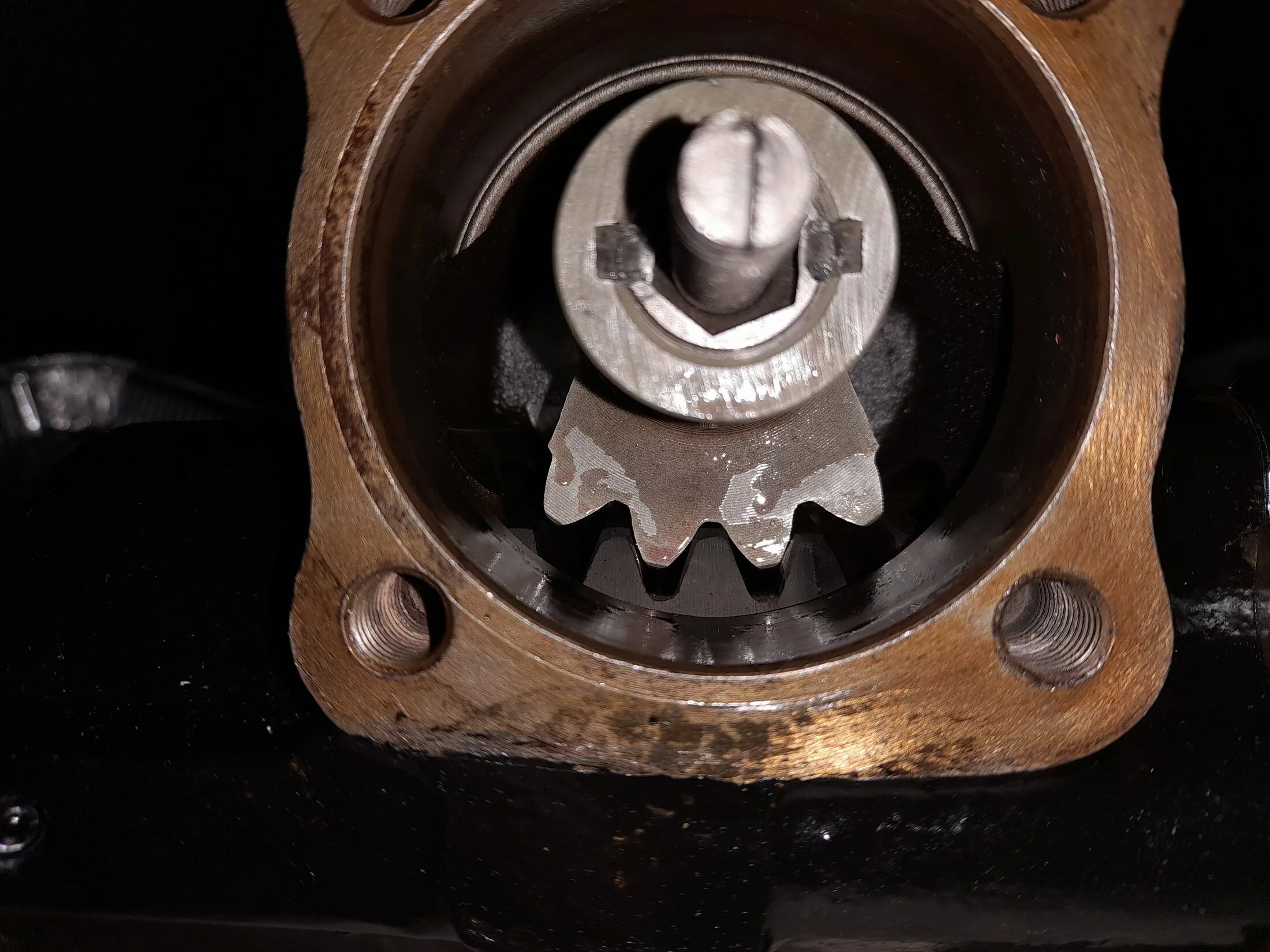

After being distracted by the PTO winch dismantling, I competed the last steps of the steering box rebuild. Here's the cross shaft with the new adjustment bolt and lock nut. I painted a small section of the shaft between the pitman arm and the steering box oil seals, to try to delay the shaft from rusting there.

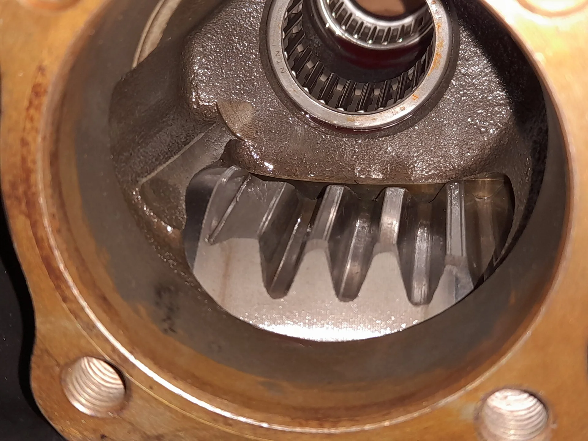

Insert the cross shaft into the housing.

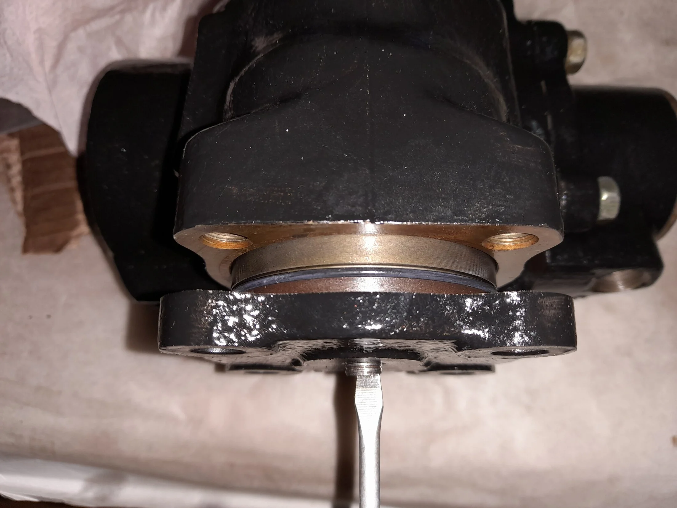

Time for the end cover with new O ring...
...wind the cover on by unscrewing the adjuster bolt with a screwdriver in the saw-cut...
...and torque the four bolts.

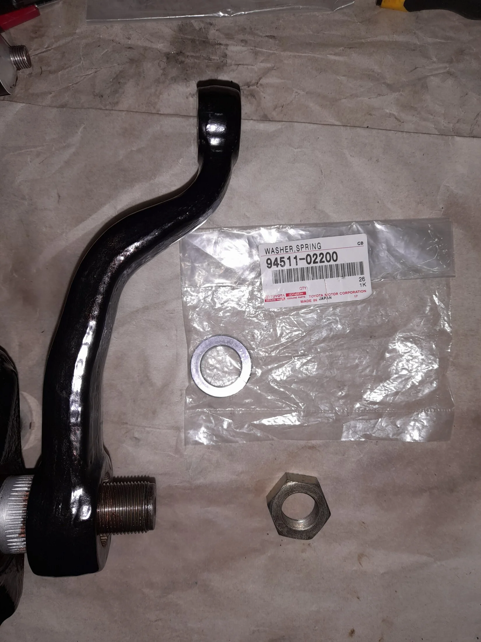

Match the line on the end of the cross shaft with the line on the splined yoke end of the pitman arm and slide onto the splines. I'm using a new washer and the original nut.

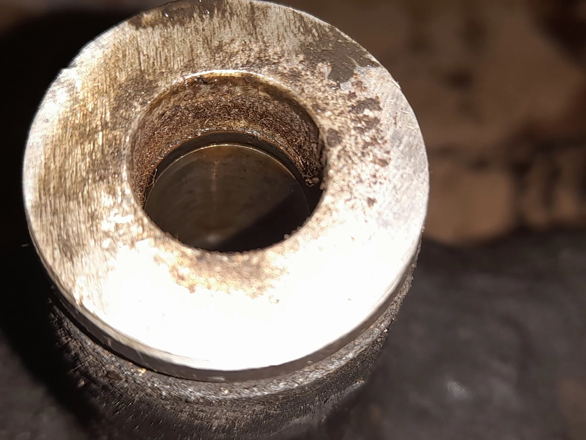

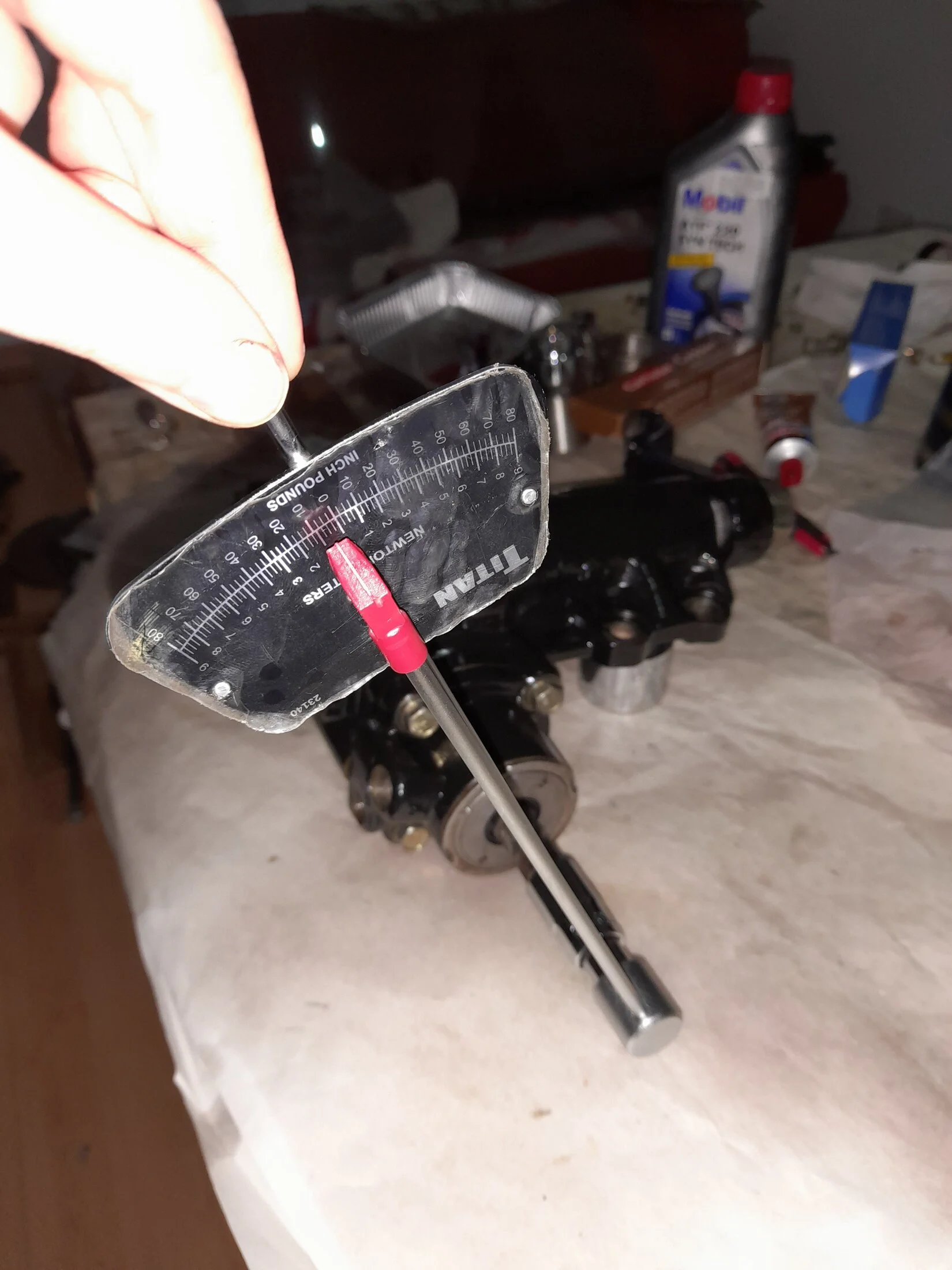

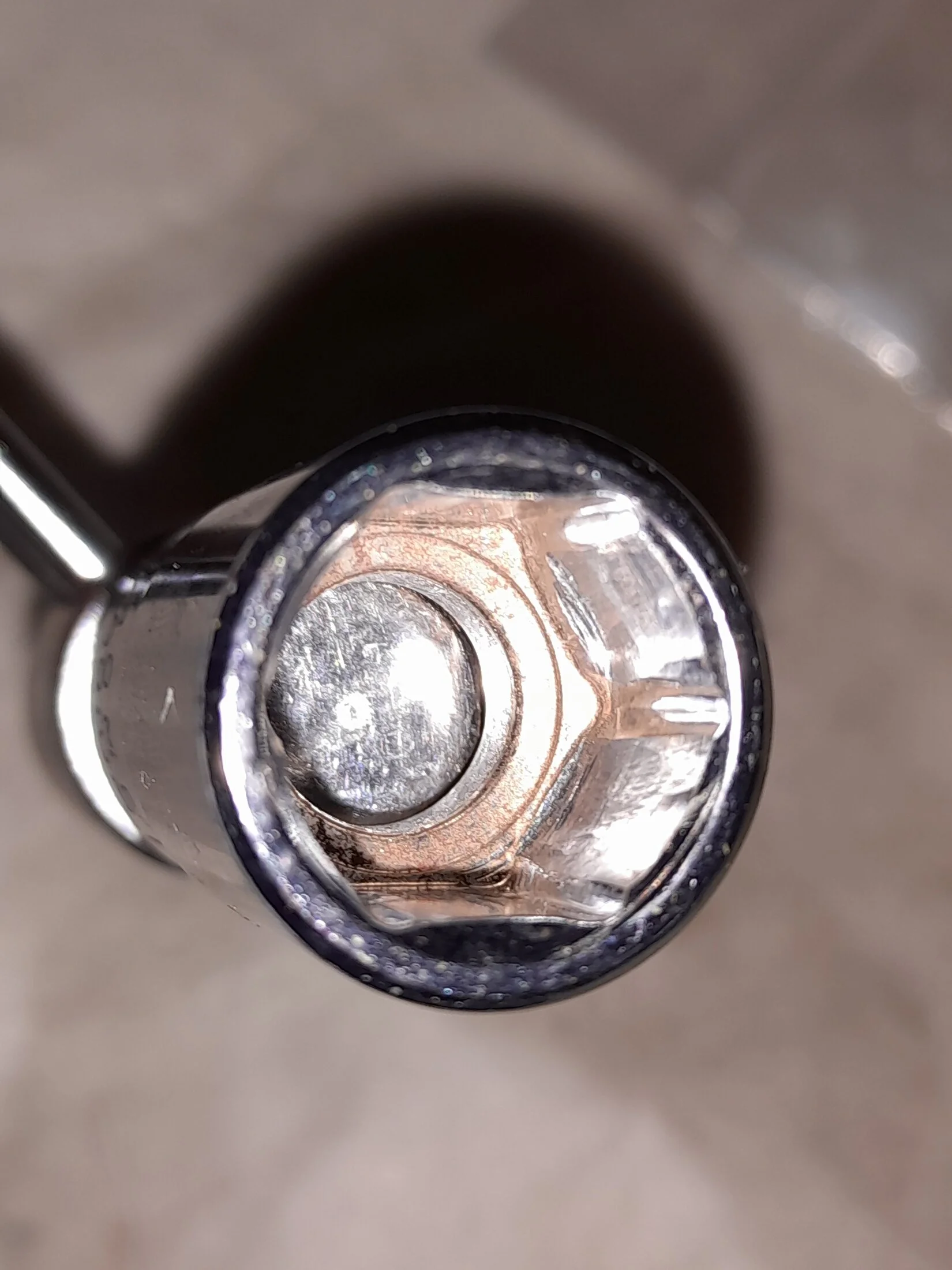

I previously skipped (on this thread) the setting of the pre-load on the ball bearing in the end of the worm shaft housing to 0.4-0.6 Nm, but it is similar to the procedure here, where the starting torque for the steering box is set. This requires another SST; I took a 15 mm socket and opened it up so it fits on the waisted part of the splined worm gear shaft.

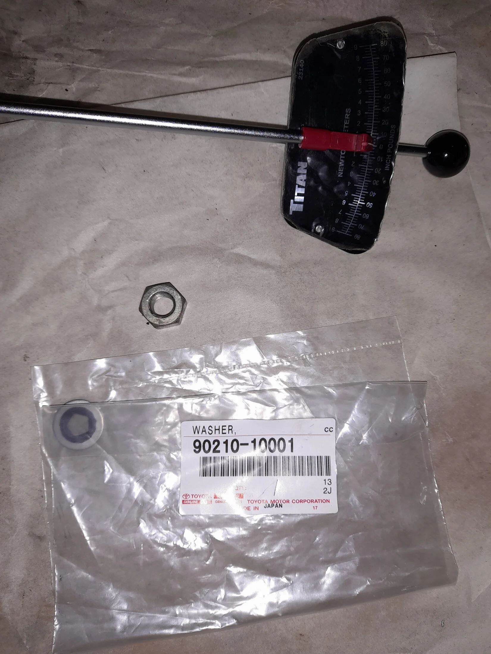

The starting torque on the worm geat shaft is set by moving the adjuster bolt in the end cover, with the pitman arm in the straight ahead steering position. The desired value is to 0.6-0.9 Nm.
Time for a new rubber-lined seal washer, and the original lock nut...
...and the box is finished.

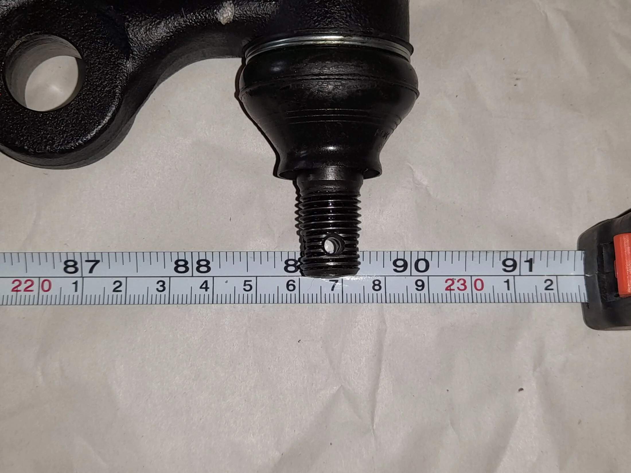

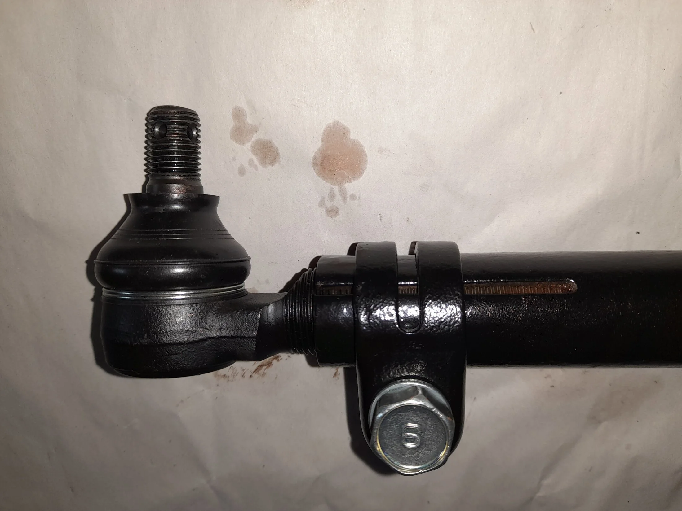

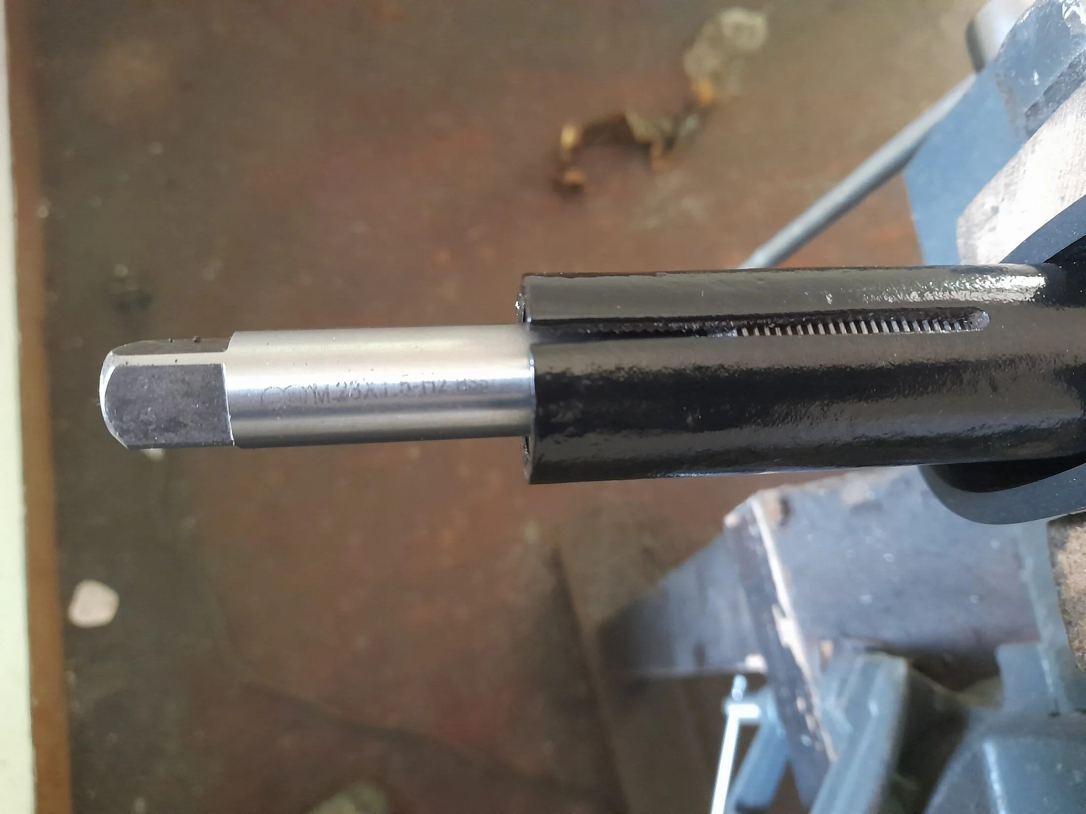

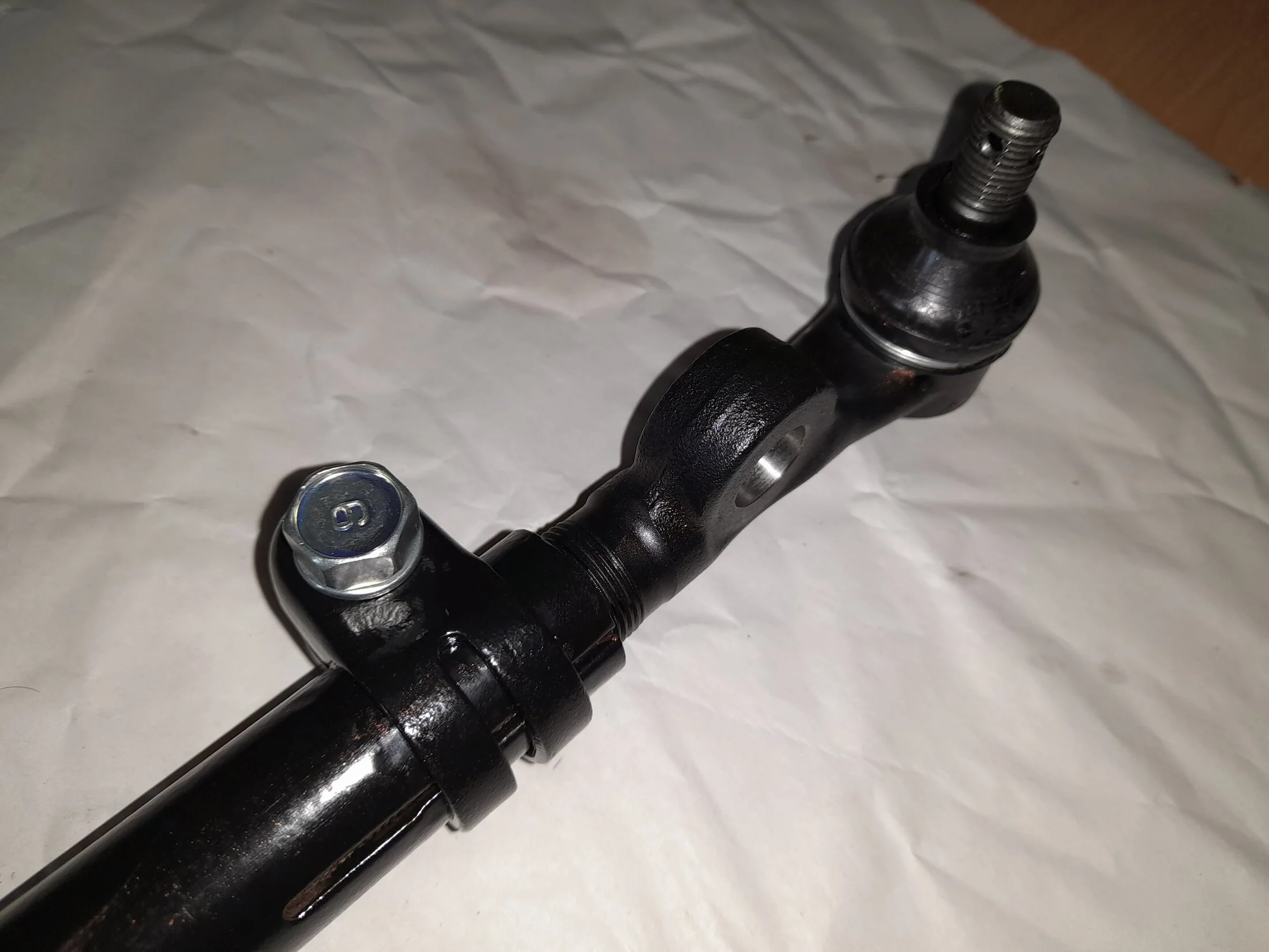

Track rod assembly

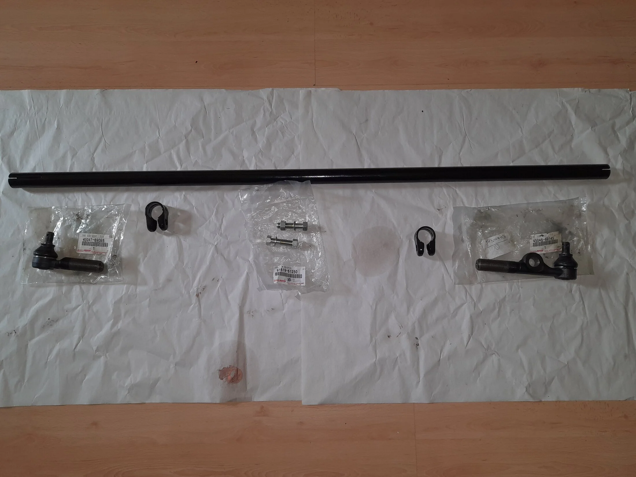

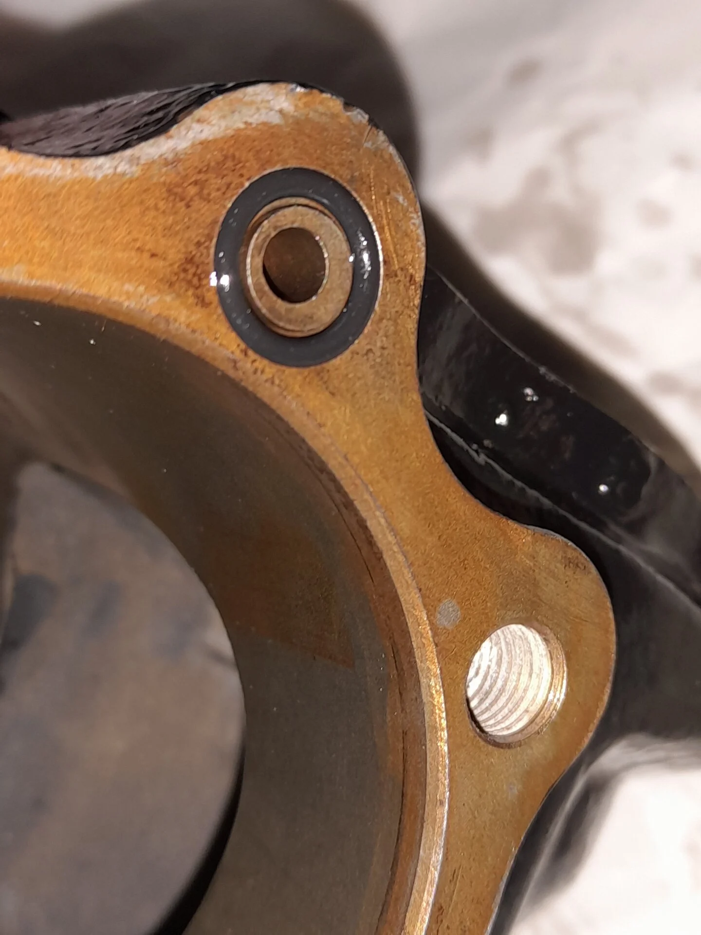

The vehicle came with Japanese aftermarket 555 track rod and drag link ends... probably decent enough but as I want to replace things, I went all genuine. Here's the original track rod and clamps, all repainted, new ends and clamps bolts.
I tried winding the new track rod ends into the track rod and found that they were stiff from the start and refused to get anywhere near the depth in the rod to be the specified 1267 mm apart... very frustrating. So I bought a pair (right and left handed) of M23x1.5 taps. It was hard work getting the taps down but very satisfying.
After that, the ends wound perfectly freely down the rod, and I set them at the correct 1267 mm separation.
Right-hand end.
Left hand end with the mounting taper for the drag link.
