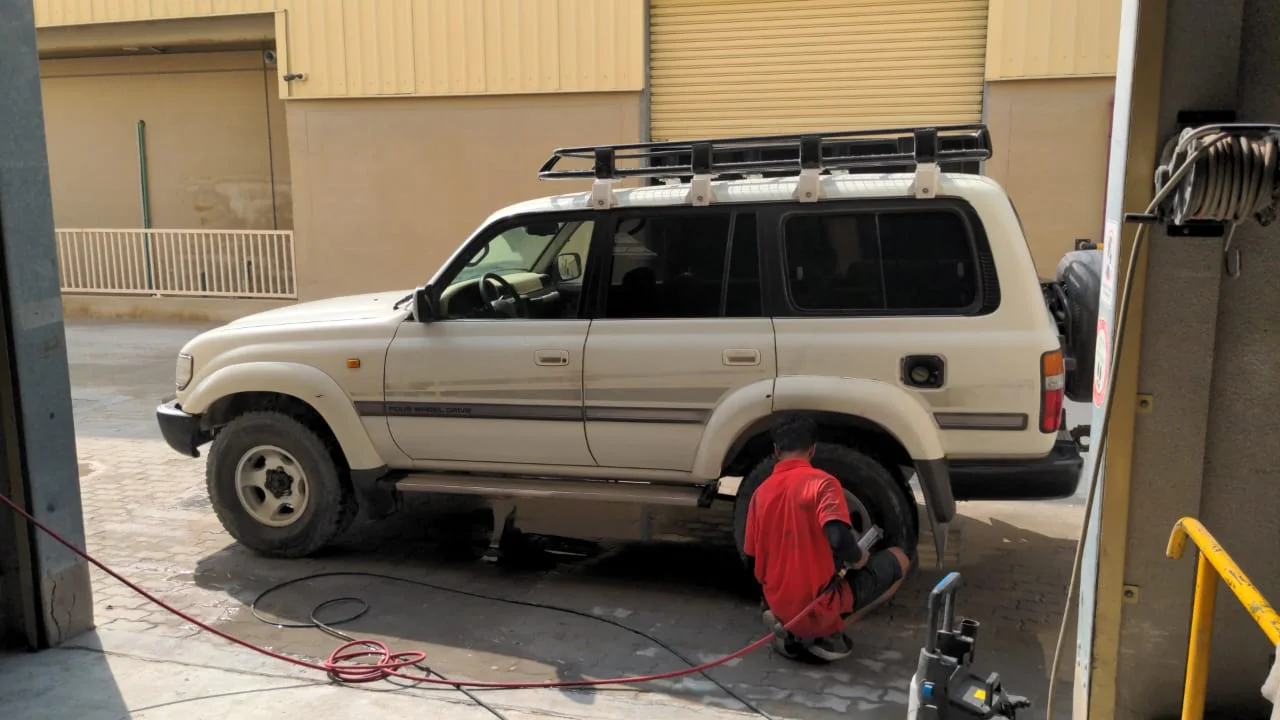

My younger boy and I are in Oman for a few days and making use of the autostrada cruise control on this petrol manual 80. The unit is pricey but it is making a huge difference on this long trip. I'm mulling over adding it to Golden Boy when I get back to the US.

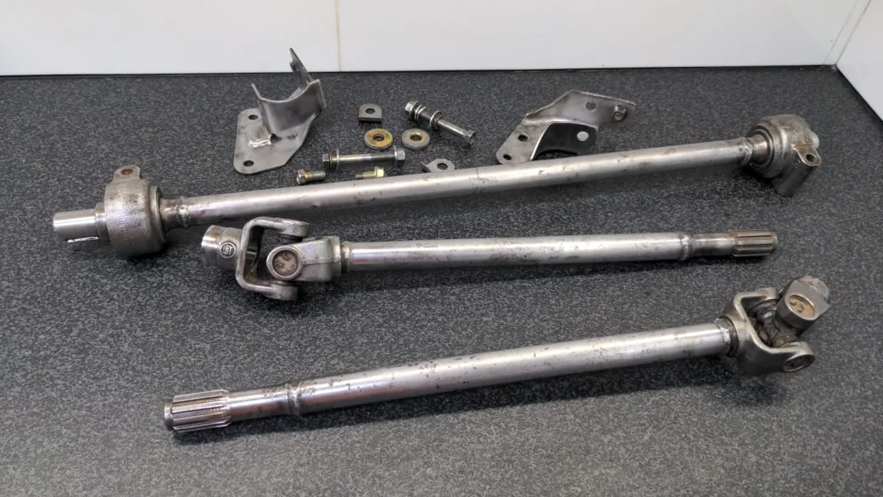

And I have a repalcement PTO shaft for the mechanical winch that I am cleaning up and will put in my luggage. I needed some help to get it apart because I do not have a shop here currently.

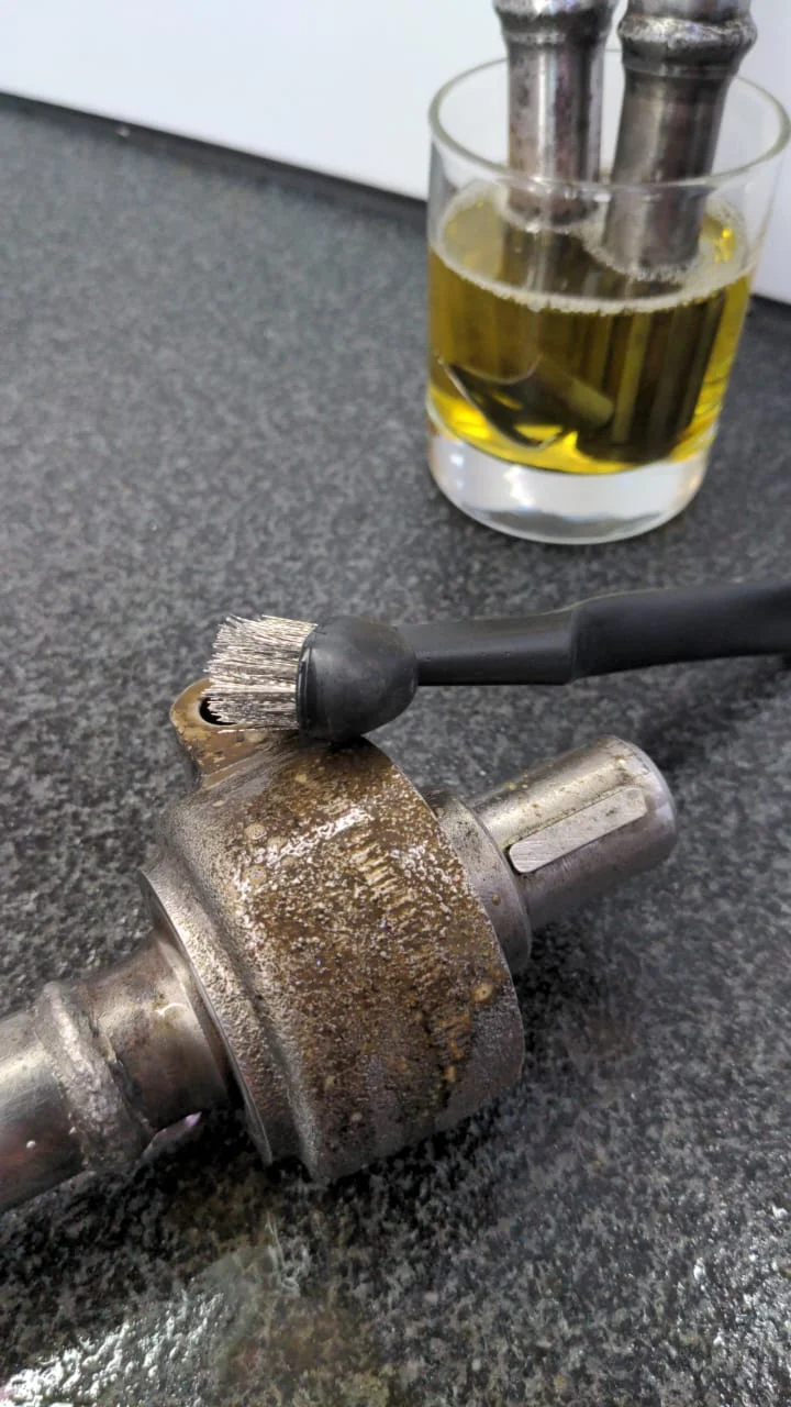

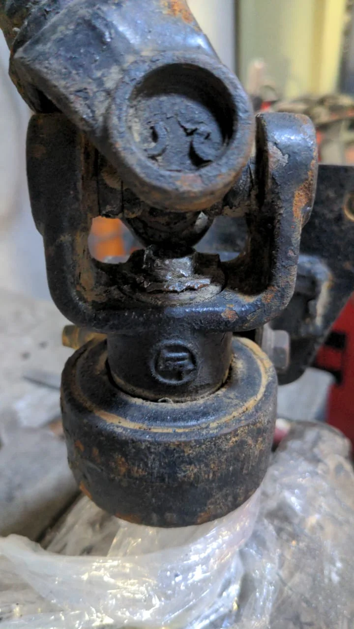

One thing I forgot was that one of the line shaft bearings was frozen. And I did not rediscover that until I got home. Otherwise I would have gone back and tried to get another complete unit. But sometimes you just have to deal with the situation in front of you. I reached out to my most reliable parts guy and asked him for these items:
(This very helpful image was found here on Mud, BTW.)
Fortunately it looks like the bearing is completely standard. I'm hopeful that Ryan can get me some of these by Tuesday night so that I can do the bearing swap in Florida.

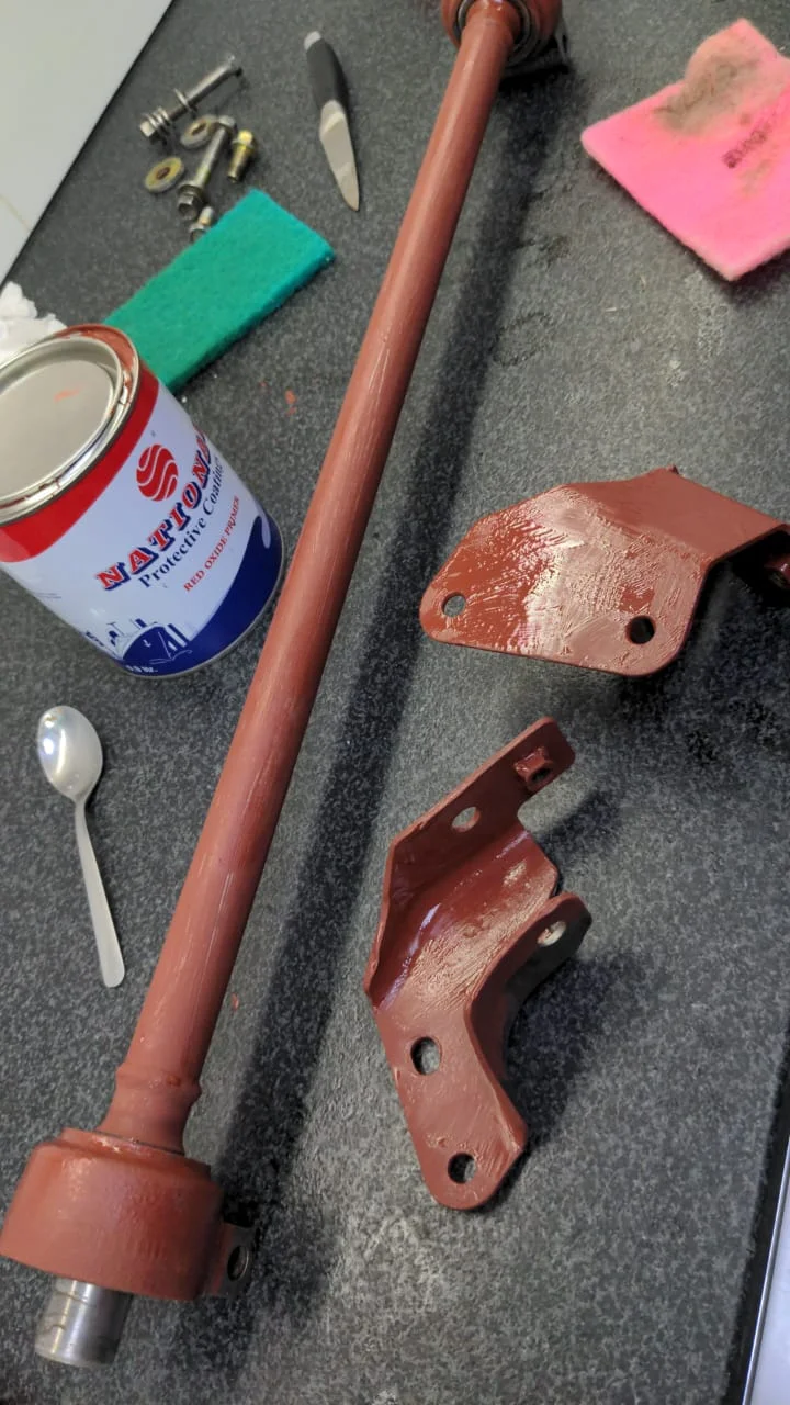

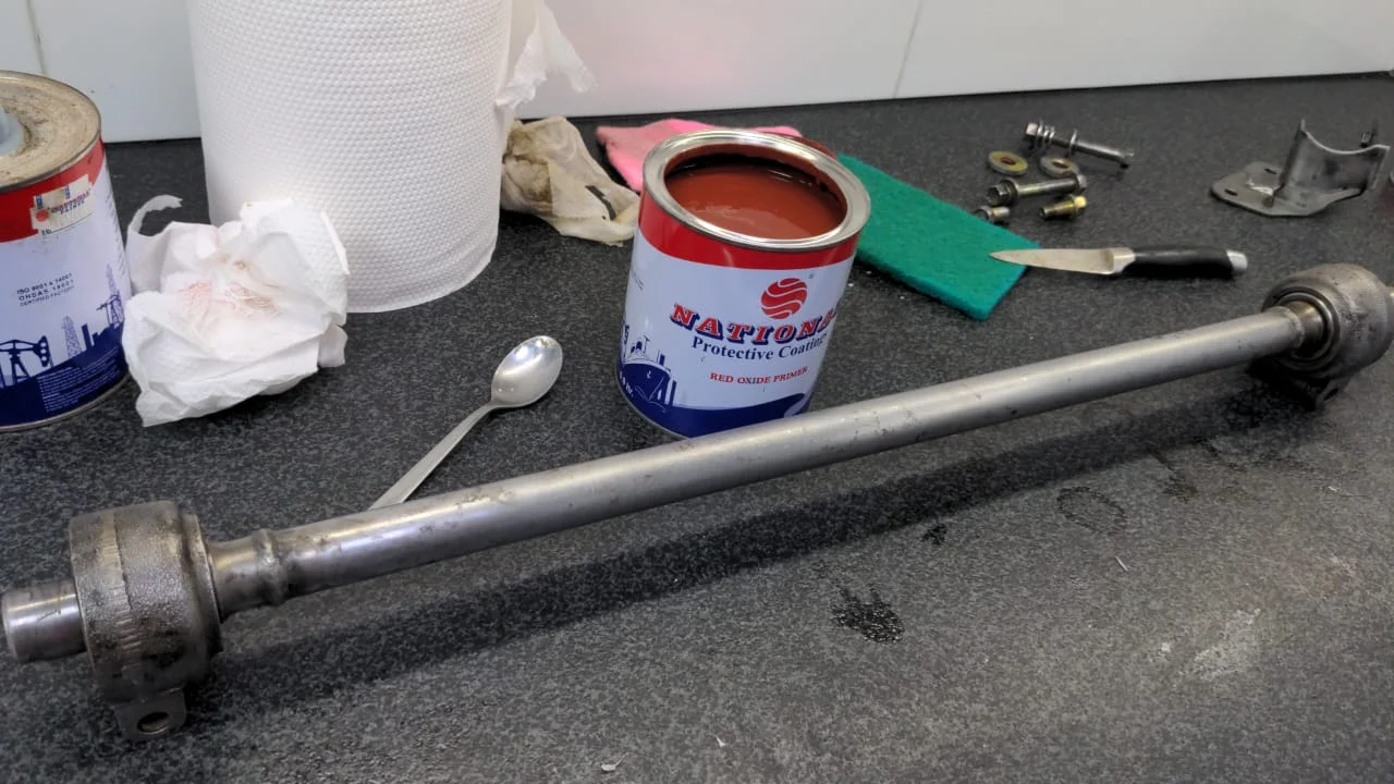

In the meantime, I have prepped and am in the process of painting the parts before sticking them in my luggage.
(Yay Evaporust!)

I decided to try brush on paint this time because I wanted it pretty thick.
I like my decision to point the shafts yellow. Not too many people even know about PTO winches. Having a little extra warning about potentially spinning shafts seems sensible to me. Nevertheless, a few 'friends' have derided my decision to paint the shafts yellow, making unhelpful comments like:
"if anyone working under your truck needs safety yellow to know which objects not to touch, i’m going to say they shouldn’t be under your truck unless the truck rolled over them or something."
But I like the safety yellow color and anyways it will get bunged up when I change the bearing on one end.
It does take a couple of coats of enamel to get a solid color over the red oxide primer.

Well the PTO shaft turned out to be an exercise in futility. I must have been for a 60 series.

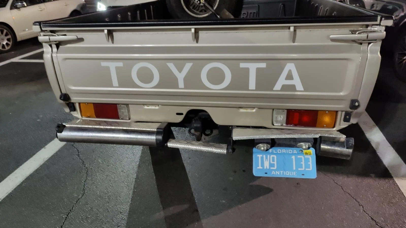

But Golden boy did end up with a bit of damage

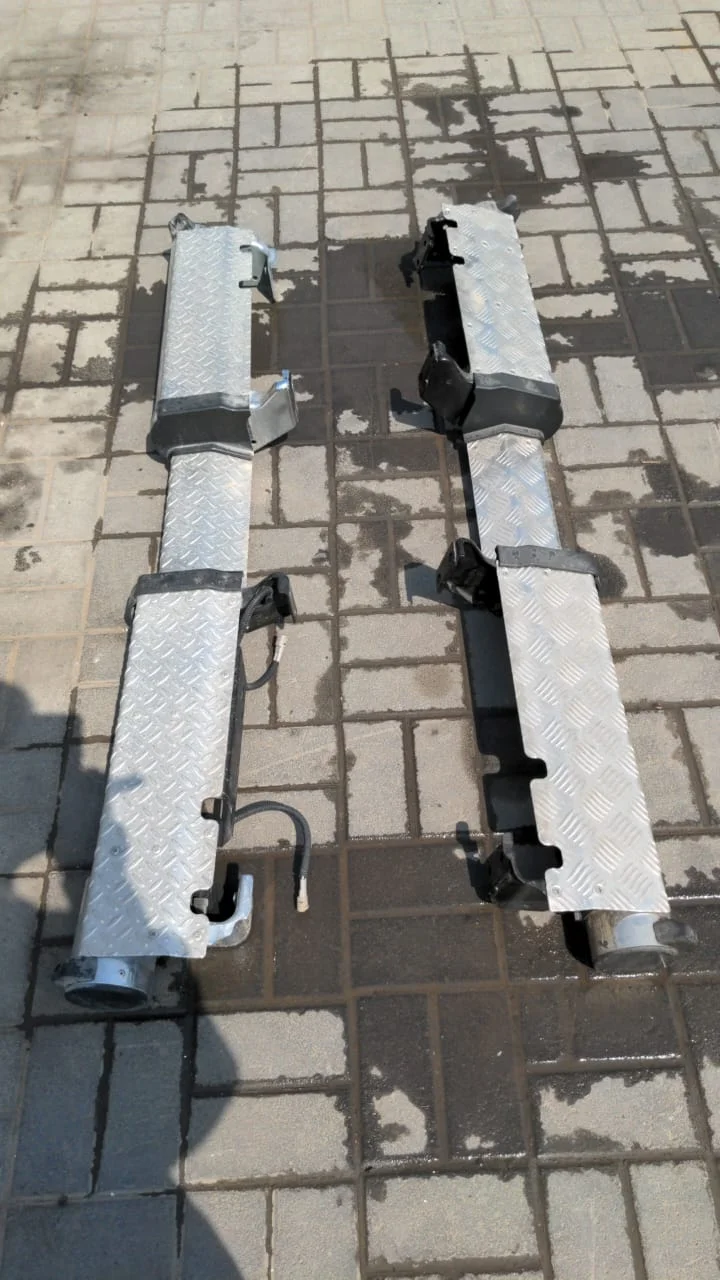

I am about to head to Florida and I decided to bring Golden Boy a new, stronger, bumper.
70's have been coming with two types of rear bumpers, strong ones and weak ones. The one on Golden Boy had been the weak bumper. I went up to one of my favorite places in Sharjah today and had a look.

The weak bumper is on the right, the strong is on the left
