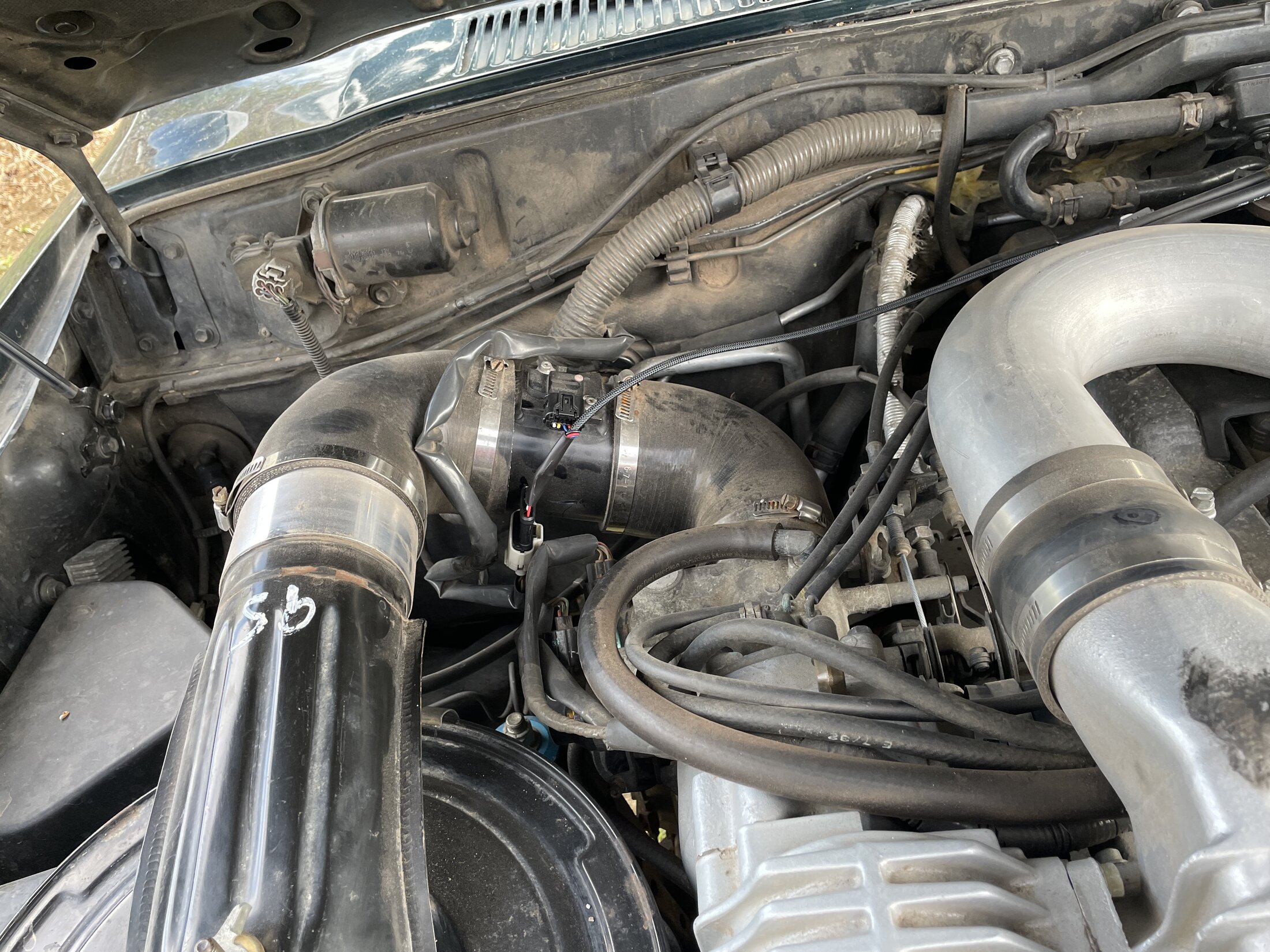

So I've done some data logging.
First off, moving the IAT sensor to a post compressor position has no effect on fuel trims and LBS/min air readings.
Wired to the MAF for IAT the idling temp was 88 degrees.
While wired to the MAF sensor for IAT and full throttle off the line to 85mph, the max temp was 104 degrees.
While wired to the intake sensor for IAT and full throttle off the line to 85mph, the max temp was 170 degrees.
When reading through the logs it looked like the truck was faster off the lint to 80mph when wired to the intake sensor.
I went back the following day focused more on just the speed performance and both configurations were the same speed wise. However the idling temp reported by the MAF sensor was only 70 degrees. So the ambient temperature was significantly cooler. I'll do more testing once summer begins in earnest.

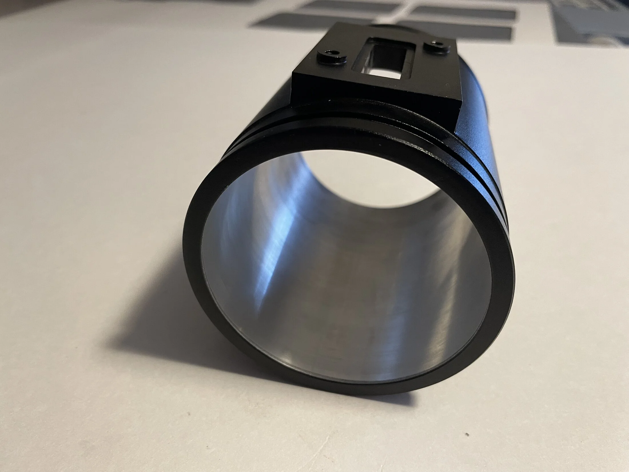

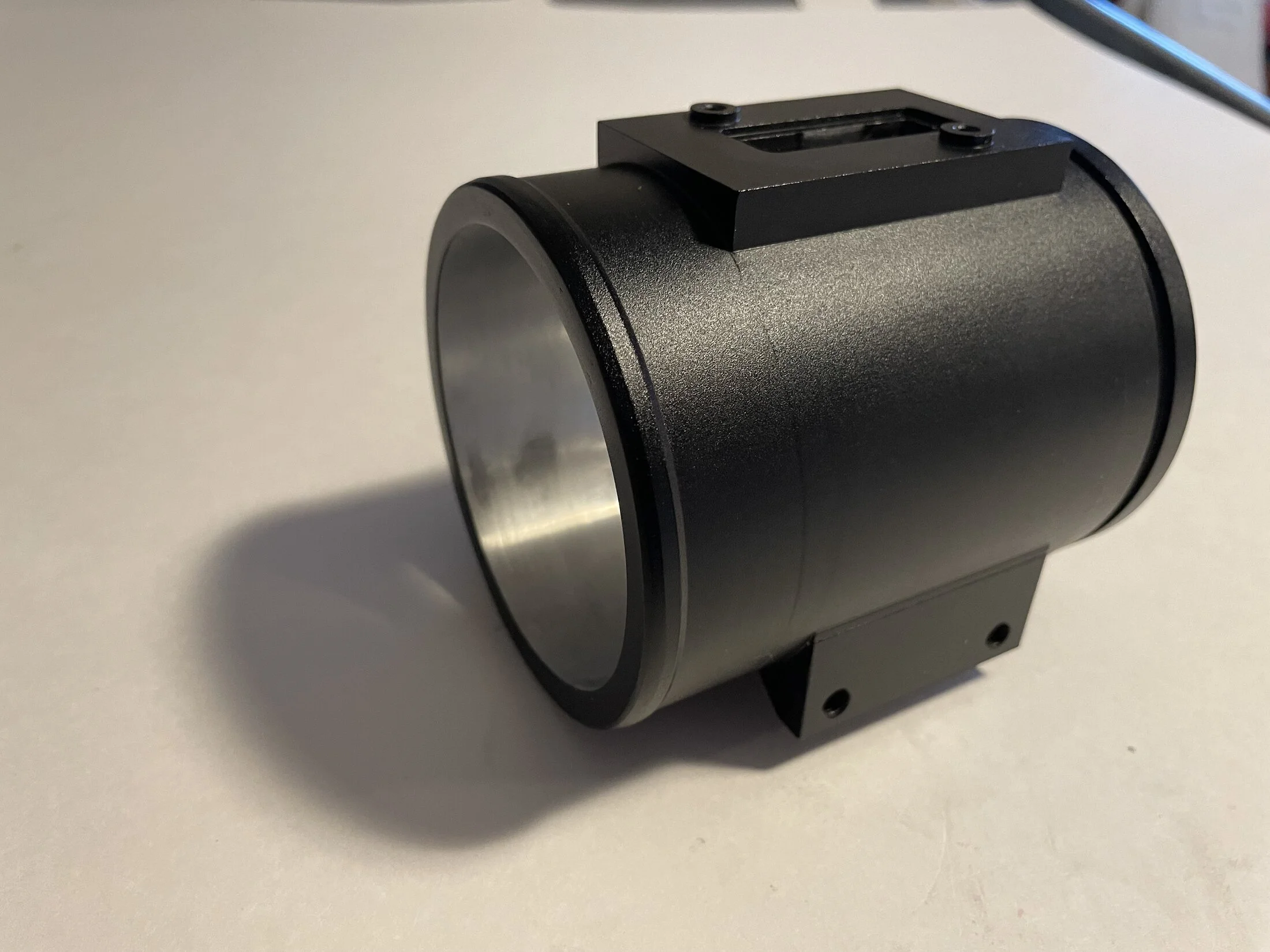

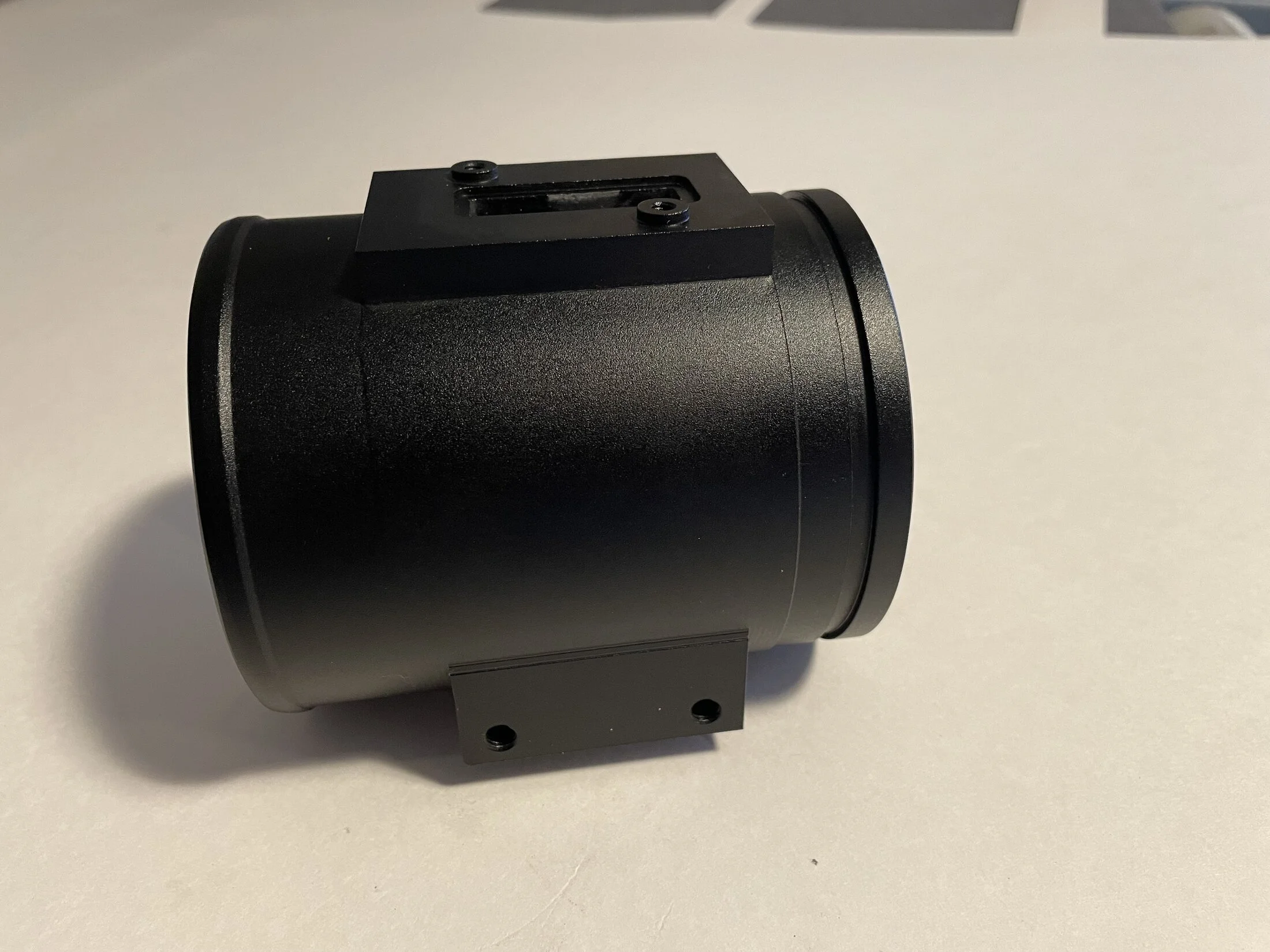

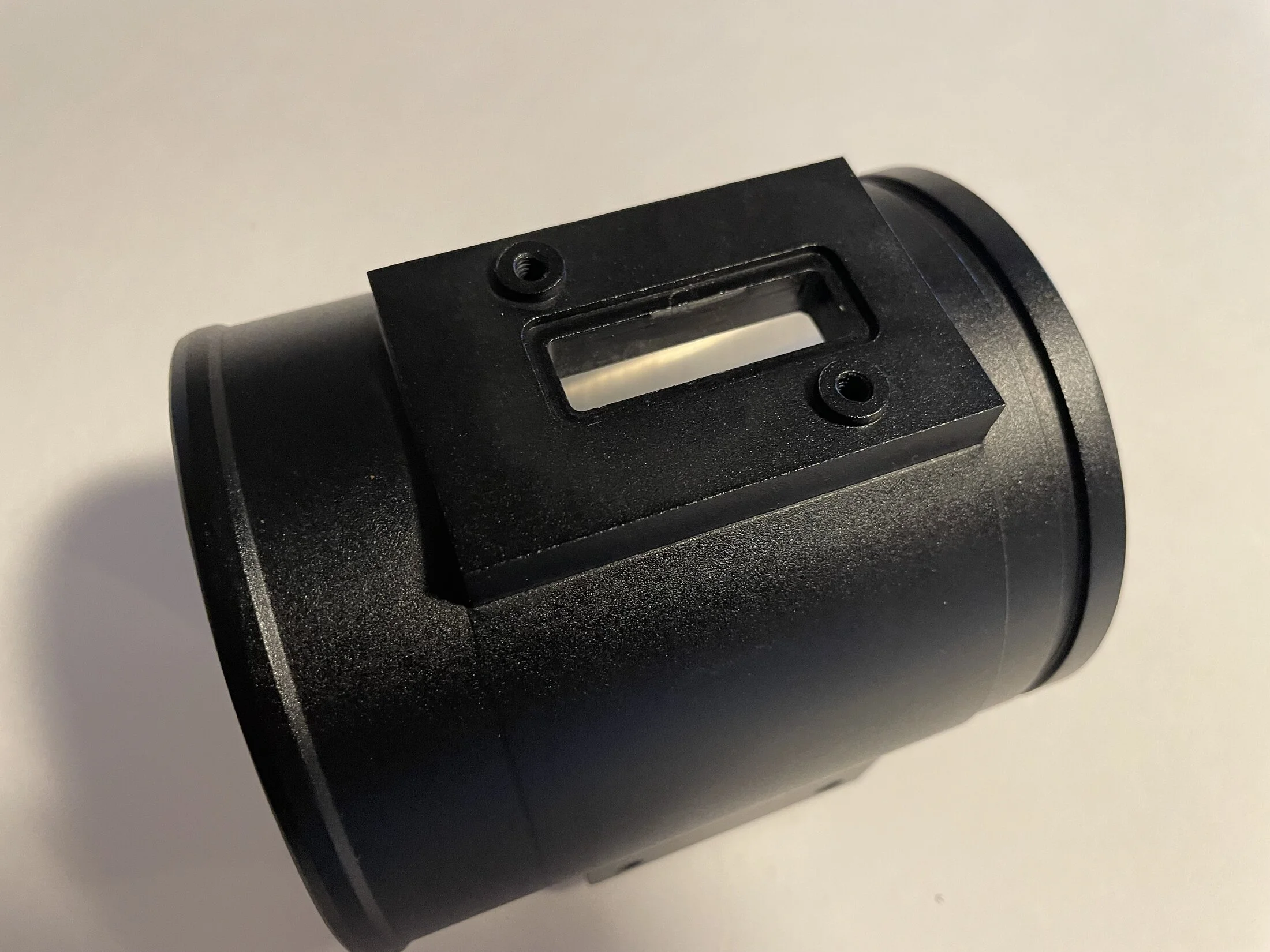

Attached is a pic of the new MAF design.

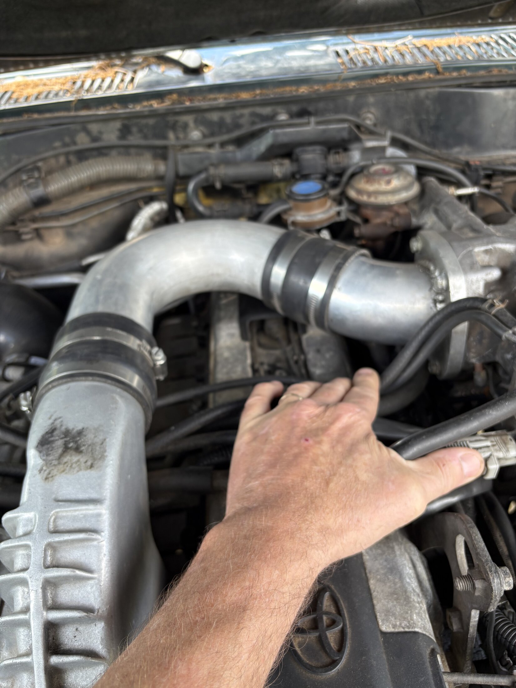

The inlet pipe is post compressor so it’s compatible with any pre- compressor configuration.
The benefits are, smoother delivery to the intake, remotely placing the IAT sensor for accurate IAT temps and easier servicing like spark plug changes.
Getting that hard 90degree turn out of the airstream was my primary goal.
