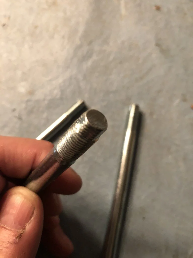

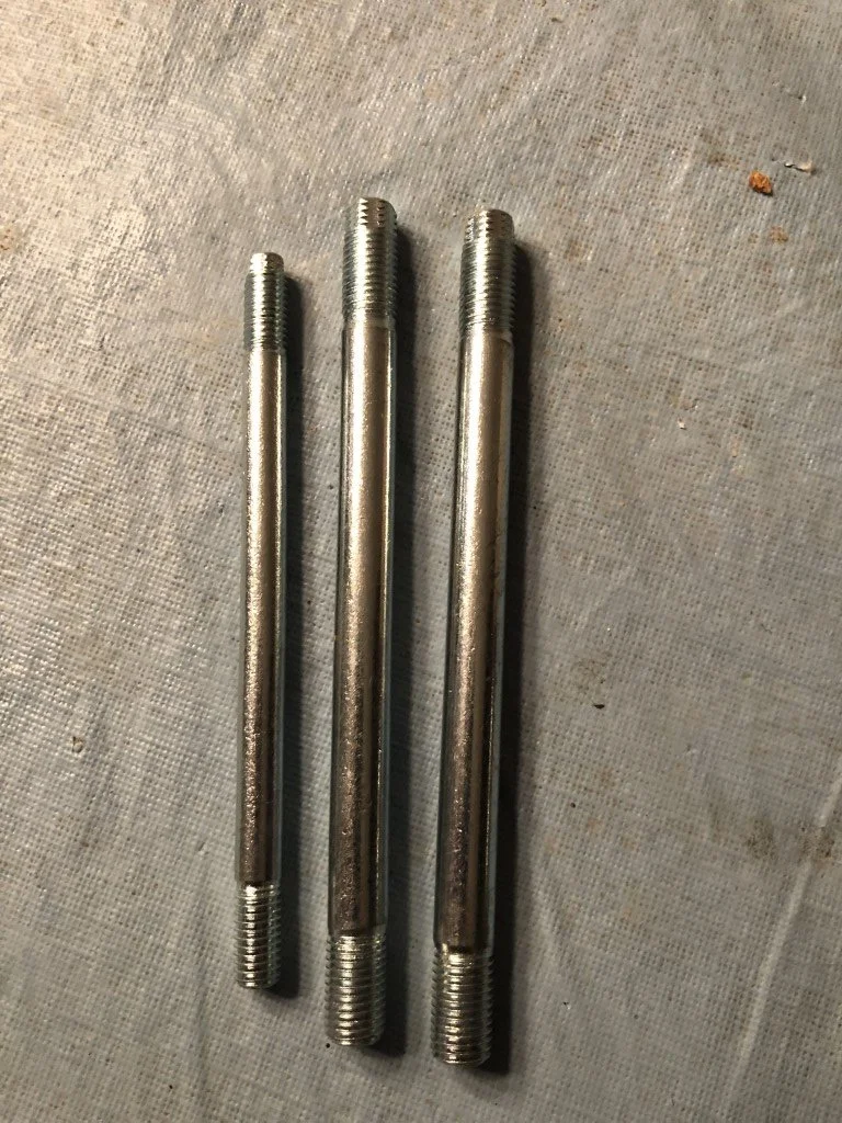

I ordered and have received the mounting studs for the charger assembly to the block. They only took 6 months to get.
It might be hard to see but the ends have been machined to use a 6 point socket to aid in install. But that area is still partially threaded.
I bought enough for 100 kits, so I guess that's the production limit at this time. View attachment 3029849View attachment 3029850
I only remember one plenum mounting stud being used for the TRD/Kazuma SC. Does your design require these three, or am I forgetting parts?
The TRD mounts differently than how mine mounts. The TRD on has 1 stud.
