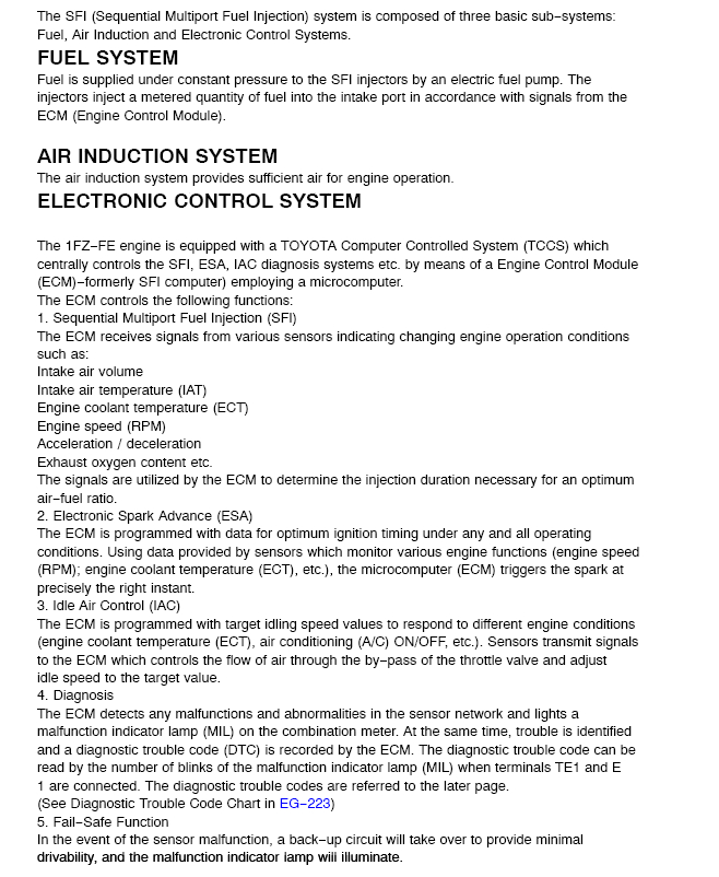

Here is what Toyota says about the 93 fuel management system.
That's fine, but it doesn't mention anything about how fuel rail pressure or the vacuum triggered FPR is used to affect fueling operation. It only says constant pressure is maintained.
This is just part of a multipage document. You can get the whole thing on techinfo.toyota.com -
