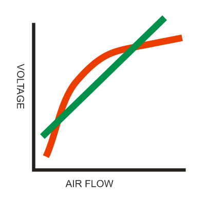

Could it be that the housing flows more, but the new sensor's response curve is such that it actually reports there is more air in some points and less in others. Thus the injectors duty cycle is adapter accordingly? It is all speculation. You could have a situation like below, although exaggerated, where at some points it is reporting above the factory MAF and some points below. We simply do not know.

Did you see the diagam about the response curves? It could be that at higher air flow, it is actually backing fuel out due to the reported voltage to the ECU. We simply do not know unless the sensors are mapped.
I can not explain that and never did, but neither has anyone else, except they say it works. I reserve comment on this until I have checked fuel trim values myself.
