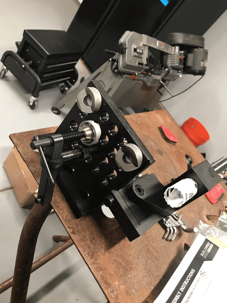

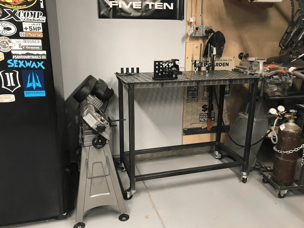

BuildPro tube notcher came in the mail today, Certiflat weld table kit should be here next week. Time to get the roof rack underway.

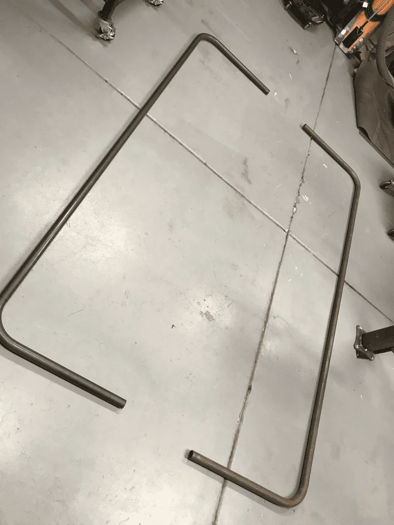

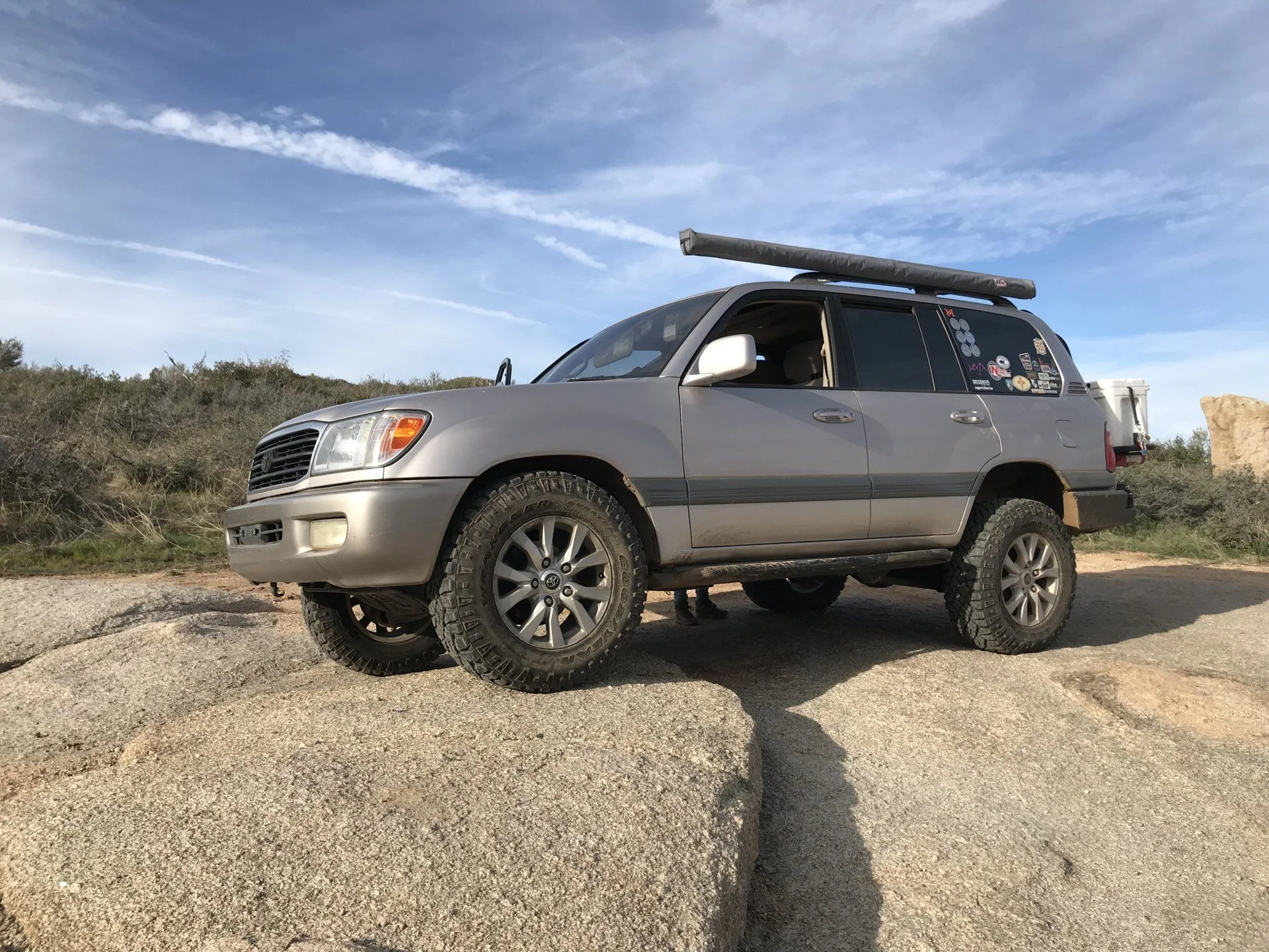

I forgot how terrible I am at bending tube. Here's the continuation of the roof rack project I started way too long ago and never got around to finishing. Got the second bit bended this afternoon. Didn't get the length to match perfectly with the one I bent months ago (I don't think I trimmed it to the correct length). I'll likely chop some out. Next up is to start cutting and notching the horizontal bars

Time to break in the tube notcher :)
