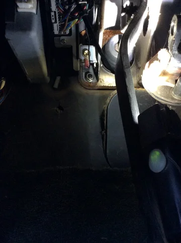

Could someone post a picture of where they have the ground wire routed to? My gauge stopped working and I noticed the group wire just hanging there. I can't tell where the previous owner had it routed to and there is literally one strand of wire sticking out of it. Did you solder it on?
Thanks
The wires are tiny. I just took a 22g ring terminal and overlapped the wire a couple times to crimp it on. Grounded it to this bolt. Lots of other bolts to ground it to down there. image.webpWorks fine.
