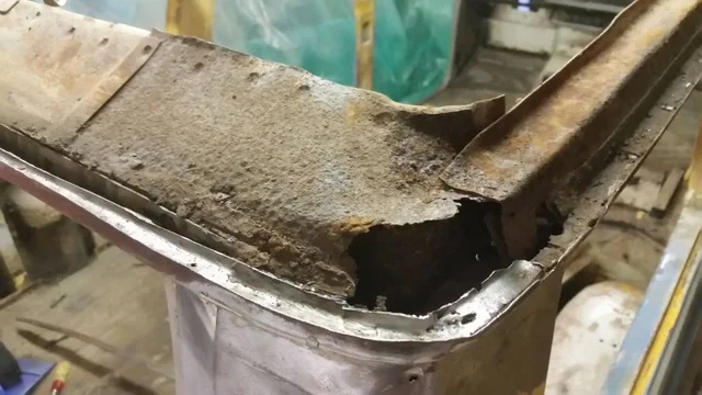

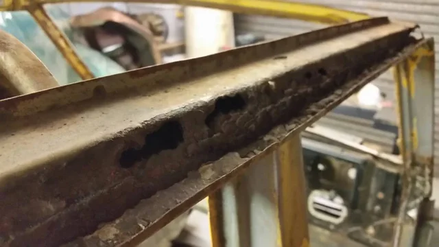

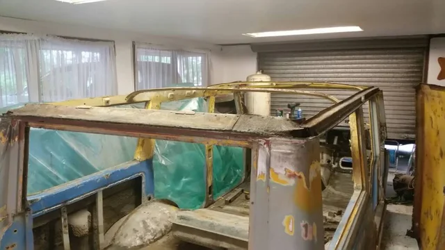

Finally can make an update on some progress. I knew I had roof issues (im sure lots of you are famliar with this) so have decided to start there. Started to scratch the surface and and started digging here is the end result.
I'm glad I removed as there is some rust issues to deal with.

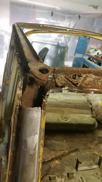

All the corner pillar junctions need work here's some pictures.

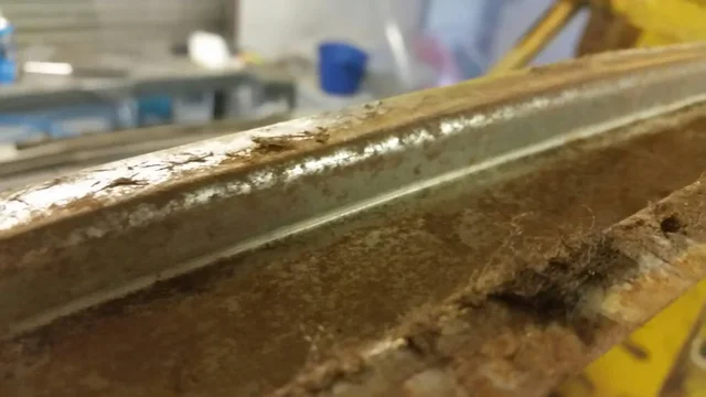

Here's a picture of one of the cross members. Amazing that it 45 Years old and has surface rust and bright steel showing. Goes to show its all about water collecting that causes the rot.1452064526574.webp
Great pictures! Shows how important it is to treat this area with a rust suppressant. What's your plan for the roof? Making a new one or maybe trying to graft a van roof on it?
Look forward to your progress.

I'm going to keep the roof, it's in good shape above where it turns down into the gutters. Hoping the edge radius is enough to reduce distortion when I weld in new gutters and sides.
I'm sure easier said than done but will give it a go.
