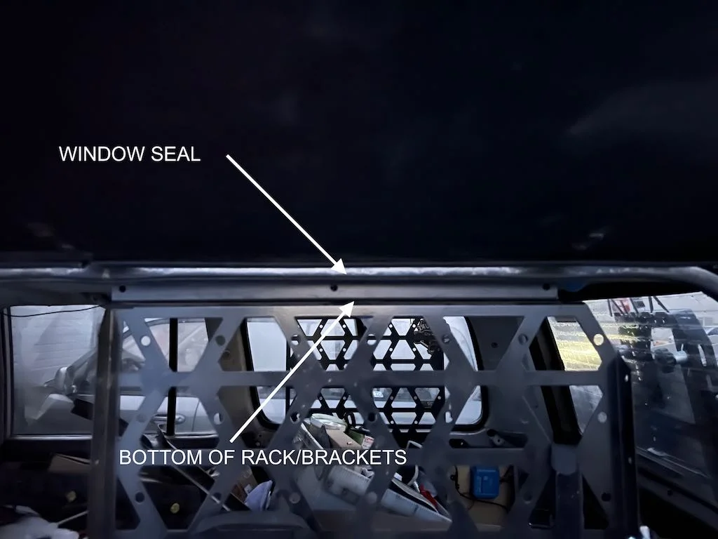

Does anyone have the KISS drawers installed with the attic shelf using the brackets from @Delta VS? I would like to add the drawers but I am concerned that I would loose to much usable vertical height in my cargo are if I did so.
The rack/brackets are just below the top of rear windows. Basically if you put a string line about 1/4 to 1/2" below the window gasket, that's farther down than the rack goes.

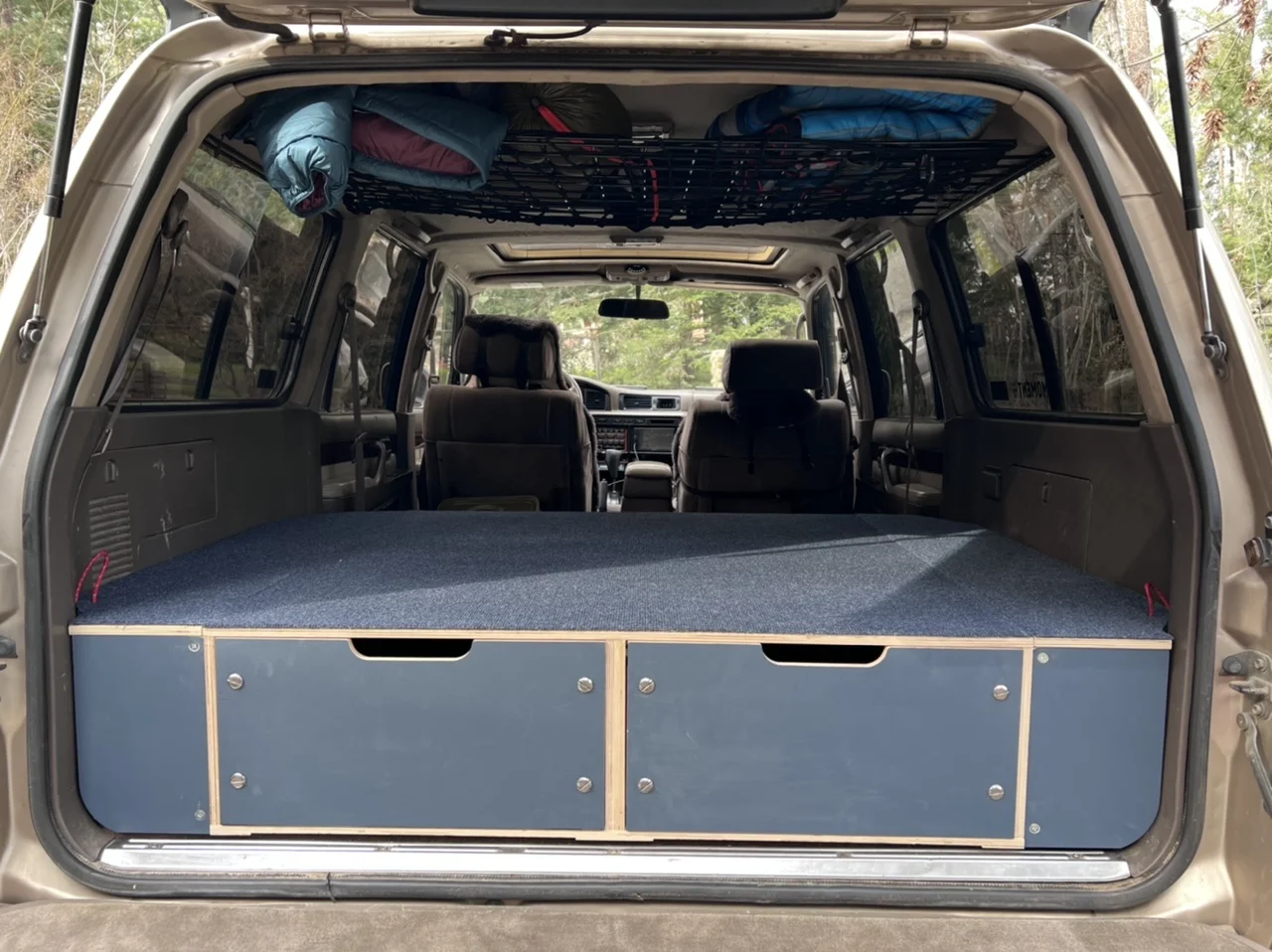

I think putting in an alum edge is a very good idea @PNWTreeOctopus I just couldn’t find it at the big box stores where I bought all the other accoutrements for finishing the project. Do you have any tips or links?
