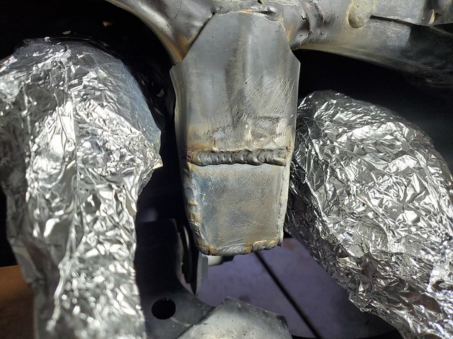

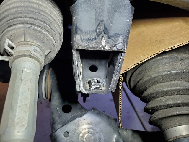

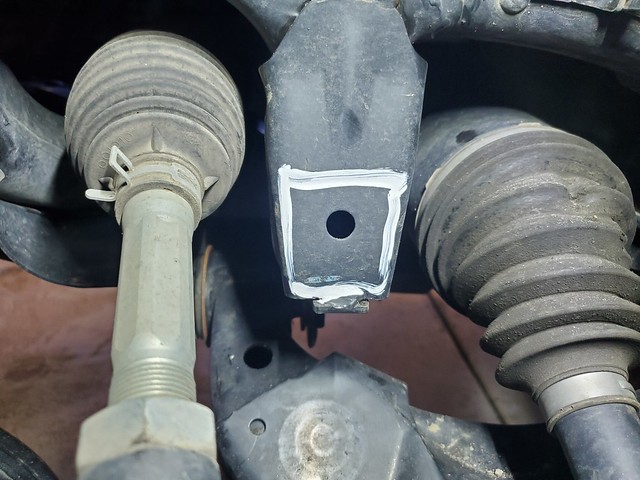

If I had this to do this again I would cut out a big chunk and weld a piece back in. Or cut it out and put in an air bump.
Went that route right out of the gate and it made the install relatively easy. There is plenty of metal even after cutting the front of the bump stop housing off. I bet if you left it like that you would not have any issues long term. Probably 45 min per side including cut, grind, cut patch, weld, grind, paint. The Nitro UCAs I installed came with some small diameter slightly extended bump stops that required no trimming. I don't have any pics at full droop but there is now a ton of clearance in this area.

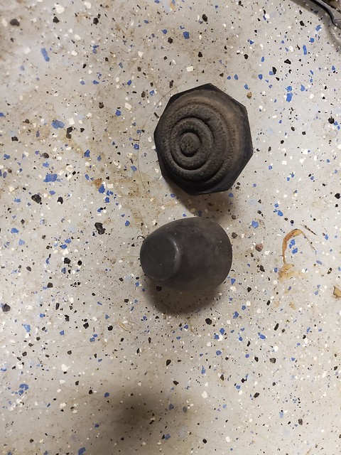

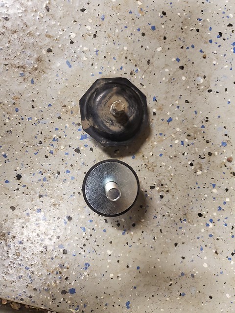

OEM vs Nitro bump stops

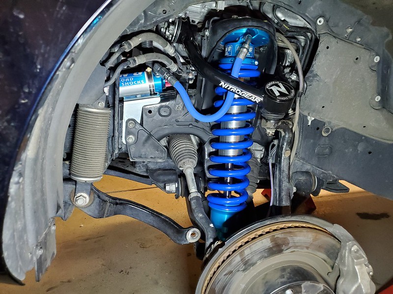

Looks great overall!
A set of 4 came with the Nitro UCAs. I went on their website and could not find them individually, but I'm sure if you call them they can order them for you. I ordered the UCAs last fall, so maybe previously they did not come with them?
They definitely are aesthetically pleasing. I haven't had a chance to fully test them out offroad as we have had 18" of snow on the ground for the last two months but from what I have driven so far, they are the first suspension set up I have run that does equally well on road as it does off road.

I just installed a set of fronts a couple days ago and the original post is what I experienced. I only grinded the bump stop edge, but I loosened the lower arm bolts and rotated the alignment cams out to get a little more clearance. Once it settles some and I get it aligned, I'll have the shop check the droop to see if I grinded enough.
