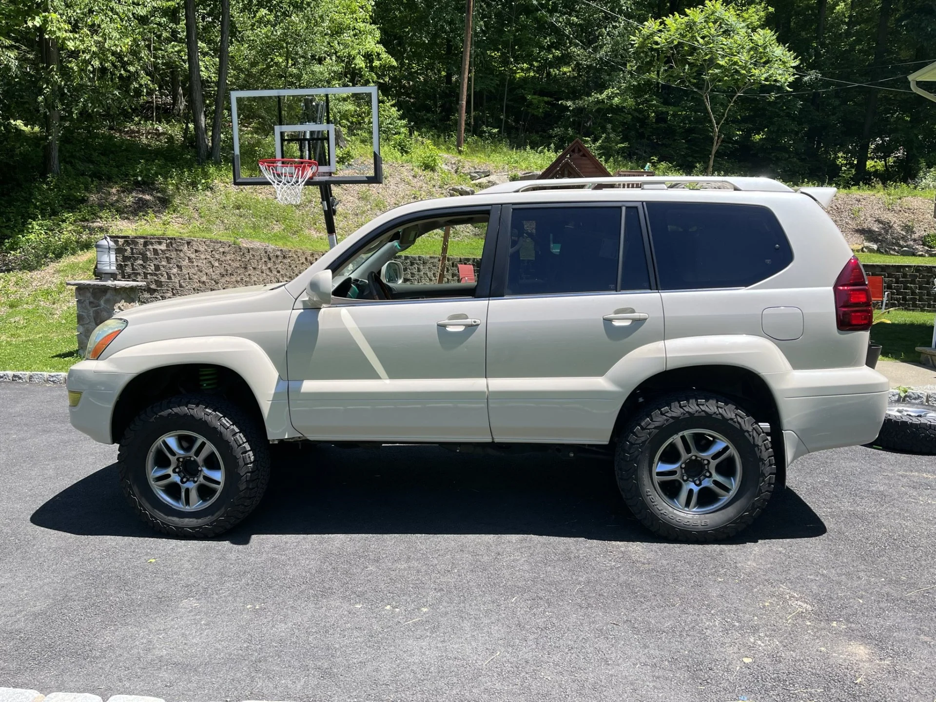

This is what I have so far and I will not be doing much more for some time:
1. Ironman basic 2 or 3" lift that I got on their St Patrick sale
2. 285/65/17 BFG Ko2 over the stock 08 GX rims
3. 1.25 Spiderax spacers.
I will cut the side steps. I know next stop should be real rock sliders but we are going overseas (as soon things cool down out there) so that's my main focus really.

My old 03 sold last year below. I essentially got the same car but two months younger and with dash with NO cracks!

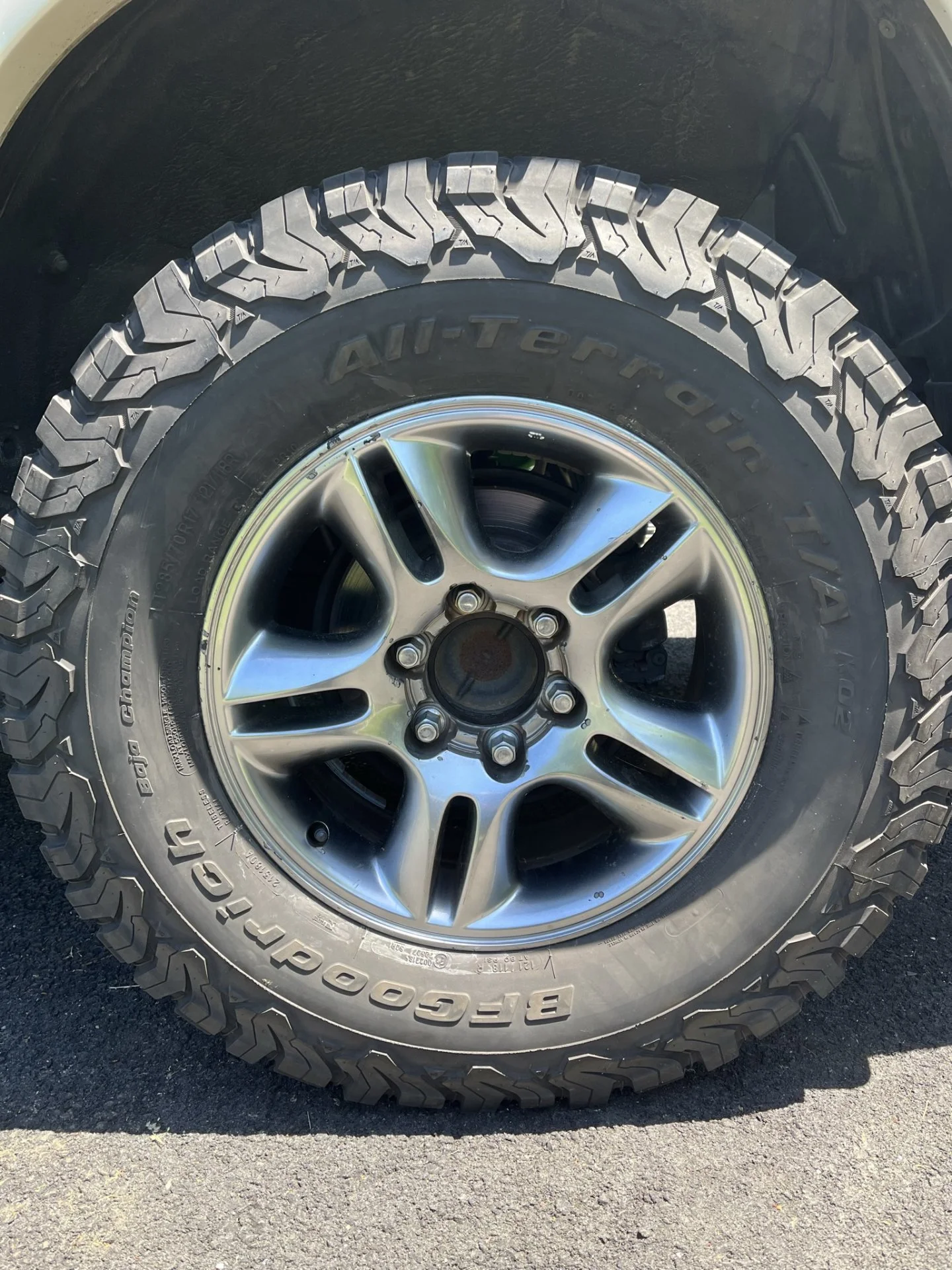

I run the stock rims also, this size tire comes in both C and E load rating, any idea which ones you have? They are still fairly small tires but will get the job done if you take the right line!
I don’t have experience running less than E load rated tires at Rausch so can’t say how they would hold up! But I did run SL load 265/70/17 Falken Wild Peaks on the beach before I got the Toyo’s without issues, they were noticeably softer on road - but 100% not recommended for rocky trails.

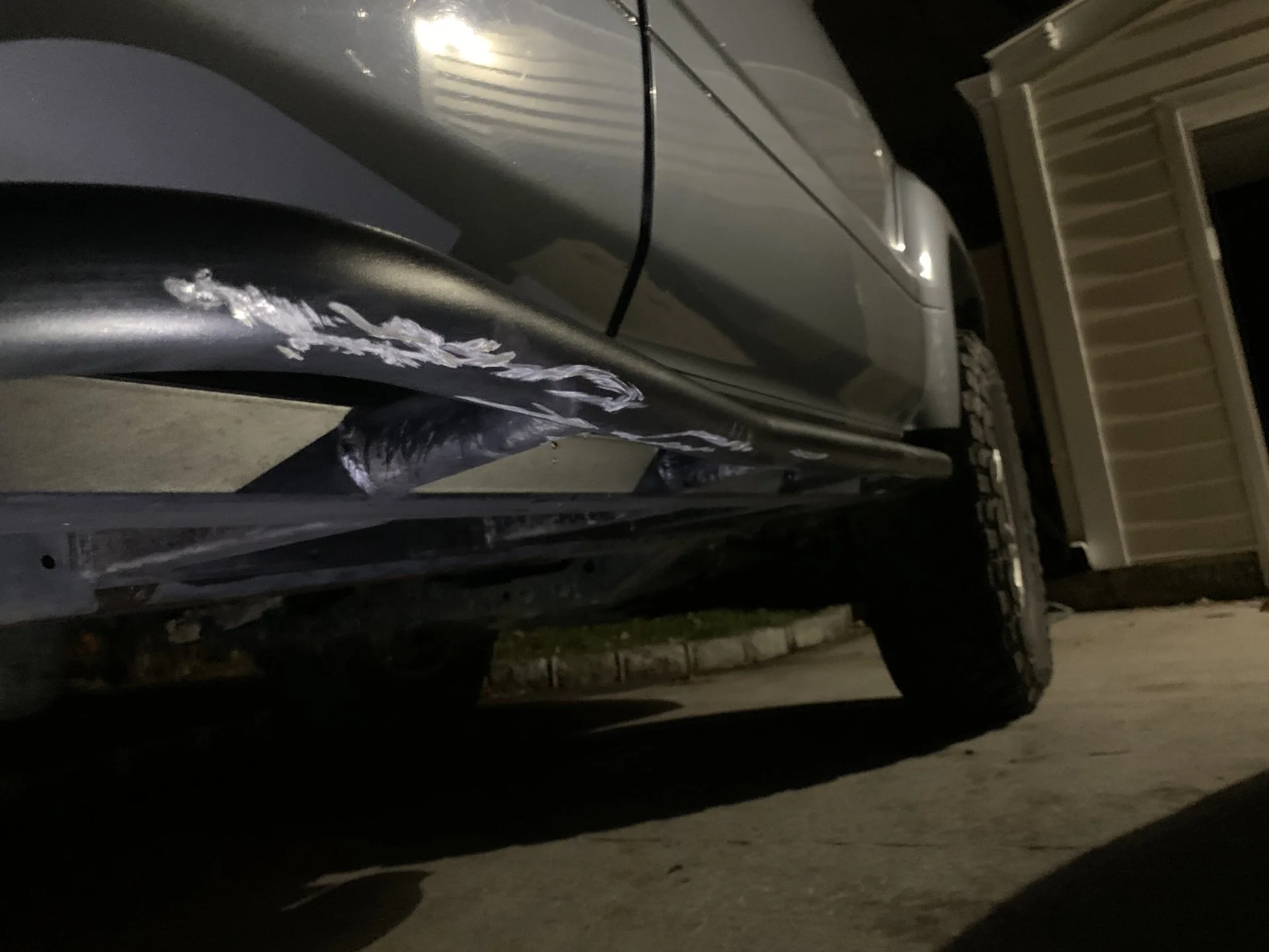

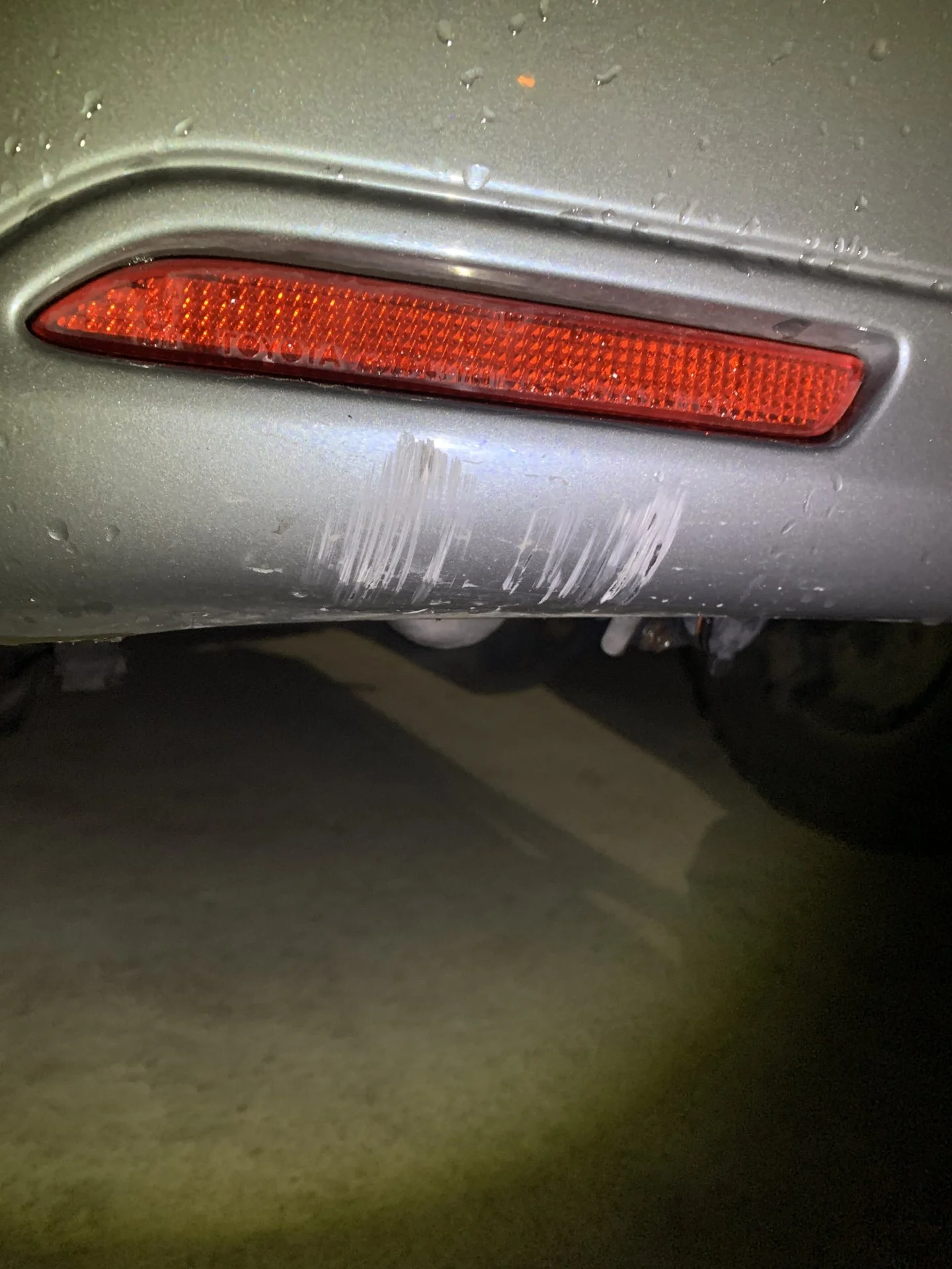

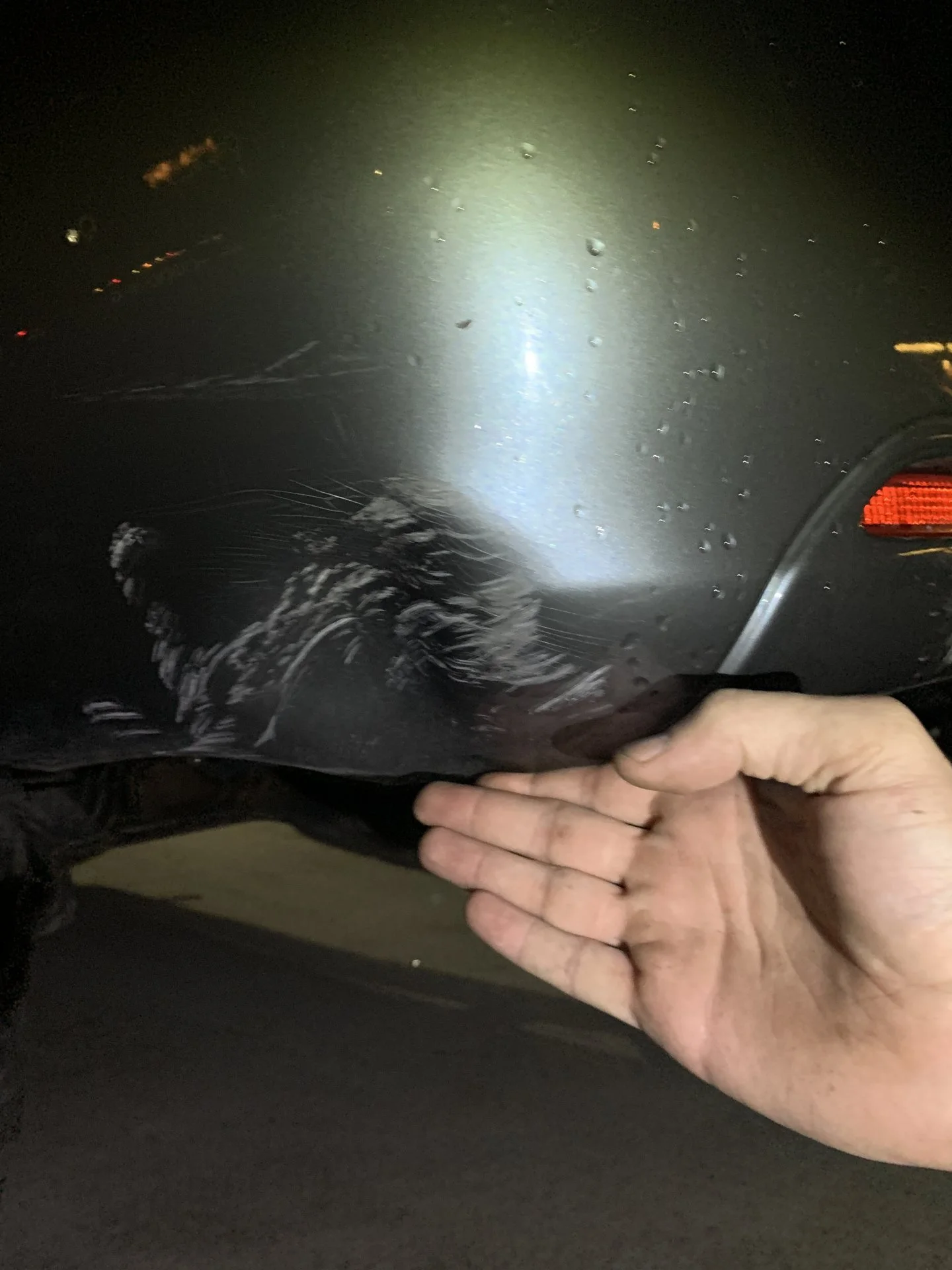

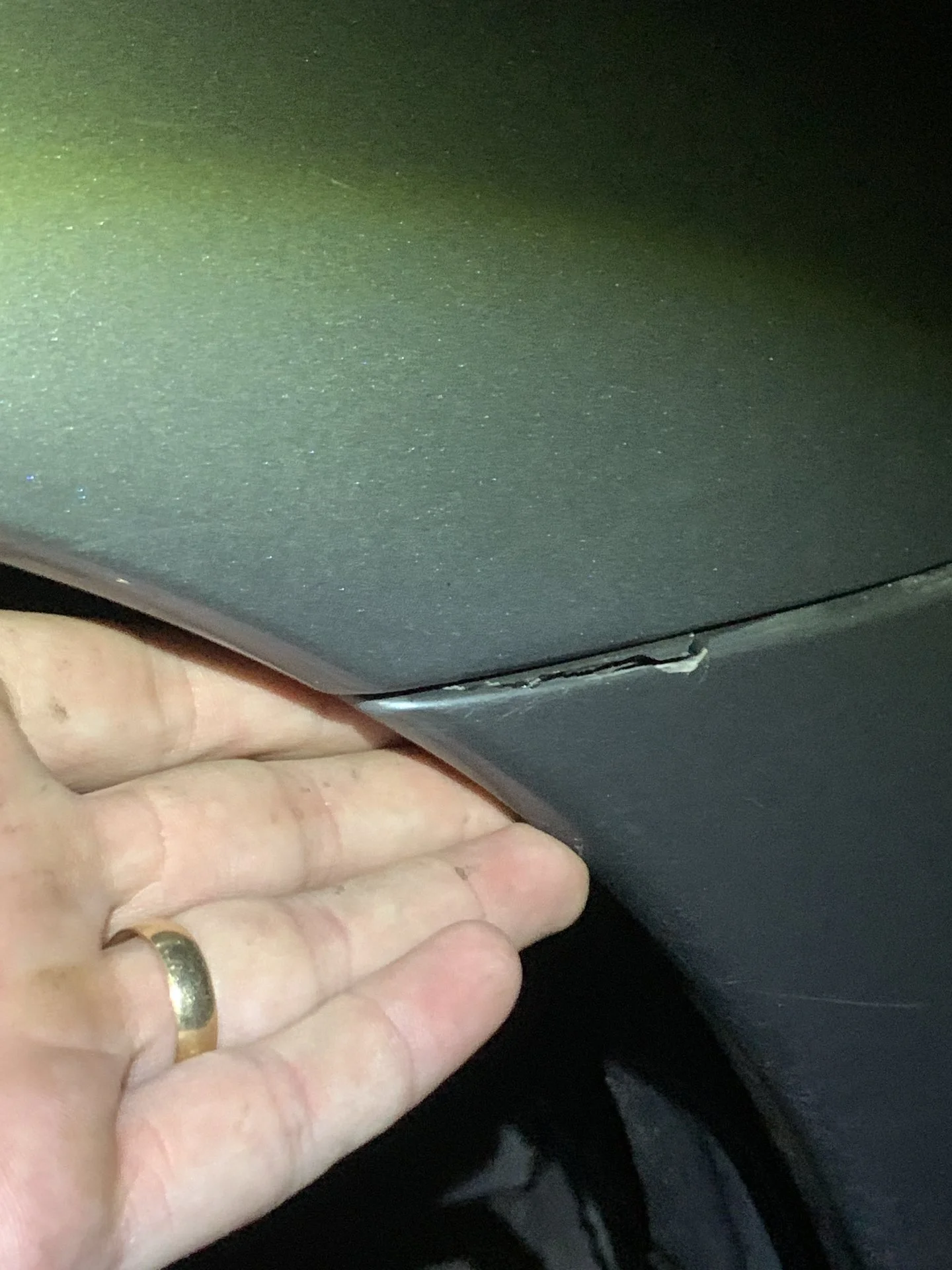

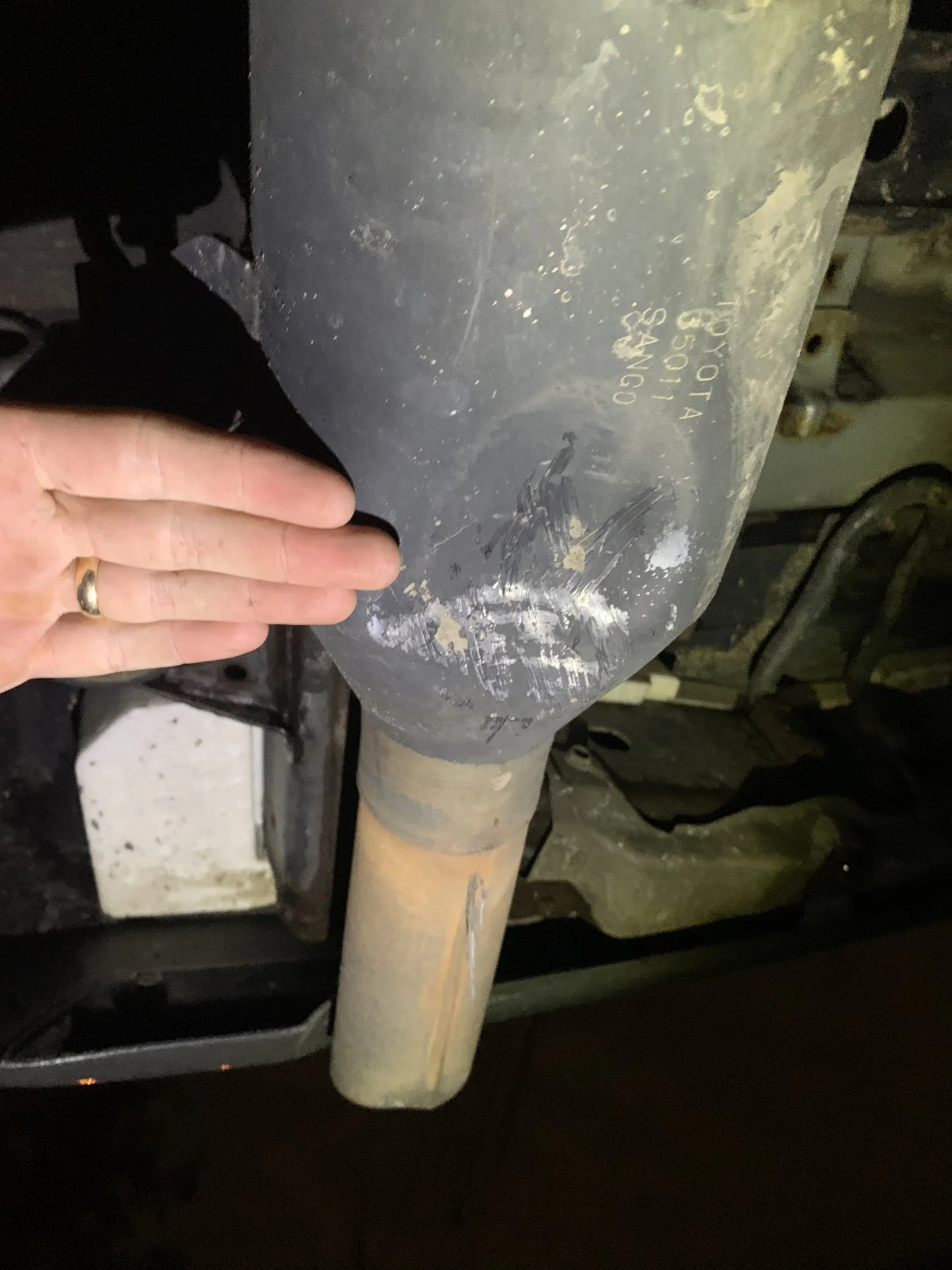

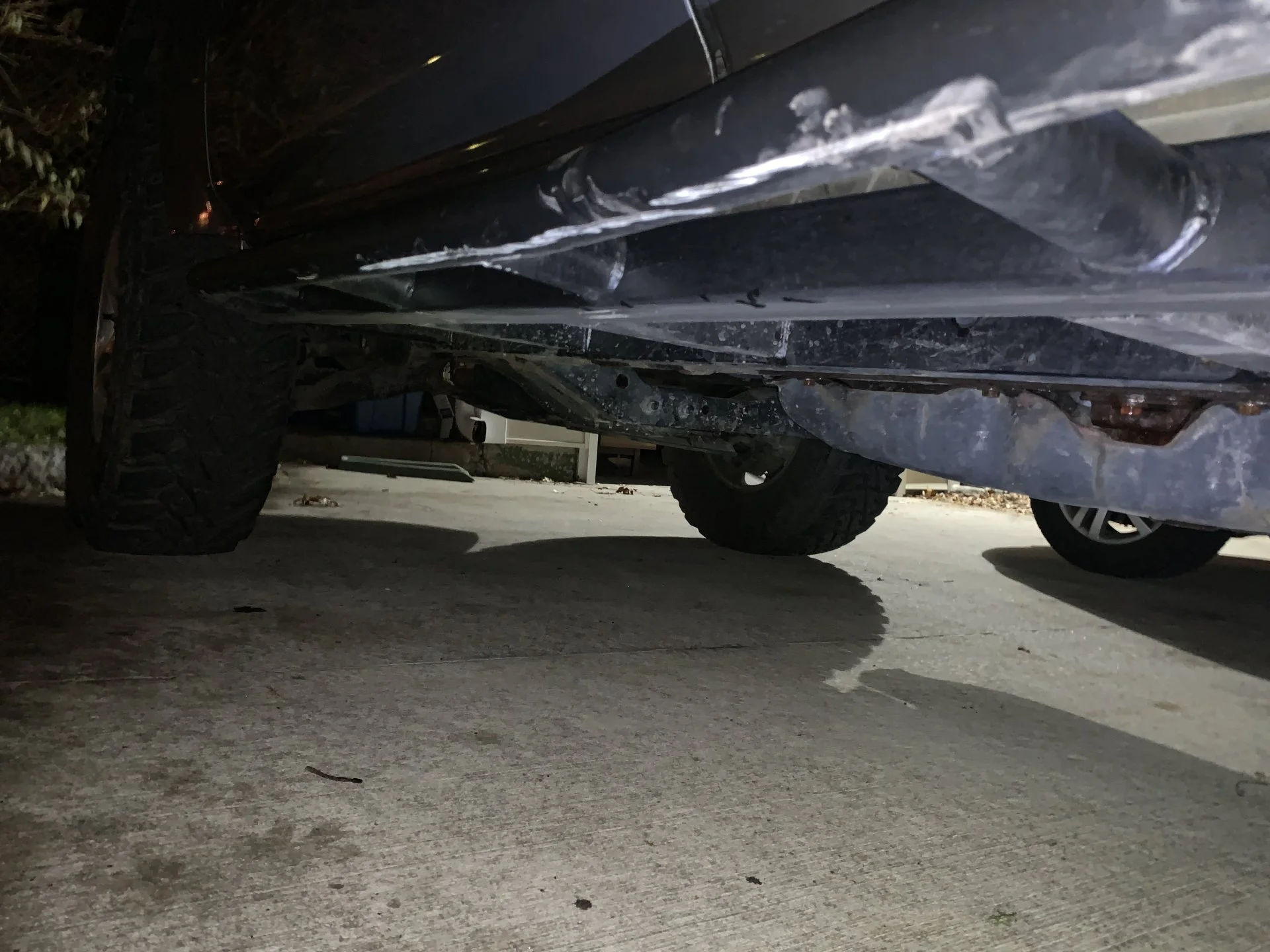

See the attached pics below of the trial damage. We ran green and mostly blue trails that day, which is usually the norm for me.

I am shaking my head over the damage you were able to collect in Rausch! Almost to the point to not want to go there without sliders!. On the other hand, my car seems to be perfect for this challenge with its minor paint issues here and there. So are the green trails (assuming these are the easiest ones) still so challenging and can cause all these damages? I clearly underestimated rausch!.

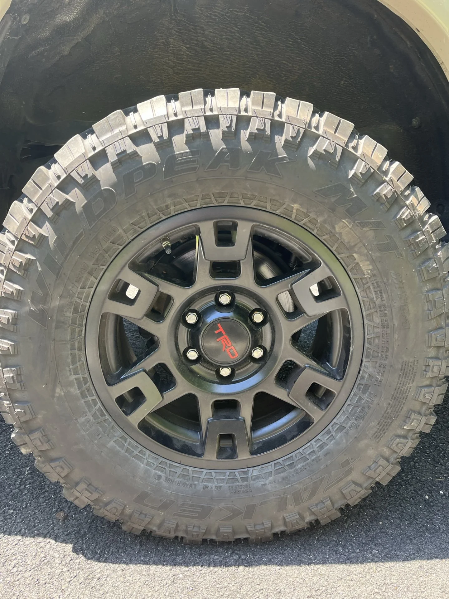

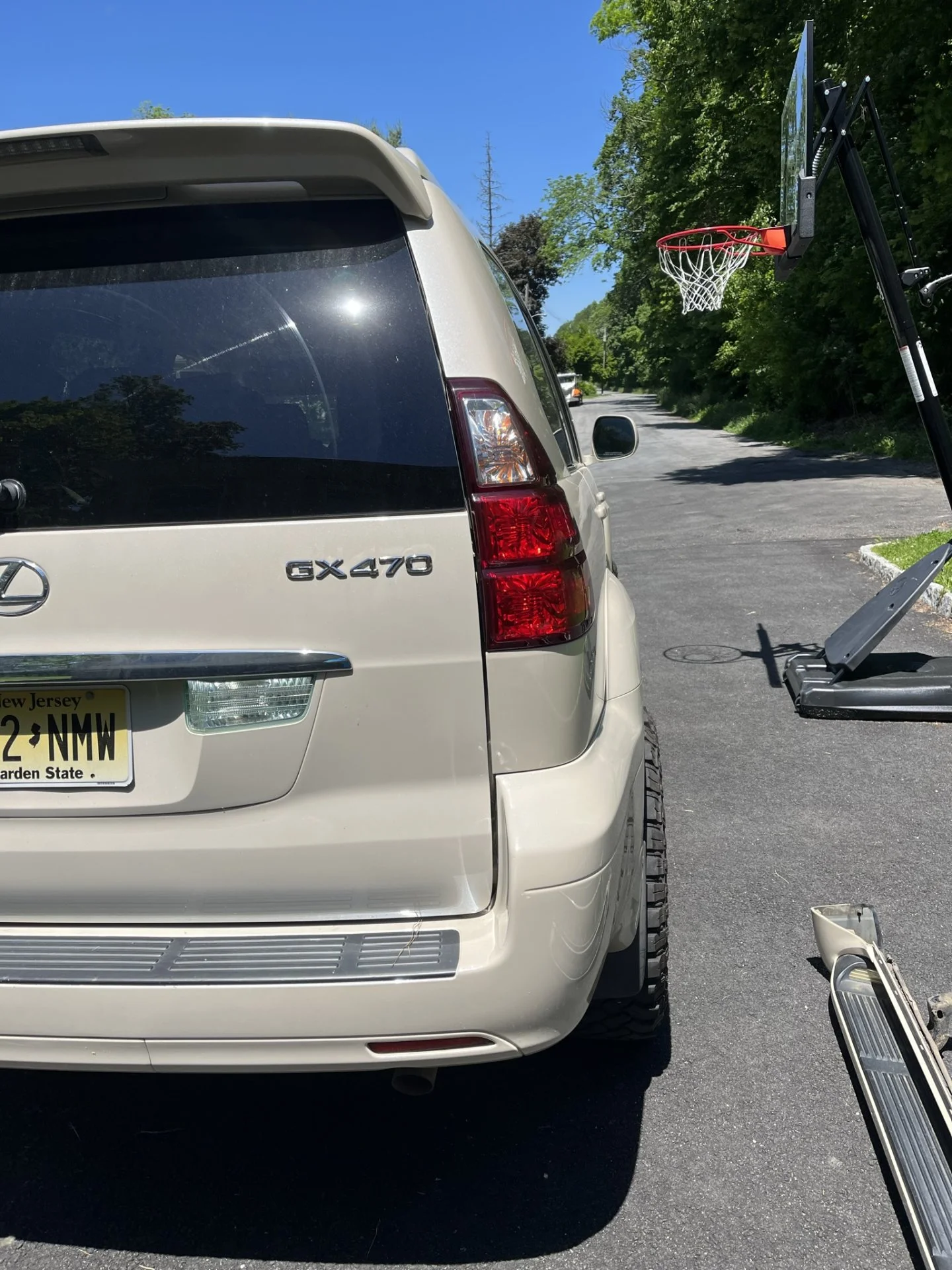

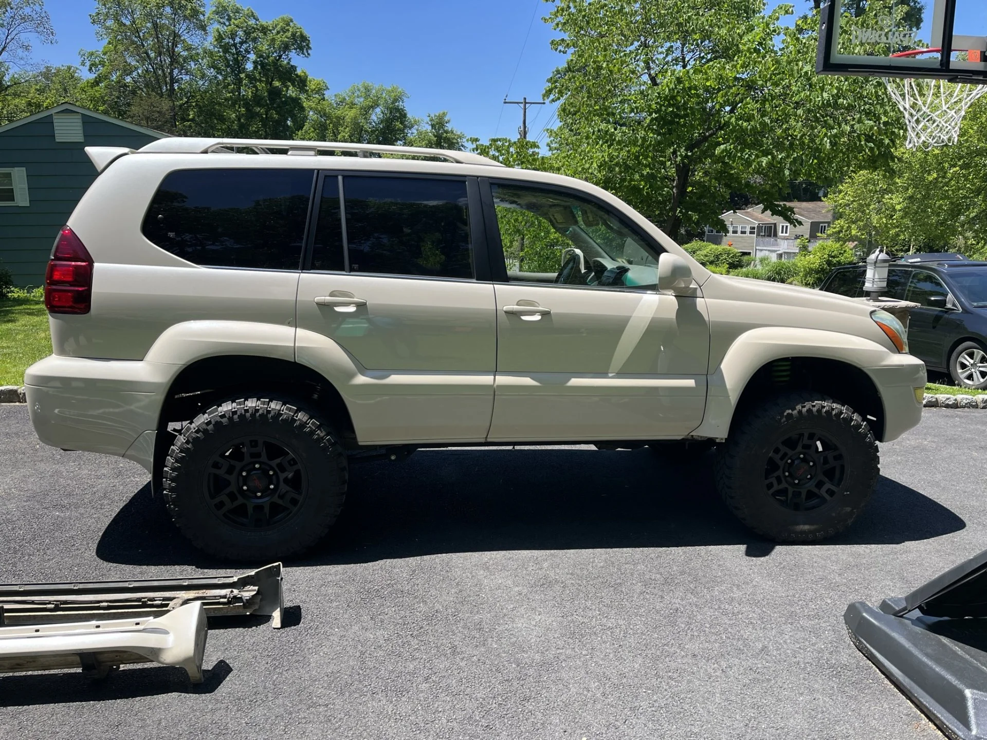

Guys - as aa novice I could use your help with these two things:
1. I ended up with two sets of wheels that work with my car. I will need another two tires for a set of 4 wheels + 1 spare and one "attic stock". I will eventually the extra set to free up $$ and out into rock siders. Just need to know what I should use out of two for the car with minimal daily duties and occasional local (NJ/PA, read FRO) outings. So it is Falken Wildpeaks M/T MT01 vs KO2 question.
2. I use 1.25" spiderax spacers on the bothe set of wheels. The TRD ones are sticking out pretty far, which looks cool but apart from being cool is there any benefit? With TRD I could probably get rid of spacers altogether.
Disclaimer:
a. This is a budget project. I got many parts from other car that got into collision and was totaled (including the replica TRD wheels). My next goals are cutting bumpers ($0), front axles ($200), rock sliders ($800-ish). I probably can get $900 out of TRD wheels, and $500 of stock wheels with KO2 tires).
b. Car is leaning ion the back and I am correcting it next week.

I'd avoid the spacers. They work until they don't, then you are in for a bad day. As for tires, the BFG's will be nice a quiet on the road, the M/T's will work much better offroad. Depends where your priorities lie.
